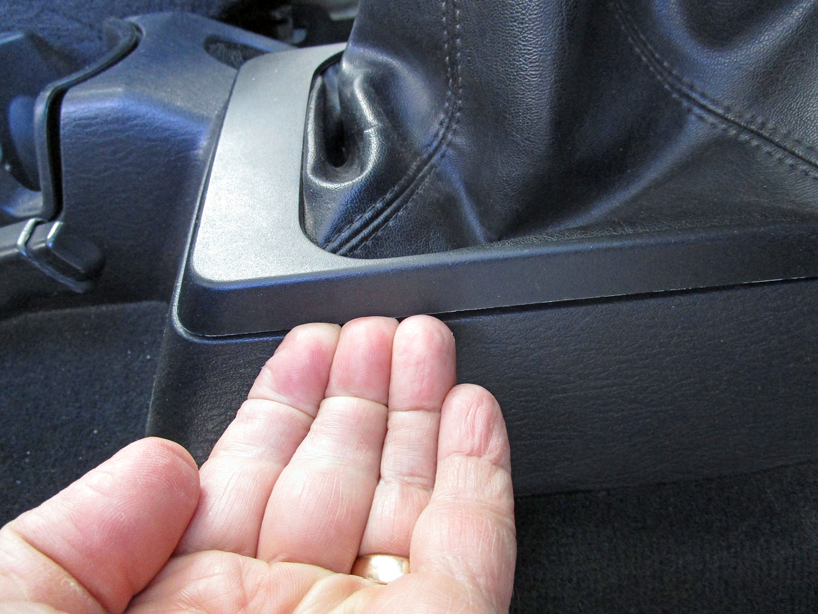

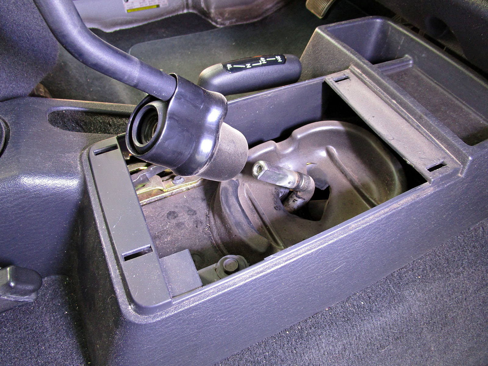

Inner Shifter Boot

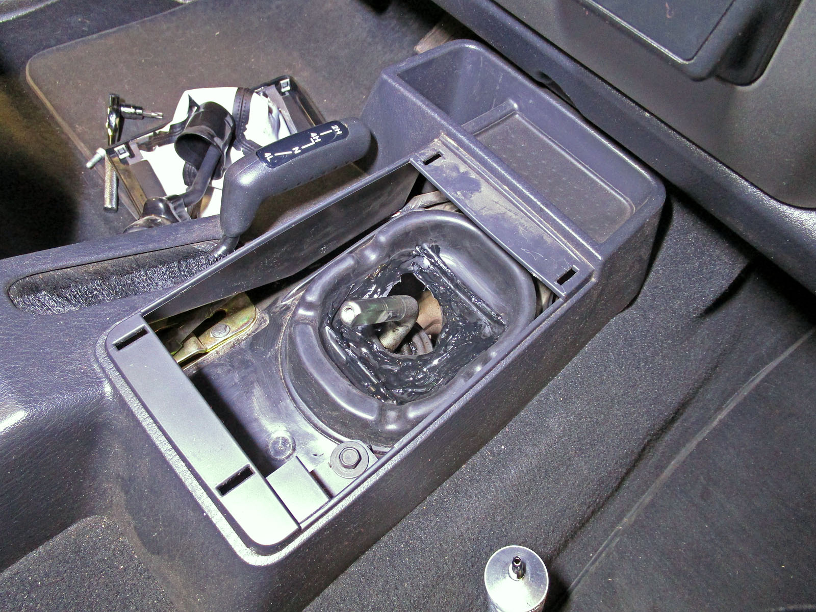

The '05-'06 Wranglers with a manual tranny have a big plastic floor pan cover with a soft rubber boot. That boot tends to tear around the shifter, leaving a big hole. And a replacement costs almost $200.
So I followed the @Zorba fix here: Zorba's Jeep - Lower Shift Boot
I popped off the outer vinyl boot with the plastic trim piece (just lifted it up).
The rubber cover over the vibration damper can be slid up out of the way. I removed the Torx T-45 bolt, and pulled the shifter straight off. You can see the big hole in the rubber around the shift rod.

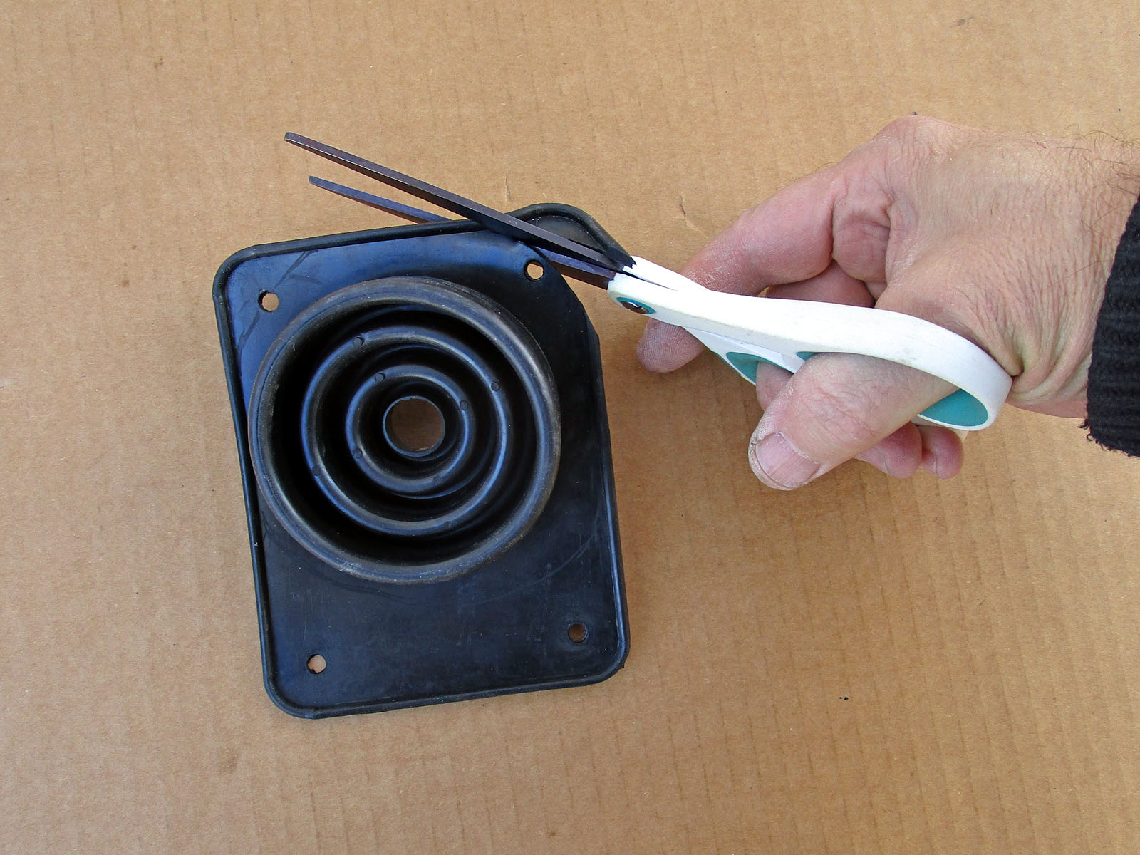

I trimmed away the loose rubber around the hole, and wiped everything down with alcohol. It would have been easier to clean and trim if I had removed the console and the floor pan cover.

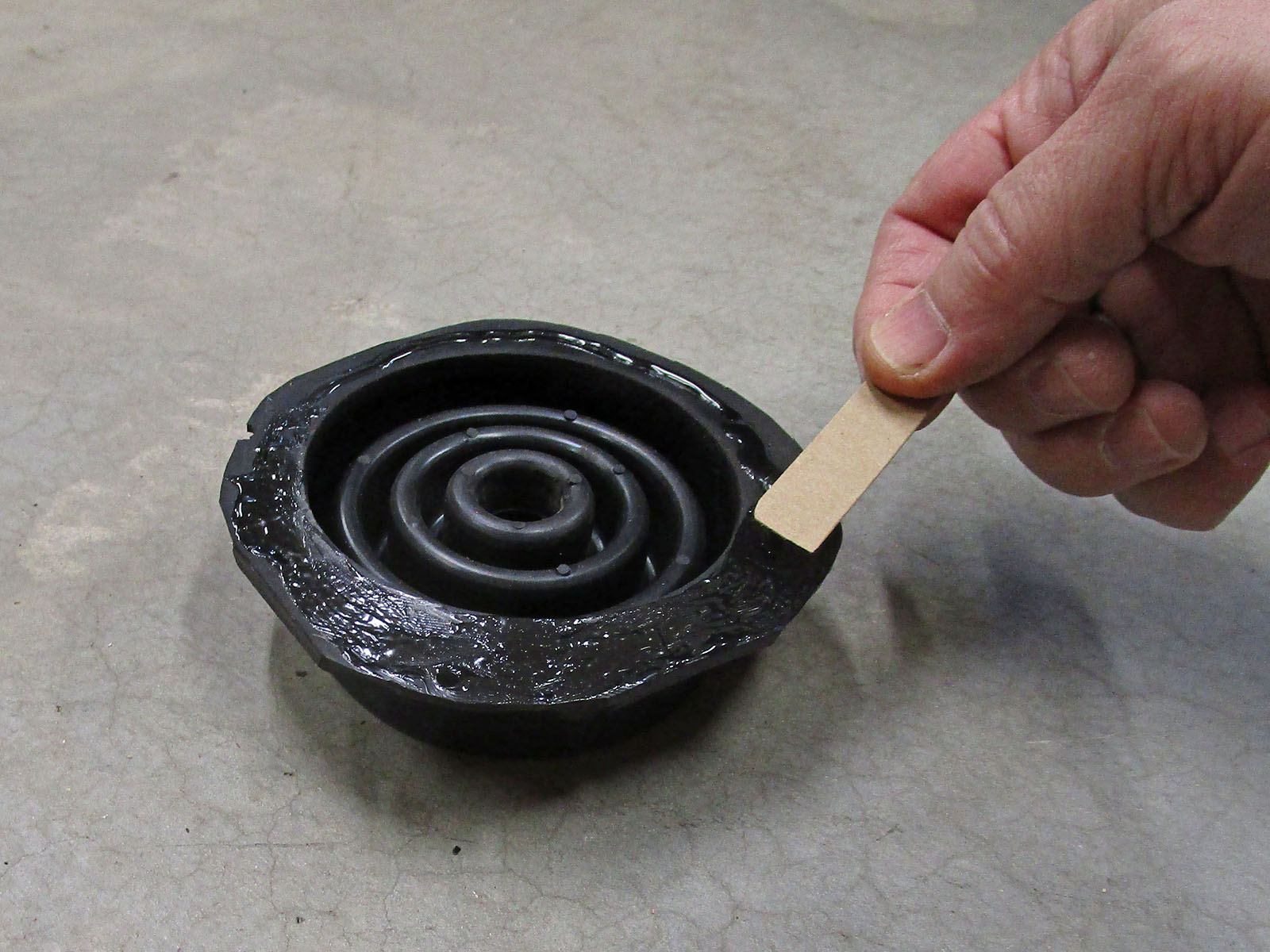

For a cheap replacement, I used this rubber boot: Spectre Performance 6285 Universal Shift Boot
along with this adhesive: 3M Black Super Weatherstrip And Gasket Adhesive
This boot is small enough to sit down in the larger OEM boot.
I placed the new shifter boot on the shifter rod, and marked where to trim it with a pencil, and then cut it with scissors. I checked fitment, and trimmed it a little more. Holding it in place, I shifted through the gears to make sure everything would work together.
I wiped the bottom of the new boot with alcohol to remove any manufacturing crud, and roughed it up with coarse sandpaper.
With the garage warmed up so the glue would cure well, I applied the 3M adhesive to the OEM boot, and to the new boot, and smeared it out thin. After letting it dry for a few minutes, until it was pretty tacky, I set the new boot in place and pressed it down all around with a stick, and held it in place for several minutes.
I placed a couple of small weights on it to keep it in place, and left it to dry overnight.
It seems to be glued snuggly, but time will tell if it will stay.

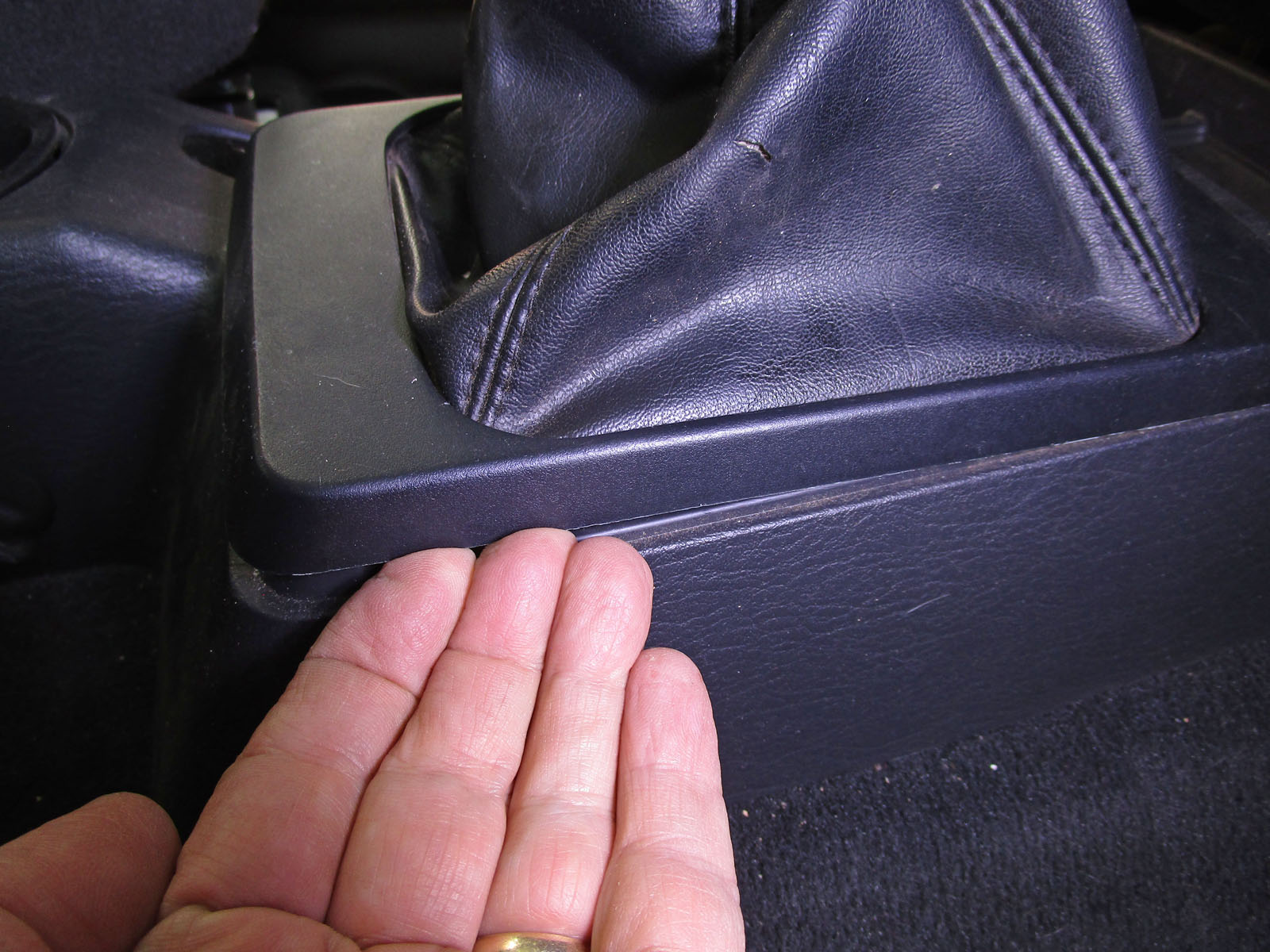

My OEM vinyl outer shifter boot had several small splits. I ordered a replacement boot, in real leather, black with red stitching, from RedlineGoods.
It costs about $50, and if you mess around on and off the webpage and it thinks you're leaving, it may pop up a 10% discount code. The shipping information was a little confusing, but I made a suggestion to the owner, who made a change to the webpage. It's much clearer now, with free shipping from Poland. It says it will take several weeks, but mine arrived in two. You can also pay for FedEx to speed it up.

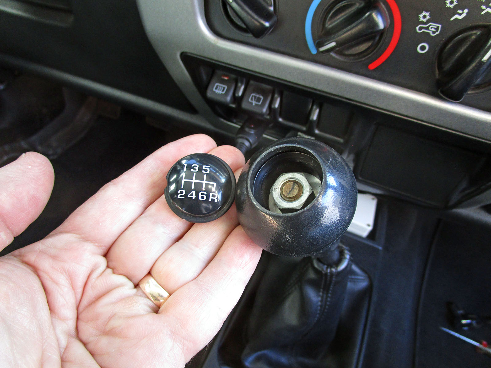

To remove the old boot, I had to remove the shift knob. The knob screws on to the shifter rod, and has a locknut under the shift pattern insert to keep it tight. Some people use a plastic or rubber gripper tool to just twist the knob and nut off together, but I couldn't turn mine without damage with the tools on hand. So I removed mine the conventional way, which is actually quite easy.
Very important: Heat the knob up with a hair dryer. First I tried probing gently around the shift pattern insert with a small screwdriver with the knob at about 50°F. It was very stiff, and would obviously be damaged. After heating it to about 125°F with a hair dryer (quite hot to the hand, almost but not quite scalding, and not as hot as it gets in the summer sun) the knob was much softer, easy to probe around.
I slipped a skinny screwdriver down between the insert and the knob. There is a small notch in the insert at the left side, between 1st and 2nd. With a very skinny screwdriver you can get it in that notch. I didn't know that, so I had to feel around and get the screwdriver over the plastic lip. I reheated once. Then I pried the plastic insert out. The knob stretched and dented, but then quickly recovered with a little more heat applied.
I removed the lock nut with a 15mm socket, and then unscrewed the knob by hand. I pulled up the plastic bezel around the bottom of the shifter boot with my fingertips and slid it off of the shifter rod. It's held in place by four metal clips.

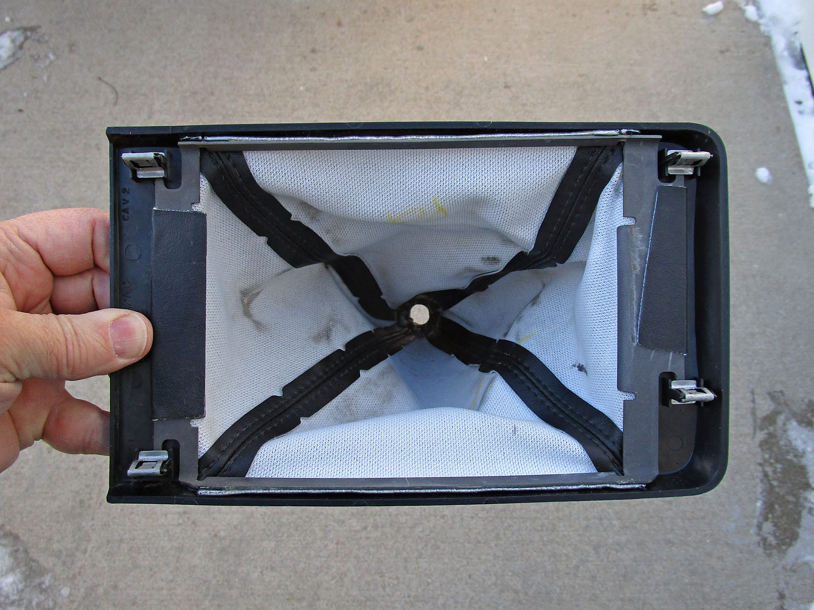

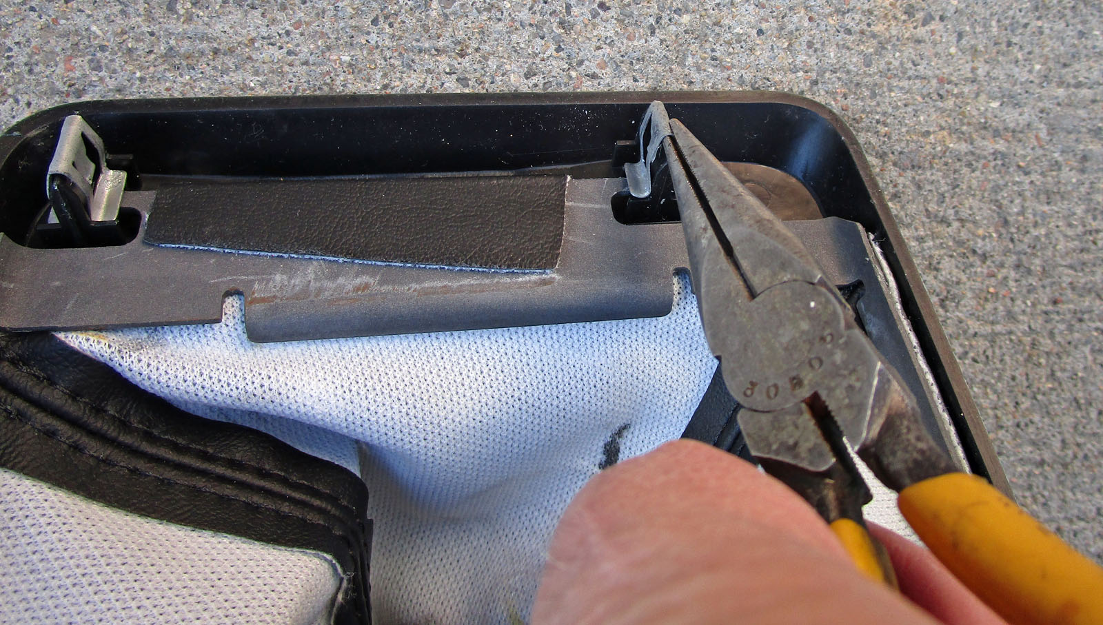

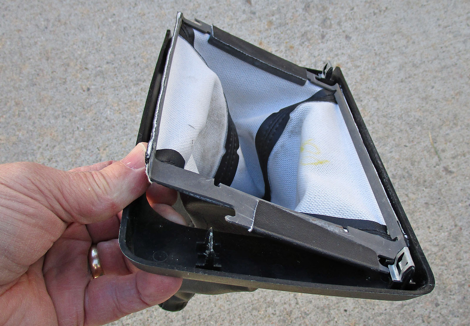

The plastic bezel has a metal frame underneath it, held to the bezel by the four clips. I pulled the two clips on the right side off, carefully, with needlenose pliers. Prying them too hard will easily bend and damage them. I stuck the tip of the needlenose in the small gap at the main fold in the clip and worked them off of the plastic studs. With the two right clips removed, the metal frame, with the shifter boot, can be lifted out.

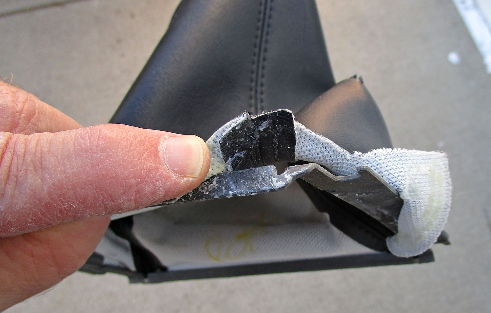

I took lots of pictures of the way the boot was attached. The OEM shifter boot is glued to the metal frame with a very strong glue. I pried the boot loose, using a knife at the corners where the glue held especially tight to the vinyl. The fabric pulls away from the glue easier. It's easy to distort the metal frame, so I tried to go easy with it.
I scraped most of the glue residue and vinyl off of the metal frame, and sanded it lightly.

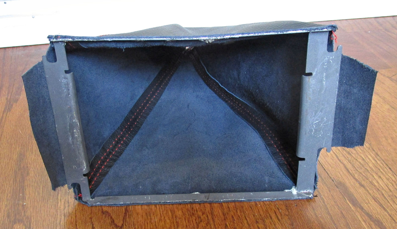

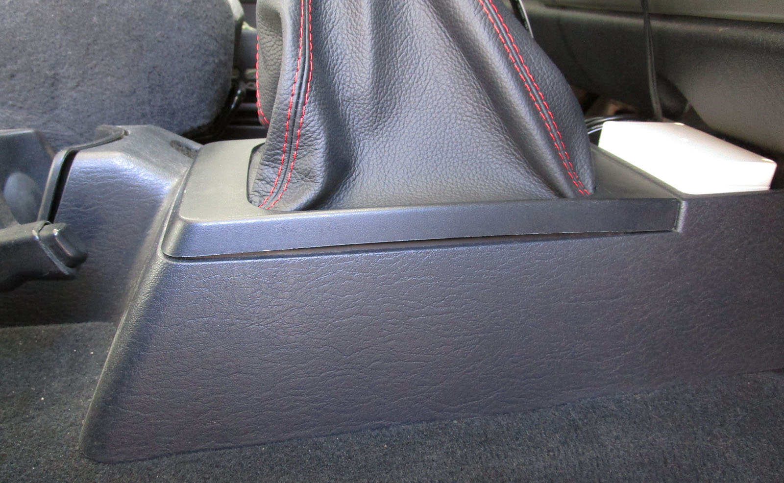

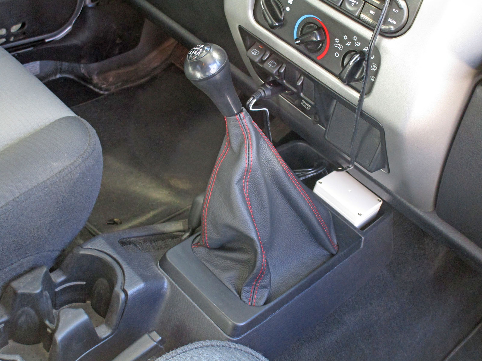

The new leather boot has two wider panels and two narrower panels. They are not greatly different, so I compared the sides carefully to figure out which way it should fit before proceeding.
I stretched the new boot over the frame, with the ends of the stitching just coming even with the frame, and about an inch of leather overlapping below the frame on all four sides. It's a snug fit, and I had to work it around a little to get the corners in place.

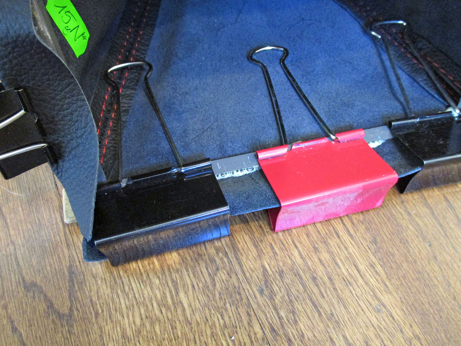

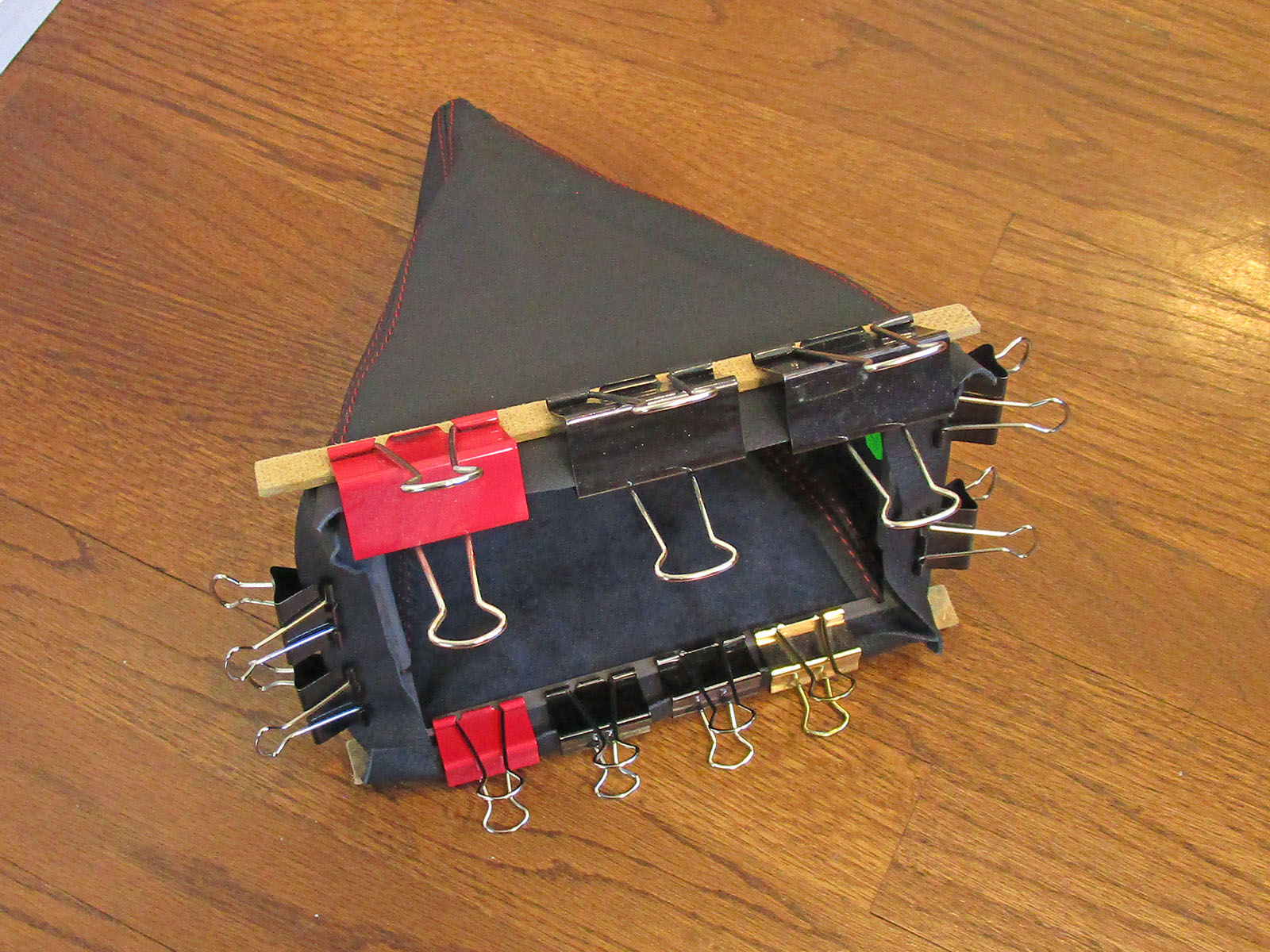

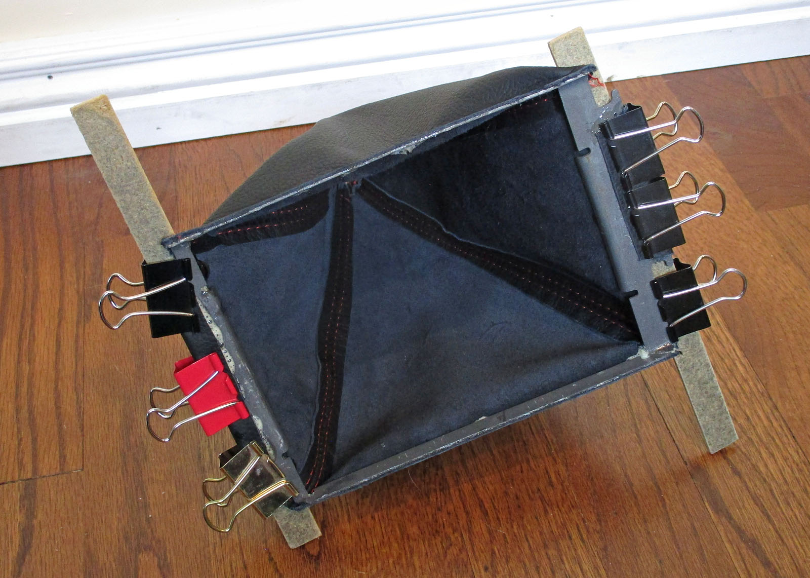

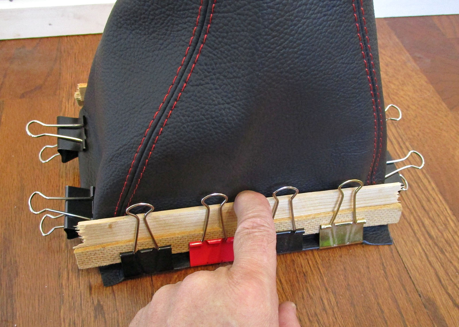

I clamped the leather boot to the frame with a bunch of spring clips on both long sides, using small wood strips to spread the clamp pressure over the leather so the glue would be squeezed evenly, and to protect the leather. I removed the clips from one side, and used a Q-tip to wet the leather where it will touch the metal. Then I applied a thin layer of Original Gorilla Glue to the metal, and pressed the leather against it. I replaced the clips and wood strips, and then glued the other long side. I used a couple more thin strips of wood to press the leather down over the edge of the frame, as it will sit under the plastic bezel. I didn't want the glue to hold the leather up stiffly along the top of the metal frame. I let those two long sides dry for 2 hours.

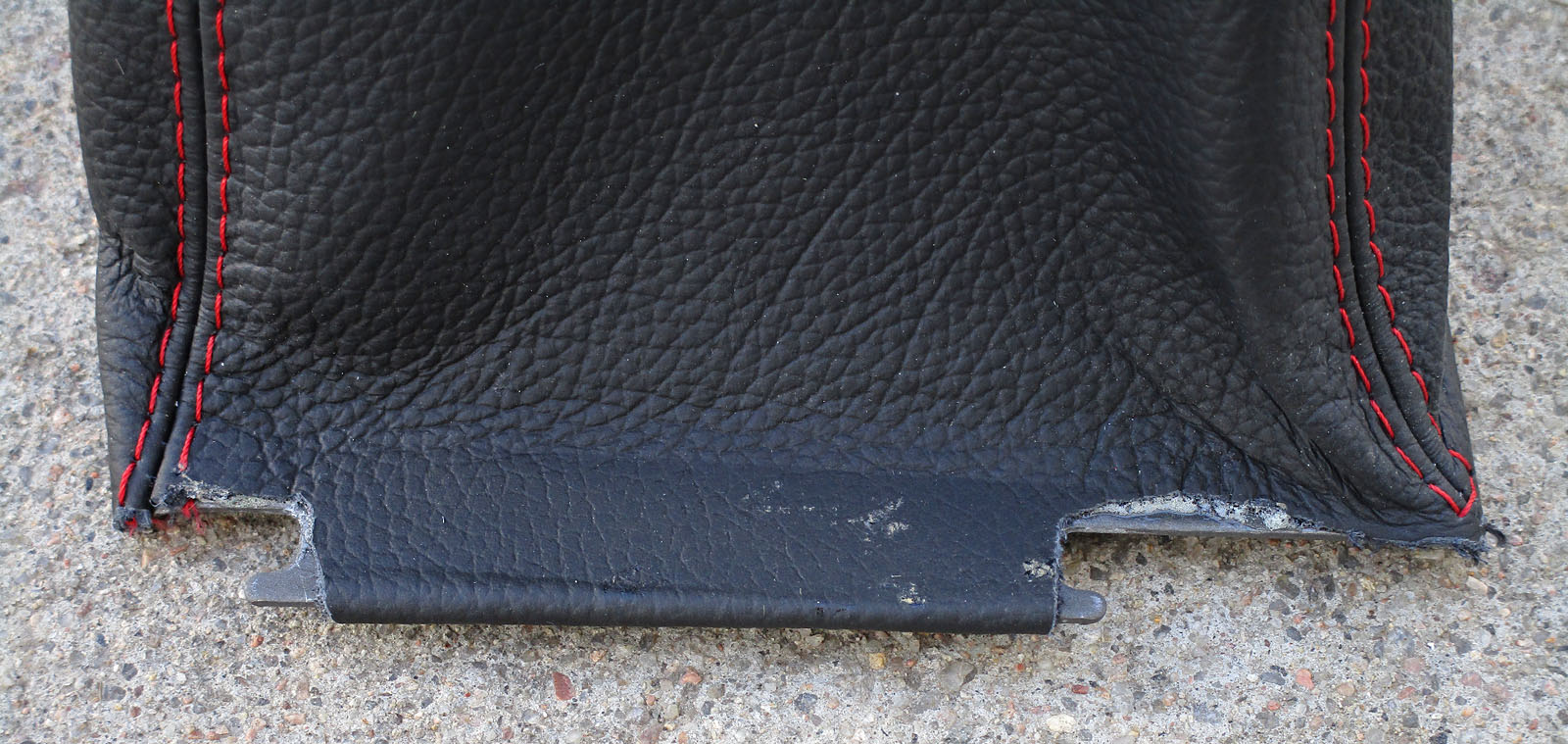

I trimmed the excess leather from the sides, and them trimmed the end flaps, notching the corners like the original boot to clear the tabs where the metal frame mounts. I was glad I had taken a lot of pictures. I glued the end flaps similarly to the side flaps and let them dry for 2 hours. Then I removed the clamps and left the whole assembly to dry overnight.
I trimmed and cleaned up the edges again, and cleaned up most of the excess glue. Gorilla glue expands as it dries, and gets where it shouldn't. I had to scrape some of the glue from under the leather to get it to squeeze down tight against the metal frame where the plastic bezel fits snugly over it. And I had to squeeze the corners down tight with pliers and wood blocks to flatten some of that fat glue. I wish I had used hot glue instead, since it cools fast and doesn't expand. But I was afraid that I wouldn't have time to glue it and then get the clamps in place to squeeze it all down evenly.

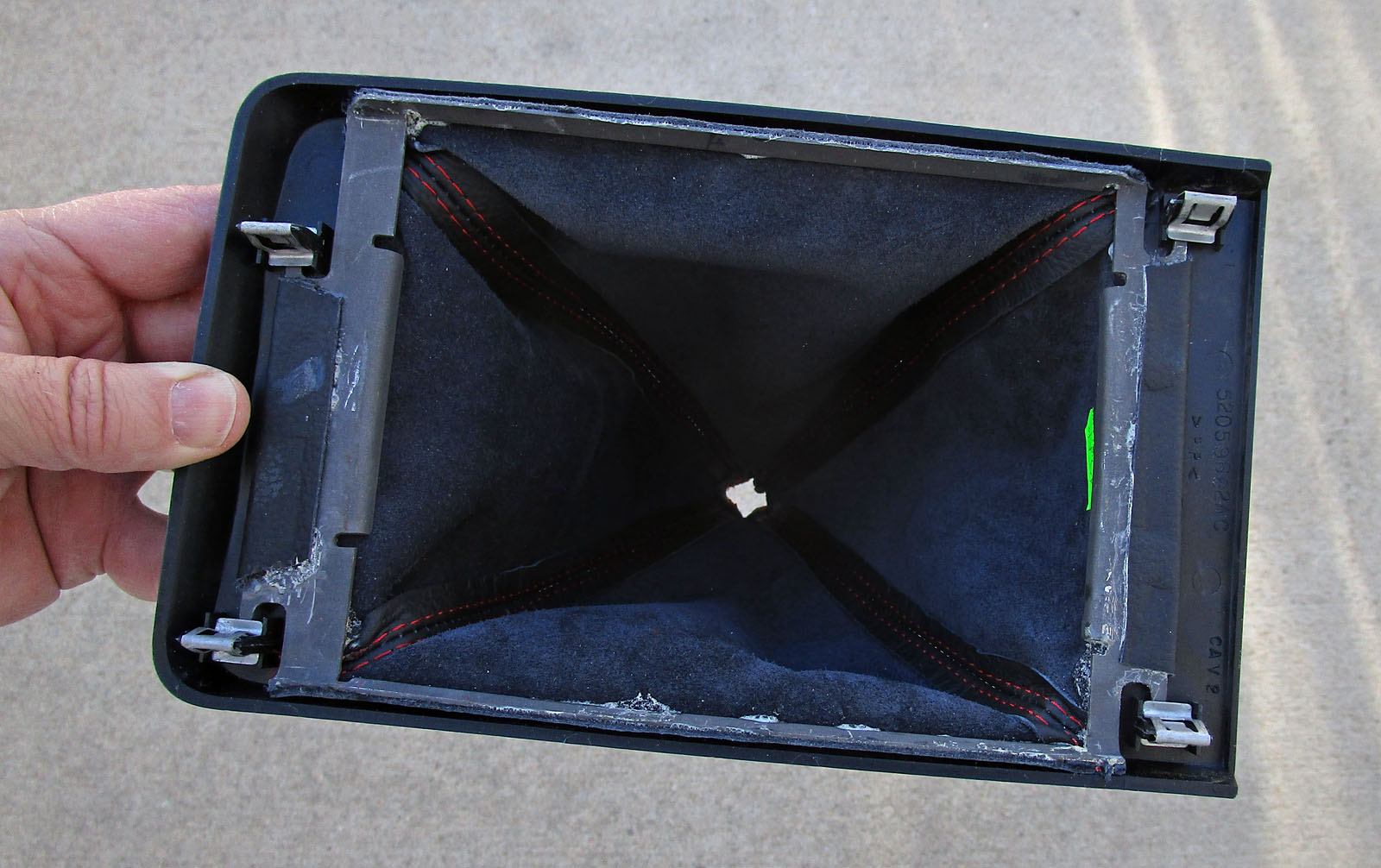

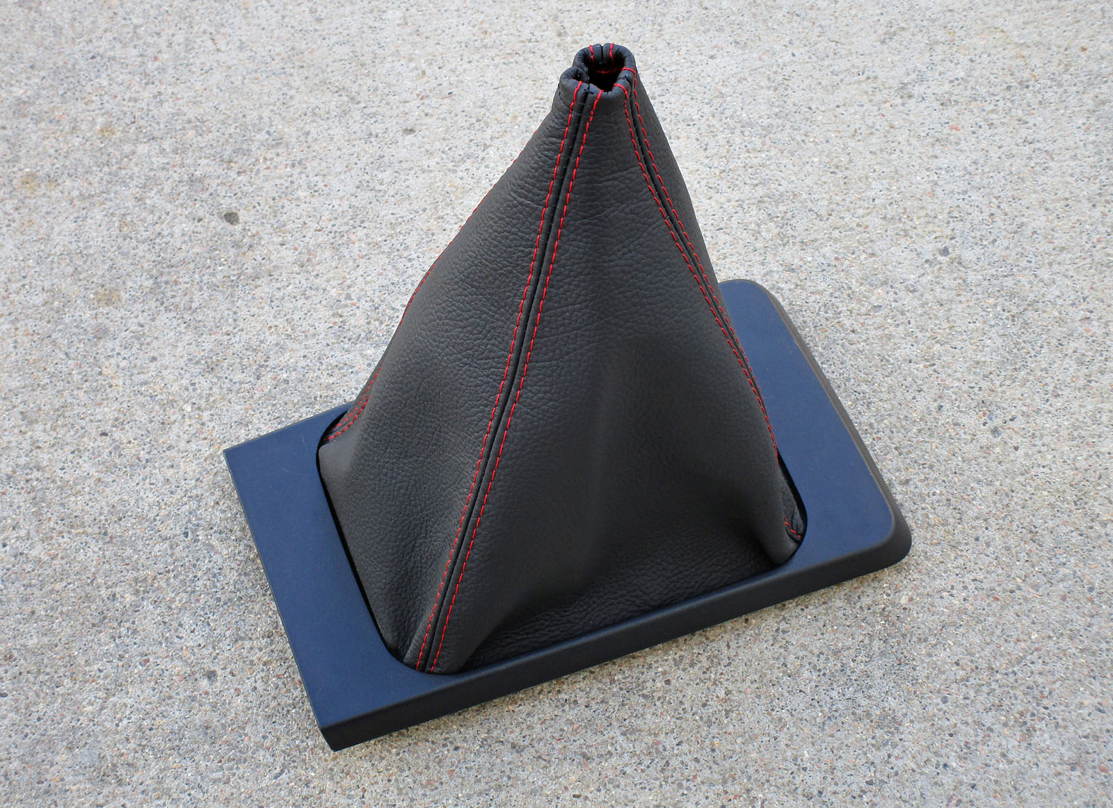

I placed the new boot with the metal frame into the plastic bezel and pressed the two clips back on. It was a tight fit.
I placed the assembly back on the shifter rod and clipped it down into place. The thick leather, along with the fat Gorilla glue, tried to keep the bezel from snapping down into place, but pressure back and forth did the trick. The bezel arches a little, but it did that with the OEM boot too.
After placing the knob on the stick, and tightening the lock nut, I had to heat the knob and use a small screwdriver again to get the shift pattern insert back in place.
I really like the new boot. It's a little stiffer than the original vinyl, and should last many years with an occasional wipe with leather conditioner/UV protector.

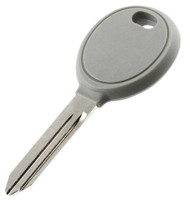

I had two keys for the SKIS (Sentry Key Immobilizer System), and needed one more. I've read that the older Chrysler keys with part number ending in AA worked fine, but the newer ones ending in BB are really hit or miss, some programmable and some not. There is a rumor of newer AC keys coming soon. And they cost a small fortune. The cheap knockoffs can be pretty hit or miss too. I tried one on eBay from Bartolete Keys for about $11. It has no markings whatsoever. I had it cut at a hardware store, but told the guy not to program it (he can't anyway). I followed the procedure in the Owner's Manual, and the Jeep successfully programmed the key. I don't know if that means this brand is good, or if I just got lucky, or if Bartolete will switch brands. How would we know?
ebay key

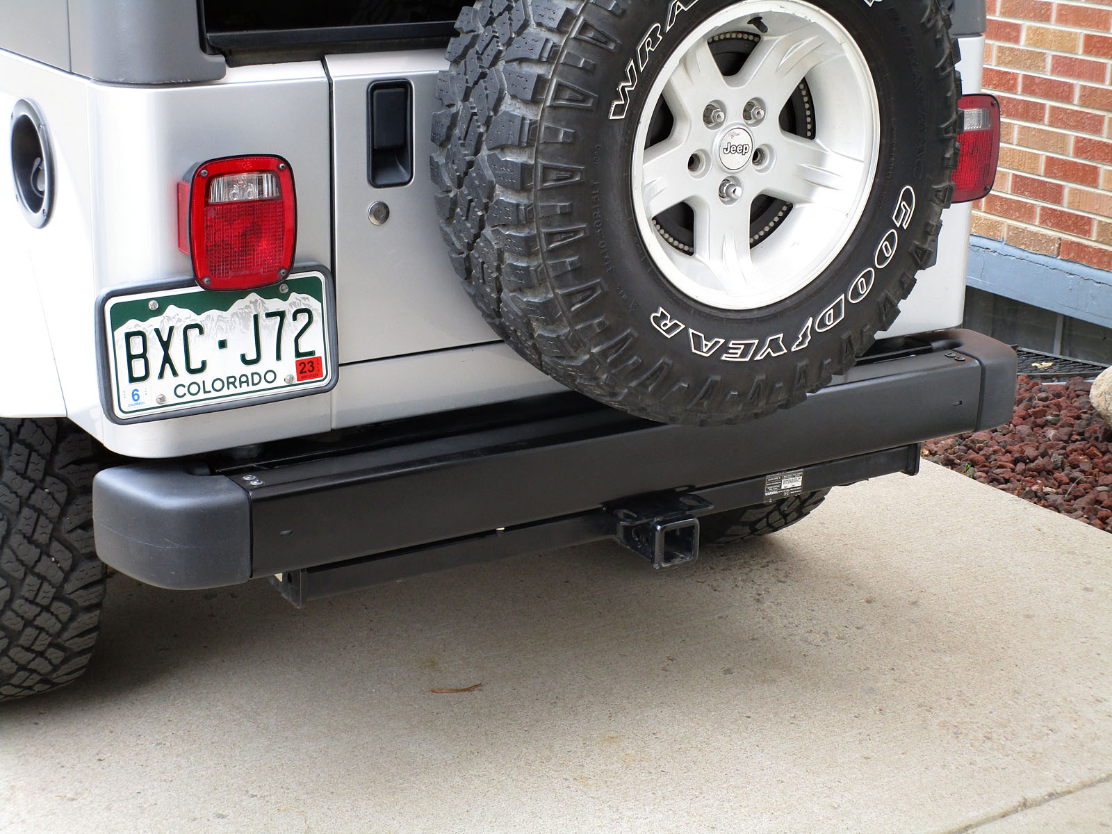

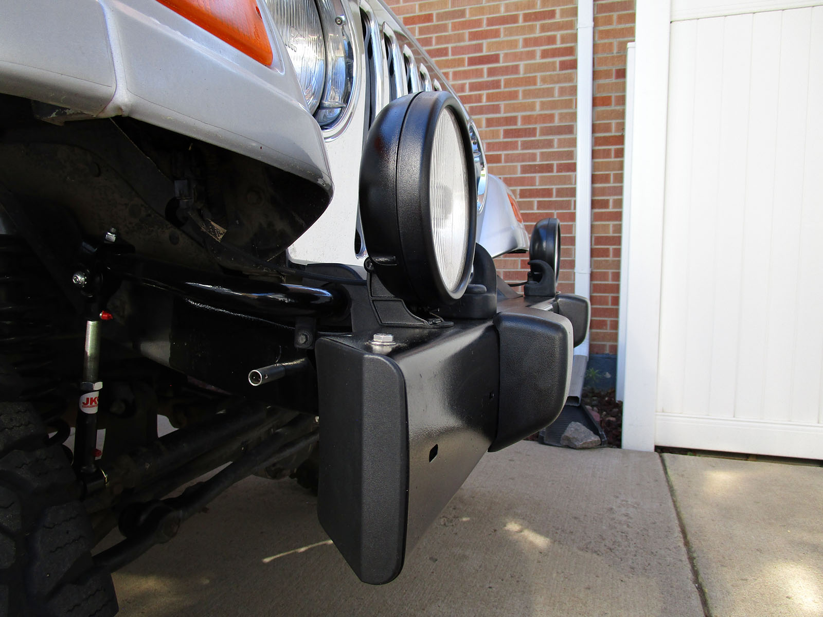

Painting Bumpers, Frame, Fog Lights

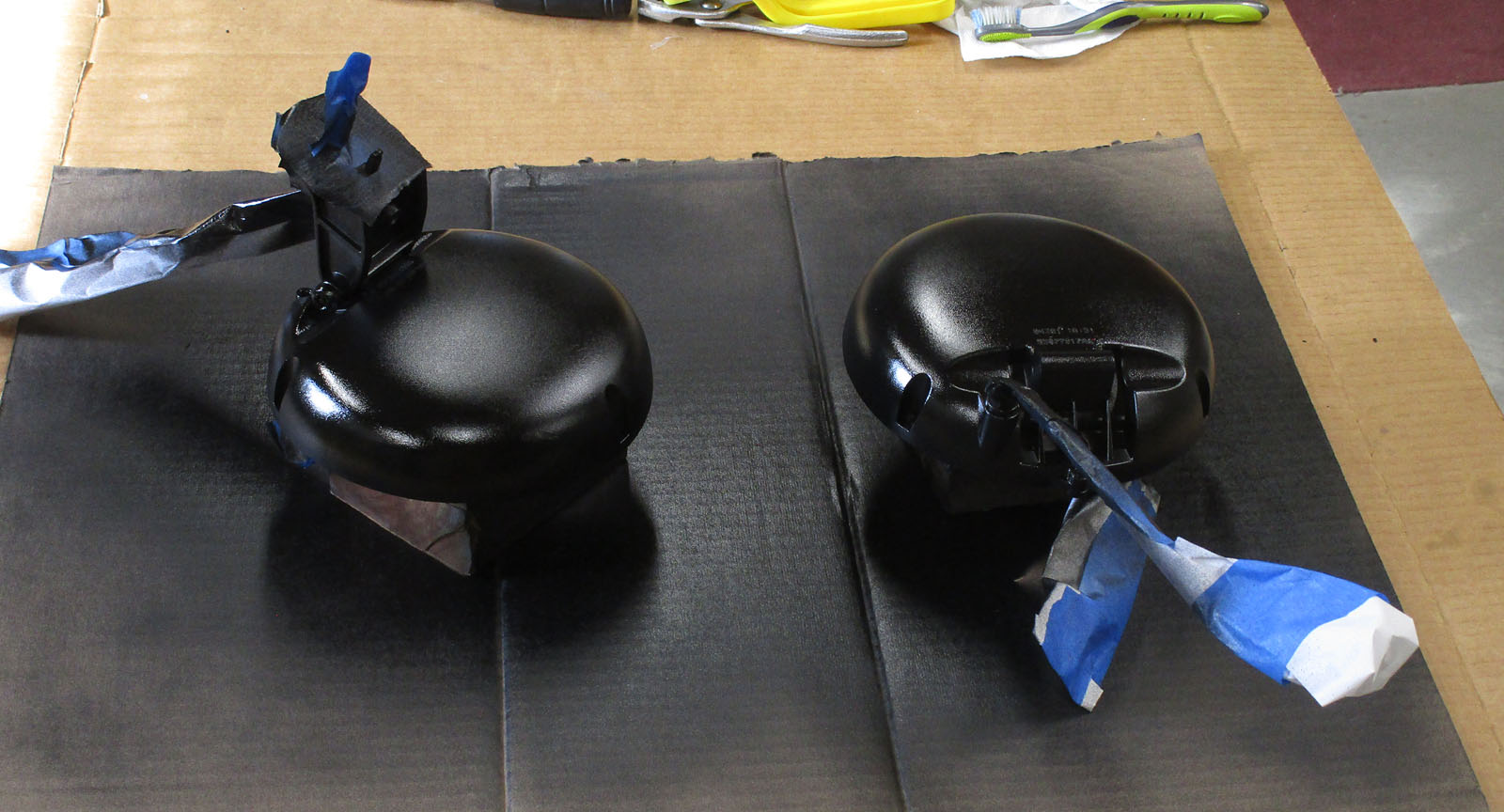

My bumpers and fog lights were faded to gray, over 17 years and 100K miles. The frame has minor surface rust on this garaged Colorado Jeep.

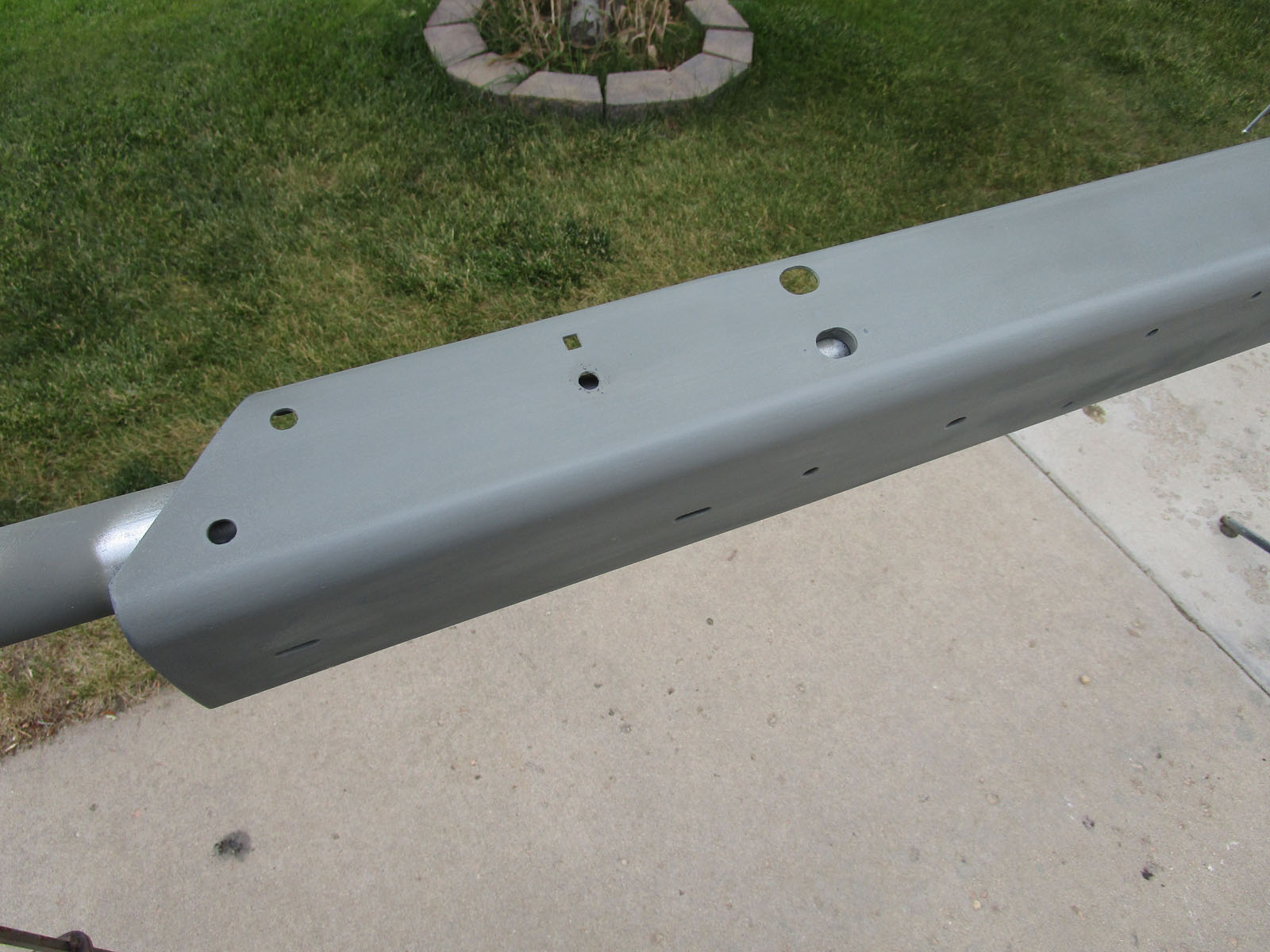

For the front and rear ends of the frame, I washed the mud and dirt and grease off. I used a hammer and chisel to pop off the worst of the weld spatter. I used paper towels with paint thinner to wipe it down, trying to get the last of the grease off (from the irritating JKS Quicker Disconnect Sway Links with those dumb no-ball zerks and semi-open joints which spew grease everywhere). I kept rubbing, and the towels kept coming off black. I decided the paint thinner was dissolving the factory paint, so I let it dry overnight. Yep, the next day, paint thinner on a paper towel came off clean. One wipe and it's done. I didn't realize paint thinner could soften old hard paint that quickly.
I sanded a few rusty spots lightly by hand, at 220 grit, trying to remove the rust but leave most of the paint, and just scuffing it up. Even the worst looking rust came off easily, since it was just thin surface stuff. Wiped it with 1 part white vinegar and 3 parts water, and rinsed (laying off the paint thinner).
I did not try to power sand the frame smooth for a great looking finish like @Irun gets. I'm OCD about some of this stuff, but maybe not enough. :) For the ends of the frame, I just used a 1/2" brush and Rust-Oleum Professional High Performance Protective Enamel in gloss black, which I had from another project. It goes on heavy but pretty smooth, and dries pretty hard within a few hours. I painted around where the bumpers are mounted, and along the sides a short distance. The rest of the frame will get similar treatment later.
I took a little more care with the bumpers, sanding them by hand with 220 grit, and cleaning similar to the frame. They're not perfectly smooth, but close. I used some of @Irun's paint recommendations. I sprayed several thin coats of Rust-Oleum Self Etching Primer (flat medium-dark gray-green), and then wet sanded it lightly with 400 grit. Next day I sprayed them with Rust-Oleum Professional High Performance Enamel, semi-gloss black. Fighting the weather, wind and sporadic sprinkles, I managed to get a few sags on one bumper and had to let it dry and then sand it smooth. Eventually the weather cleared, and I got several thin coats and a couple of slightly heavier ones on there without sags or runs.
I reinstalled the bumpers and hitch receiver. The receiver bolts didn't feel quite right, and I discovered that whoever had originally installed it used three wrong bolts out of four. Sheesh! I've been pulling a 3000 lb trailer with those sorry bolts. He had two UNC 7/16-14 bolts up into the crossmember, but those should have been M12 x 1.75, so they were a very loose, sloppy, slightly cross-threaded fit. And he used an M12 x 1.75 bolt into one of the flag nuts on the frame side rails, which should have been a UNC 1/2-13 bolt, so it cross-threaded badly. It damaged the bolt, but not the flag nut (soft bolt). I replaced all of the bolts with the correct size, in grade 8, and torqued them to spec.
When I looked at some pictures I had taken of the the front bumper, I noticed that I had installed the recovery hooks backward, with the pointy end forward. How embarrassing. I ran back out there and reversed them before anyone else noticed. I replaced the front milk jugs with Omix-Ada end caps, with stainless steel hardware.
Eventually, I want to replace the rear bumper and receiver with a Dirtworx, which weighs about the same as the combo I have now. So the milk jugs can stay for the time being.

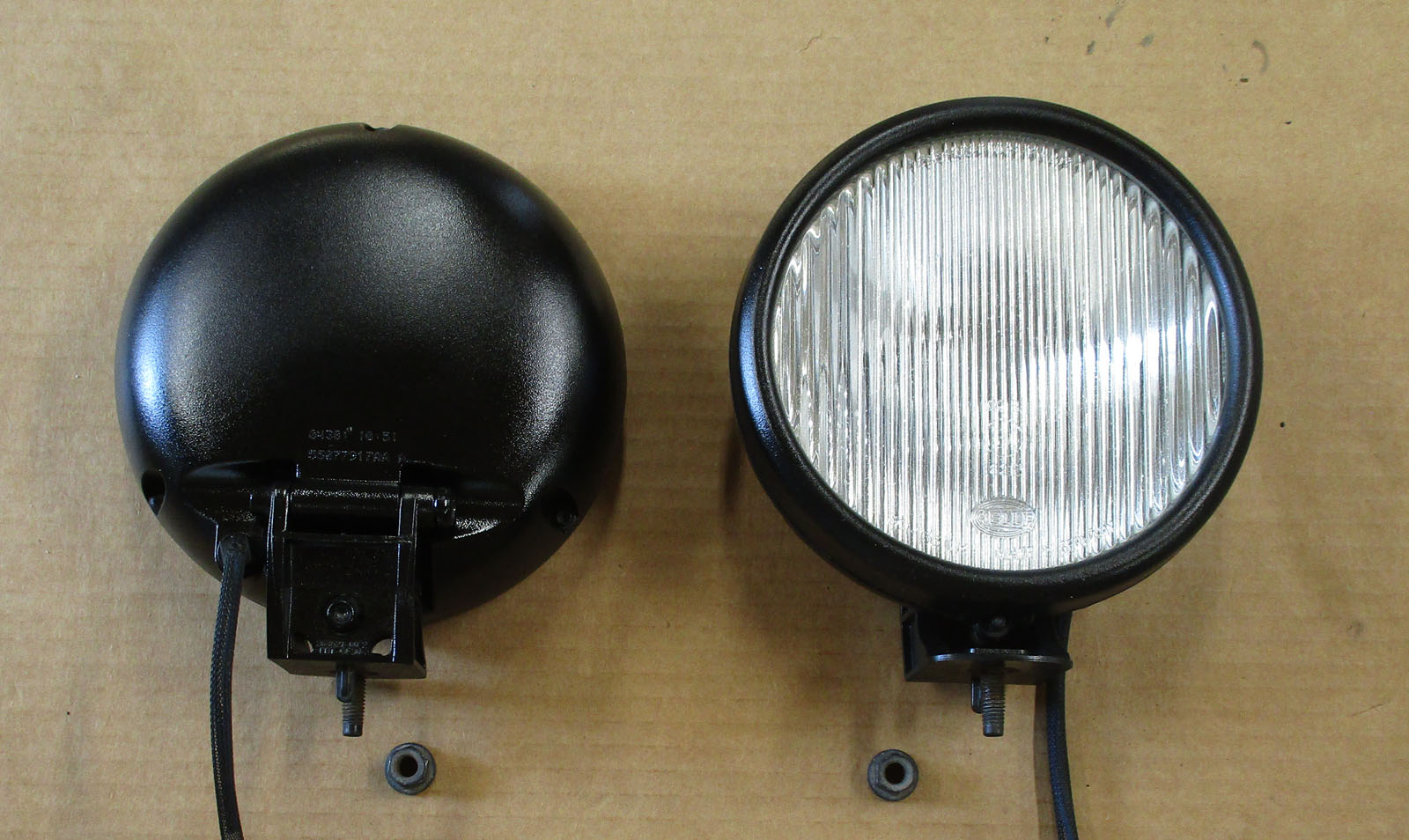

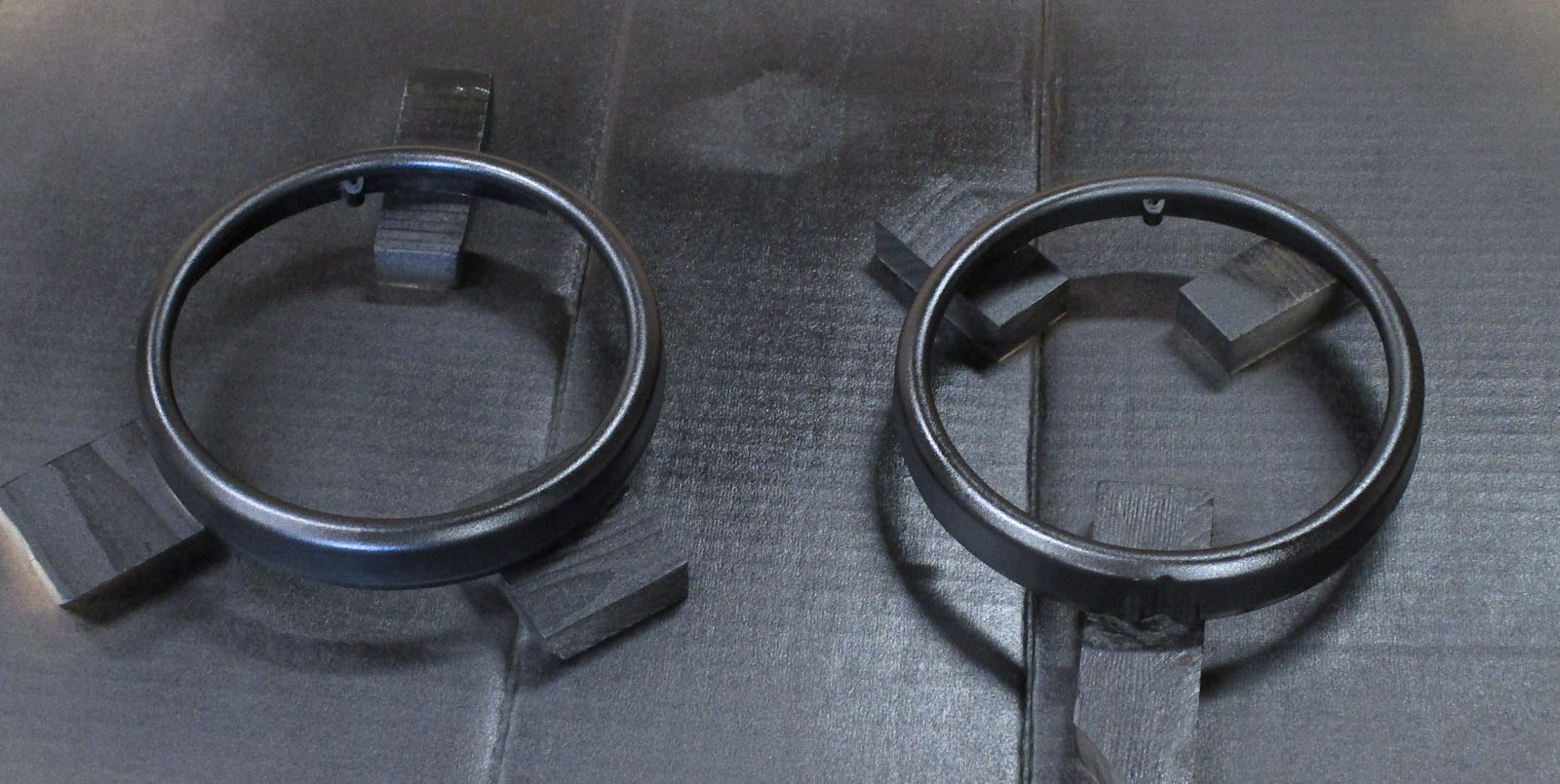

I cleaned and disassembled the fog lights, and scraped some rough spots, and lightly sanded with 100, 220, and 400 grit to clean and roughen the surface. I masked the bulb and wires and screw threads. I had planned to use the same paint as on the bumpers, but it's not marked as plastic-safe. The housings are plastic, or some fiberglass-like stuff. So I used Rust-Oleum Painters Touch 2X Ultra Cover Paint + Primer, in gloss black, because it's plastic-safe. Several thin coats and they look pretty good, with a few road scars from 100K miles on highways and trails. They dried hard in a few hours, surprisingly. Paint on plastic can take much longer, but maybe this paint-safe stuff fixes that. I cleaned the bulbs with alcohol to remove any fingerprints, and reassembled everything. I think they look pretty good.

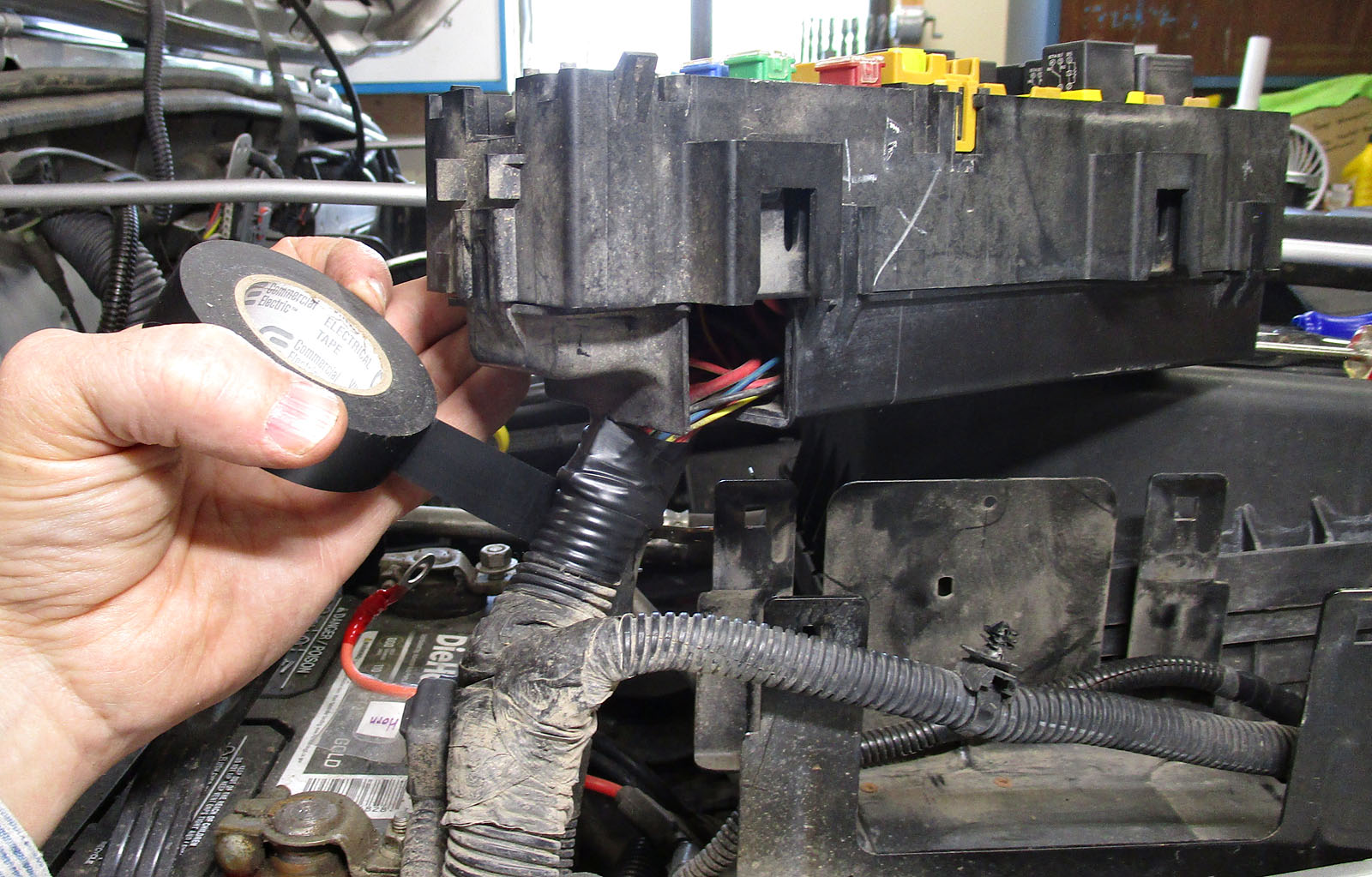

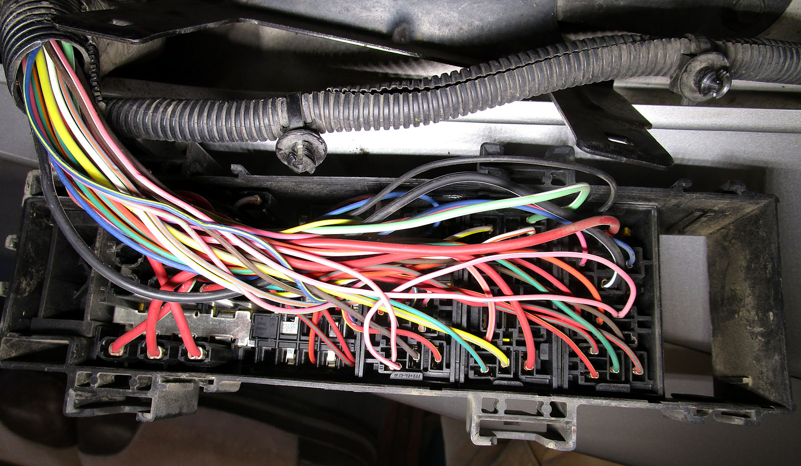

My OBDII system reported an Emissions Monitor which had not completed. The CEL (check engine light) did not come on, and there were no DTCs (Diagnostic Trouble Codes). But with the key on, not running, after 15 seconds the CEL would would flash, indicating an incomplete Monitor. My OBDII reader (an OBDLink SX with OBDwiz software running on a Windoze laptop) said that the Oxygen Sensor Heater monitor was incomplete. No amount of running drive cycles, general or specific, would get it to clear. Replacing all four oxygen sensors with new NTK/NGK ones did not help.
Colorado, aka Colofornia, changed the emission test this year to require ALL Monitors to be complete. Even though all emissions equipment is working perfectly, and it can pass a sniff test with wide margins, it fails because Chrysler (and California) screwed it up.
Chrysler issued TSB 25-001-07 (and updated it several times, currently TSB 25-005-13A) which describes how to fix this. The latest version says "The Catalyst Monitor, Oxygen Sensor Monitor, and Oxygen Sensor Heater Monitors may indicate "Not Ready" even if the monitor is operating correctly and determining pass/fail results." It shows how to modify a couple of wires in the PDC (Power Distribution Center) under the hood. It was issued as an Extended Warranty Bulletin for dealers to perform, but I don't suppose they would still honor it. It's easy to do yourself.

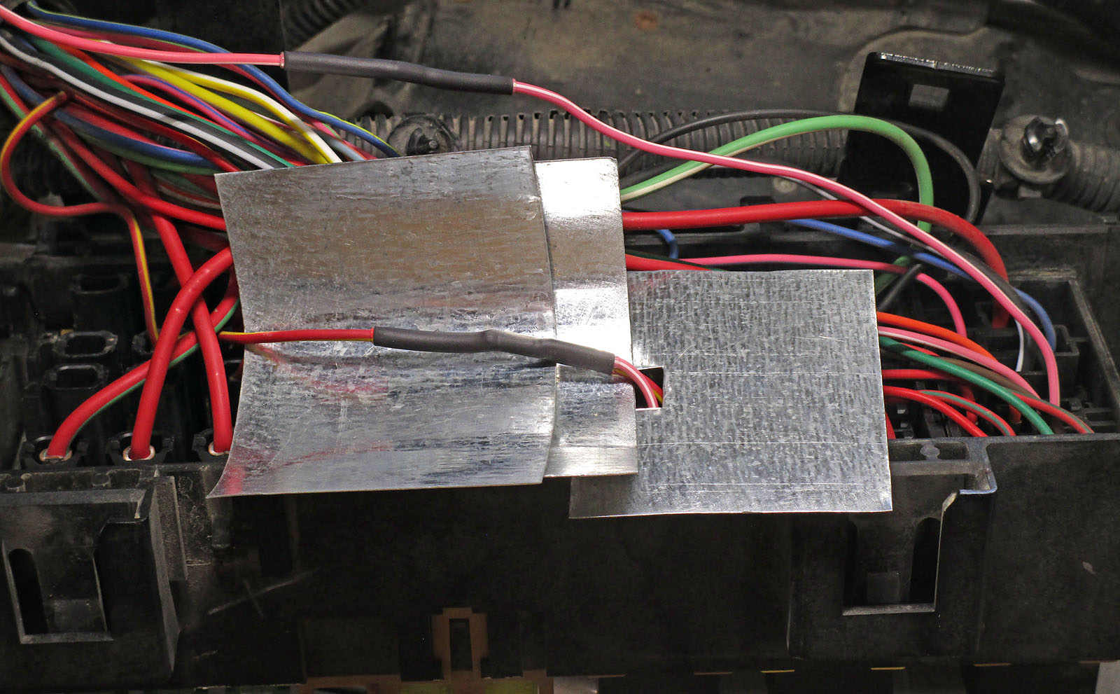

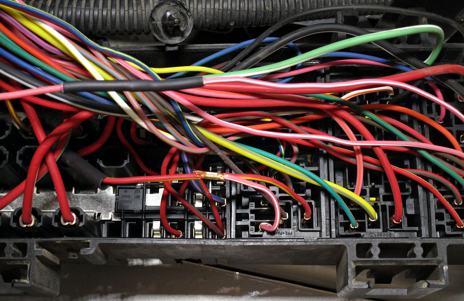

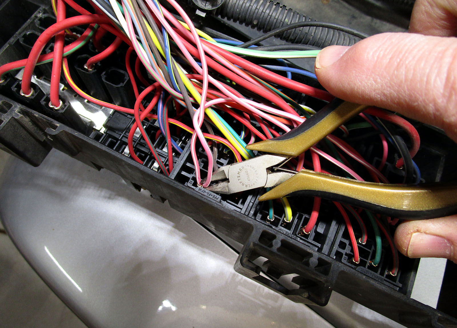

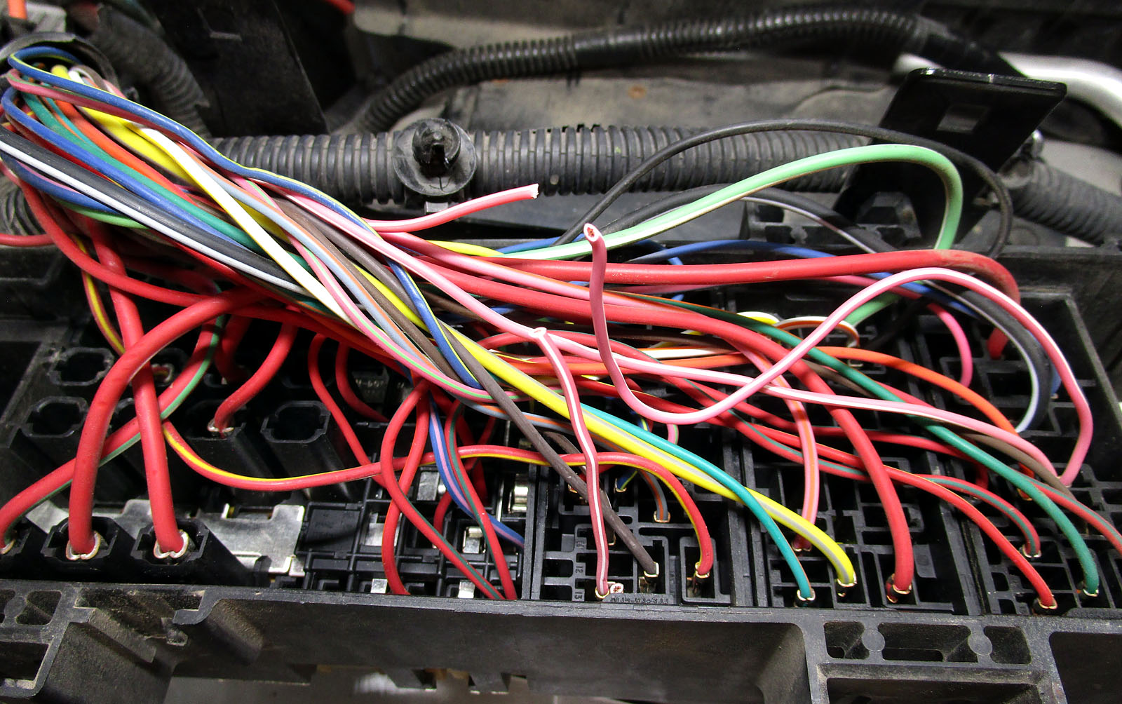

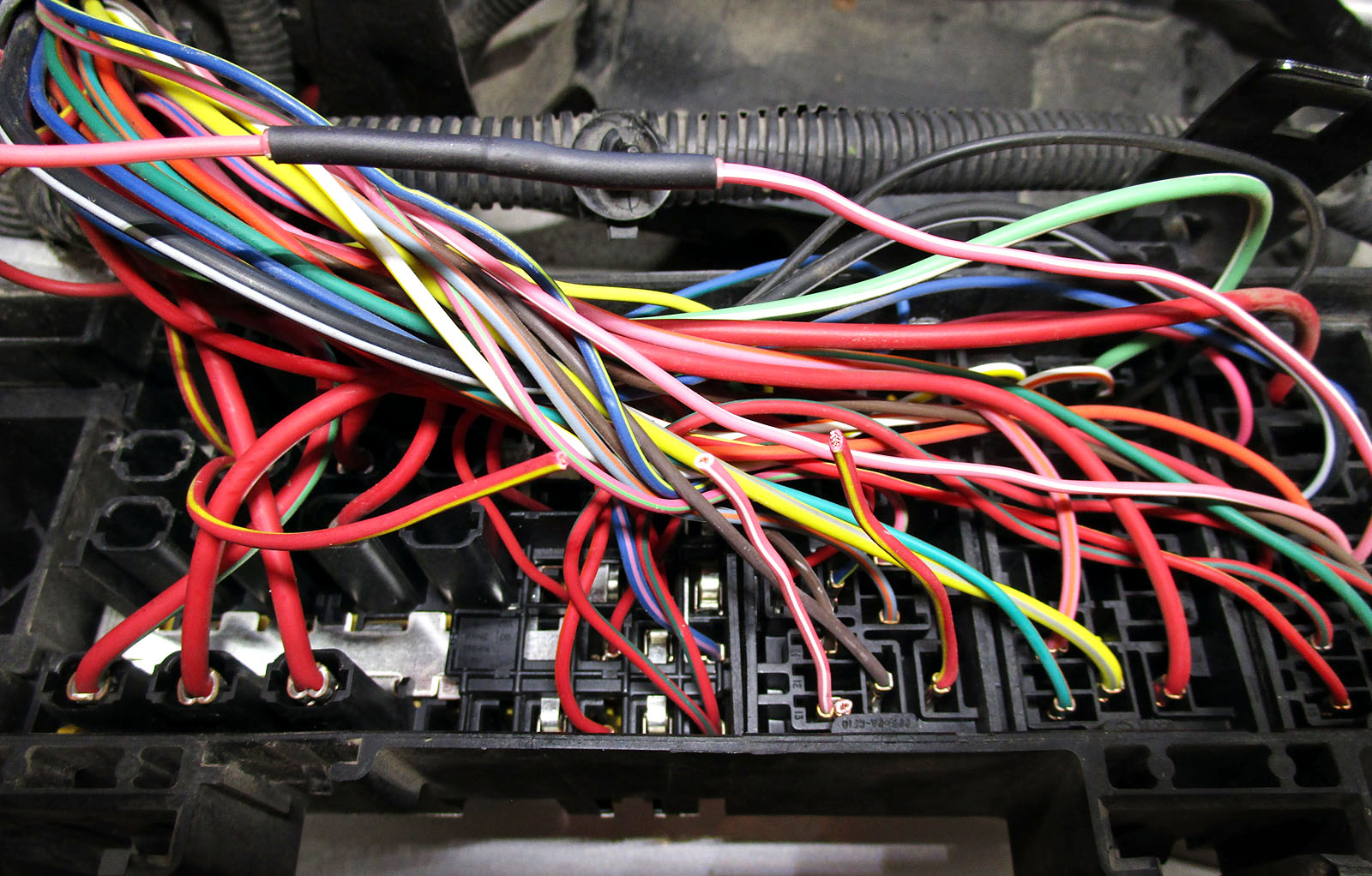

You have to pull the PDC out of its bracket, remove the bottom cover, and flip it over. There are a couple of wires to cut and splice. The wire bundle is crowded and tight, so it takes some prying and pulling to get enough slack on the wires to work with them. Once you make the cuts, you can un-thread them from the bundle and get a little more working room.
After blowing out the dust and wiping the wires with a cloth, I carefully identified and traced the target wires.

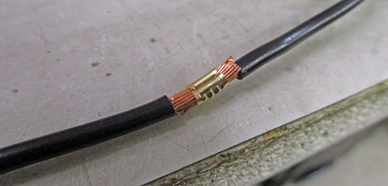

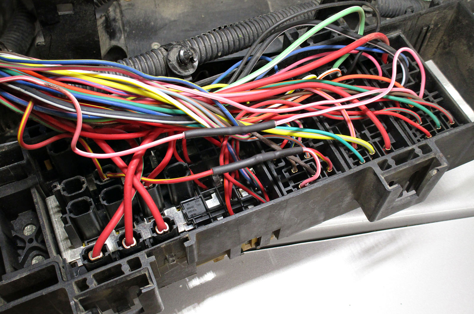

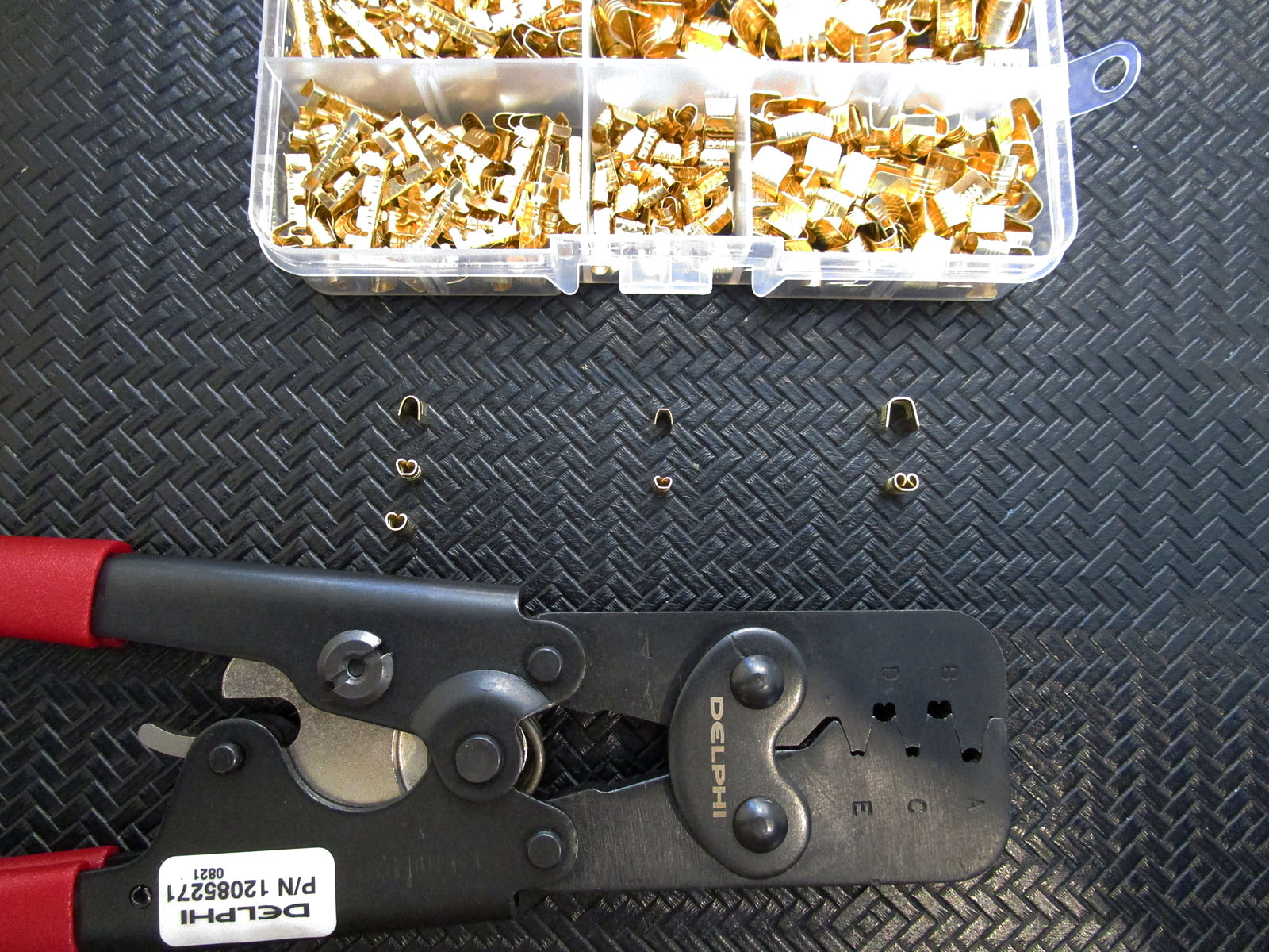

I made the cuts, pulled the wires loose for working room, and made the splices with brass U-clips and crimper.
The crimps looked like these (from a different project).
The TSB says to crimp the wires, and then solder them. Discussing soldered wiring on a forum can start a religious war. I'll just say I crimped the wires, did not solder, and used self-sealing heat shrink tube on them (the stuff with the hot-melt glue inside).
I didn't want to melt any other wires, or the PDC case, so I used some sheet metal flashing as a shield while heat-shrinking the splices.
All done.
I put everything back together, re-taping the sleeving to the PDC which I had removed to get some wire slack.
I started the engine, ran it for a couple of minutes, and shut it off. A little later, I turned the key on without starting it, and the CEL remained steady, no flashing after 15 seconds. Wow, I didn't expect it to work that fast! I verified it with my OBDII reader. Yes, all of the Monitors are completed, including the Oxygen Sensor Heater monitor.
I looked over the 2005 FSM schematics to see what this change does. You have to look in several places to get the whole picture, particularly wiring diagram 8W-11-8 and 8W-30-2. This Chrysler mod boils down to one thing. It rewires the ASD (Automatic Shut Down) Relay to get power to the activation coil from the battery instead of from the ignition switch. That allows the relay to stay activated after the key is shut off. I'm guessing that the PCM (Powertrain Control Module, the computer) is trying to do something as the engine shuts down, and gets cut off before it finishes. Lousy firmware. After all, 98% of all of the problems in the world boil down to bad software or firmware written by some chimpanzee. This change allows it to finish after power is cut to the engine, and then the PCM shuts off the ASD relay from the other end of the activation coil. You can feel and hear the ASD relay wait for a couple of seconds after the key is switched off before deactivating. Before the mod, it cut off instantly.

Emission Monitor Fix
All done.
