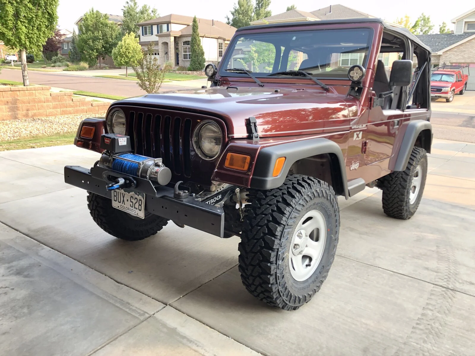

My TJ has no AC (for consideration of whatever that weighs) and I run a Warn M8000 with synthetic line on the stock bumper with a RC winch plate. I have half doors and soft top, a 40lb aftermarket rear bumper, rear seat, and a 31" tire on a stock steel wheel on the OEM tire carrier. With this setup, I elected to go with OME heavy front and light rear springs. Realistically, I probably could have gone with light springs in the front as well, but with the heavy front / light rear combination, the rear already sits 1.5" - 1.75" higher in the rear. For what it's worth, I'm running the lighter valved OME shocks on each end. I believe a hardtop would likely bring down the rear 0.75" or so, leaving a slight rake (which would be perfect to my eye).
Here's a pic on my sloped driveway showing how it sits. (Sorry for the driveway pic, I'm still breaking in gears so no action shots yet.)
Your jeep looks great. Smart upgrades which is what I am trying to go for. So if I am reading your reply correctly, if I went all light it would probably level it out and not have much rake?

Thanks a lot, I appreciate it. To answer your question, no. I'm running heavy front, light rear, and I'm 1.5" - 1.75" high in the rear. If you go with light front, there will probably be even more of a difference between the front and rear.

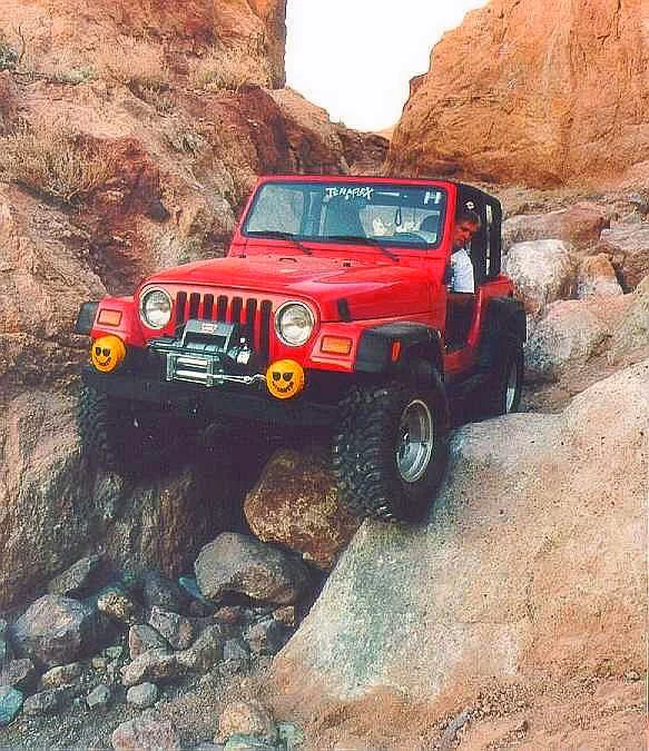

My Teraflex shit turned to shit, I stopped wanting anything to do with them and their stuff.
As you can see from my Teraflex windshield decal on my previous TJ, I did like them at one time. Damn, I still had dark hair back then.
