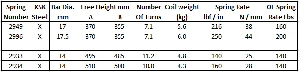

I have not found any good description of the springs or their differences. I did find a document that explains this info but it is Greek to me.

In principle, your trying to understand spring rate as it relates to weight, do that in the end you get desired lift.
A 200lb spring rate means that for each additional 200lbs the springs will compress 1”. This is for a linear spring.
You need to know the weight you are trying to support at a given height, which you seem to know. Front is easier bc it doesn’t vary with gear or passengers. The rear could fluctuate, so you have to decide what weight you want to compensate for (loaded, unloaded or a compromise). Choose an appropriate spring which will give you ~4” of total lift. A 3” spring compressed 1” by weight is only 2”, plus your spacer or spring relocator adds 1 5/8”, plus your 1/2” body lift for a total of 4 1/8” Lift. If you suspect more weight choose higher spring rates or longer springs. You get the idea

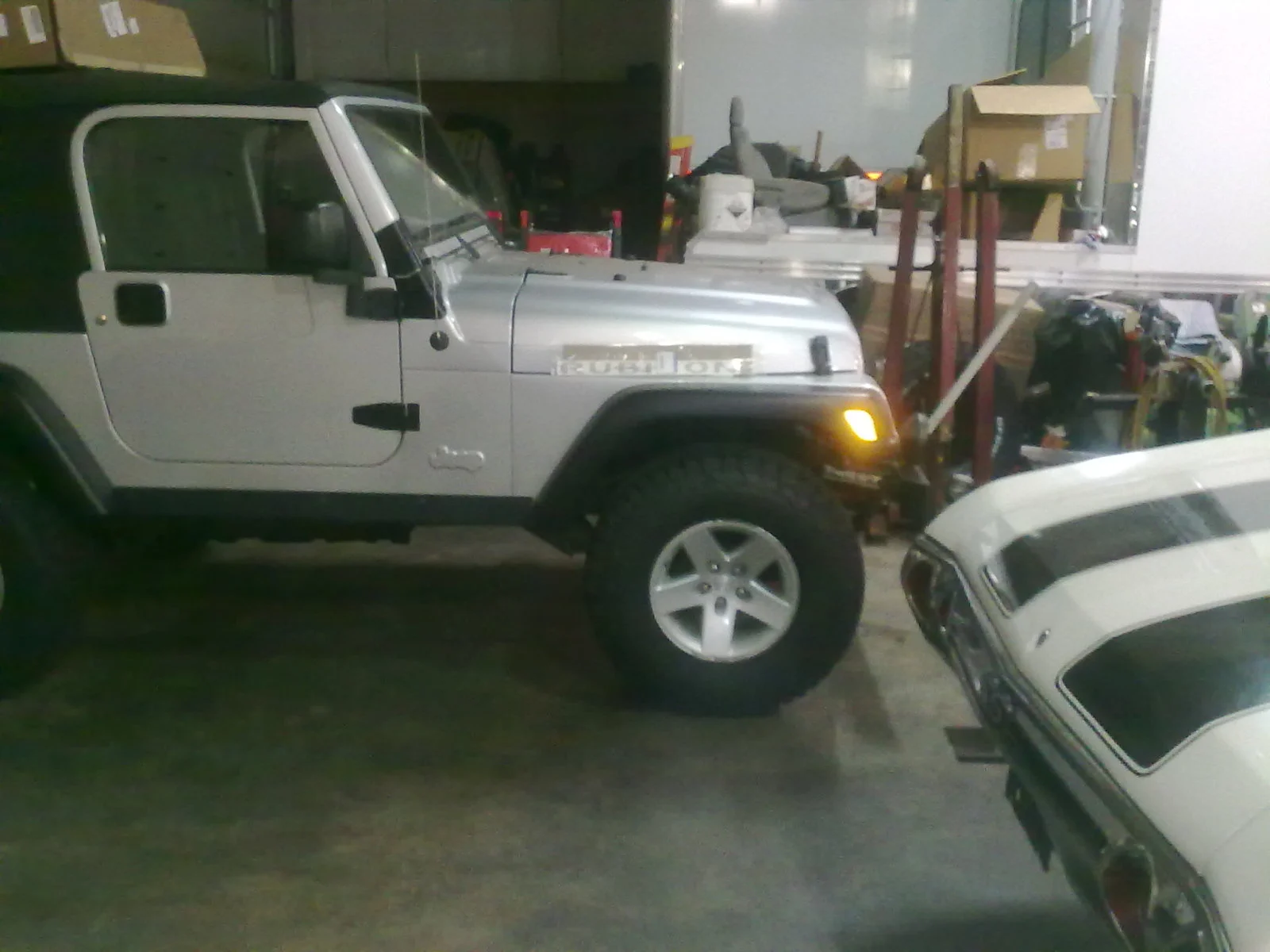

FWIW, I just put an OME 2" lift on my Rubi and am running so called 33's, which are actually 32.8 I believe. I have plenty of room, but I do have the HD springs which are so stiff I can climb on my bumper and it hardly moves. Very stiff springs, so not the best ride. I don't have any gear being carried however, so I am going light which makes more sense to me. The lighter the better, IMHO. Never understood wanting to keep adding so much weight.
Reactions: ac_
I have plenty of room, but I do have the HD springs which are so stiff I can climb on my bumper and it hardly moves. Very stiff springs, so not the best ride..

Oh sorry, the OME shocks. I panted them black because I don't like yellow. lol They don't move much.
I do want to point out if you are going to off road like Jerry B, then I would yield to his advice. My Rubi won't see the trails he is hitting, so for me my setup is okay.
Here is a picture of the front.

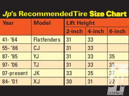

As above, 2" is not enough for 33" tires unless you never take it offroad or drive over dips/bumps in the road. It may look like you have enough clearance but it's not. At a minimum I'd at least add a 1" body lift to give your tires more clearance.
4" is the most commonly recommended lift height for 33's, I'd go nothing less than 3" for a Jeep that only sees smooth paved streets.
There are many charts like the below, and all recommend 4" for that size tire...
