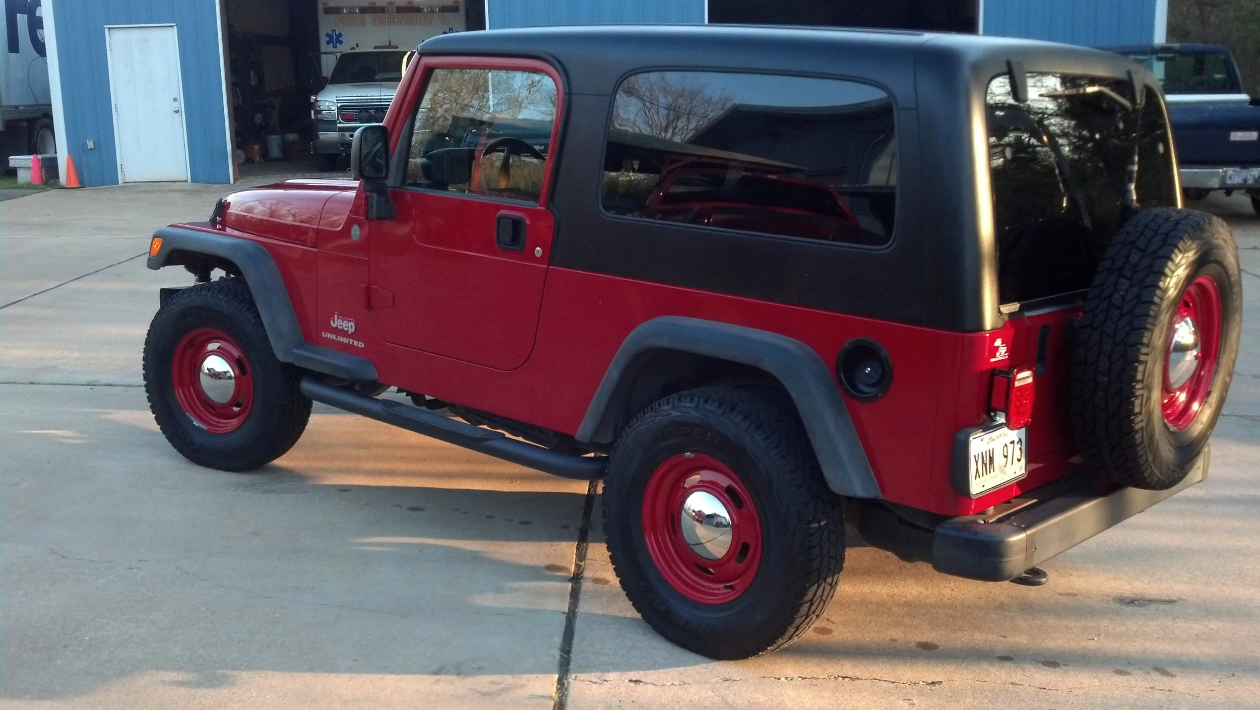

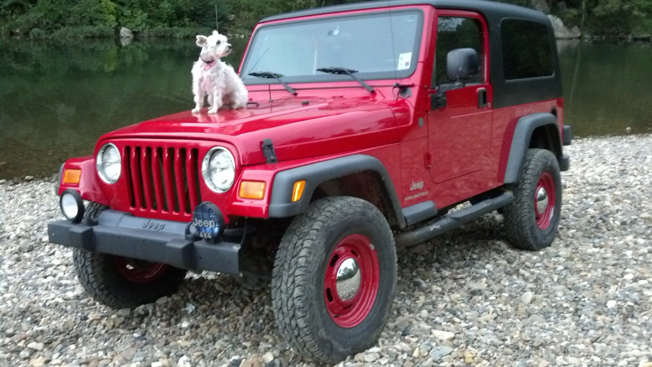

This is ours when I put OME 2 inch springs all around .
I removed the OME rear springs and reinstalled the factory rear springs with a 1 inch spacer .
That was 11 years ago . I've changed it some since then .
Bottom picture is OME springs all around .

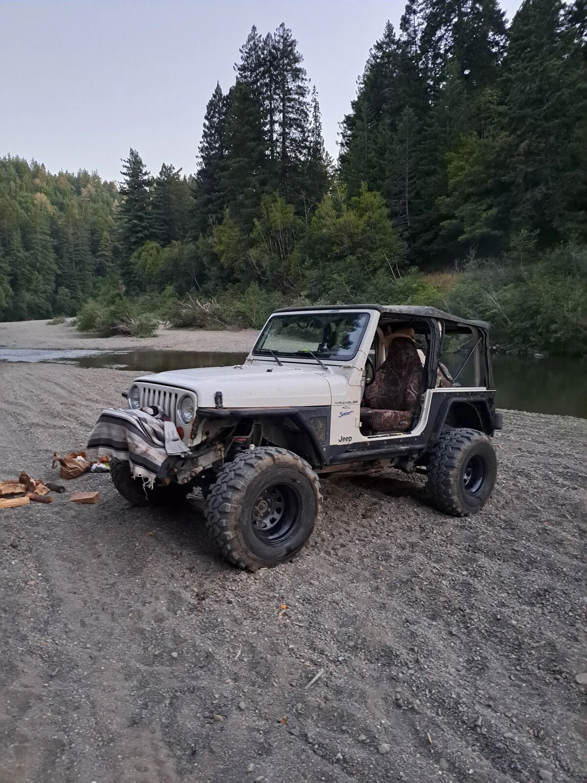

I know it isn't an lj but it's a heavy rig with steel armor

Keep in mind she is about as heavy as tj's get. That's a lot of 1/4" steel!

I have 2932 front with 1 inch spacer . Fronts have been on 11 years . I added the 1 inch spacer when I put the rear OME springs in recently .
Rear springs are 2949 .
I bought my lift 11 years ago .
Front springs say 932
Rear springs say 949
Tires are 33 inches tall.
