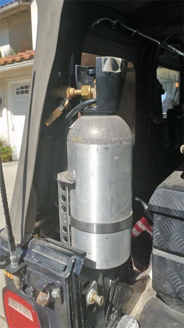

There's no need to remove the CO2 tank from the Jeep to use it. Mine stays put.
