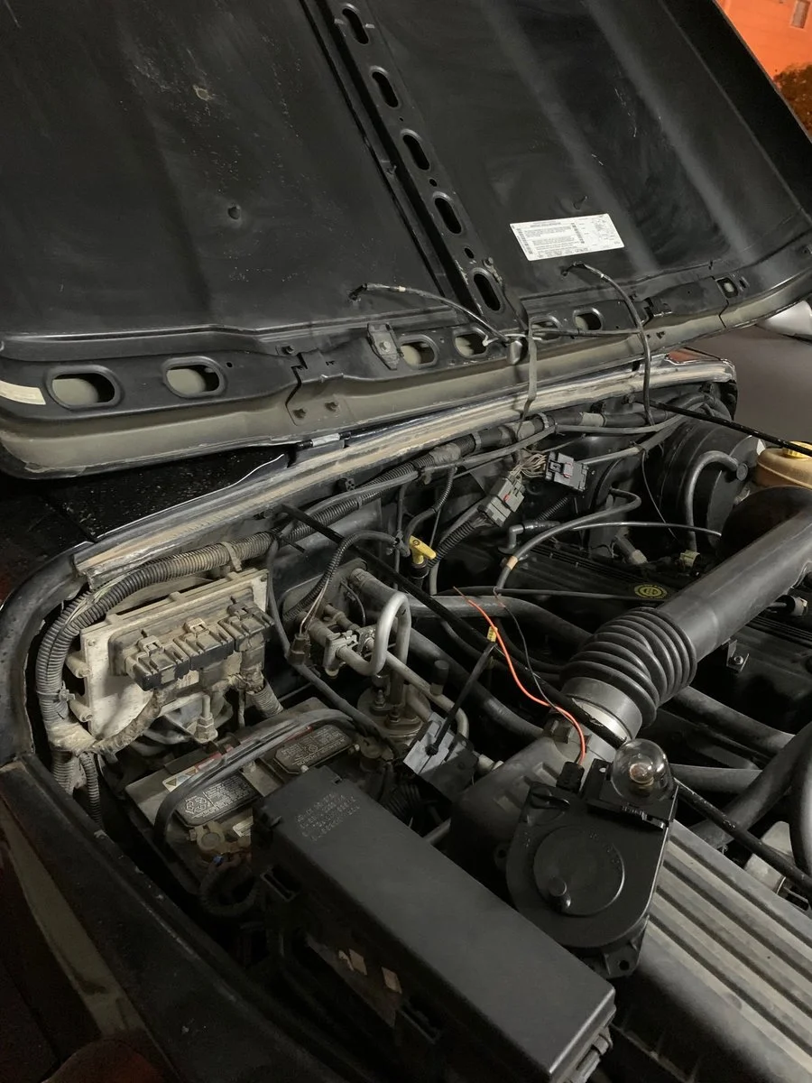

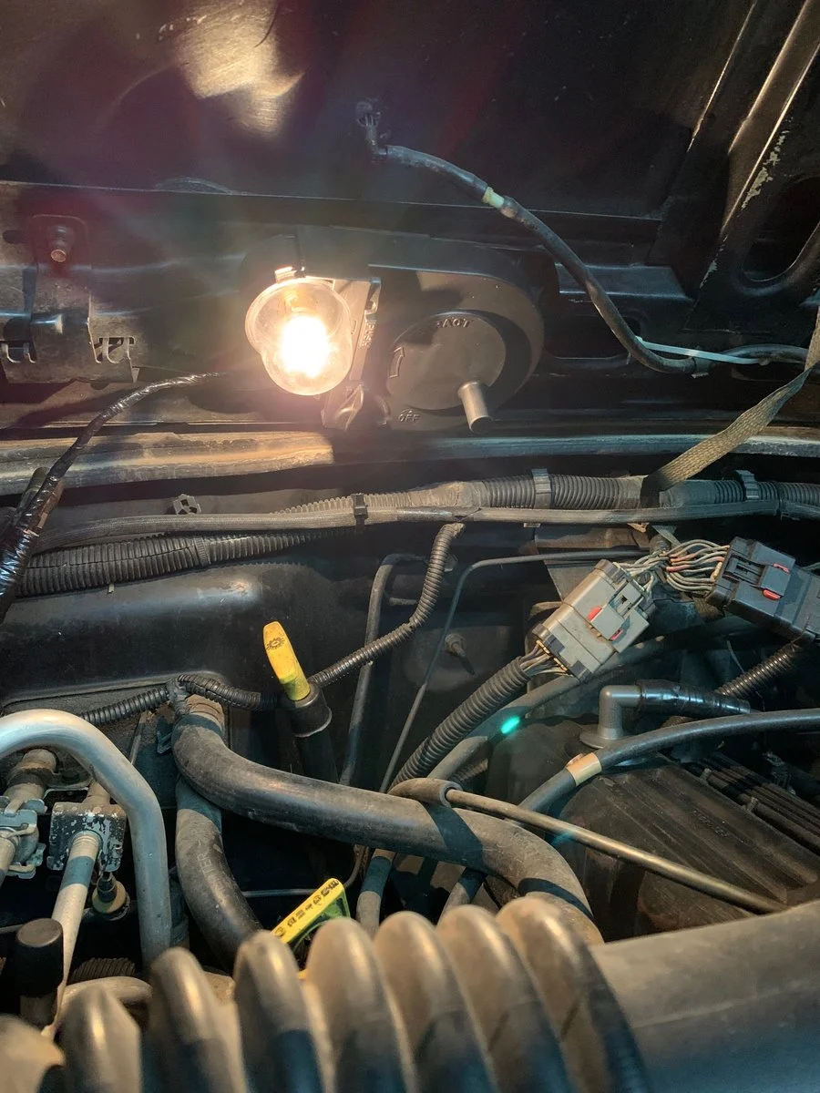

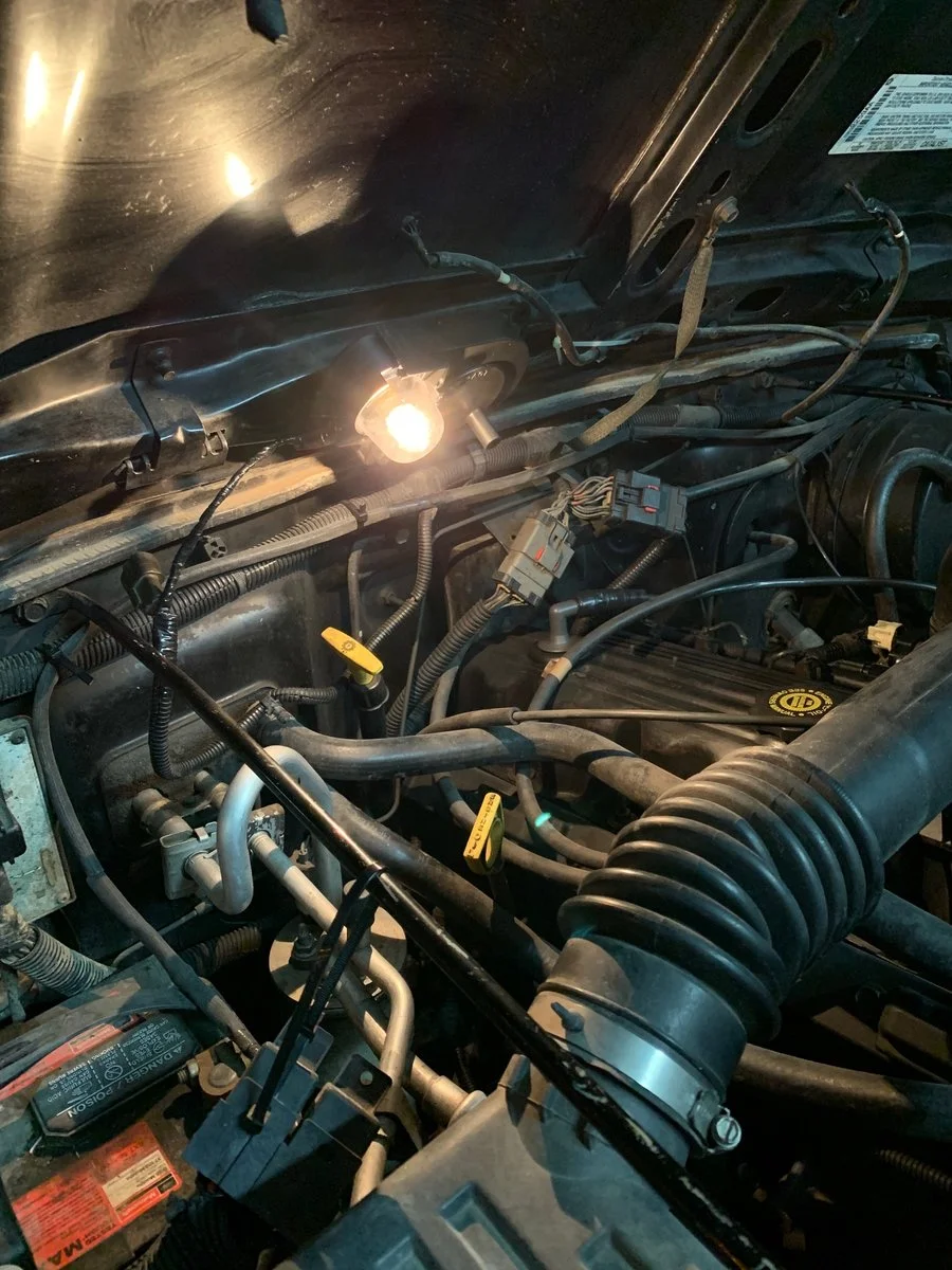

Adding 90's GM/Chevy truck underhood light to the TJ was a great Mod, I do admit.
Here is the topic that I followed, and my photos attached:
https://wranglertjforum.com/threads/upgrading-the-underhood-light.8393/page-3#post-451297
Cheers!

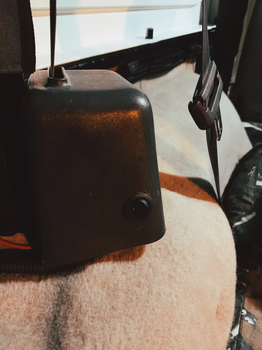

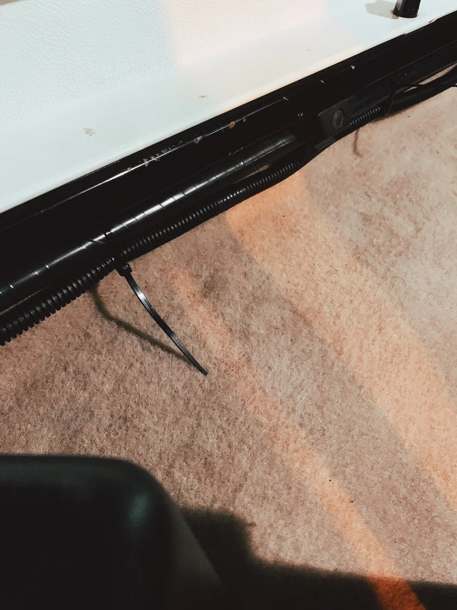

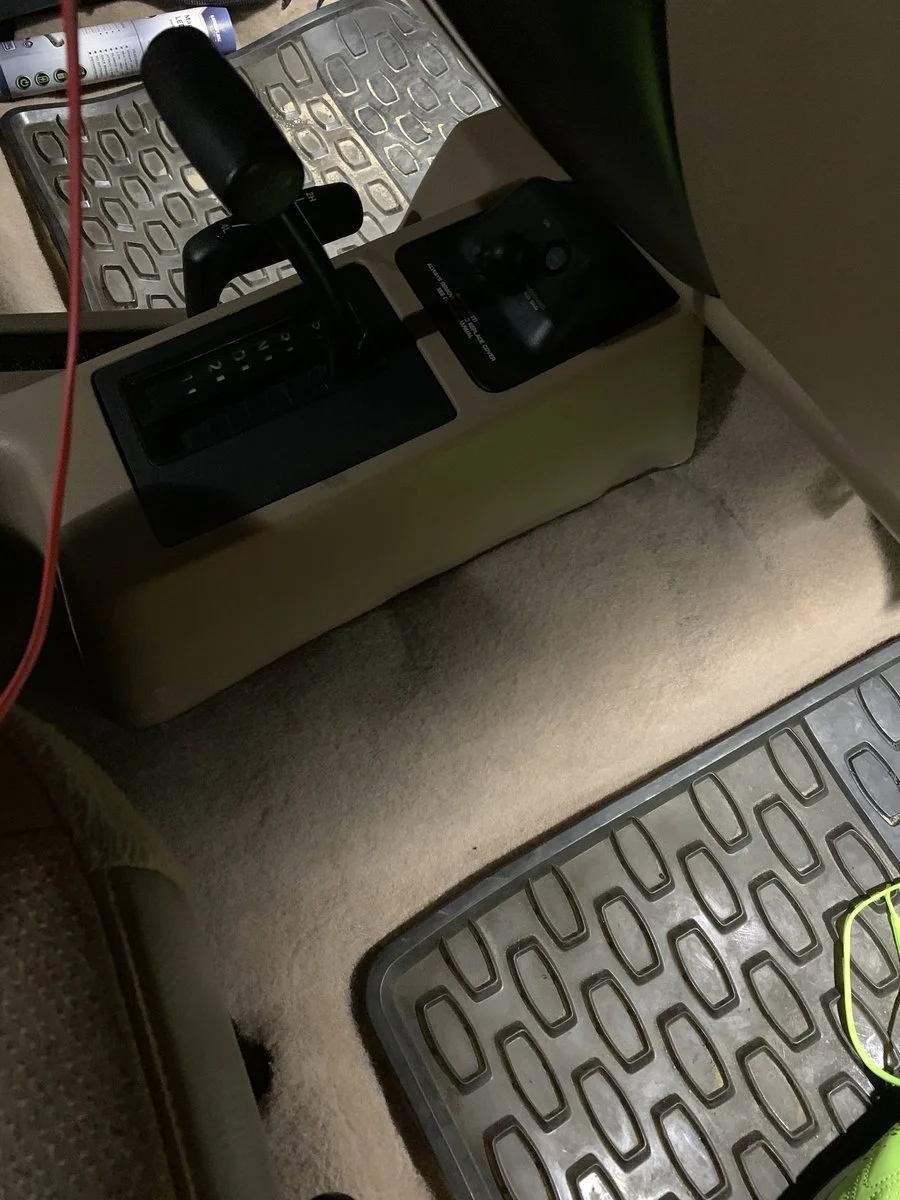

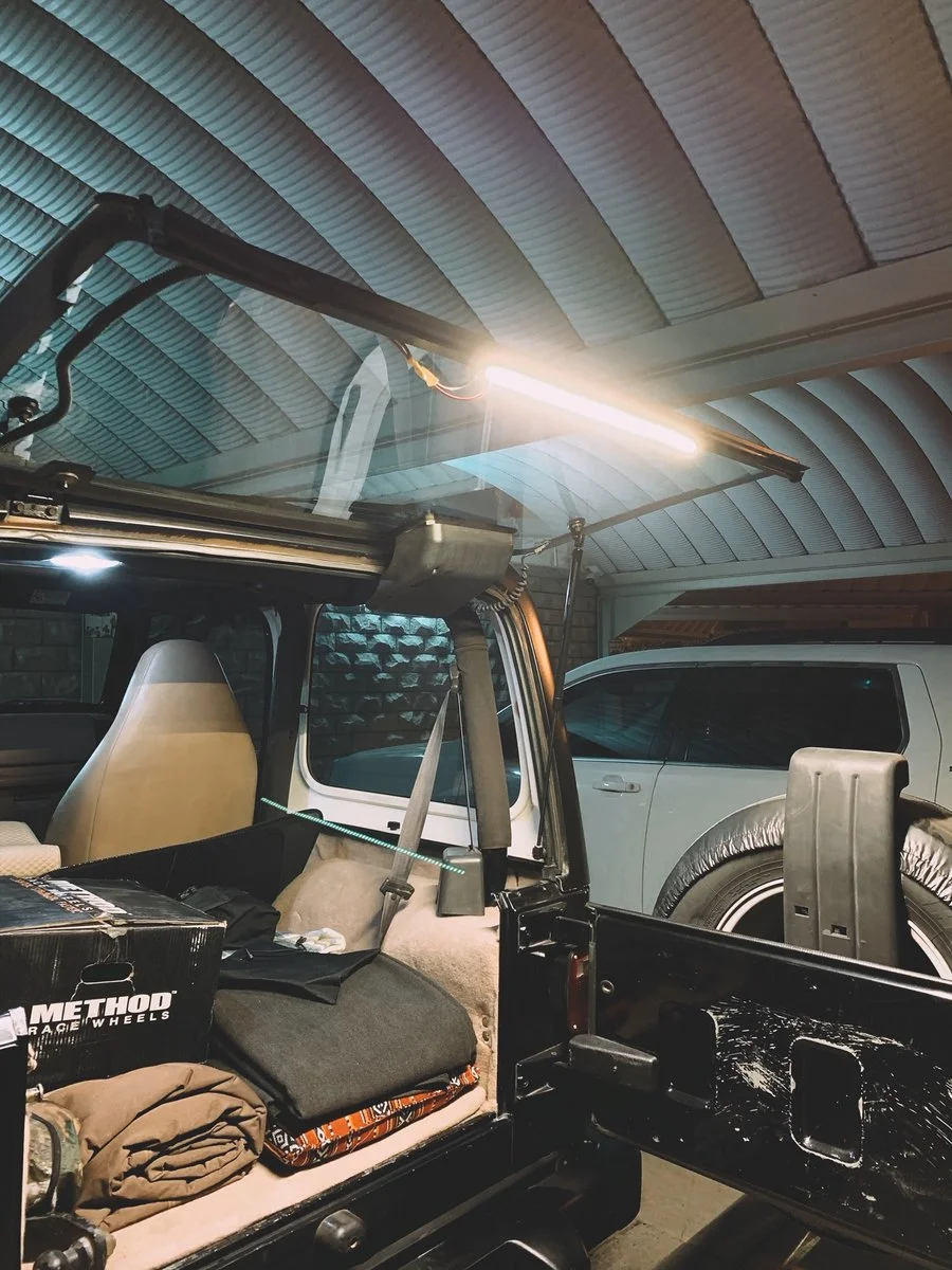

One of the things that makes me fall in love, more, with my TJ is the ability to find tons of ideas and accessories that I can use, or enhance to fit my needs.
I love winter, and I do camp a lot.
And this mod I am going to share right now,
I worked on it last night and I find it worthy..
For many reasons.

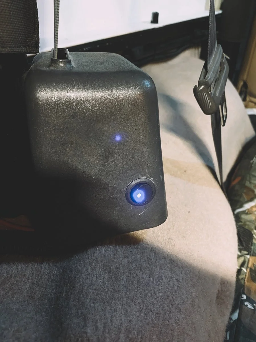

I used for this mod:
1- 1.5mm wiring
2- LED - strip type - sticks with 3M (costs around $3) 12V
3- Fuse 10A
4- Switch with Light indicator (couldn't find 10A so I used this one 20A)
5- 1:30 hr
Yes, IT IS BRIGHT.

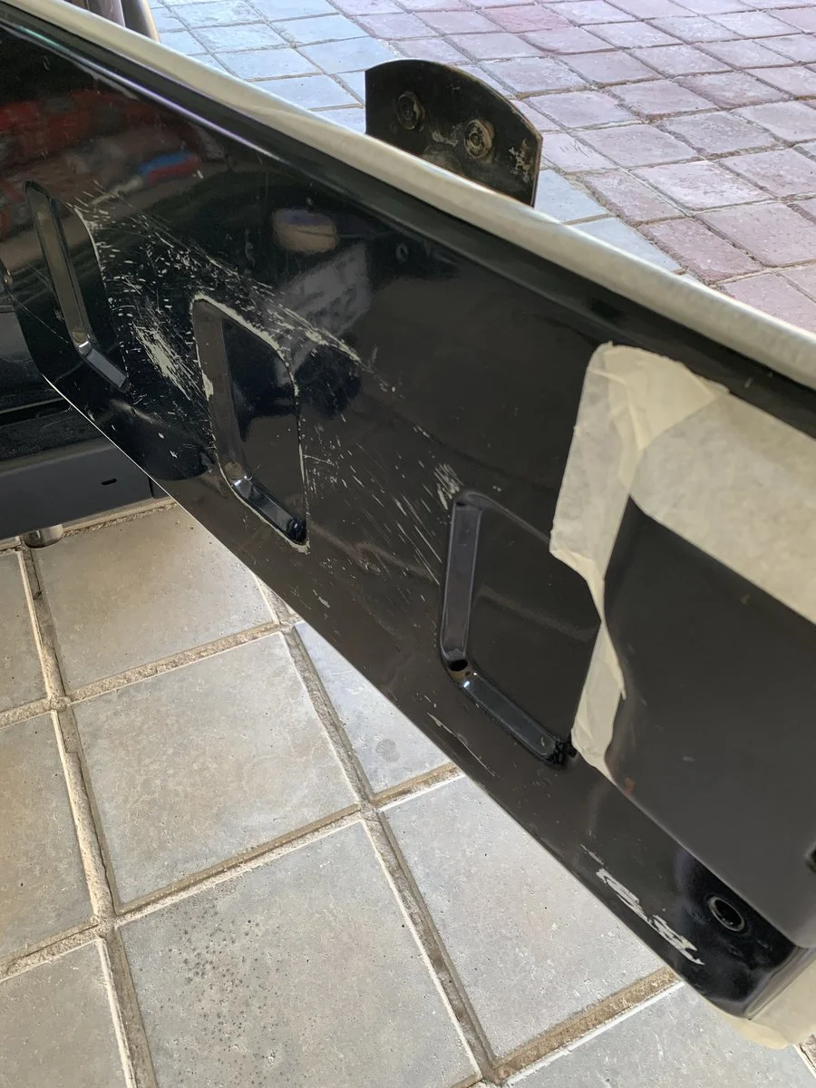

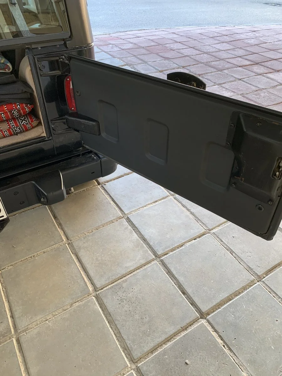

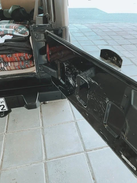

My tailgate door has lots of scratches and I didn’t like it since day 1.
Today I decided to work on it,
Cleaning it properly then painting it.
I chose for the painting:
• Plastikote - Rubberized Undercoat
After the painting,

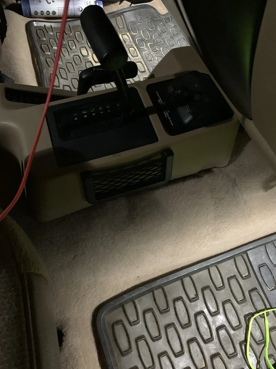

I got these nice storage string bags ($1.5 each)
Photos below (y)

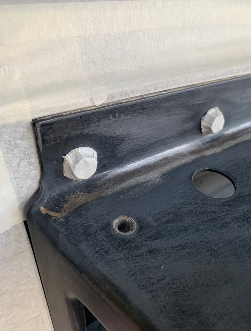

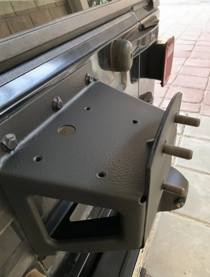

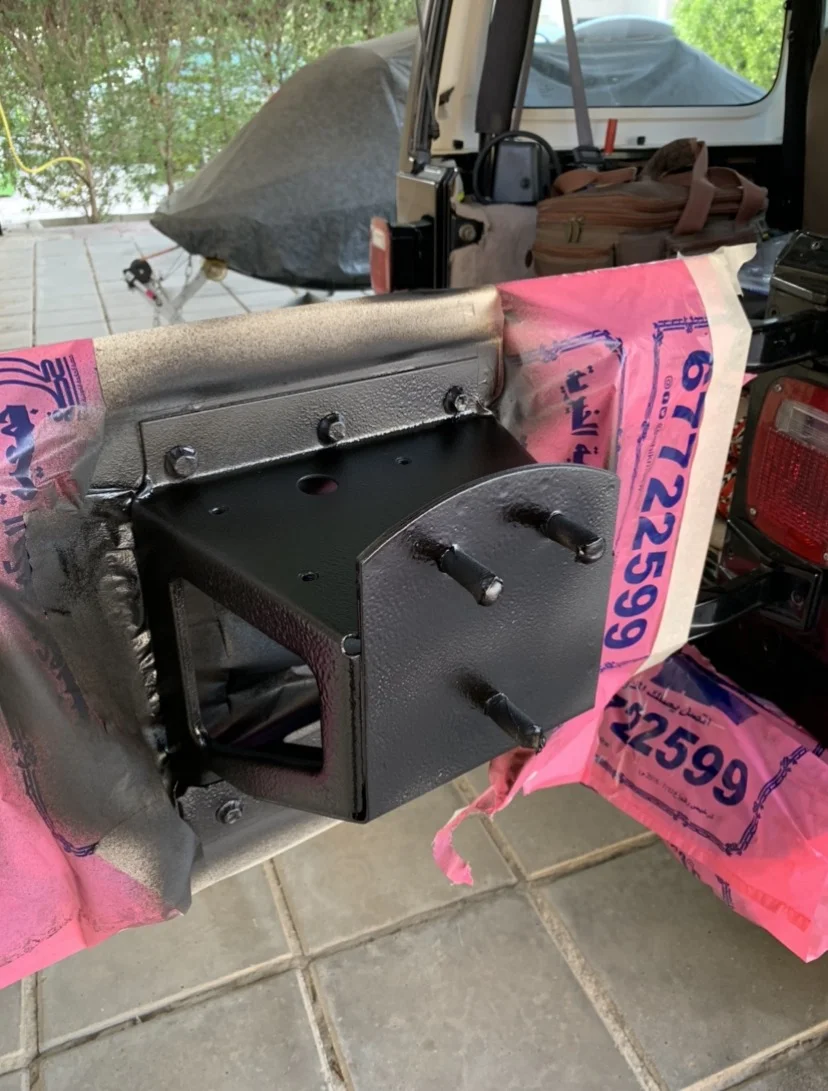

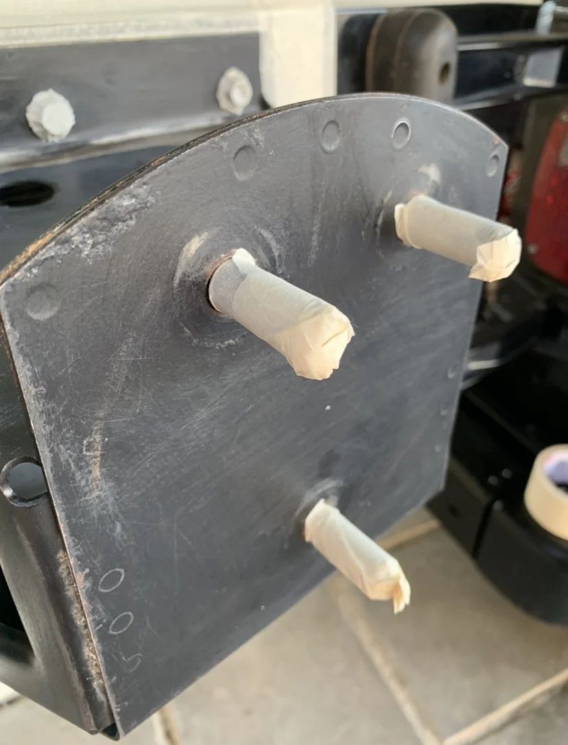

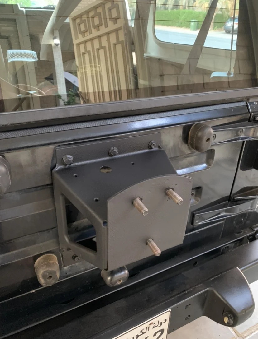

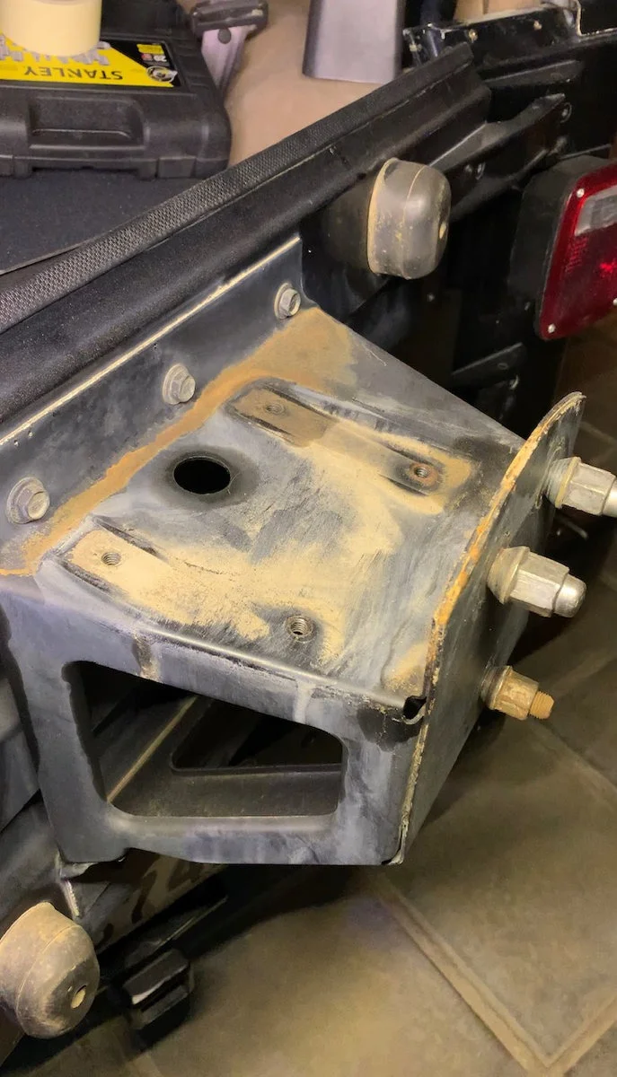

Yesterday I felt like enhancing my Spare tire carrier,
the paint that is painted with will fade and cause rust with time (that's what happened with me)..
So, I decided to sand it..
I even sanded the bolts, and screws.
I used Undercoat *Rubberized* type of paint.
To provide a protection layer for the carrier, and to prevent rust.
I made sure to tape the screws,
so that they won't be painted with this type of paint,
as it will be harder for me to unscrew them in the future if needed.
Check the photos below:
