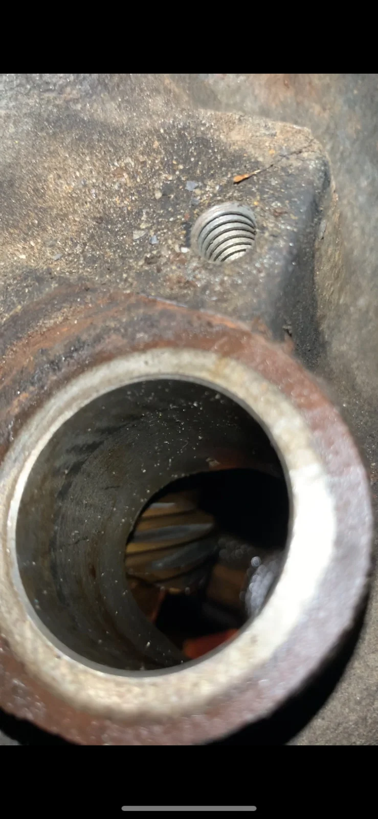

So a while ago I was having the random misfires and then a p0016 code and found out 05-06’s had opda problems. I replaced the opda with a crown unit and all had been good but I’ve been hearing the ticking noise mostly at idle and then when the engine warms up, it goes away. When I was trying to pinpoint it, it seems the ticking can be felt when I touch the opda. I’m assuming it means I need a new cam but what do you all think? Is it worth it to check the rockers and push rods first or should I just plan to do a new cam and lifters and check it then? Anybody have any good recommendations? I’m not looking to get anything performance cause then i’m get carried away and want performance this and that and soon enough i’ll just want to stroke it. Anyway, i’m also assuming that this would mean just the teeth on the cam where the opda rides is bad? Nothing will get further damaged except the opda teeth and cam teeth if I keep driving it like this, right? By the way here’s a photo of the cam when I replaced the opda a few months ago (pretty worn i’d say)
