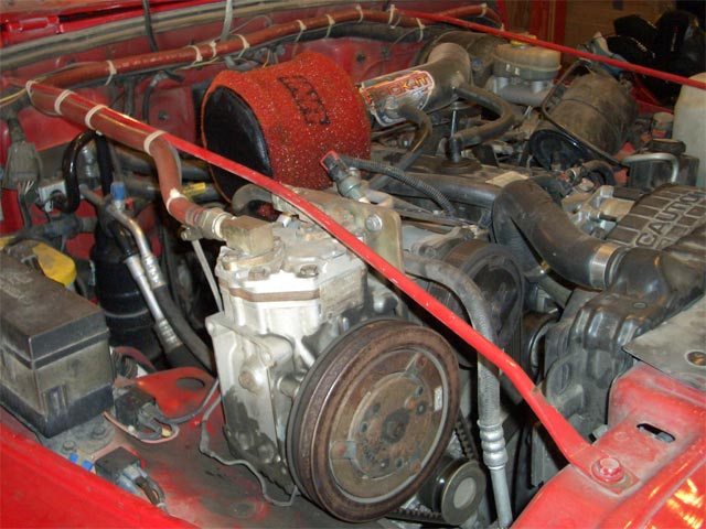

I installed a York OBA system using Kilby's bracket & kit but I sourced my own used York compressor from a local auto parts recycler. It only cost $35 used and it was in superb condition, never gave any problems. They had 8-10 in stock, I picked out the one that had the most suction & output pressure as I spun the pulley with my hand. A 12v battery is needed to energize the clutch so that can be done.
Those two sources of parts are charging an arm and a leg for the compressor, I'd buy everything but that from them. What you want is an F210 model, that's the model with the highest CFM rating. Technically I used an F210L which has the output port on the left side. This is my previous TJ.

Great! Thanks for this information. I will read your install process JJVW. That setup was really nice Jerry! I will try to find that F210 York. There are not many auto part recyclers close to where I live. Is the York compressor from ORO a much more specific/improved compressor for our intended use (just air) over a 1970's or 80's F210 regular York compressor? This is the description on ORO's website:

The flange head style shown on the page in Byhumba's link is the most desirable since you can install the two flange head fittings that make it easy to connect the input and output plumbing to. That's what I found the most of on my auto parts recycler's shelves. This was a common compressor used in older Volvos and Fords.
The flange style head is what the 28723 Flange Fittings in the Cuoffroad kit fit directly.
