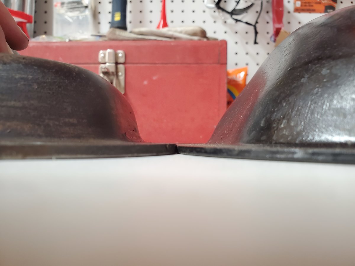

Here is a Dana 44 cover from a 99 ram 1500. A hair thicker than stock. I paid $4.99 for this cover today.
View attachment 125216View attachment 125217
My only concern would be the location of the fill plug. From the looks of the 2 pics the one on the right in the first pic is the one from the 1500? If that's the case you wouldn't be able to put as much gear oil in the diff.
The overhead pic of flipped. The Dodge cover has a higher fill plug.
The picture is flipped. Sorry for the confusion. The 1500 cover is higher.
