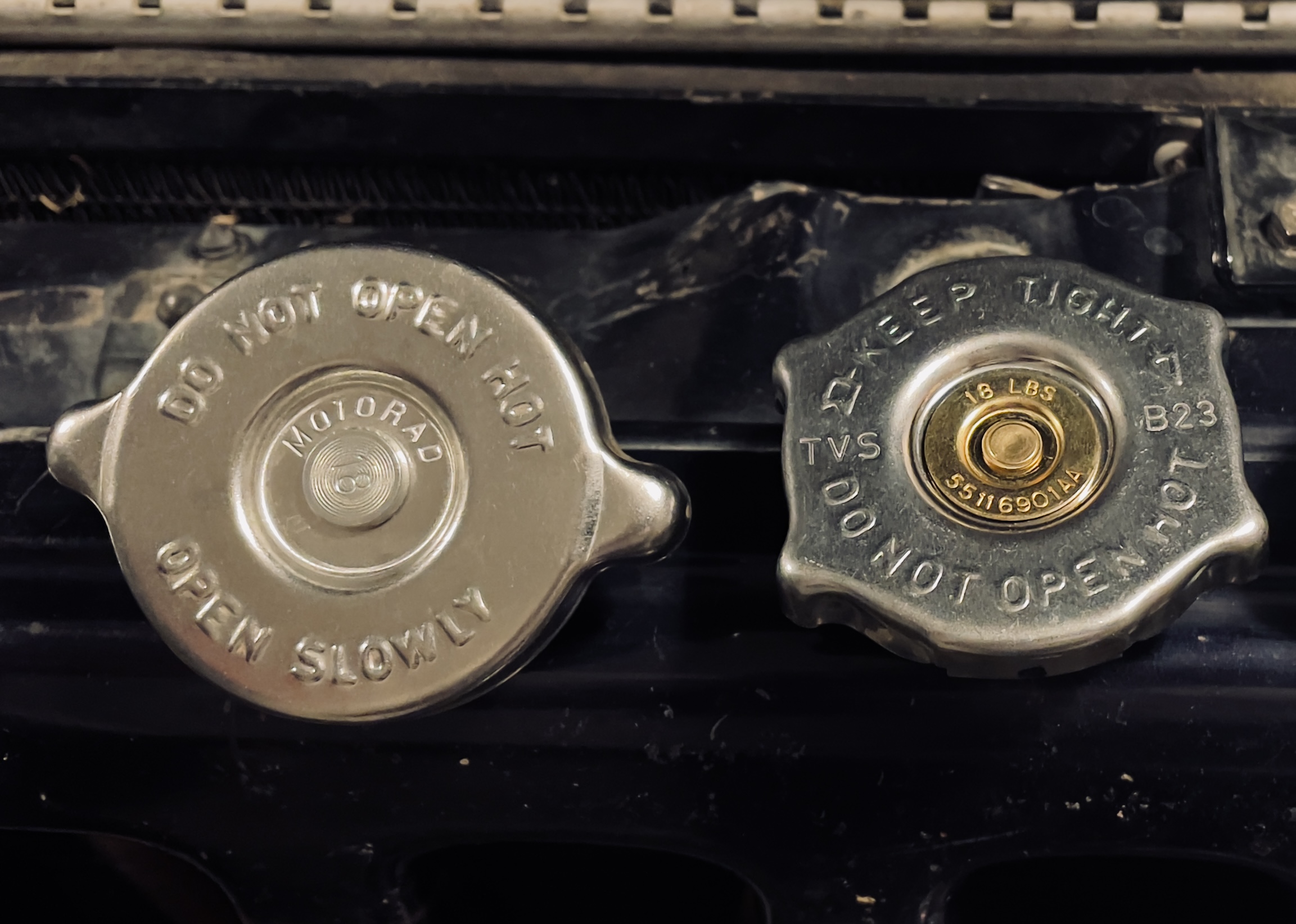

I also recommend staying away from Motorad radiator cap. I have MOPAR cap now and now the fluid does not boil over.

Great news, I finally had time to troubleshoot. I topped off the coolant, jumped the battery and watched as the temp climbed. I noticed coolant leaking down the thermostat housing, but realized it was coming from the upper rad hose, so I waited for it to cool down and adjusted the hose further onto the neck and tightened the hose clamp just in case it was just pushed off from the increased pressure while overheating. While I was waiting for it to cool down, I went to check my parts stash and I found an new mopar radiator cap, so I tried it out and problem solved. I've never had a cap go bad on me before and wow, I didn't realize how vital it is to the system. Thanks for the help and reminders to check the rad cap first. I'll definitely be keeping a spare cap from now on.
