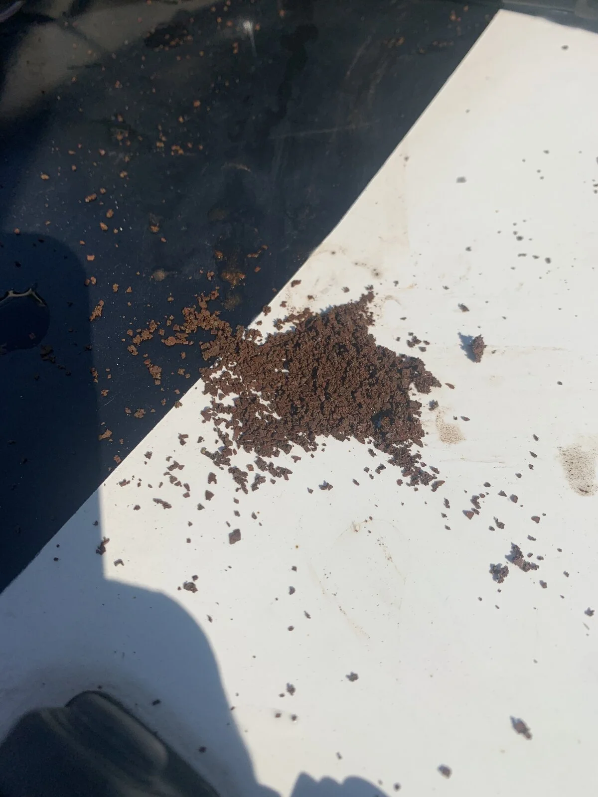

The coolant was brand new snice I drained during the harmonic balancer replacement. There is, however, a lot of rusty scale all over the engine bay.

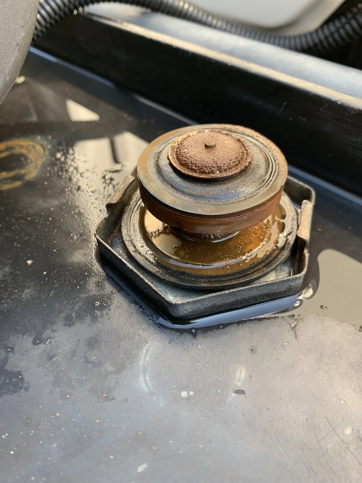

If your radiator was original, they don't last forever. The plastic top tank generally splits at some point and you need a new radiator.
While you're at it, pop in a new thermostat and a new radiator cap.

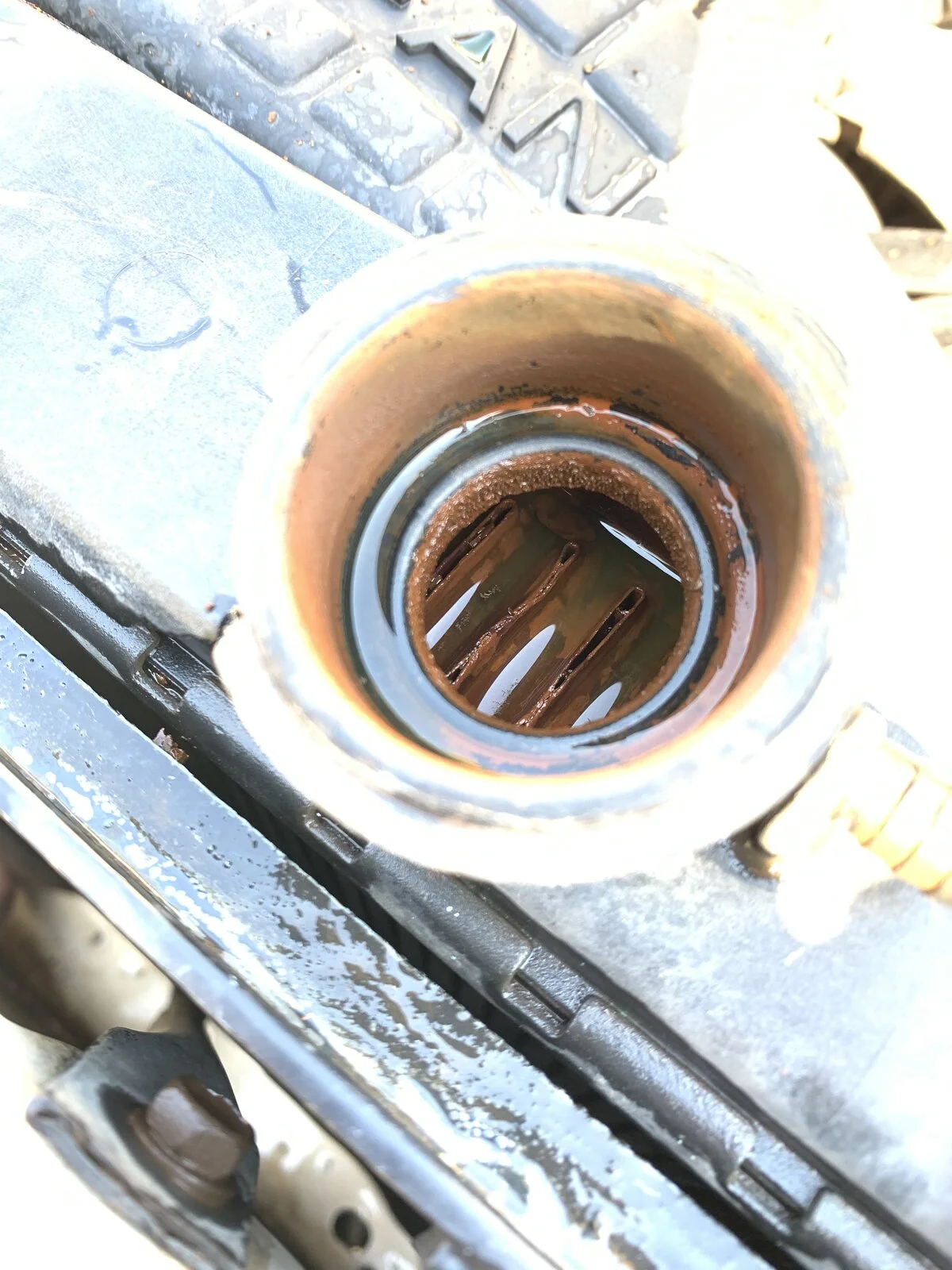

Radiator overflow was empty. Hose was full of rust:

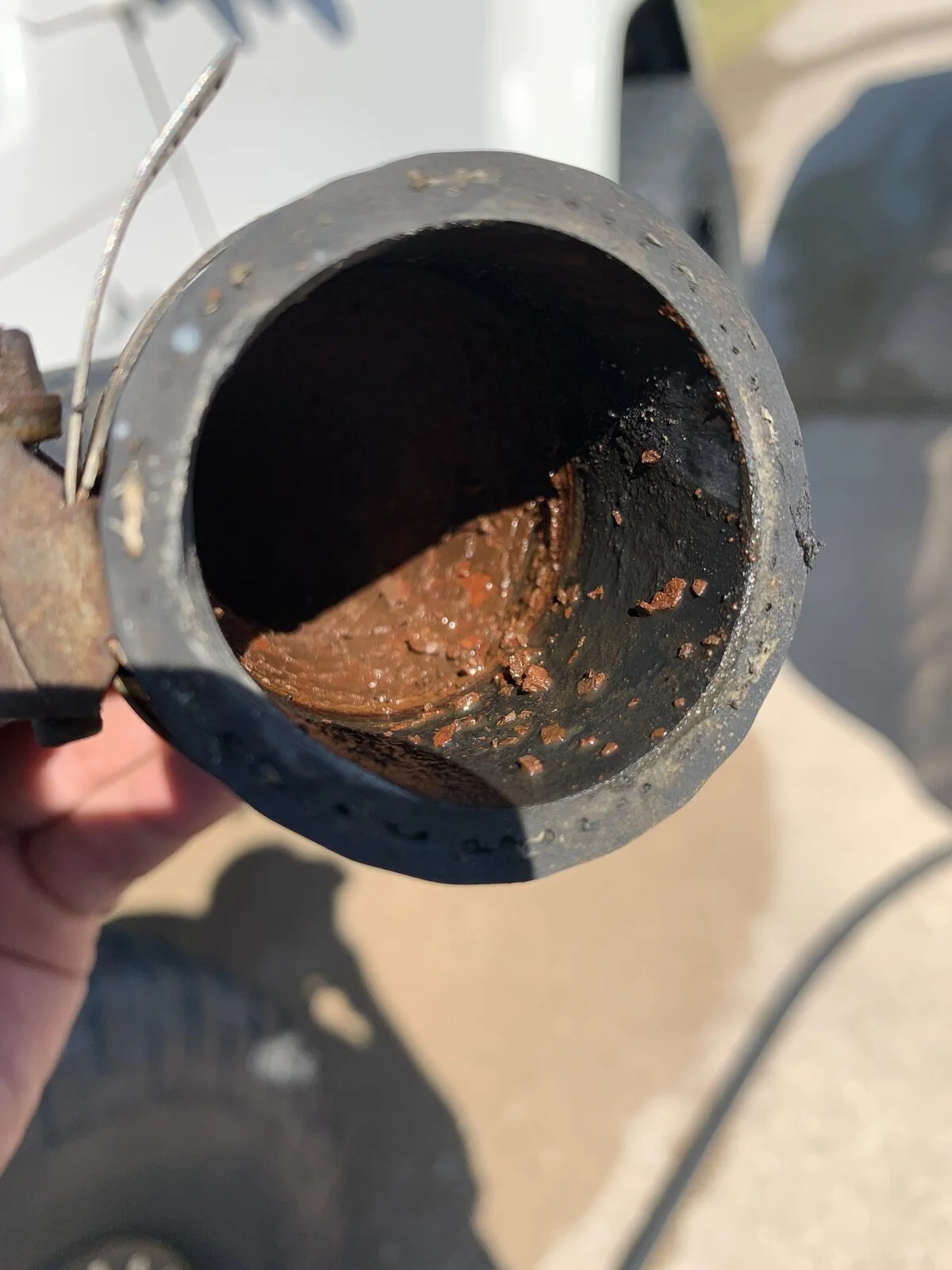

Upper Hose:
