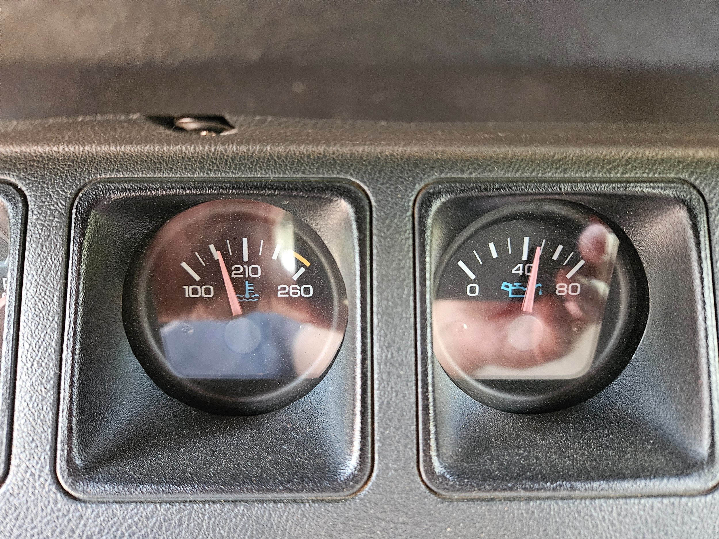

At 2500rpms my oil pressure gauge seems to read correctly according to the 10psi per 1k RPMs right?

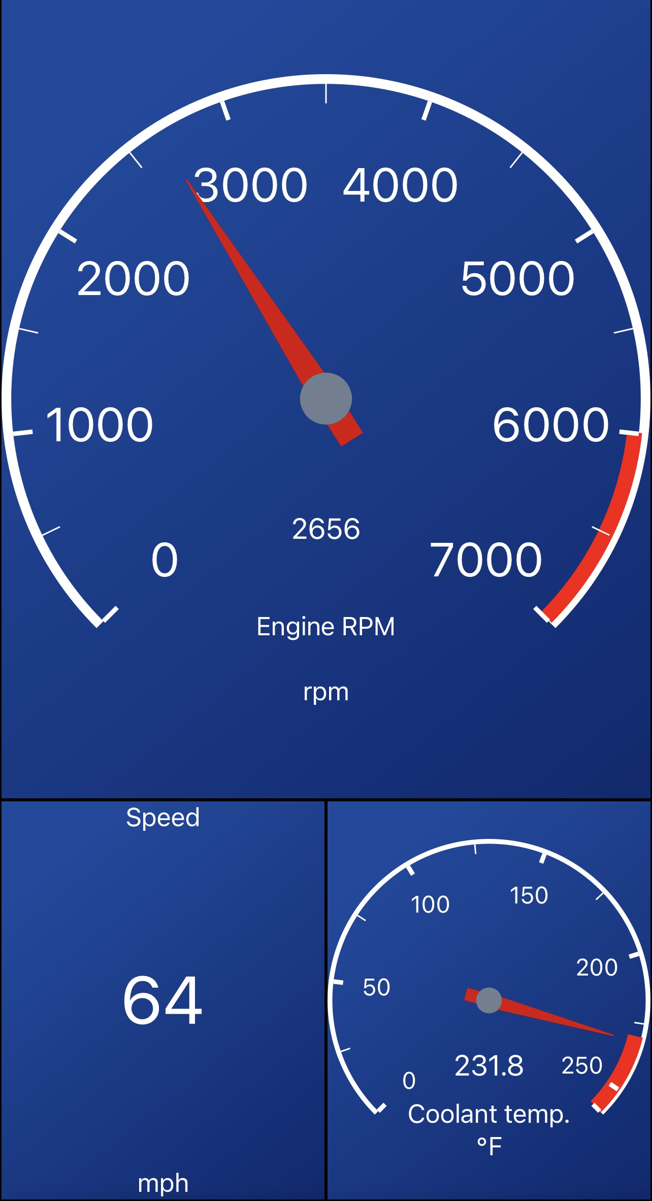

So got my Bluetooth OBD.
After driving for 30 minutes in 90 degree heat this was the reading. The tach is accurate but I don’t have a speedo for the 35s yet so the speed is about 4-5 mph faster than what the pcm reads. 230 is still way to hot for what I’m comfortable with.
The gauge on my dash showed a little bit over 210 so I’m assuming that’s just how they were made back in the day and then they would jump to the red when you started overheating? Not sure. Either way, the fan that my mechanic installed helped a little bit but not much.

You need to get an oil pressure test gauge. Factory gauges are damped down to prevent owner panic and complaints as you found out with the temp gauge.
Your pic showed less than 20 PSI, so if you were at 2500 RPM you should have been at 25 PSI or more. A new motor should probably be indicating 40 PSI or more on the factory gauge.
I would guess your oil pressure is actually less than the dash gauge indicated.
For a point of reference, my 300K mi YJ shows right at 20 PSI or so at hot idle here in GA, IIRC. I'll check it tomorrow as it's going to be mid 90s or so.

Today it was 25-30 Psi on the gauge when I was on the freeway but I’ll check that out. Low oil pressure can definitely cause overheating. Hopefully it’s that easy.
Check the hot idle pressure and then at 2K and 3K when it's up to temp.
Also, do you know what oil the mechanic put in it? It needs to be a Xw30 or Xw40. None of the new thin 20 weight oil.

I actually drive around with the Bluetooth OBDII hooked up in the TJ with gauges setup on the phone so that I get undamped data from the sensors. Except of course for the oil pressure. In the 06, the oil pressure gauge is just really an idiot light...

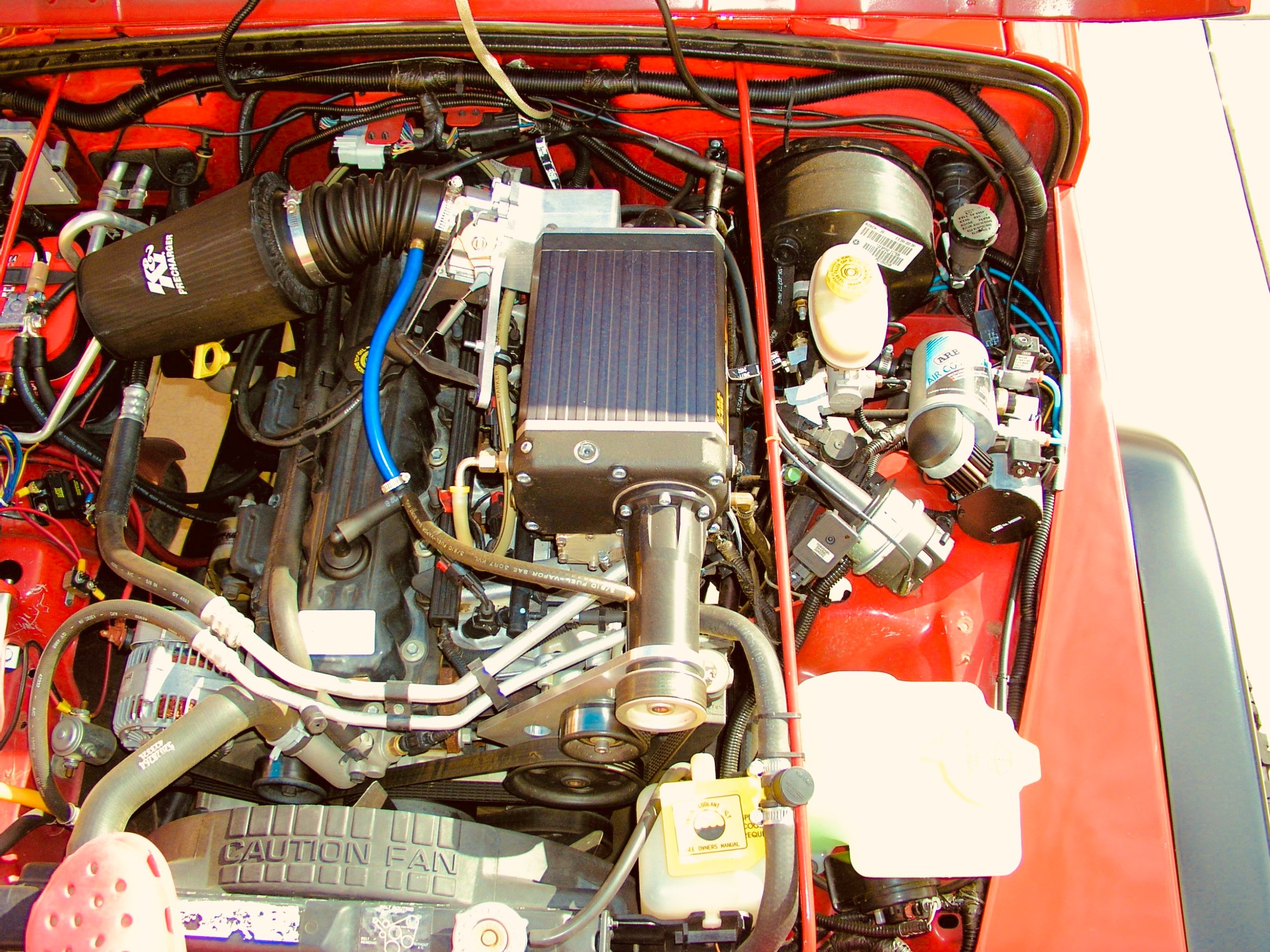

Being the engineer I am I found a solution(s) x3:

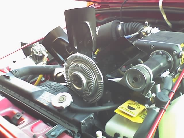

1) Jeep made a special 6 blade fan for the TJ. Chances of finding one of these is slim. I found about the fan from Jeep and I wrote an article and install and pics. Only need to remove your fan. the 6 blade drops in.
I was a Super Mod on a major Jeep Forum in the US with 13,xxx active Jeepers and I had about 40 mods under me. So I posted my write up and it got forwarded across the US. About 3 mo later I started getting tons of mail from across the US asking me where can that 6 blade be found, all the dealers were out of stock.
YOU may ask your dealer...
Some additional info.
2 0 The 6-blade solved my problem....Until I installed my SC, the my Jeep heated up like a Senior boy in HS who had a date with the Homecoming Queen and its his first ever date.

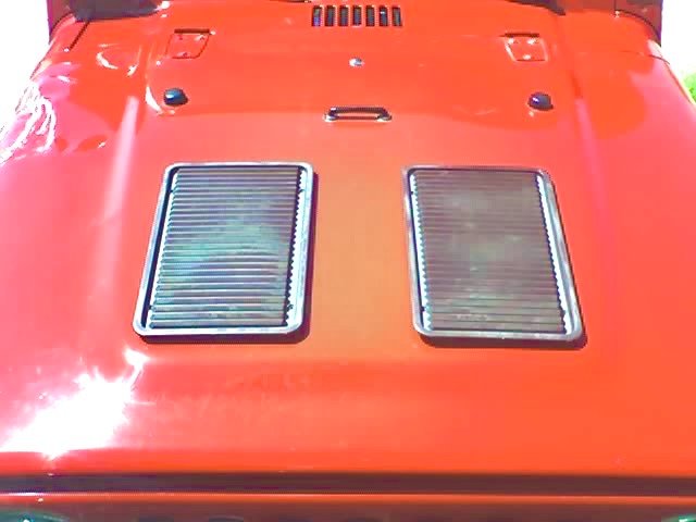

I installed a pair of Dodge hood vents from a Dodge that was being sold at that time with a SC.
3) That + the 6-blade + Vents + Cold Air Intake.
I tested a LOT of CAI, I lived in Phoenix AZ where temps are normal even in the 120s and on trail runs in the Sonoran Desert 130s: Bottom line is CAI does not work because no one knew how to build it. A friend of mine bought a Jeep CJ at an estate sale. Jeep had sat up for over 10 years and it not running, flat tires, everything dead. He called me and said I needed some help so I ran over.
I lifted the hood and what did I see...FOLKS, Jeep invented the CAI. The Jeep was box stock, owner had died years ago and family finally got mom to move to a rest home and the ranch was sold.
Jeep used a oil bath air cleaner and attached to that was a HOSE that ran to the Headlight bucket, boys we found the CAI that actually works. So I converted by. removing my headlight trim ring and running a Jeep intake tube (take off) from the filter box into the back of the passenger side headlight bucket. I called it "Trash Air" because I used a round plastic trash can screwed to the back of the headlight support.
Results: SOLID +1-1.5 mpg

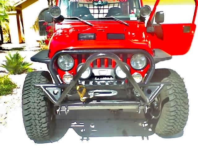

NO overheating...Trail rides became fun again: Me, my Rubicon, Supercharged and better mpg and ICE COLD AIR and I could idle all day and never overheat.
Some pics:

It did work for me, but it took the 3 things I mentioned to get Sonoran Desert cool after the SC was installed.
