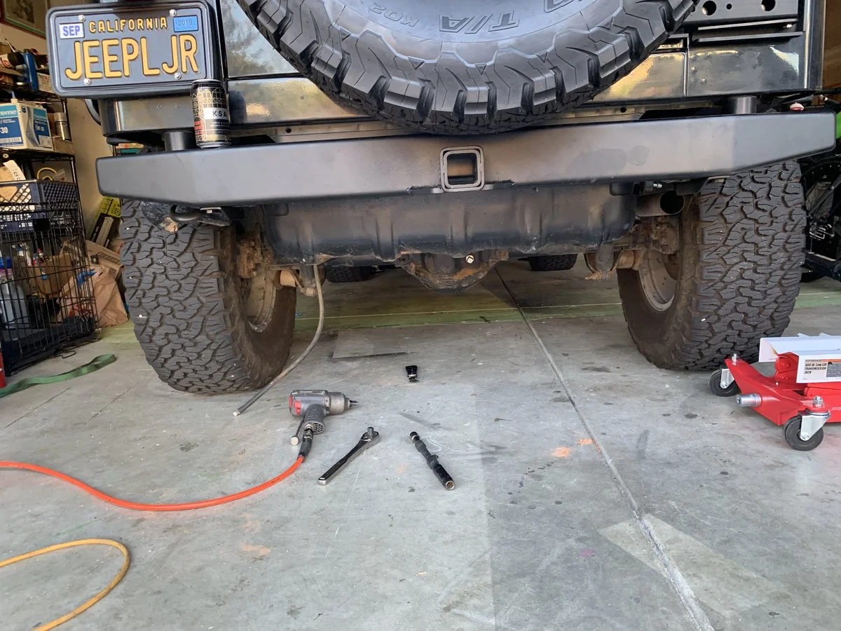

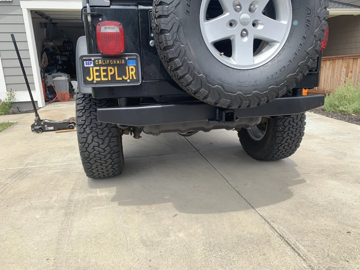

Ordered the Olympic 4x4 bumper @bobthetj03 has, I like its towing ability and Olympic sort of discontinued their whole current product range until Christmas, so I was able to get it, made in the USA with 3/16” steel for $142 shipped and tax from 4WP
Nice, I remember seeing your rear bumper after the Moab trip. Bent and in need of a few more bolts. LOL! Things will be all good now. That's a killer deal!
New bumper

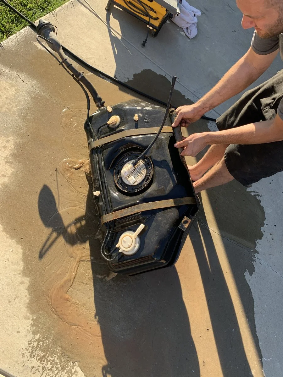

We also dropped the gas tank, I got a transmission jack from harbor freight on the cheap which made the job not too bad. Fixed the rollover valve sticking, I had learned to adapt to it but it sure was annoying. Glad to finally have that issue behind me. Thanks to @Rob5589 for helping via text on how to get the cage out.
Well done! A job I need to do as well. That last gallon or so takes forever to get in there.
Tom was just telling me that as we were finishing up. @bobthetj03 sounds like we need get your jeep back on the lift. The worst part about that job was getting the piece of of the tank. The only way we were able to was getting a flat head inside and prying two of the 4 locking tabs open. The metal collar was a PITA also.
