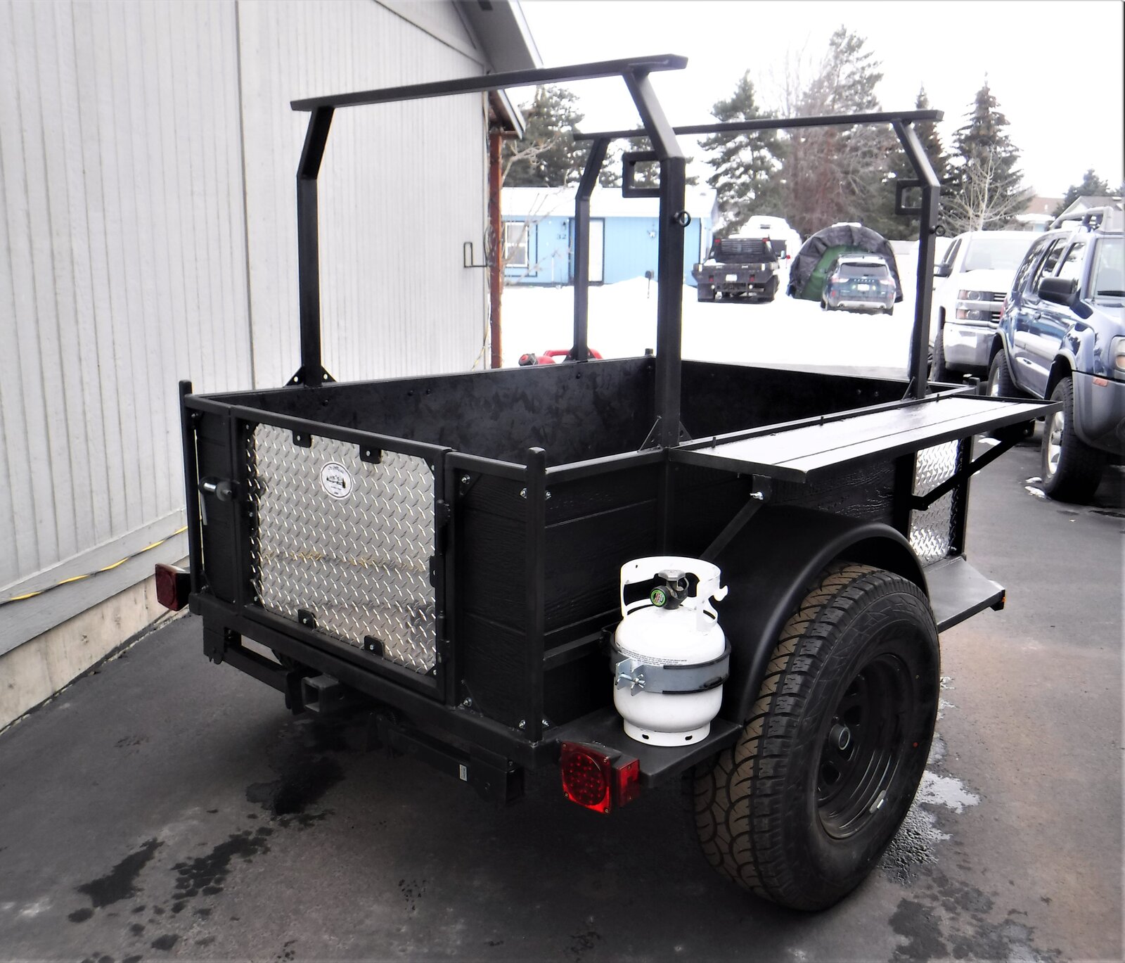

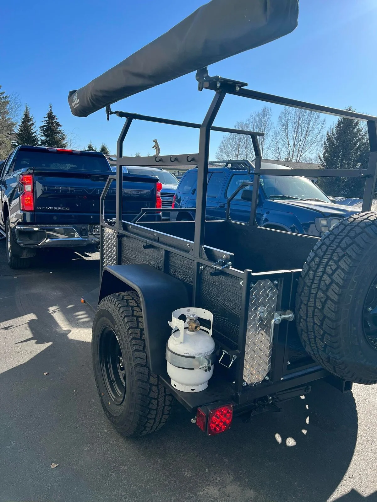

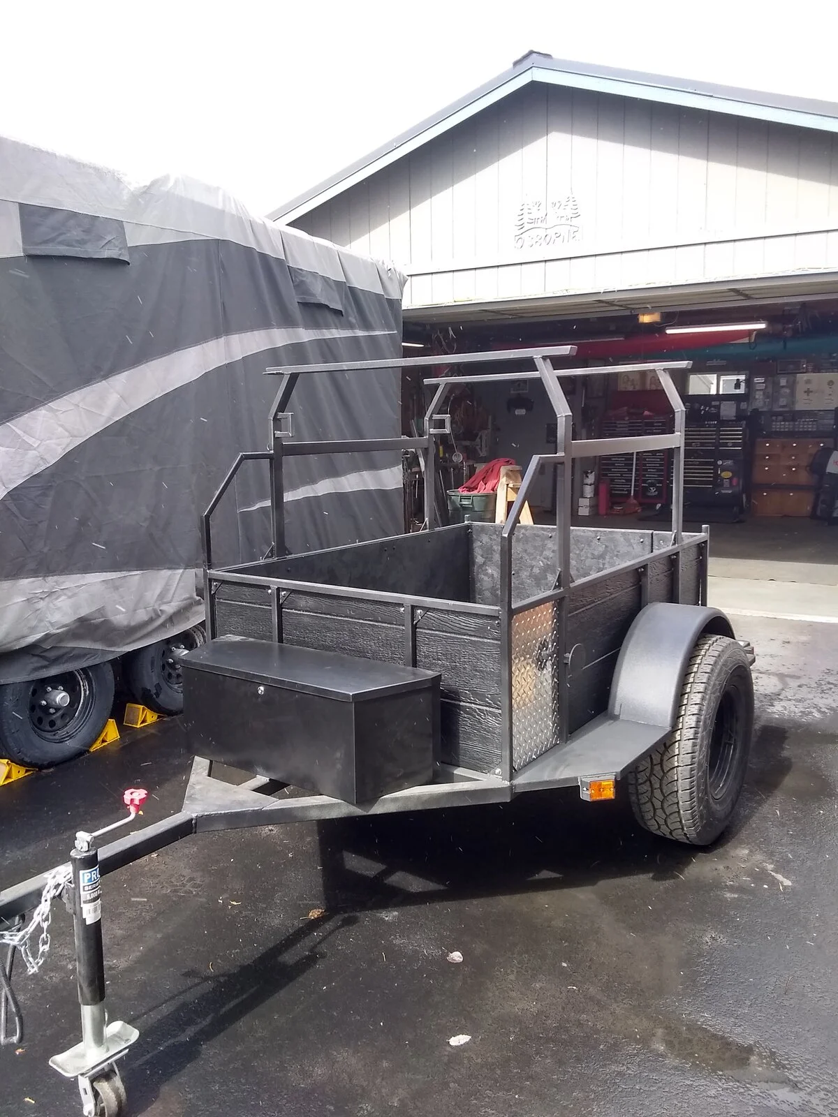

Finished building another Overland Trailer. Got it up for sale. Starting on another one in a week or two

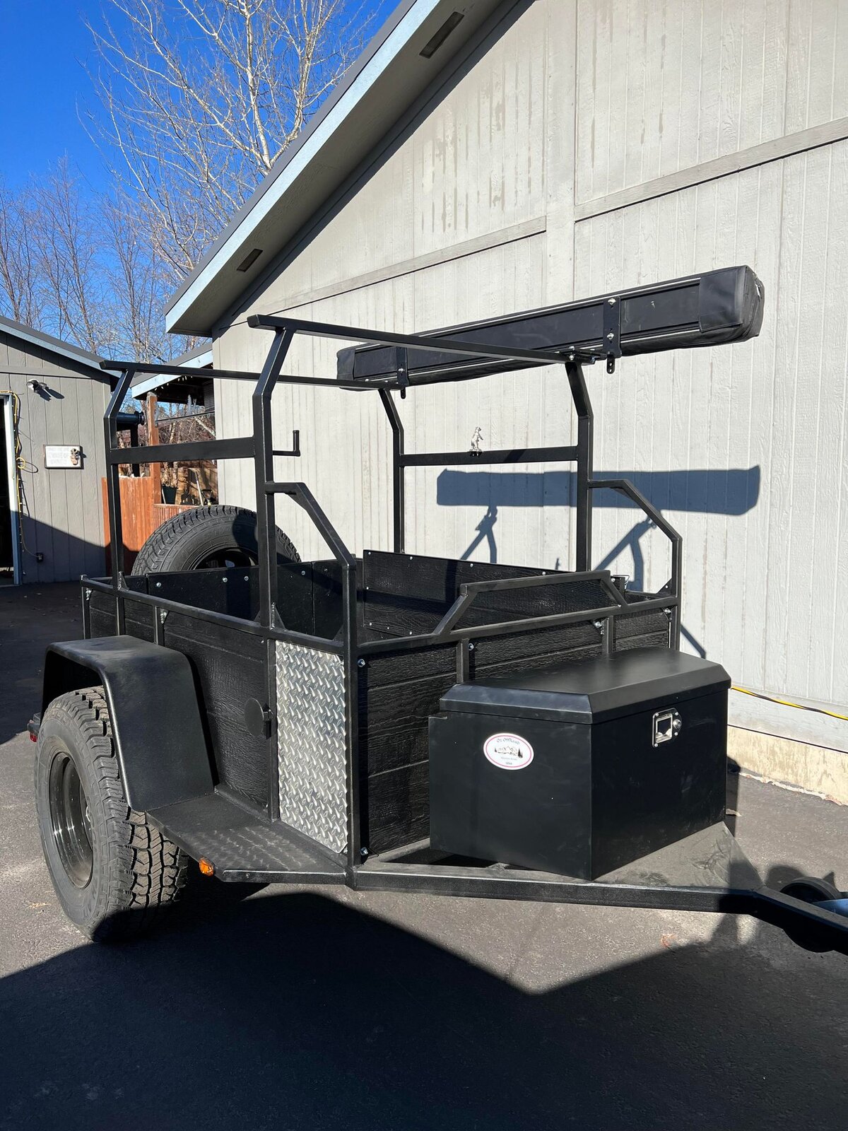

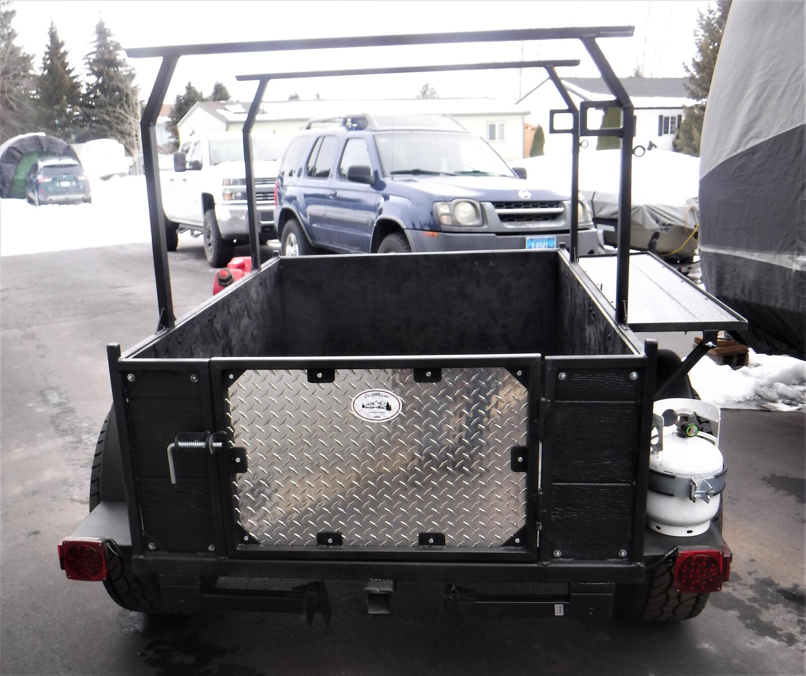

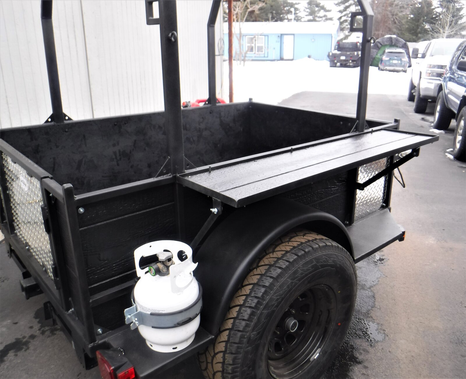

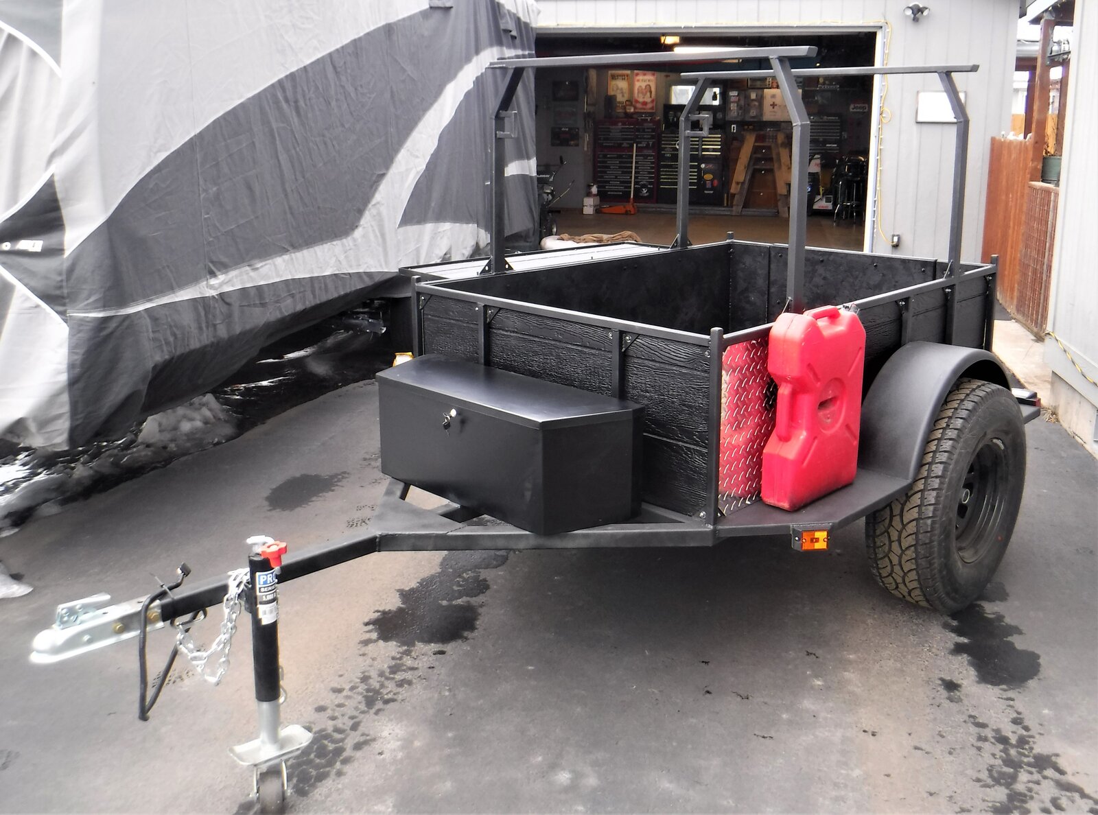

It's on FB marketplace.
$5500.00
Custom-built 4 x 6 Overland Trailer
(Ready for your Roof Top Tent)
Includes:
* Drivers side Rotorpax mount (mount only) for up to 3 gal. fuel or water container.
* Passenger side propane tank mount. (5 gal. tank included)
* 2 Passenger side awning mounts
* Fishing rod holder, etc.
* Tongue box
* Passenger side Removable table
* 31x10.5x15 tires (spare not included)
* Pro Comp wheels (15x8 bolt pattern 5x4.5 backspace 3.75)
* 3500 lb. Axle (double-eye leaf springs)
* 2 rear fold-away stabilizer jacks
* LED tail and marker lights
* 4 pin trailer plug
* 2” rear receiver
* 2” ball mount
* Fully welded frame (2x2x3/16) square steel tubing
* (Everything primed and painted with black bedliner)
(A great way to get your RTT off the top of your vehicle)

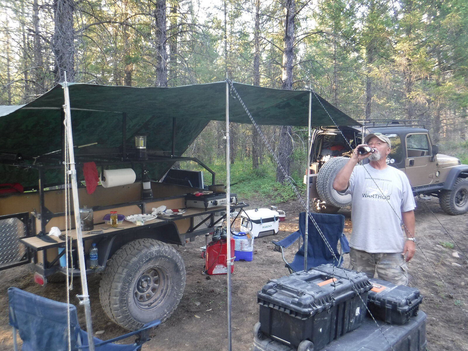

The siding is exterior, OC Panel engineered treated wood siding. Primed and coated with 2 coats of black Herculiner.
I've had the same thing on the trailer I built for myself. Montana weather hasn't done a thing to it.

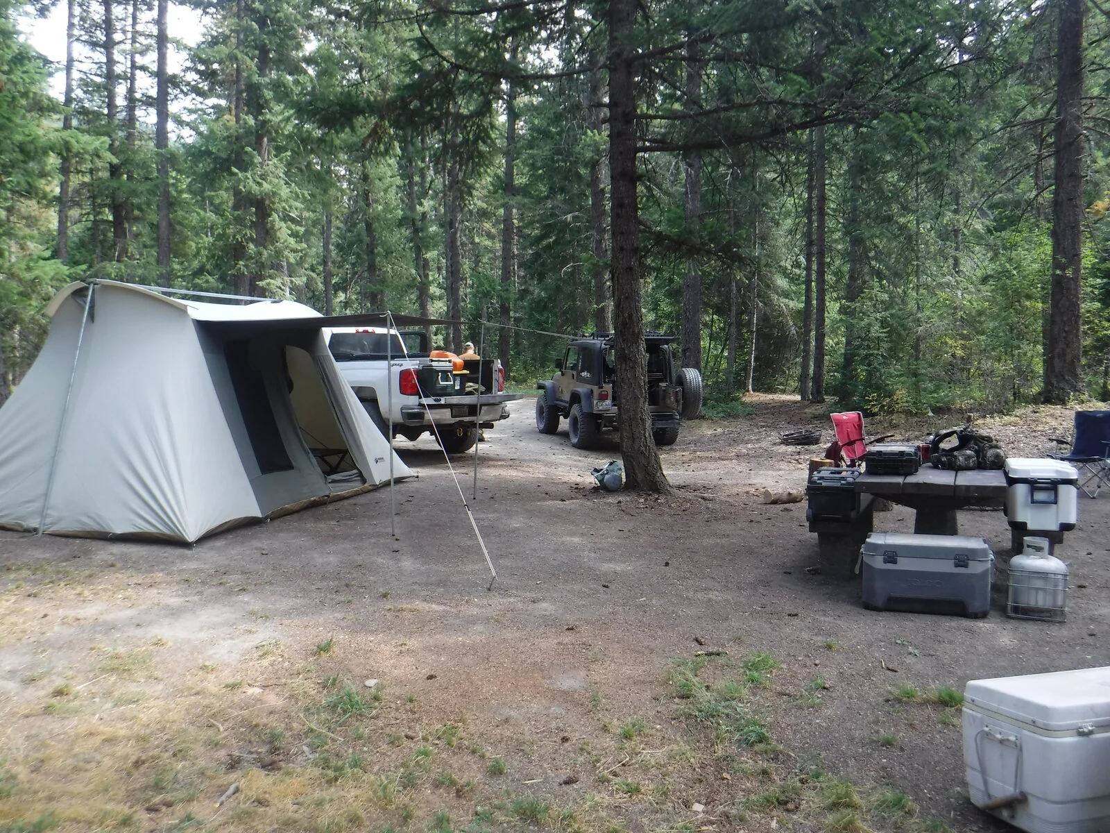

I have a Kodiak Canvas tent for bow season elk camp. I love it.
