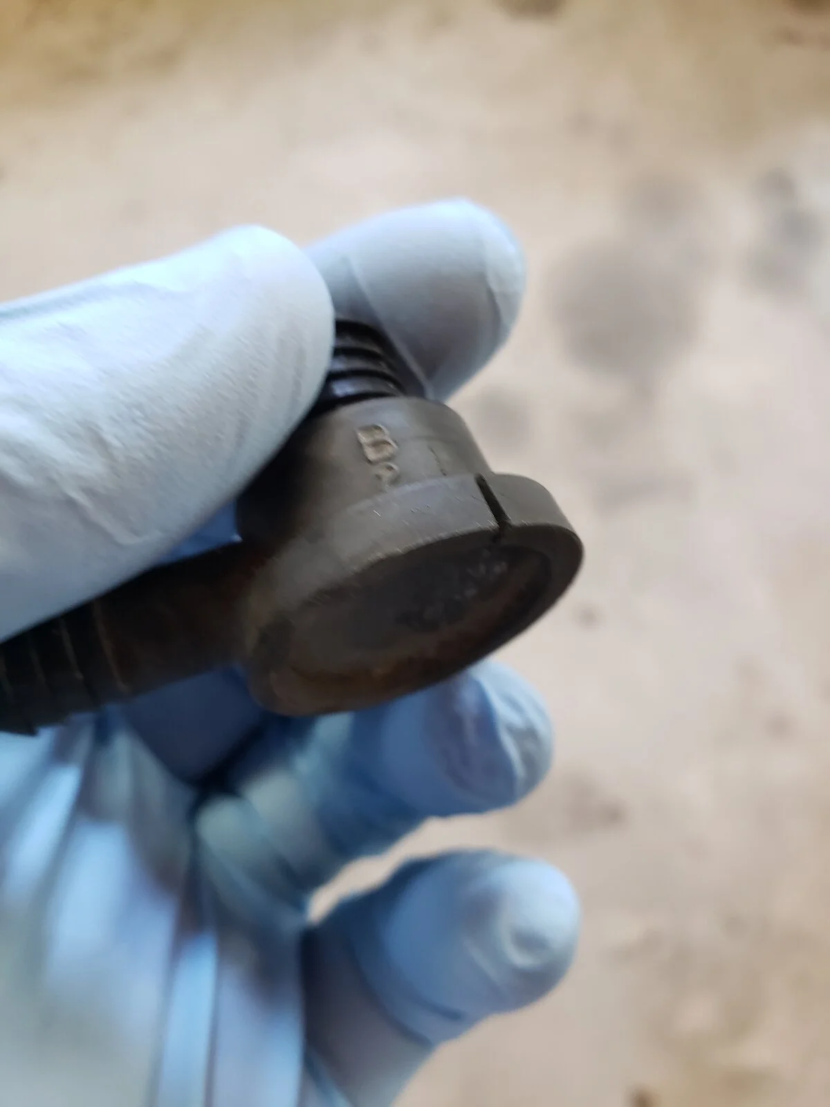

One of the exhaust connection flange bolts was corroded, but still had thread left at the end. It being late and me being tired, I went with it and reinstalled the existing flange bolts.

I removed the flange nuts and corroded bolt on one side (pain in the butt) . Installed a new one and cranked down on the nuts (i had previously replaced the gasket). It drove much better, but after 15 min, it bucked once and then the check engine light. P0171. The p0133 code never came on again.
