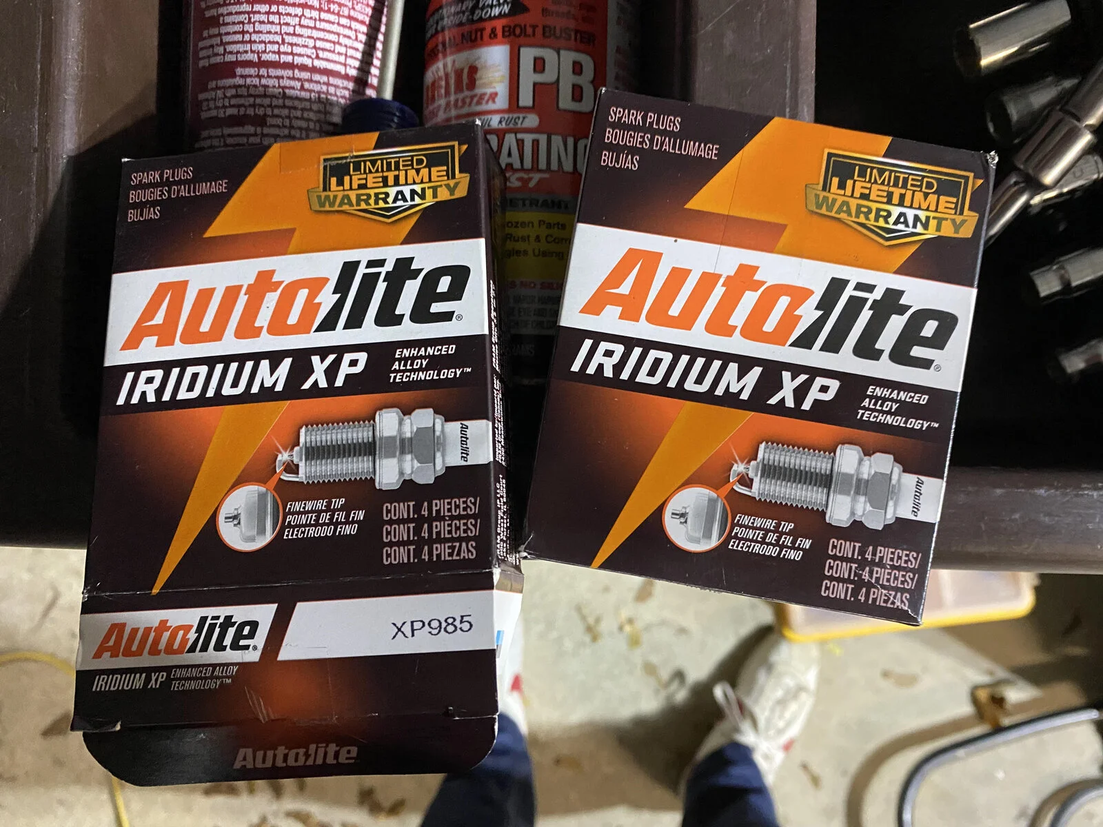

Which autolites did you use?
X2, exactly what model plug did you install?
I did a little digging through the forum and decided to get these from Amazon: Autolite XP985-4PK Iridium XP Spark Plug
sparkplugs.jpgshould I have used something else?
