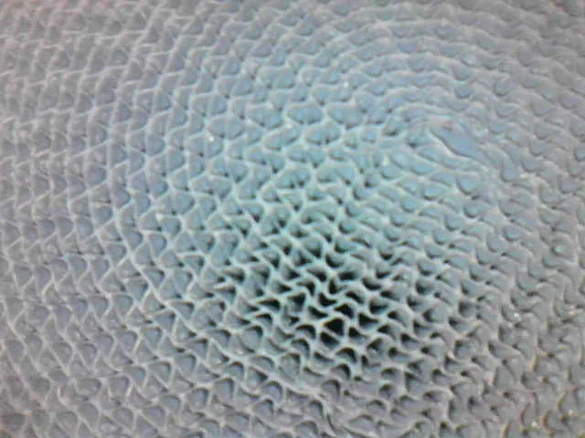

Ok, so about 3-5 months ago when I first got the Jeep, she had a emissions code problem, no biggy, went through a little bit of a fight to get the right NTK sensors (I installed Bosch ones first) and all was good, the code was gone. Then I had a battle with the TPS sensor. Got that sorted out and now I. Can’t get the P0420 (bank 1cat below efficiency) to go away. The Jeep has 4 NTK 02 sensors (upstream and down stream) that are all 3-5 months old. When I replaced the 02’s I used a endoscope to look at the cats and they seemed fine ( see photo ). My question is do I throw another sensor at it? Or just bite the big one and buy a cat? Something else? Keep in mind this is a persistent code that has been cleared at least 5 times and still comes back. Also she’s a 2001 4.0 5spd with 256,xxx miles if that helps.

Then carbon is probably not the issue. Buildup is often seen in cars that only do short, low speed trips, like to the grocery store and back. It takes a certain amount of heat to get the catalytic converter to light off, but once it does so, it should get hot enough to cook out any deposits.
