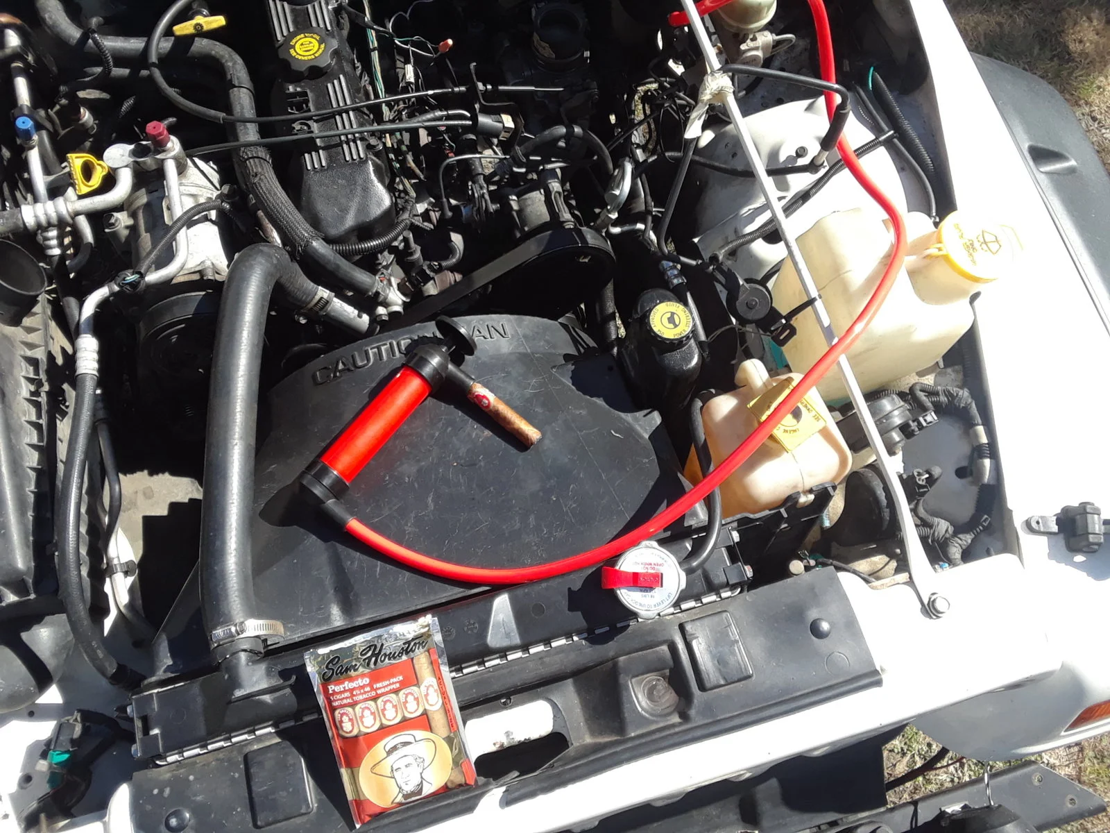

Here's a DIY smoke machine. It's a HF hand transfer pump for <$10.
Attach it to the intake as shown. Stuff a rag in the exhaust pipe and stopper the throttle body intake.
Light the cigar and pump smoke in and watch for it to show smoke somewhere.
Works the same on a 2.5L or 4.0L.
