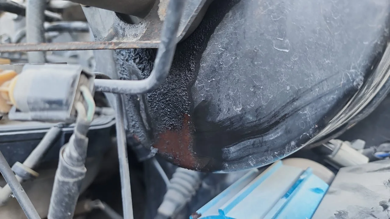

I did the IAC clean with TB cleaner, TPS and MAF are fairly new, checked for vacuum leaks, couldn't find anything until I reached the brake booster. Turns out there's a big brake oil leak at the mating point of the master cylinder and booster. It kind of circulates both above and below the mating point. Photo attached.
I also noticed the bushes under the brake oil canister were wet and the cylinder was wet at the bottom.

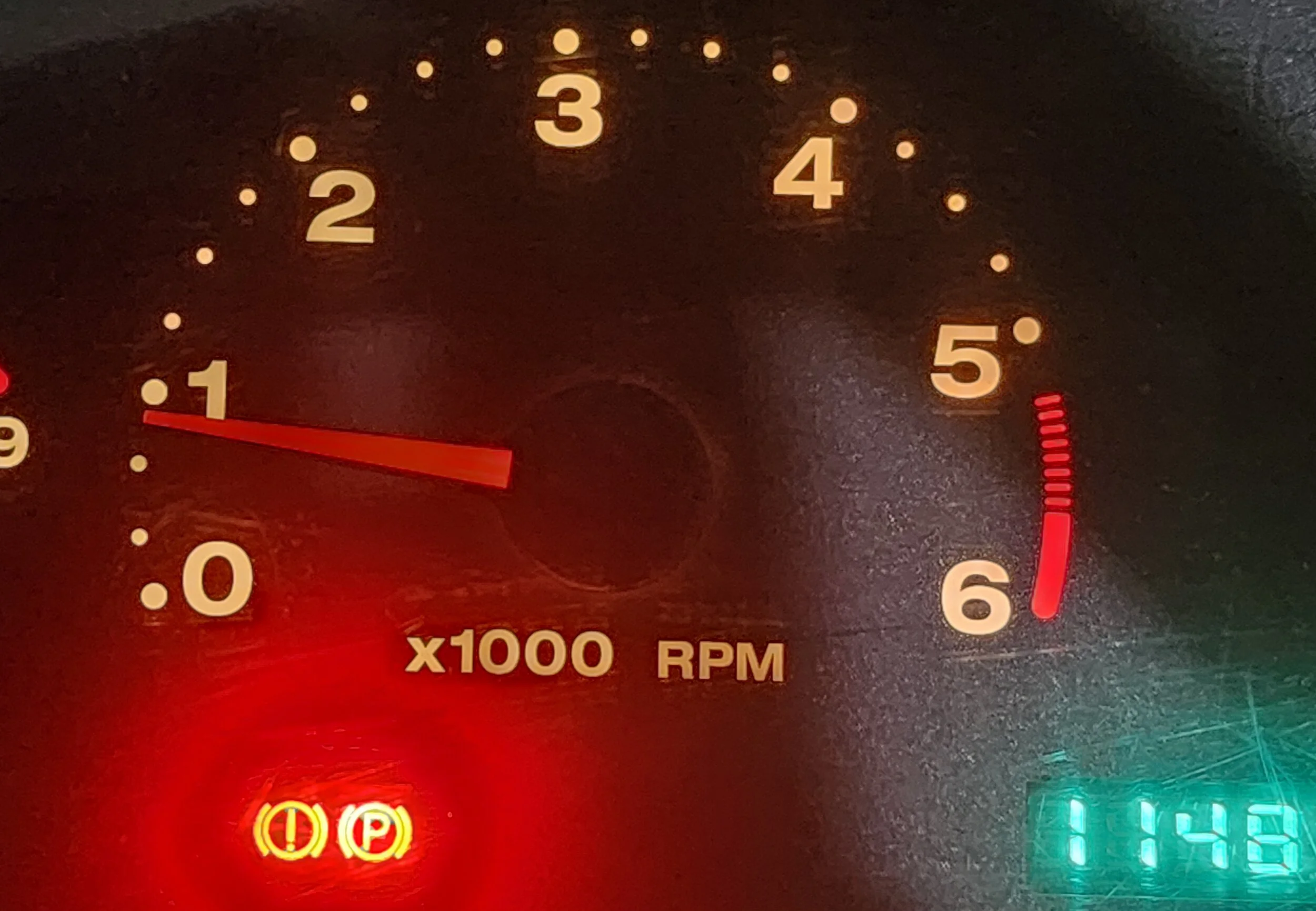

- the idle rpm rises when I press the brake, significantly when I press multiple times.

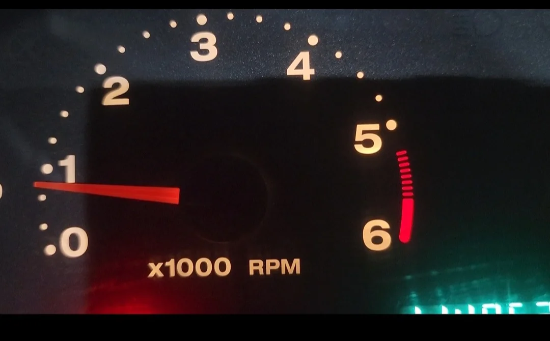

- I plugged the vacuum output for the brake booster and compared engine idle rpm between plugged and unplugged. Difference isn't huge (photos attached below) but with the rest of the evidence it's enough to confirm to me that the booster failed or is on its way.
Booster connected
Booster disconnected and vacuum plugged

I did the IAC clean with TB cleaner, TPS and MAF are fairly new, checked for vacuum leaks, couldn't find anything until I reached the brake booster. Turns out there's a big brake oil leak at the mating point of the master cylinder and booster. It kind of circulates both above and below the mating point. Photo attached.View attachment 579792
Booster connected

The rubber diaphragms in the booster are not brake fluid compatible. They will die at some point after contact with brake fluid. No idea which parts to use but you need them now.
