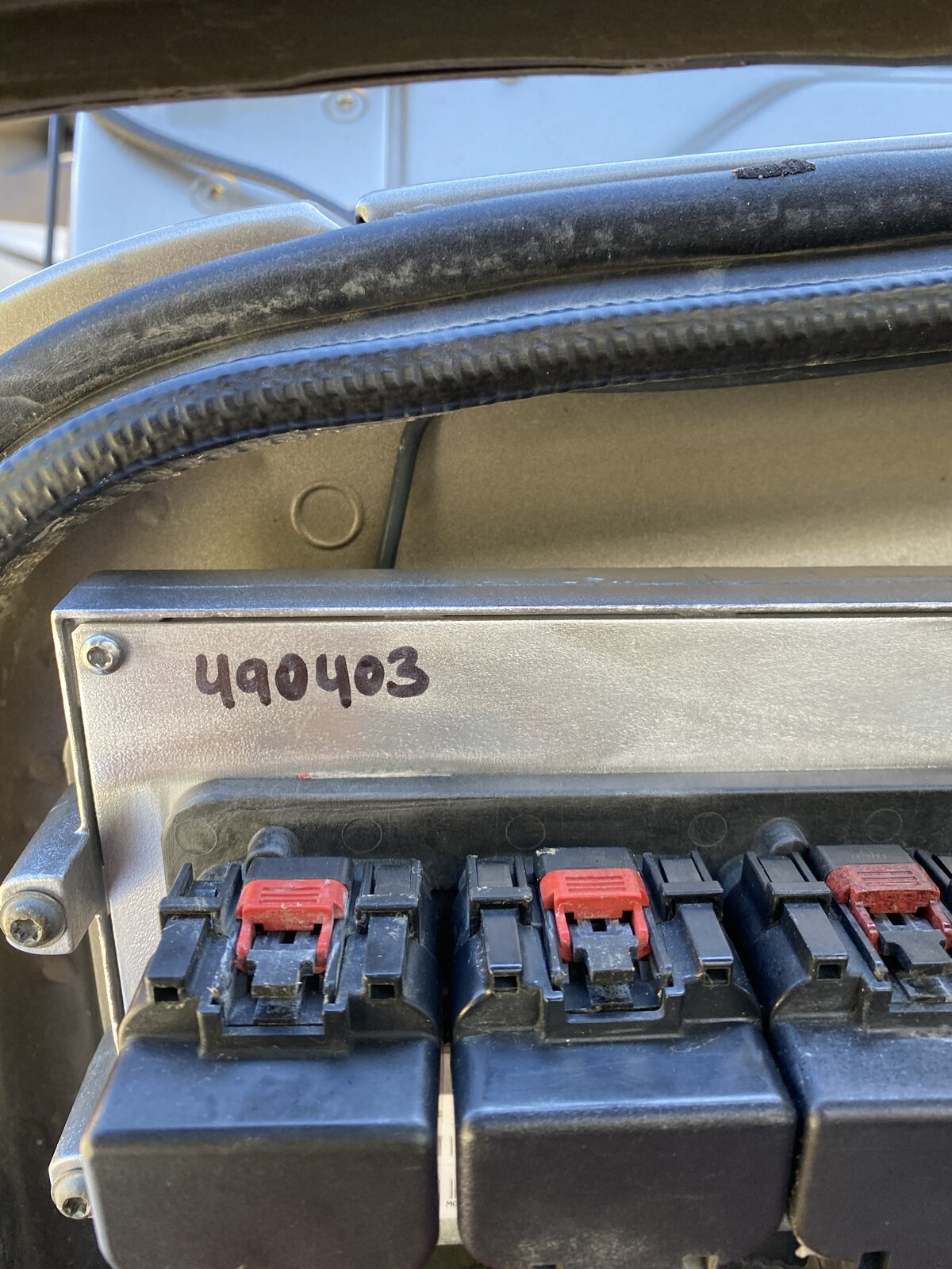

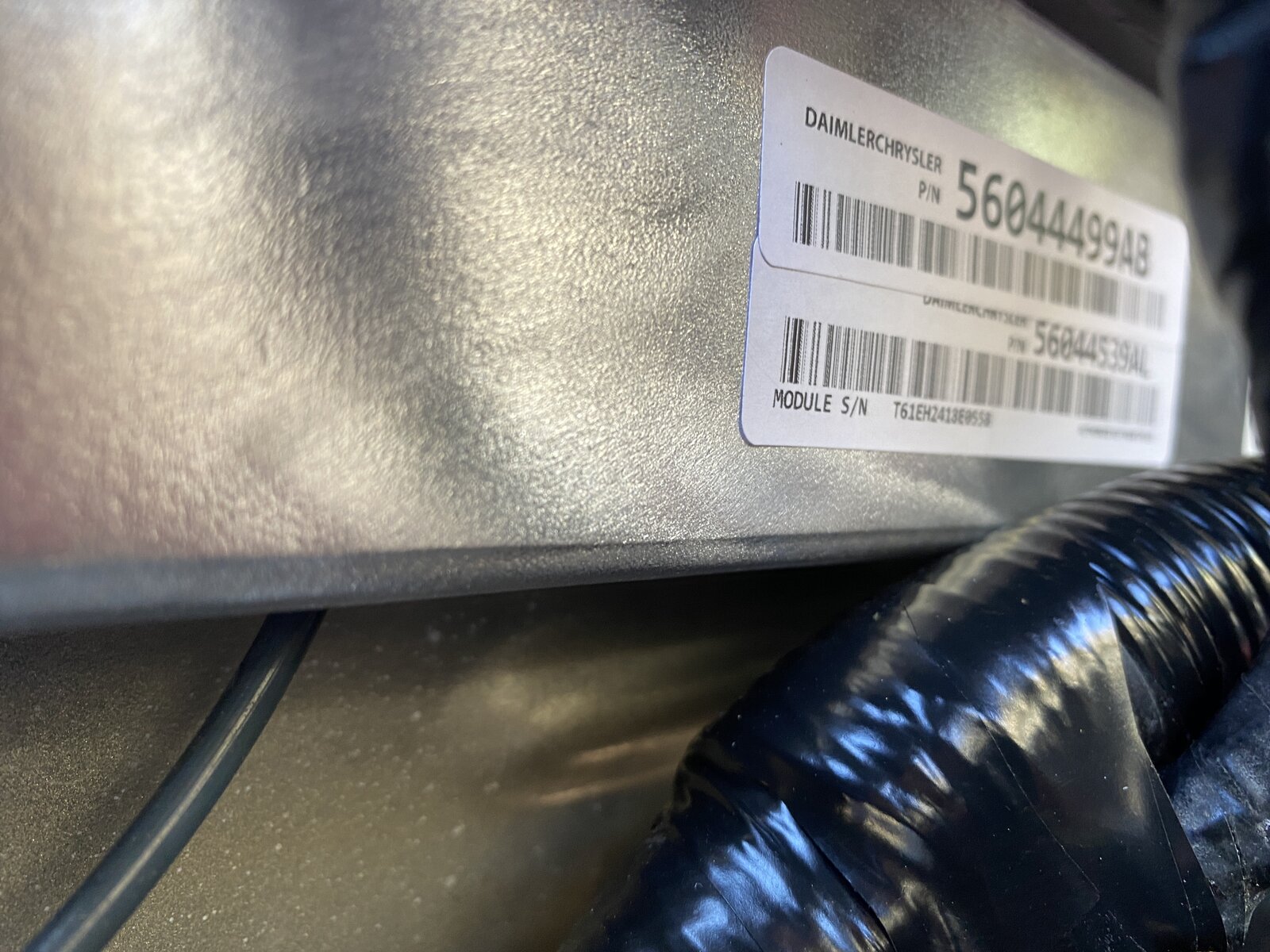

I have a picture of ecu cant figure out how to post? But its green port is capped off no pins.
