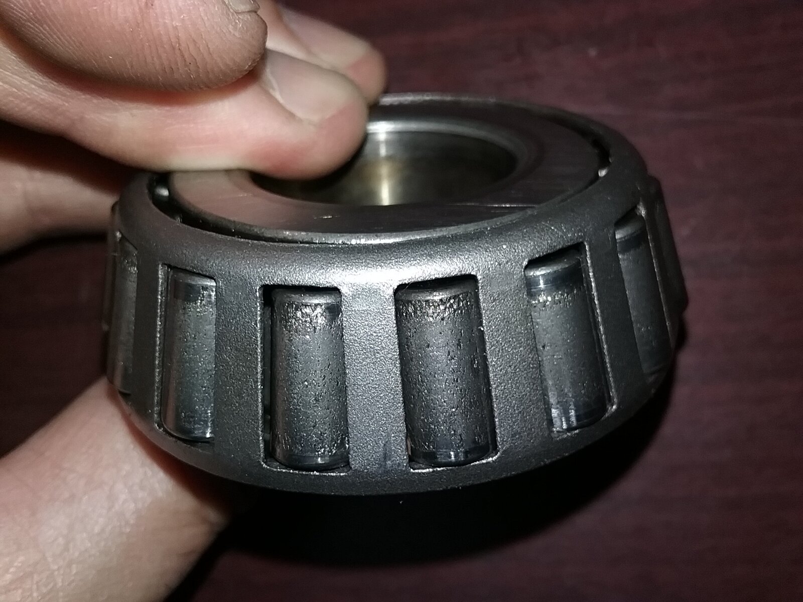

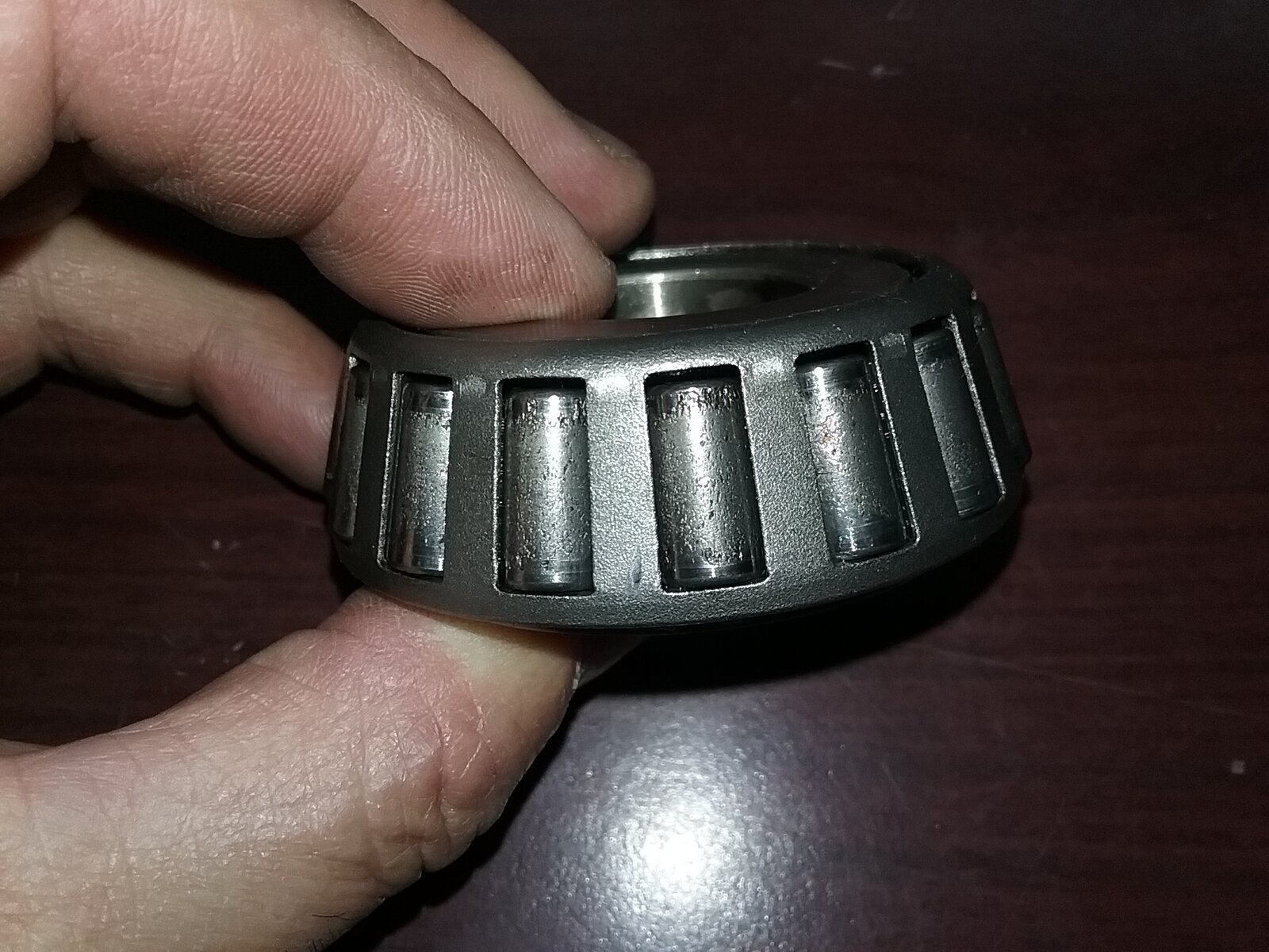

Spent some time on the rear diff tonight. Swapped out the bad ujoint. Pulled the outer pinion bearing.
Did your gear installer reuse bearings, or just a bad bearing? I don’t think my OEM looked that worn when I did my regear in the spring.
They definitely used new bearings. They were Koyos. My previous were timkens. Junk chinese crap bearings bites me in the ass! I had no control over the installer's choice, but didn't much matter since I'm not taking it back there. The race had some minor pitting, but didn't have the proper puller to remove the race from that end, so I did a two fold fauxpah and replaced the bearing with a Napa Auto garbage bearing and left the race as is so I could button it up and drive it home. It was wisper quiet for the drive home. It'll buy me some time.

I’ve always heard good things about Koyo bearings. ECGS uses them interchangeably with Spicer - Yukon Gear does as well if memory serves. That one was definitely bad though. Any chance there was an oiling issue?
Was it getting oil?
With all the pinion angle changes I have made, it is totally feasible that it could have starved a bit and got hot. The damage to that bearing certainly looks like it. No discoloration, but the hard facing certainly busted apart and trashed those rollers.
