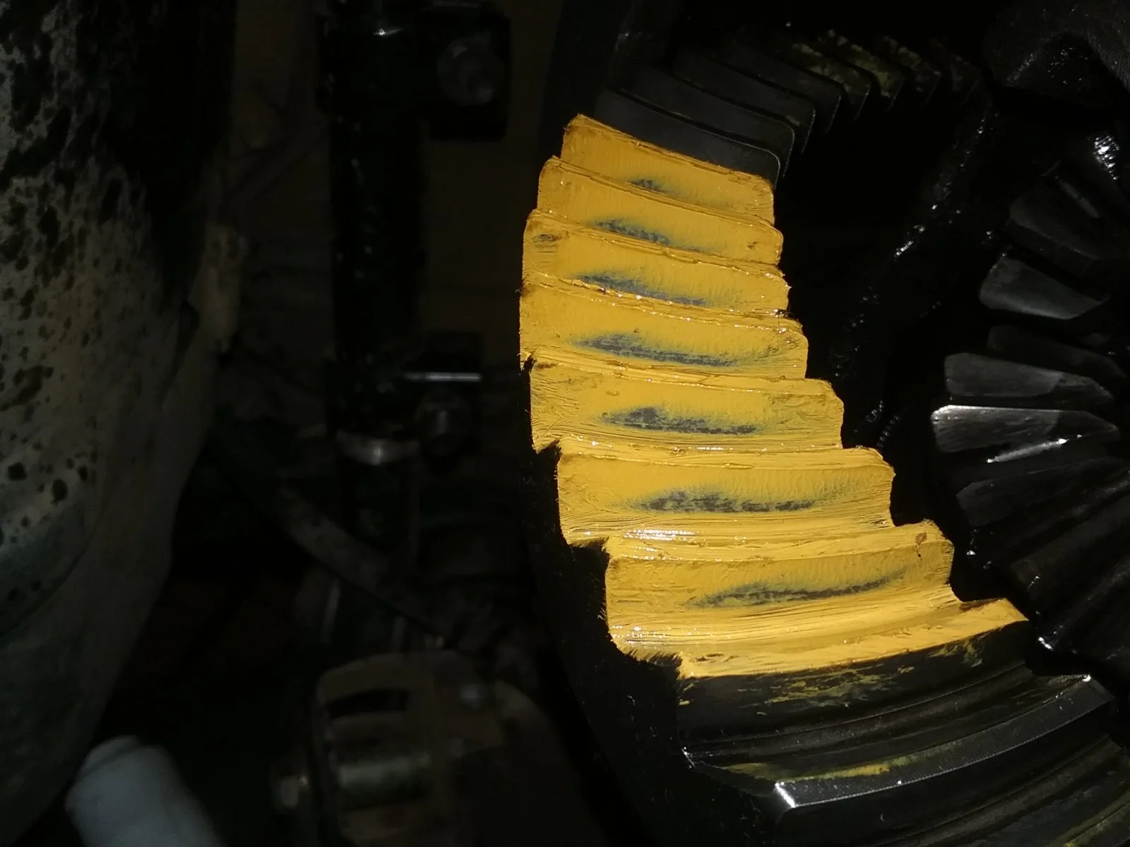

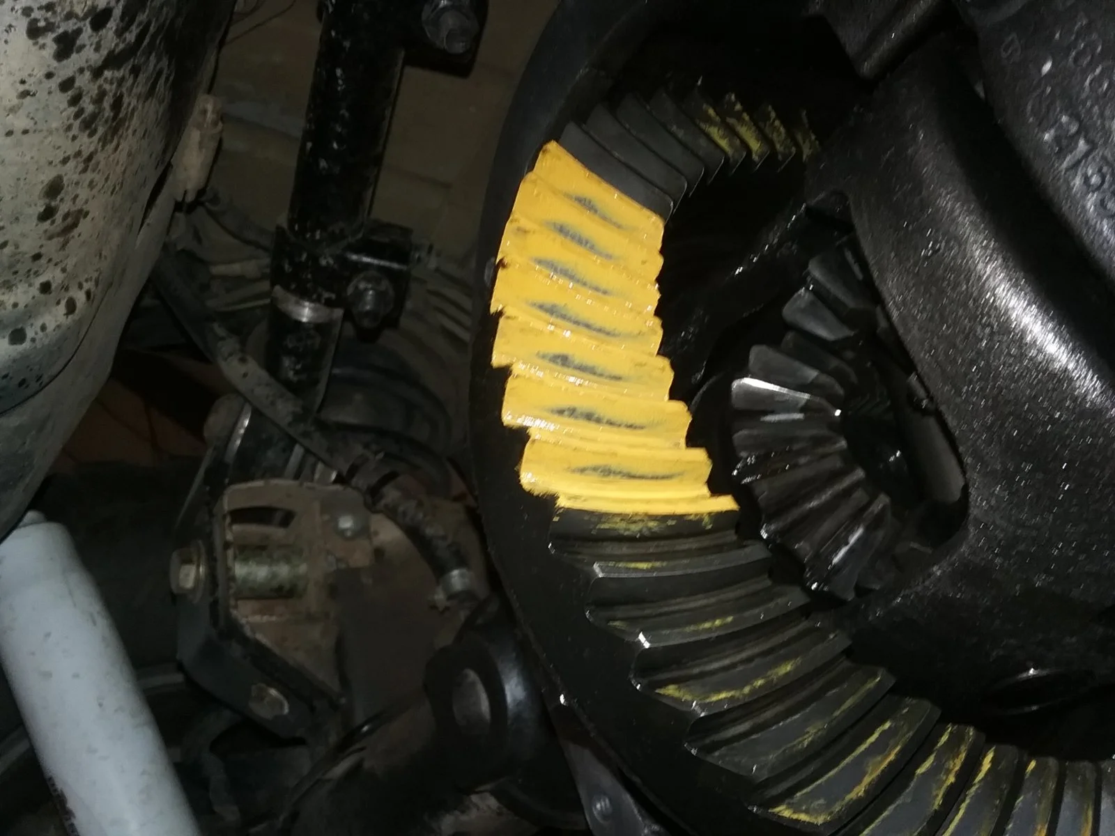

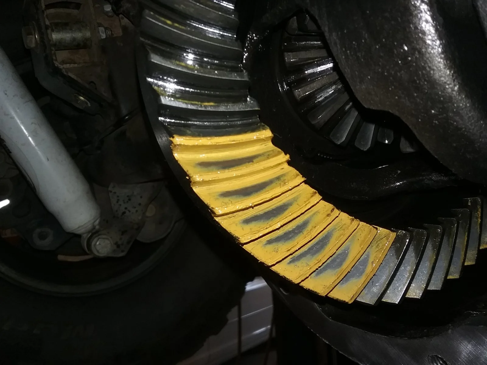

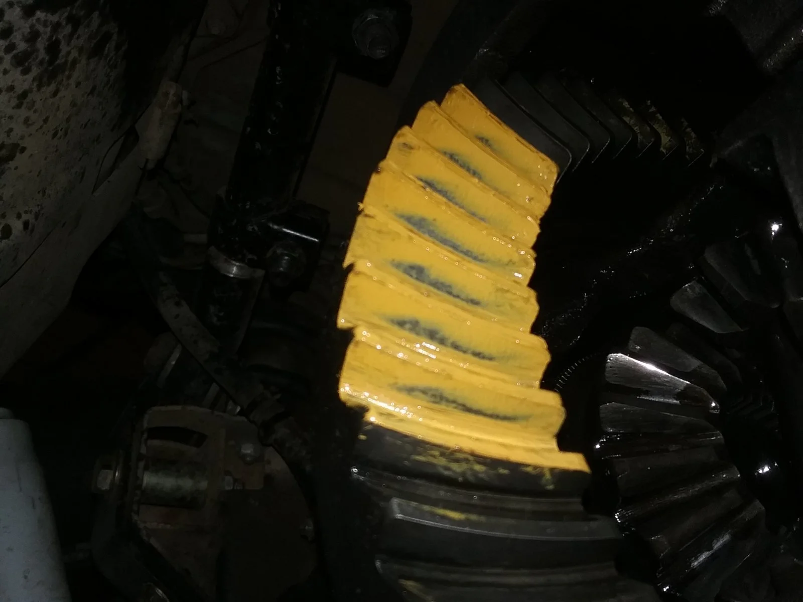

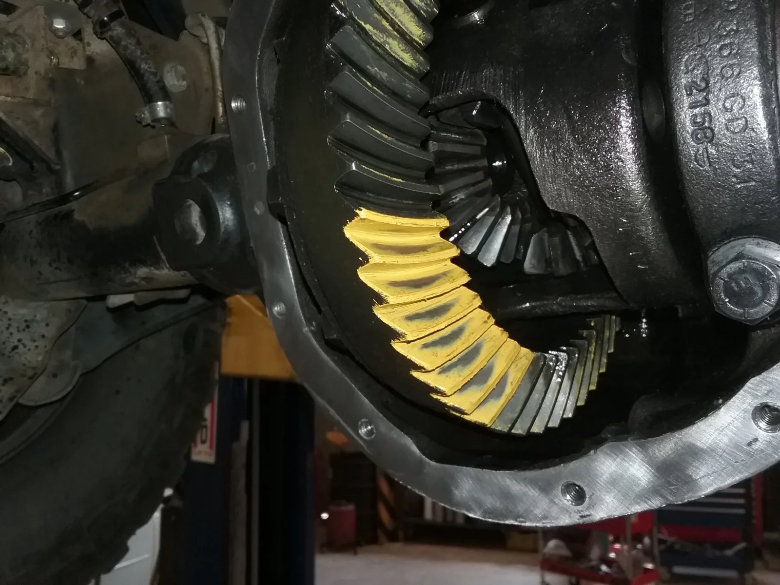

Well, today was the first day I've had a chance to check the jeep for any damage from the Slick Rock run. Nothing too bad really. Few scrapes on the front diff. Diff skid did its job. Front lower arms took a few scrapes. Passenger rock slider took a good scrape. Rear tank skid has a few new dings. All in all, not too shabby. The rear diff cover is leaking. That's new. So, I pulled the cover, cleaned it up and re-sealed it. Gears look ok. Decided to check gear tooth pattern. @Rob5589, or anyone else gear savvy, what do you think? Drive side looks decent. Coast side looks deep to me. Couldn't check backlash, but felt for it, and it didn't seem too loose or too tight. I'd guess .004-.006 thousands by my butt dyno gauge.
Reactions: KCsTJ and JMT
Waaay too deep. BL 4-6 thou is on the tight side.
Not much I can do about this at this juncture. Gears have 25K+ miles on them, so I gather they are set. Yes?
Another experiment I did today was to put the jeep on jack stands and run it up to speed. Went rear wheel drive first up to 70 mph. Felt pretty smooth. Put it in 4hi and ramped up to 65 mph. There's those pesky vibes! Front drive shaft is completing the circuit. I think there's more than one thing going on here. With the coast side pattern too tight, and probably the backlash too tight, I'd gather the pinion depth is also too tight. Could be amplifying vibes thru the drive train some how. Just a thought.
Well, yes they are set but I don't think they are you issue. You'd be hearing some whine or howl from the gears from improper set up. The pinion depth is too deep, bl may be too tight. Going by feel and guessing 4-6 thou is tough. That is nearly no movement on feel.
Just a guess in the dark on the BL since I didn't measure it. I've heard of others who had the pinion depth set wrong encounter vibes at higher speeds, so I was thinking it could have contributed. Like I said, I think there is more going on than the tooth pattern being a bit tight. It also doesn't explain why the vibes happen when the front DS is spinning to speed.
Also, it's tough to hear if I'm getting any whining from the gears as my tires are stupid noisy, so there's that too.
Reactions: JMT
Hmm, not sure. I do not recall ever having a vibration issue due to a gear set come through the shop. And of course, me and my guys would never send one out like that so no help there either.
It sounds more like an issue between the front and rear ds, but you know that already.
