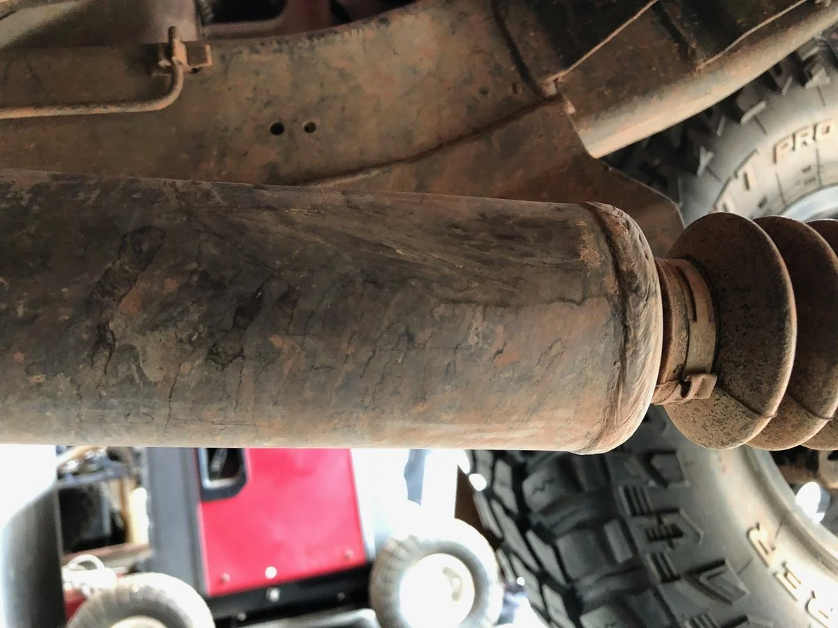

@bobthetj03 I replaced my front driveline today with Tom Woods, and it totally fixed my vibe issue. Here is what I had. I had a smaller what seemed to be a harmonic vibe after a regear, then went to Moab (without you) then encountered a more pronounced vibration. Here is what I had. It was solid as glass till right at 45 mph. then it would start vibrating then about 48 get a little worse and just stay that bad from here on out.
I had new front lower control arm brackets welded on because I bent them at Moab but it didn't fix the vibe. The other day I crawled underneath and looked at everything. Measurements are so close. The front pinion angle is slightly low, but other than that I didn't see anything then low and behold a good sized dent in my front driveline from I am guessing "poison spider." I called Tom Woods, and he hooked me up. Man that is a slick outfit. I called on Monday morning, and it was sitting at my house on Thursday the same week.
Anyhow, I put it in today and no more vibes.

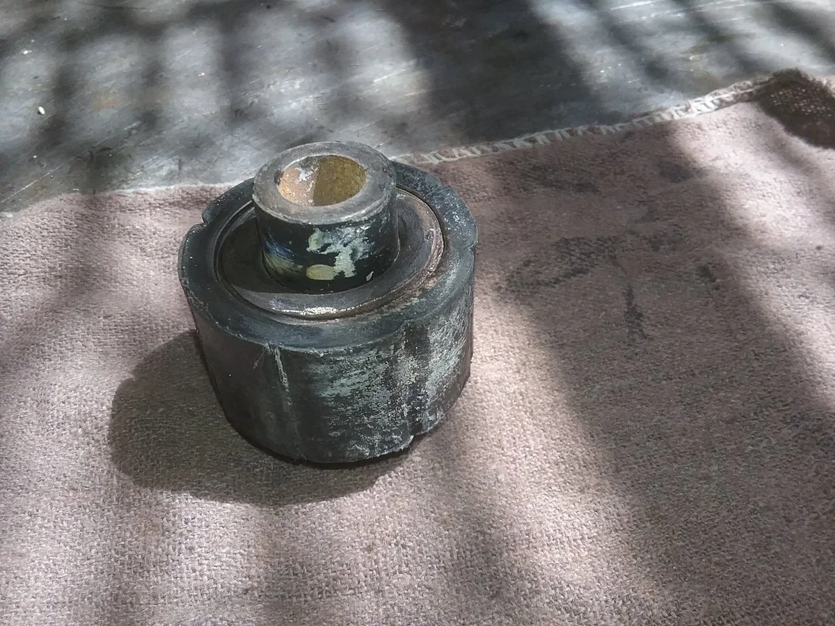

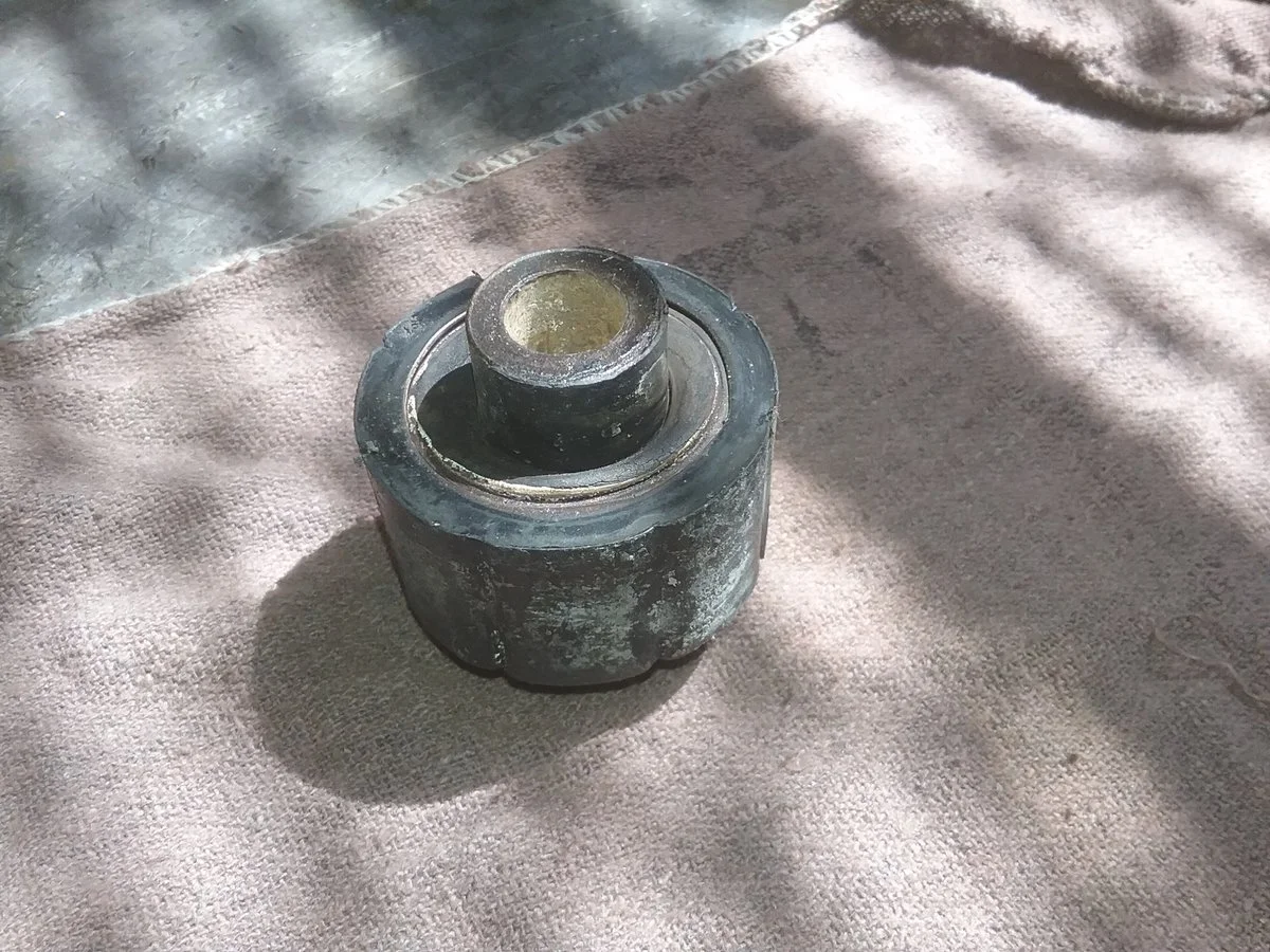

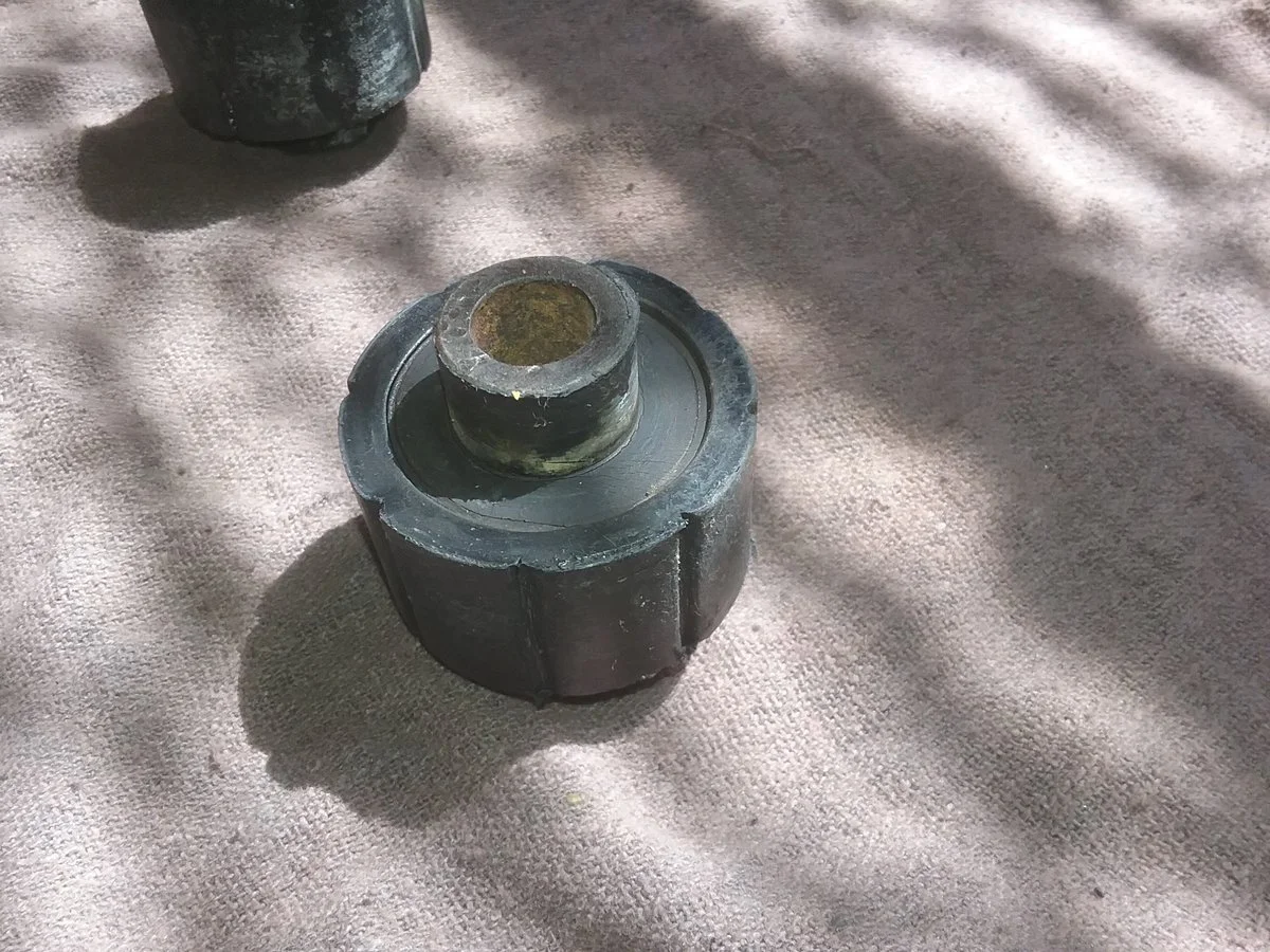

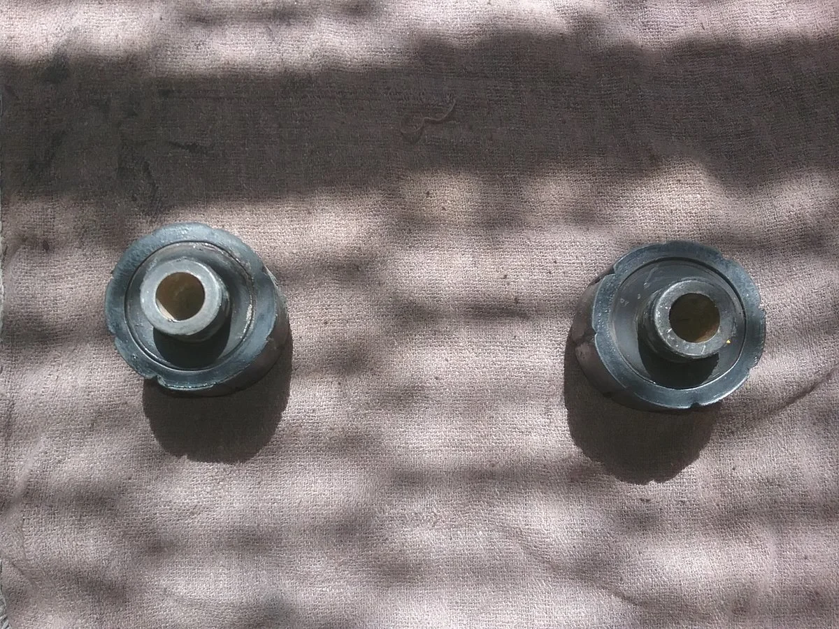

Spent Labor Day laboring over my Jeep a little. Changed out my front upper A-arm frame bushings with a fresh pair. After 70K miles they were starting to show their age. Passenger side didn't look too bad. Driver side showed signs of bulging and cracking. Believe it or not, the front upper factory Clevite's still look ok. Greased the chassis, drive shafts, and torqued wheel lugs. Was hoping to change out the rear springs for the fresh ones I got from @ac_ but it's getting too hot in the shop, so that's good enough for today.
