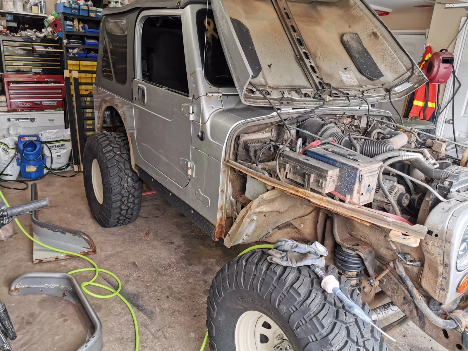

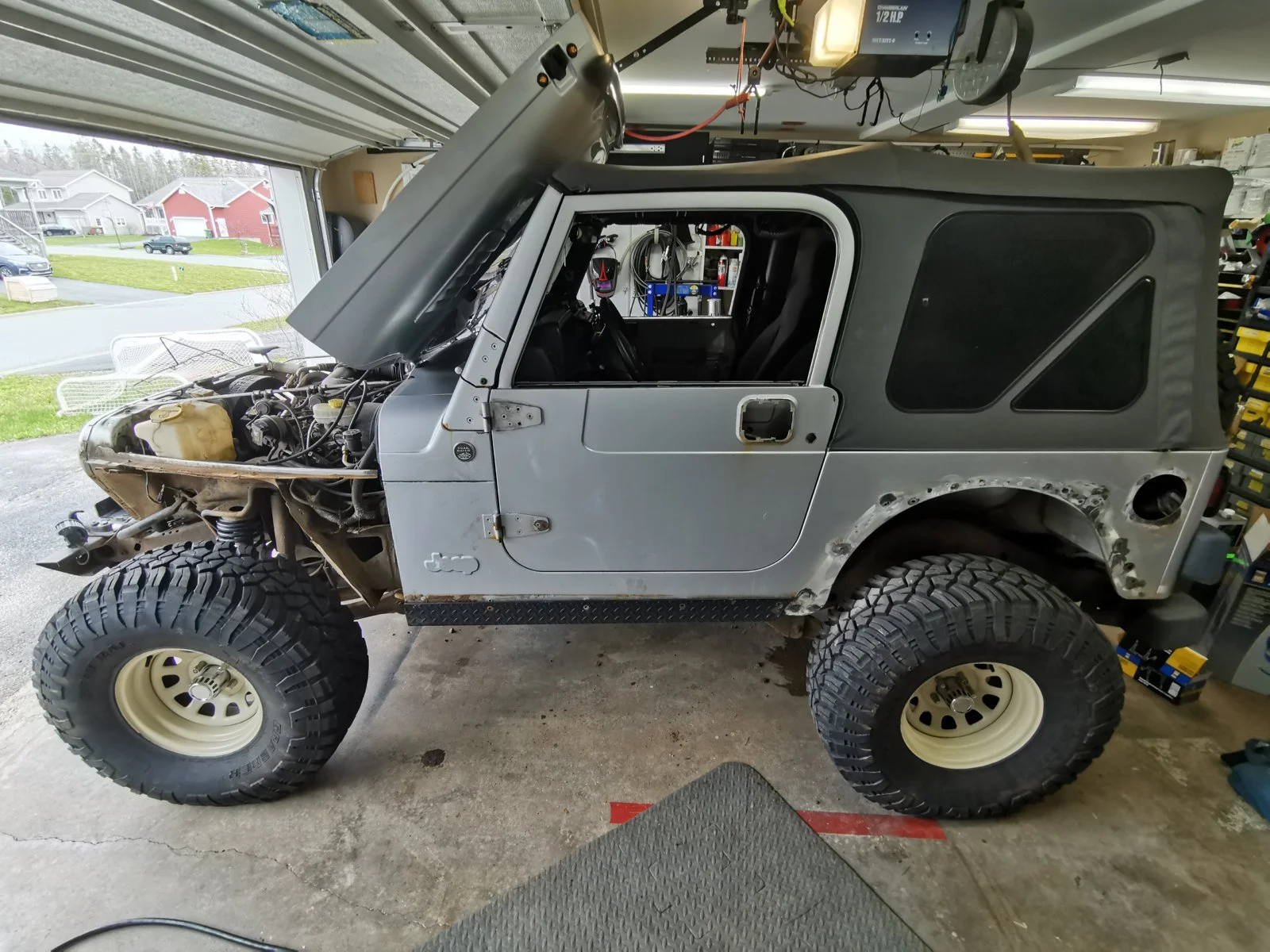

Next week I plan on prepping and painting my Jeep. My plan right now is to remove the doors and hood and paint them off of the Jeep. The hood I could do on the Jeep, but I figured it would be easier to paint the inside of the hood if it's off. I'll be removing everything from the doors and hanging them in the garage to paint. I'll also be removing the tube fenders as I want to sandblast them, then prime and paint.
Anything else I should remove, or any tips from anyone that's painted their TJ before? This is a color change from silver to desert tan. I don't plan on painting the floor, but will be doing as much that's visable as possible.

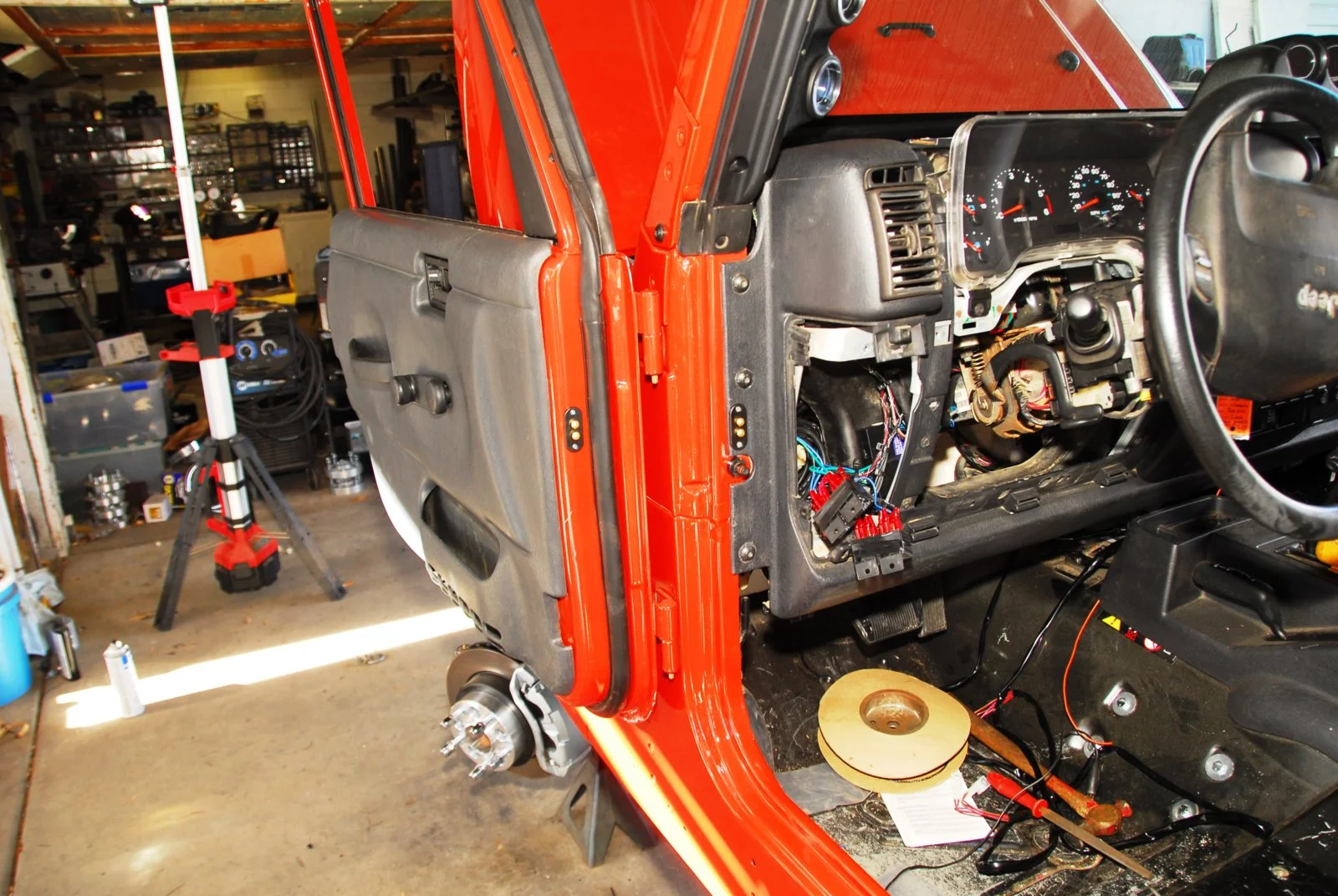

Pick a line to follow to break the paint. The pinch weld that the hood weather strip fits on is a good line to break the two colors. Go through the whole rig and find that line. The toughest one will be where the dash bolts to the area just inside the door openings. If I was doing one of my rigs, I would pull the dash to get that area done easier.
Yeah, that was one area that I figured would be a pain. I really don't want to pull the dash, but I don't mind taking some extra time to mask it off.
We pulled the dash back and hung it in place. It came out decent, not as good as pulling it. You have to choose the break there as well. We left the inside of the windshield frame black since it had a black interior.

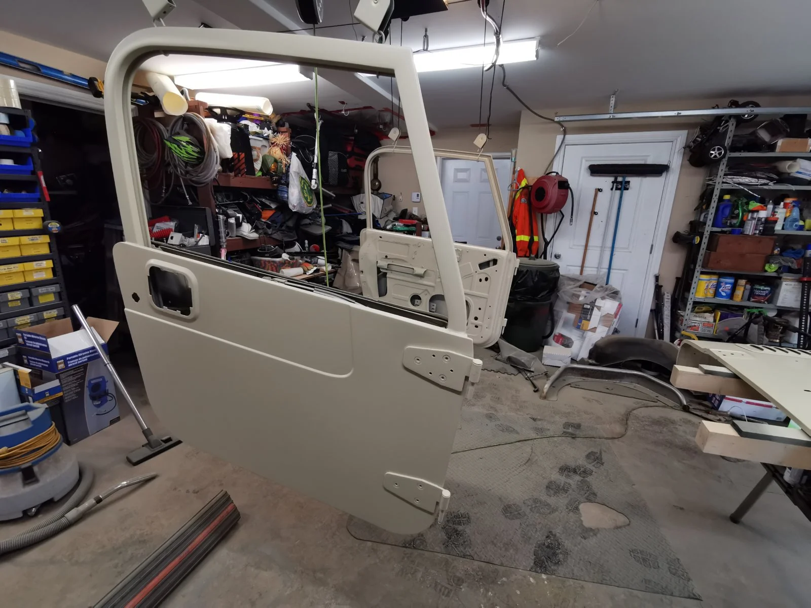

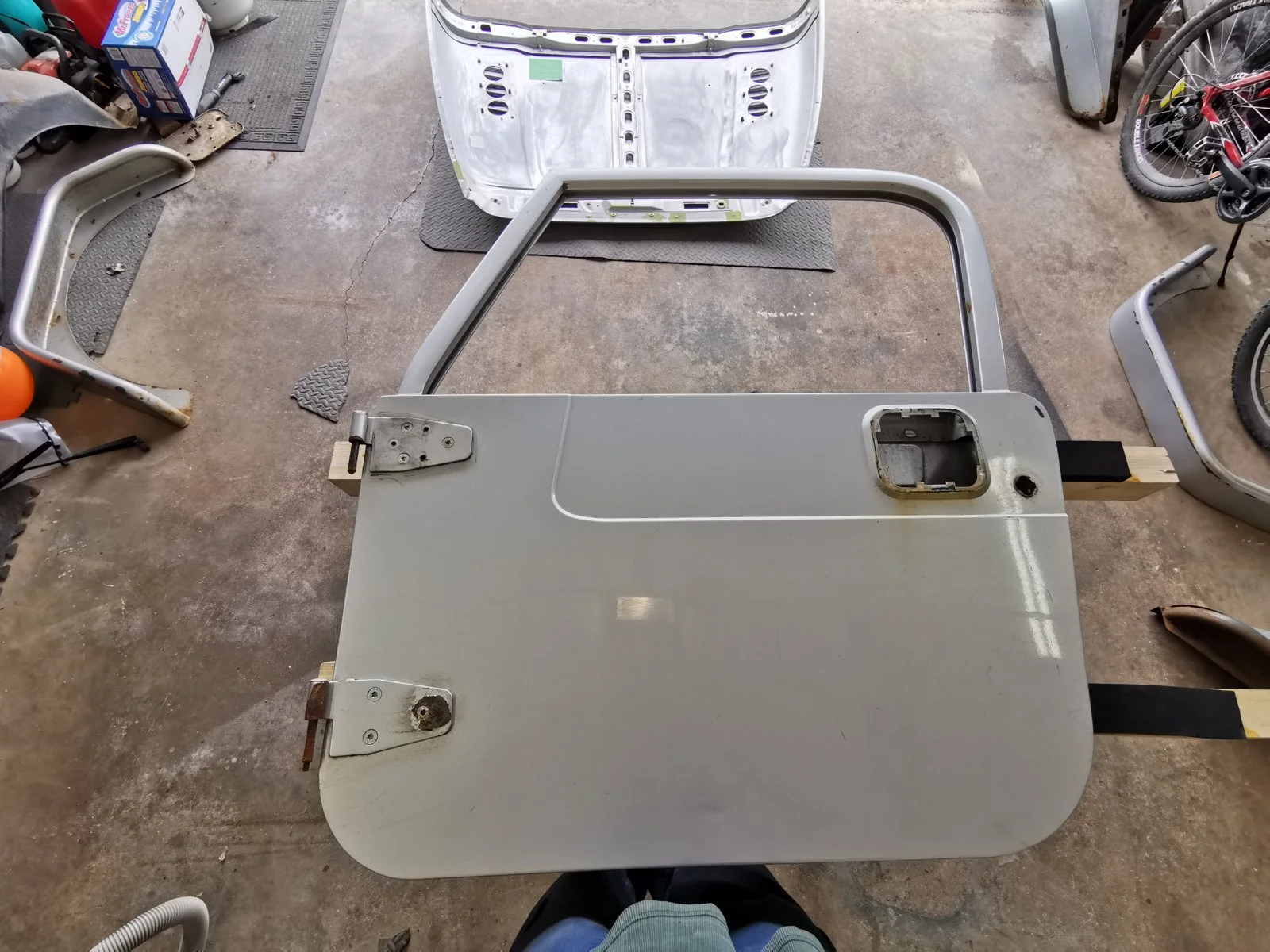

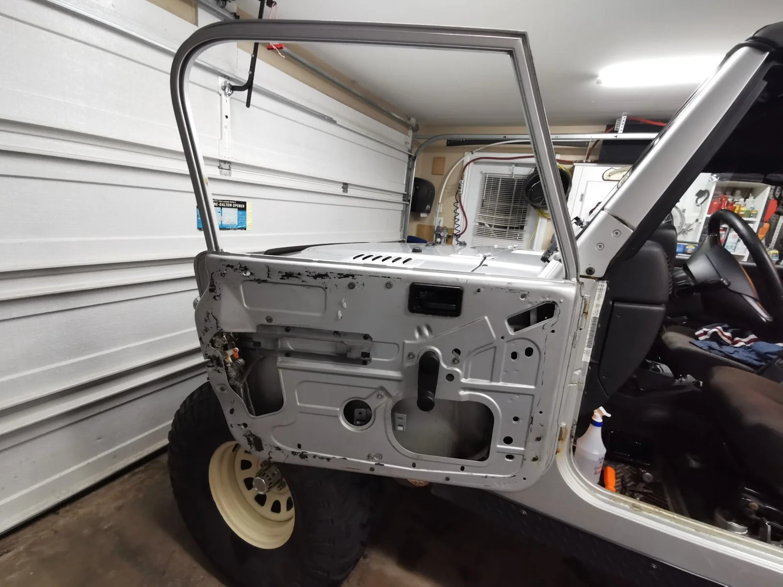

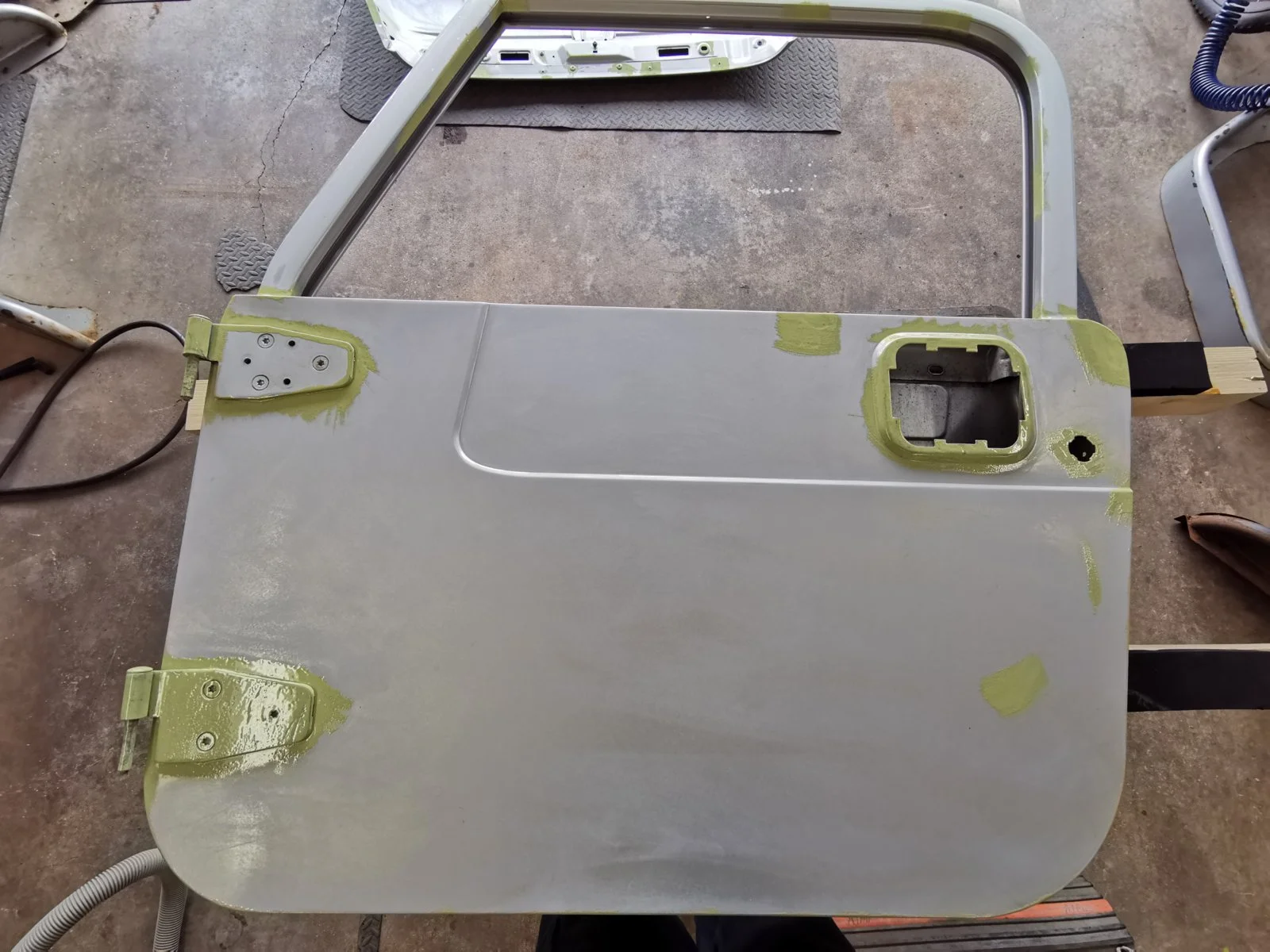

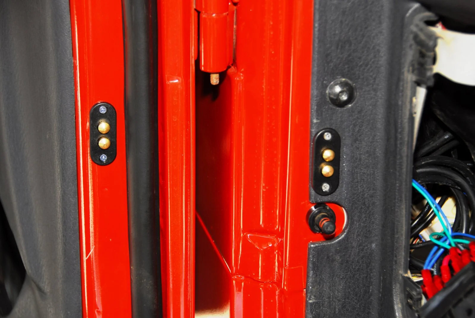

Prep time is starting. Did a quick wash of the Jeep with dish soap to help get the bulk grime off, and I'm starting to strip the doors down. The drivers side door is pretty much ready to start sanding, and fixing the small rust spots.
View attachment 94319View attachment 94320
When you reattach the plastic dust shield, use new butyl rubber rope.
Reactions: derekmac
I was going to ask if the plastic is really needed or not. Mine are in good shape, and I do have a couple of rolls of 3M DUM DUM tape, so it would be easy enough to put back on. Man, that old stuff is nasty to get off!
DUM DUM is not the same in my experience or based on what we used that we called by that name. The old stuff doesn't need to be removed, just paint over to it or under the door panel enough that when the panel is installed, it hides the old color.
