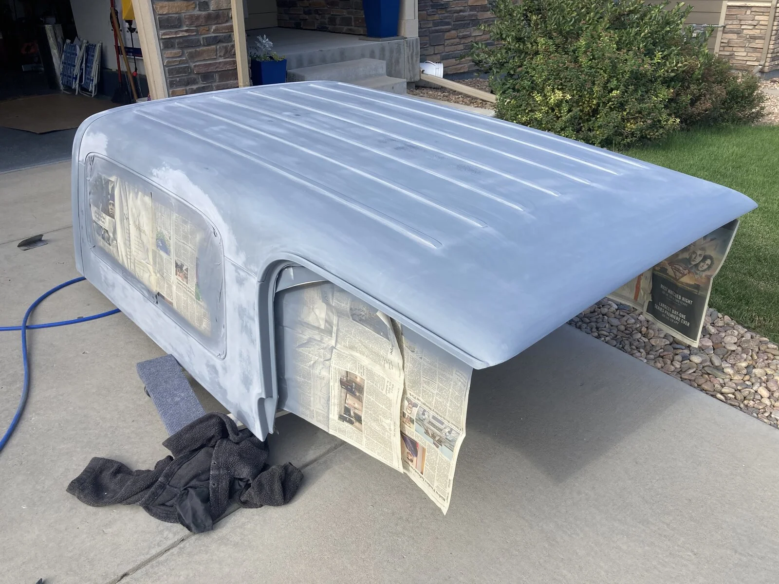

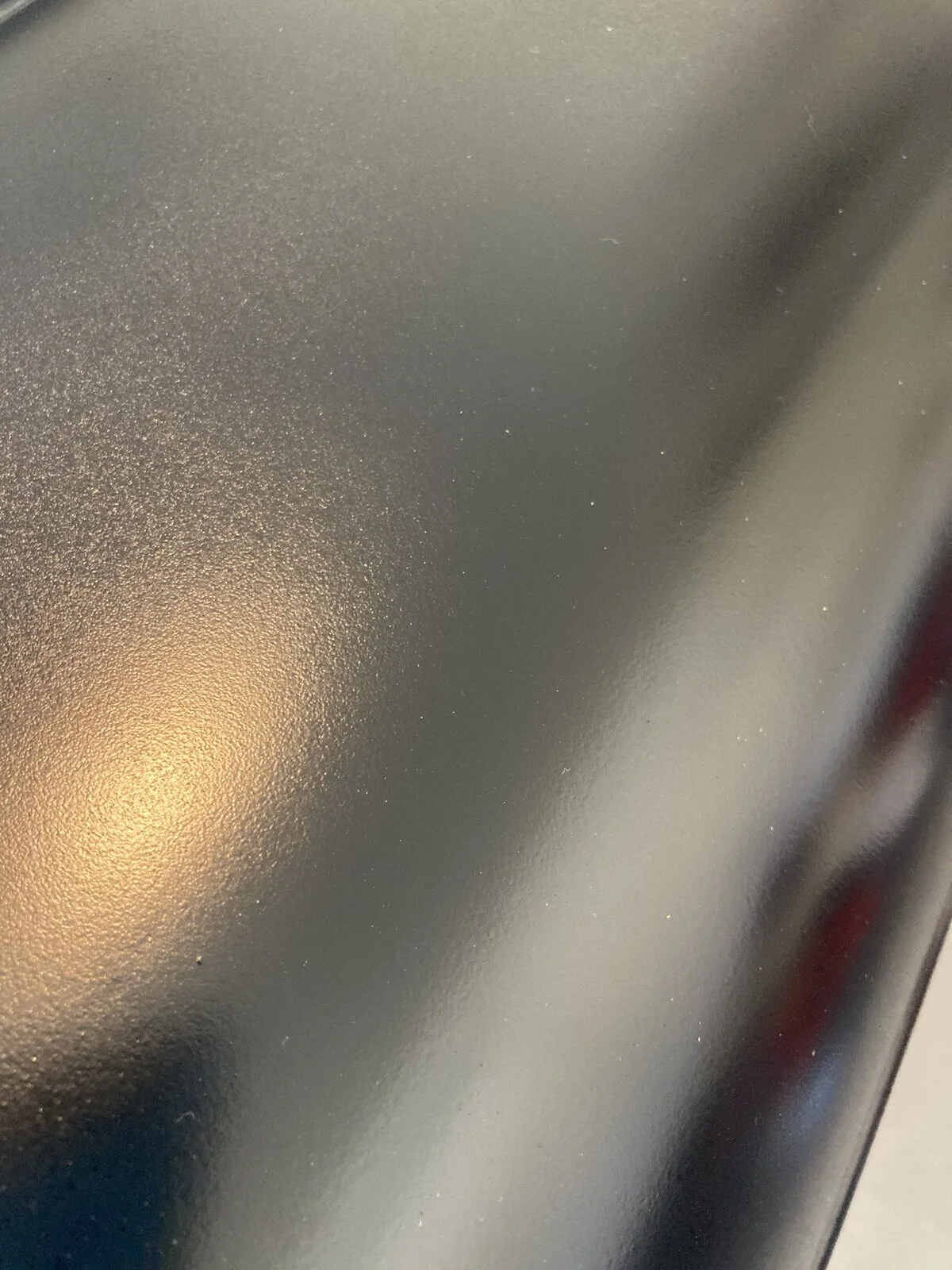

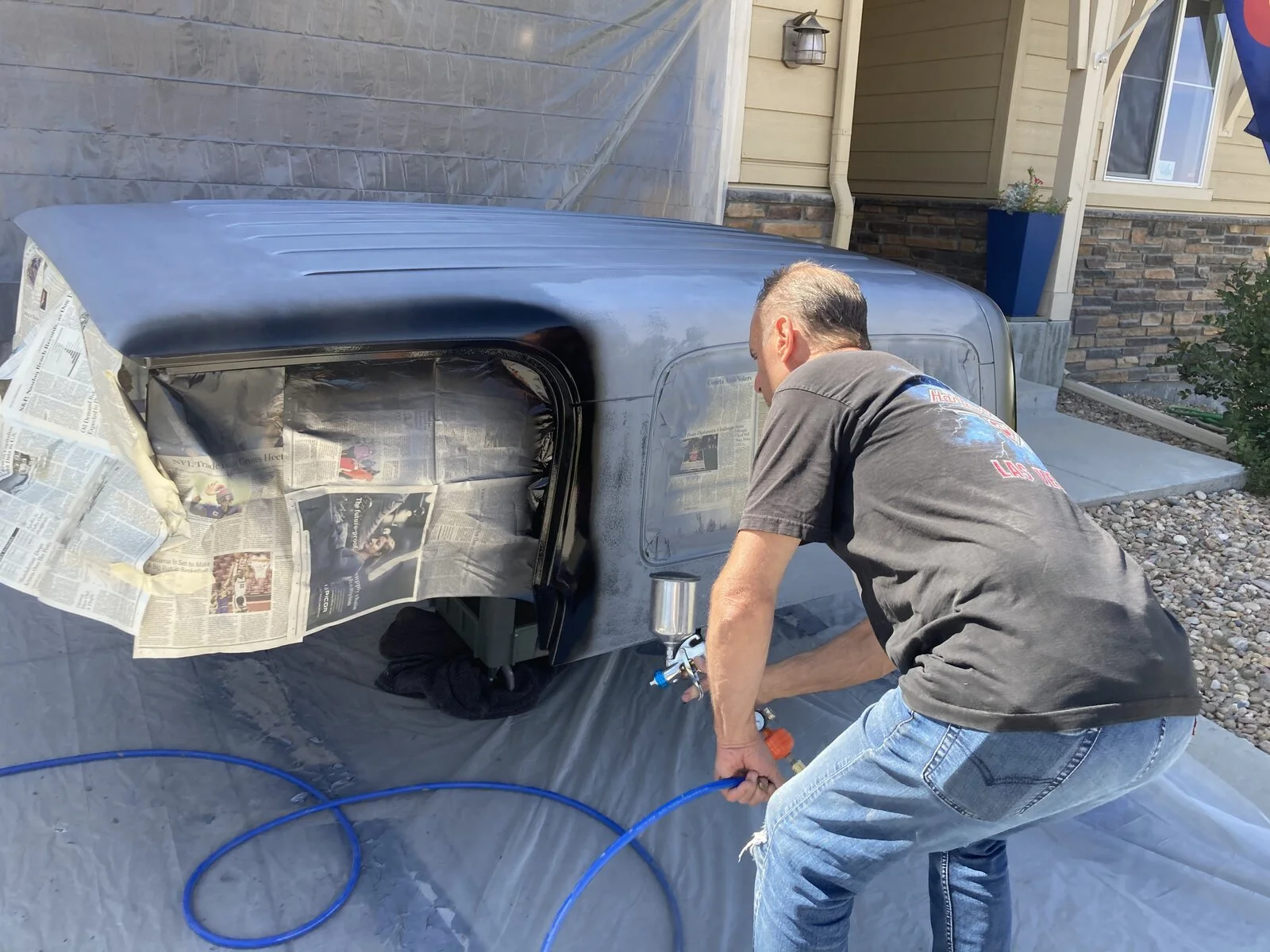

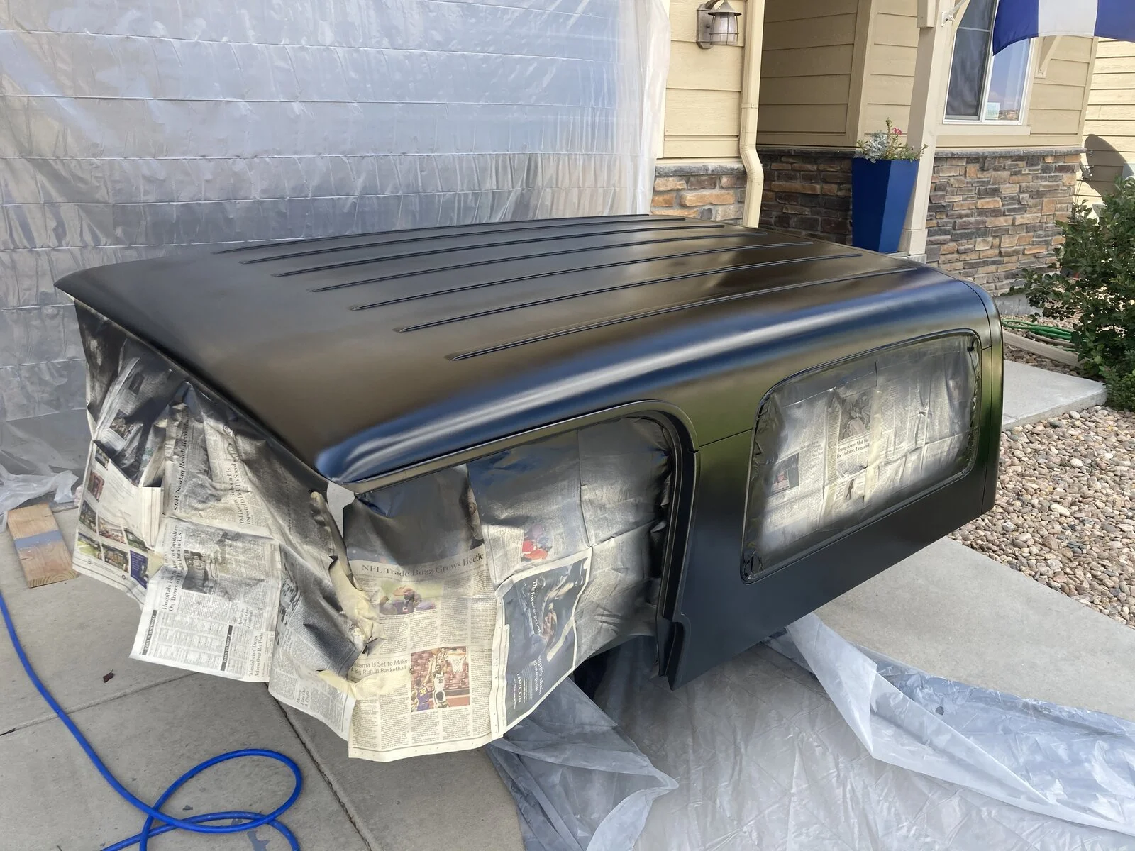

Just did today! I have always hated the cheap looking heavily textured finish, and I had some spots that needed a little body work anyway. Glass cloth, resin, Bondo in spots, no rocket science there. Used 2 part catalyzed high build primer and then the fun began. Orbital sander 80 grit, Wet sand 220, 400, 600. That took most of my free time for a week.
The auto paint store recommended High Tek Hot Rod matte black, its a 2 part one step urethane. One quart was exactly perfect for one heavy coat, and then one lighter coat to get the matte finish I was looking for. Had my buddy come over and shoot the color coats, he’s a lot better at that stuff than I am.
I think it came out great, the finish is more like a JL hard top, and looks much more up to date.
