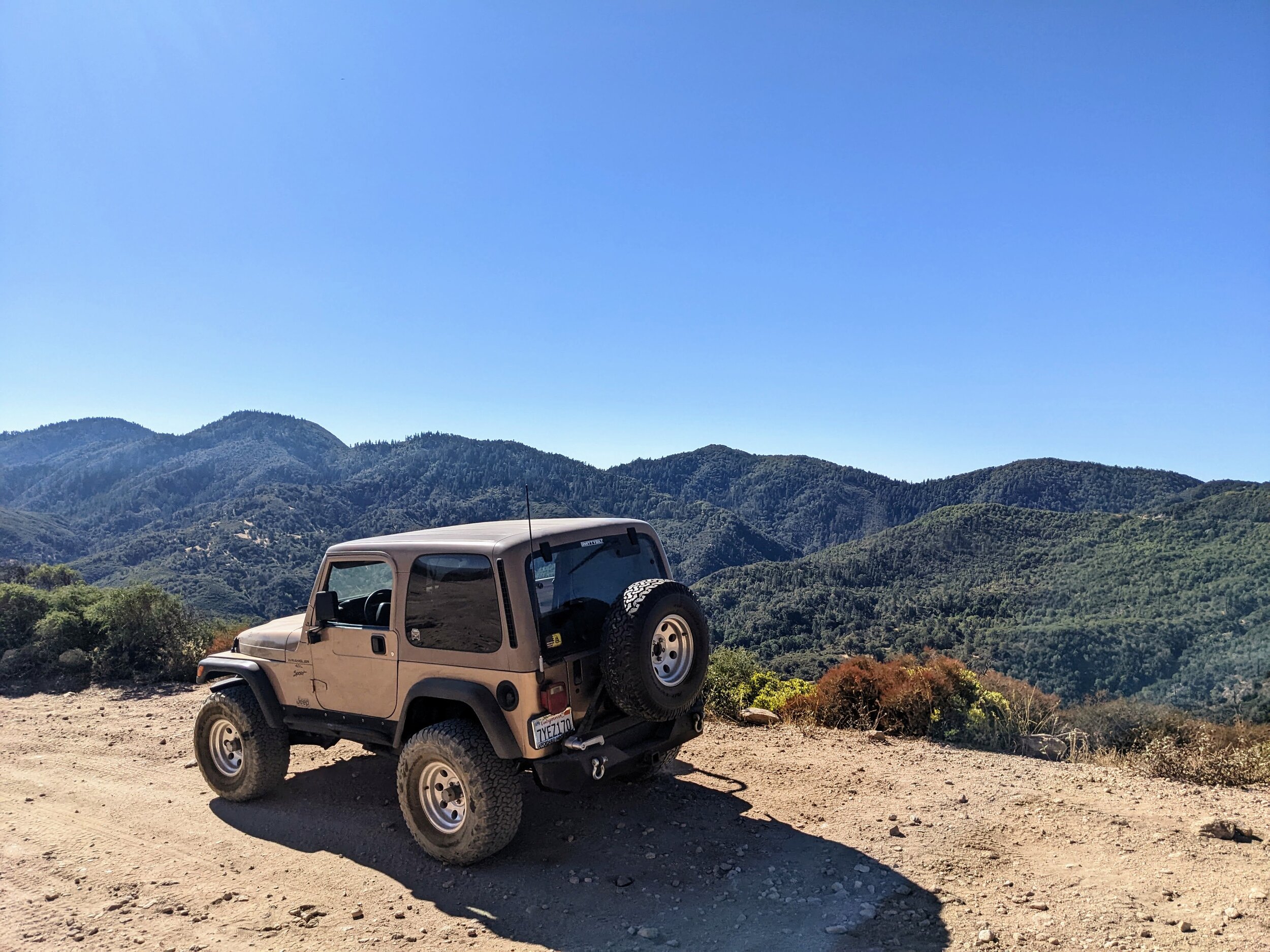

Ever since I got my jeep I've wanted to paint it desert tan down the line and now I'm getting some really bad chipping and peeling on my hood, so at the very least I'll have to sand that down and paint it. So that got me thinking about just doing the whole thing along with the hood.
I'm really not too picky about the idea of high end quality that a shop would provide and I have a personal preference for flat/matte paint jobs. I think off road vehicles look cool without the gloss finish anyway. I've seen some good looking paint jobs(to my eye anyway lol) for 50 to 100 dollars.
So what is the process and what are the essentials I would need to wear down the old paint, get the stickers off, and paint it? As far as I know from videos I've watched, I would need tape and plastic, 80 grit sandpaper, a torch to heat the stickers for removal, a cloth to wipe it down, and about 6 to 8 cans of rustoleum tan. I just wanted to make sure I'm not missing anything and just find out what the general process and application timing is in case anyone here has done something similar or knows how to.
