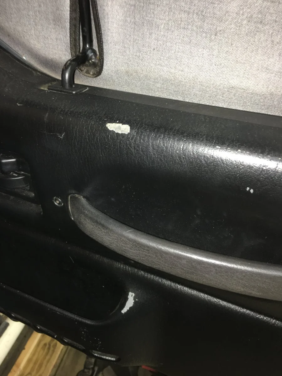

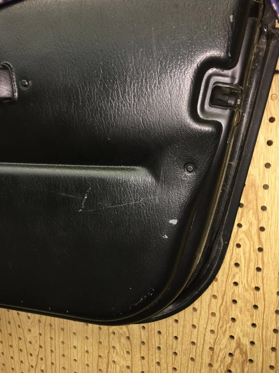

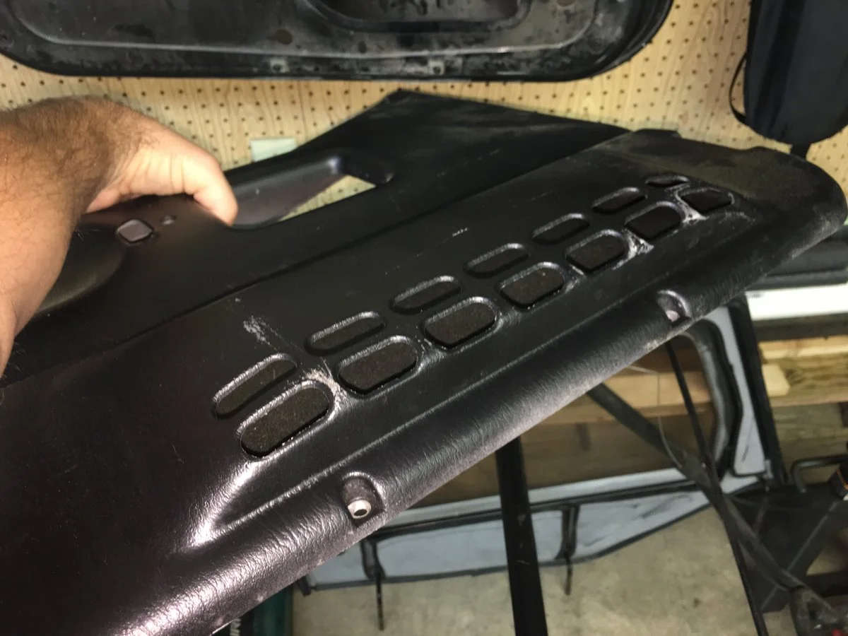

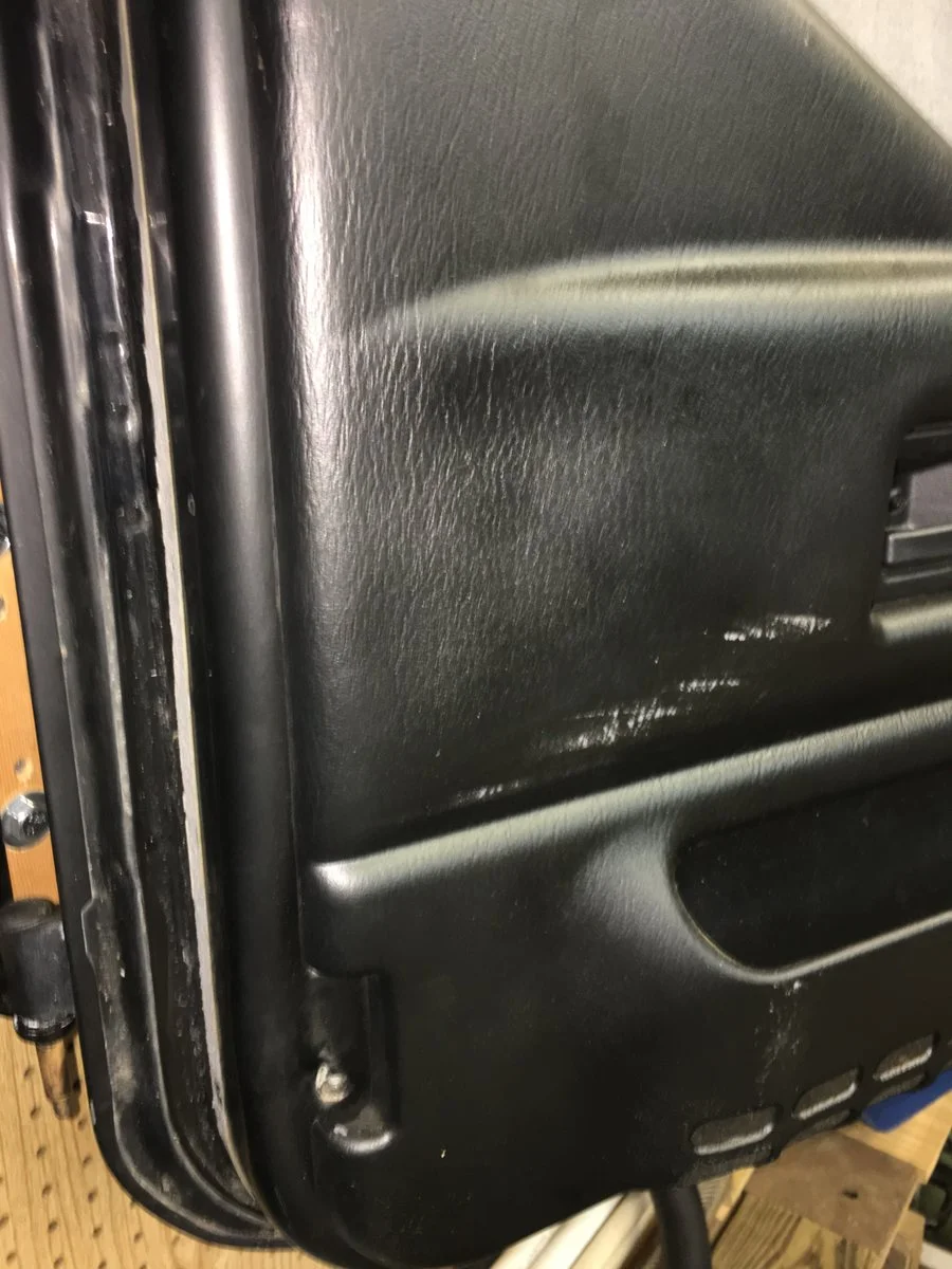

My situation has a wrinkle in it though. The half doors I bought had panels that were originally gray but had been painted black. The finish isn't terrible, but it does have some wear spots and scratches. No major peeling or flaking.
SEM also told me if I had any raw plastic showing I'd need to use the correct adhesion promoter and to let him know and we would discuss that. I told him I'd imagine there would be after I scuffed the area with a gray 3M scuff pad, but I haven't heard back from him yet.
A friend who did body auto work for a while said he has painted many door panels with SEM. He said he washed thoroughly with Dawn dish soap, let dry, scuffed with a scotch bright pad a isopropyl alcohol and they painted with SEM and always had good results.
I don't know if i need to use adhesion promotor or not with it already painted before. I don't mind using it, I just don't want to mess it up. After scuffing, will adhesion promotor on top of whatever kind of paint that black paint is hurt?

I would use the adhesion promoter. (It comes out like a smooth clear coat.) I only say use it as you have multiple surfaces your trying to cover. The black paint and the parts where the black paint chipped off and shows the plastic. I think your better off covering your bases and using the adhesion promoter over both surfaces. Just to make sure the color coat sticks long term.
I would also scrub the hell out of it with grey auto body scotchbrite pads. I used those before the Dawn. And with the Dawn.
