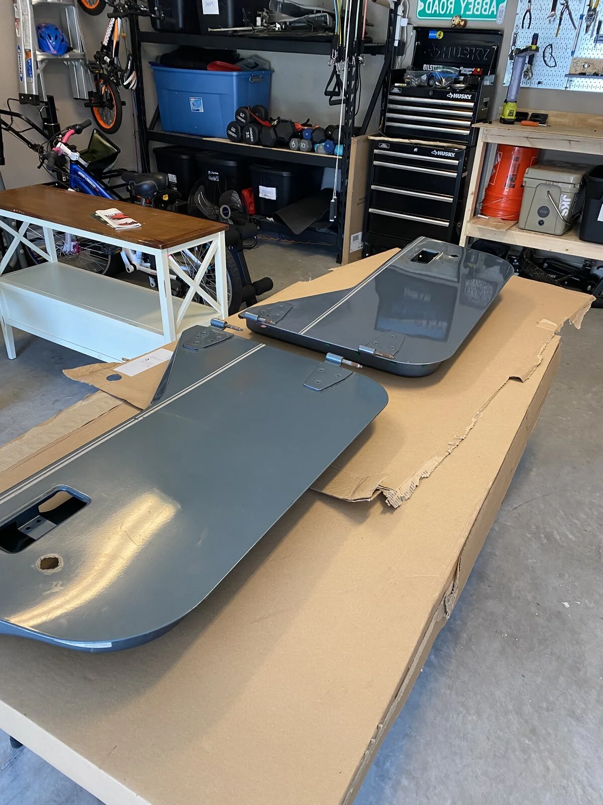

I'm doing a complete colour change (original Bright Silver to grey) except for under the hood with no edge blending of any primer or paint. I've done it this way before without any problems. I do have a few areas where I'l be going down to bare metal and the whole panel will be primed before painting.

We never did a color change without full prime coat - post up your results when you're done, I'm curious to see how well it comes out. I do not envy you spraying silver pearl :)

Finished removing adhesive from a door seal today, it might as well have been welded on. Got the paint and did a test run, pretty pleased with the results for PSB in a rattle can. We will know how it turns out by tomorrow night!
