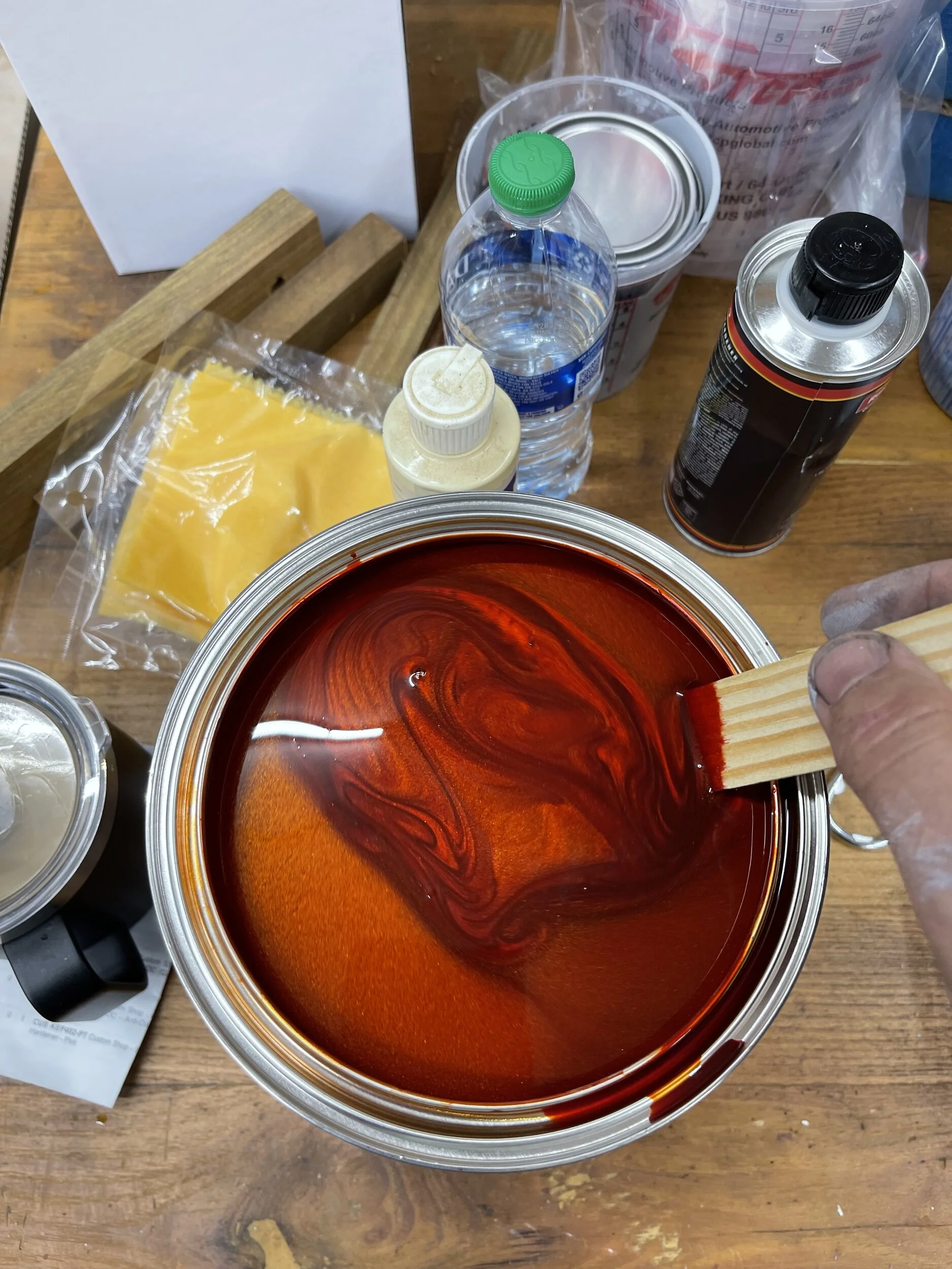

This one’s for the auto body guys out there. So while I’m waiting motor and other things I’m painting the TJ. I went with a single stage urethane from restoration shop. Body is in great shape, other than hood and one fender the paint is actually in good shape. Question is can I scuff the original paint and spray over it? I did an old dodge Dakota years ago with the help of a family member that had some experience painting cars. I know for a fact we didn’t strip to bare metal and I’m almost positive we didn’t prime or anything before spraying. Paint turned out pretty good for having doing it in a garage without no floor other than the dirt. Only spots I had issues with was around rocker panels where I imagine didn’t get sanded well enough. What are your suggestions on getting a decent paint job without stripping down to bare metal? Can it be done? What steps do I need to take if so? Thanks in advance. Oh not going factory color if that makes any difference. Dakota was two tone grey and we painting it red. TJ is gunmetal and I’m painting it orange.

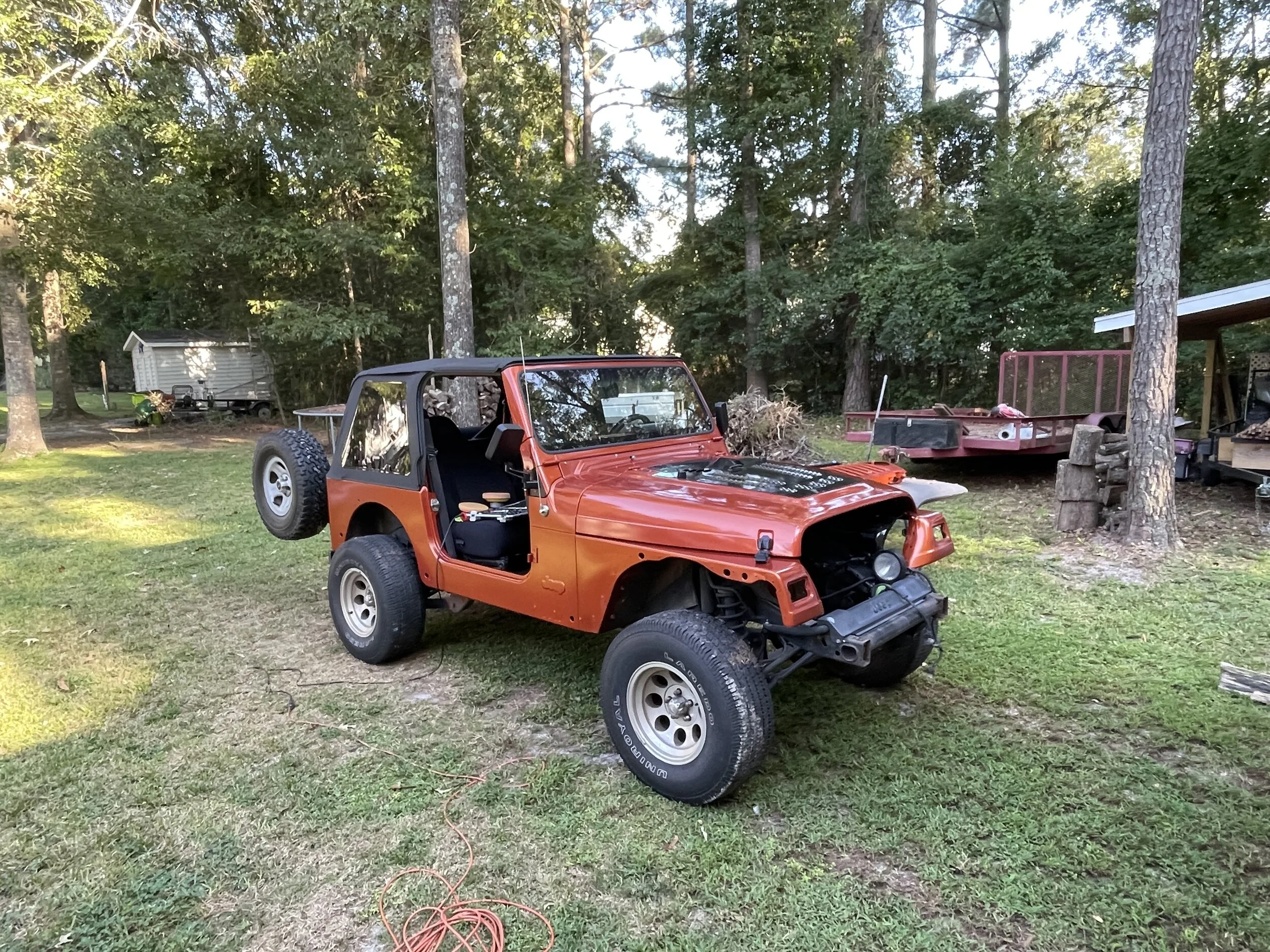

That depends. If the paint/clear is letting go mechanically, then that area will have to be taken to bare metal. If your paint is in good condition, then a scuff-and-shoot is possible. You will still need to do body work, prime and seal before shooting color.
Why single stage?
Which orange? I REALLY want to sand down my Black '97 and paint it Impact Orange... best color EVER.. IMHO.
Inferno orange pearl metallic

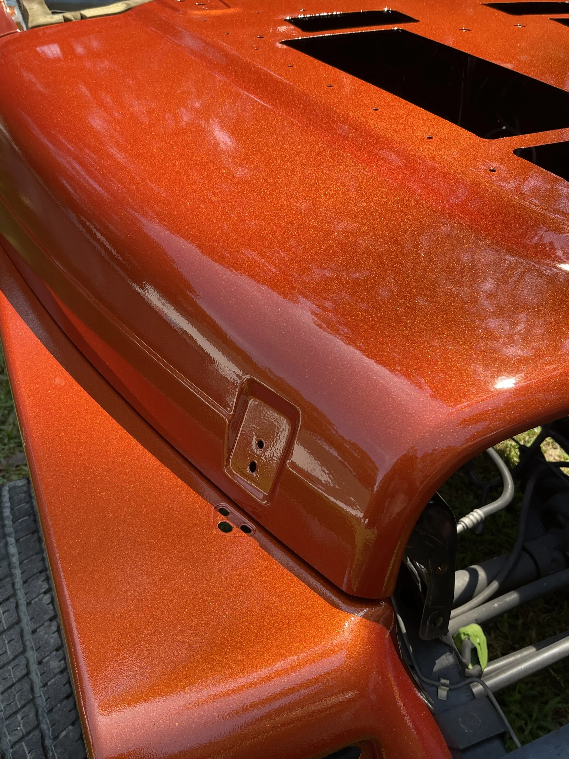

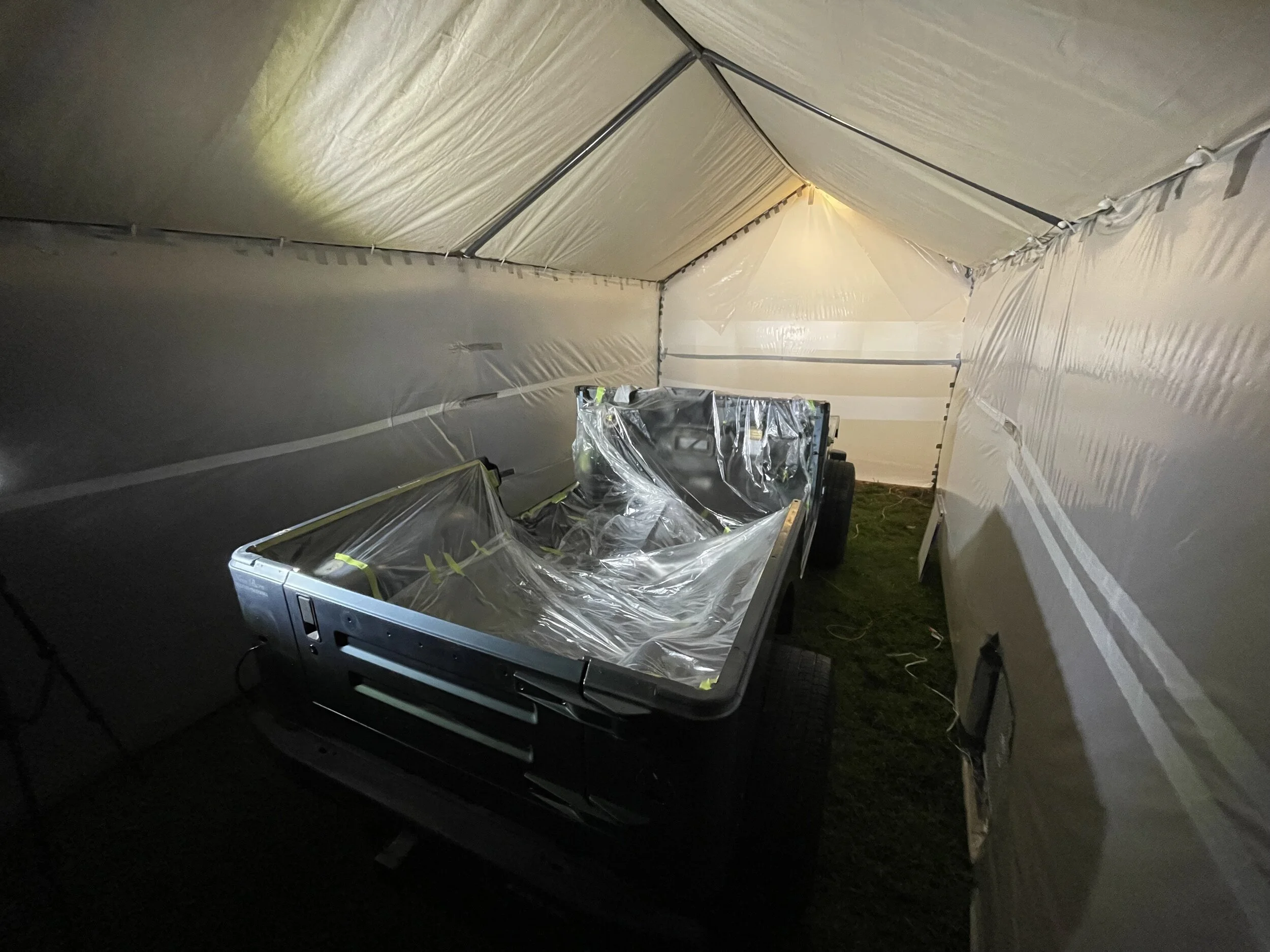

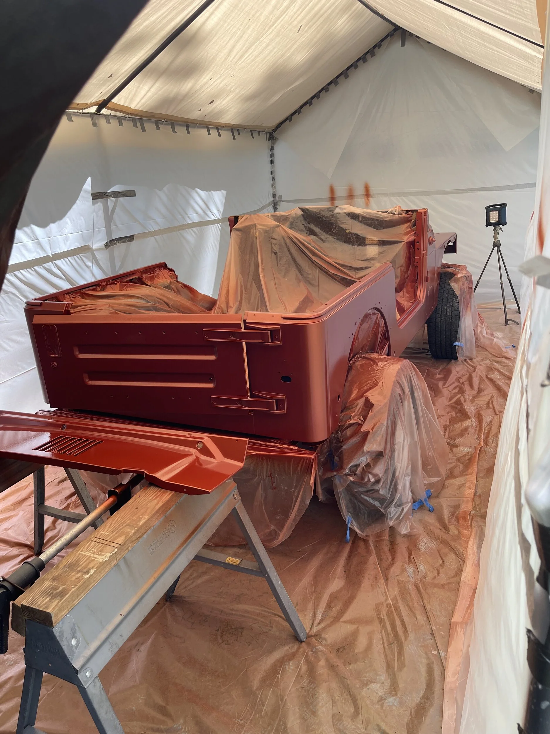

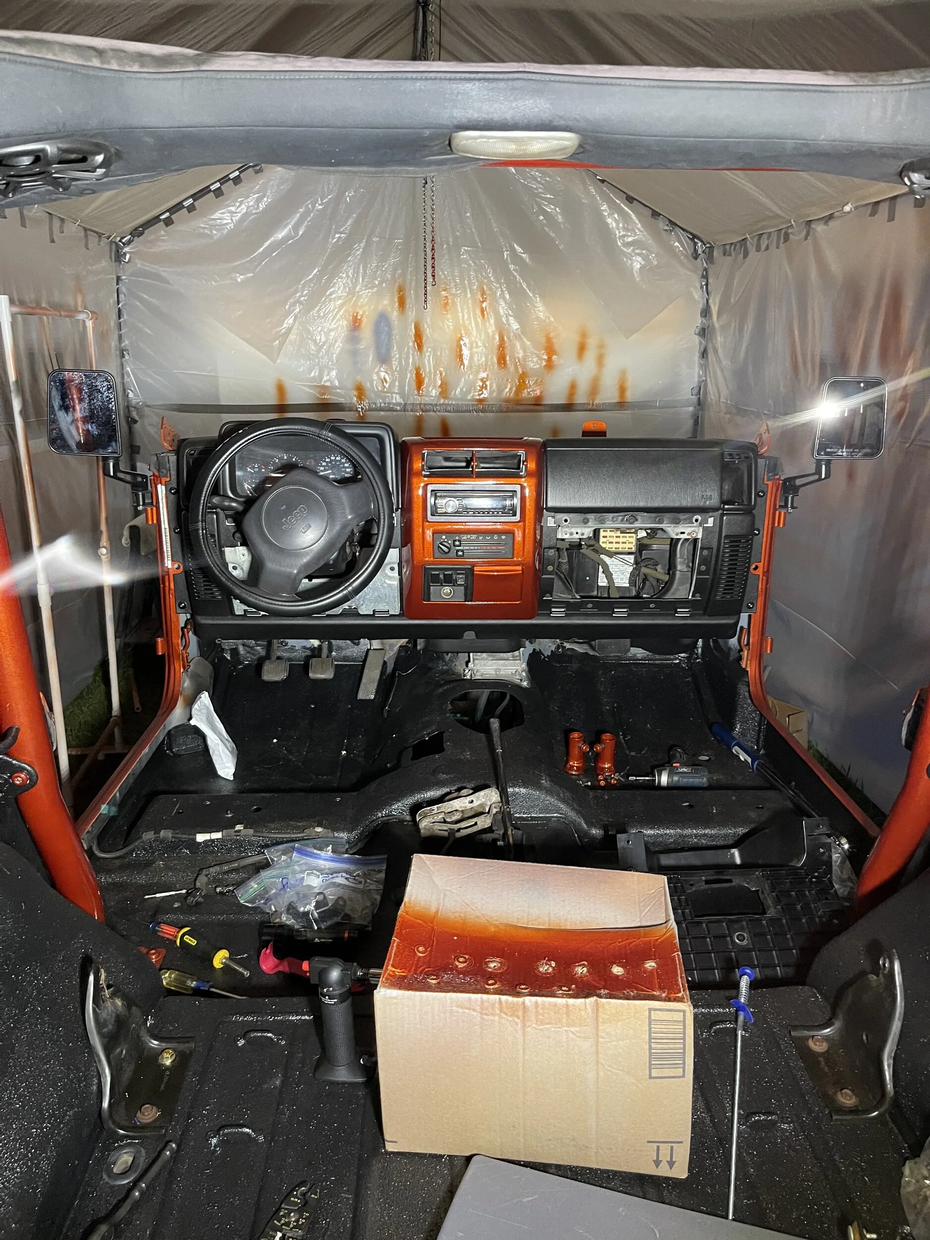

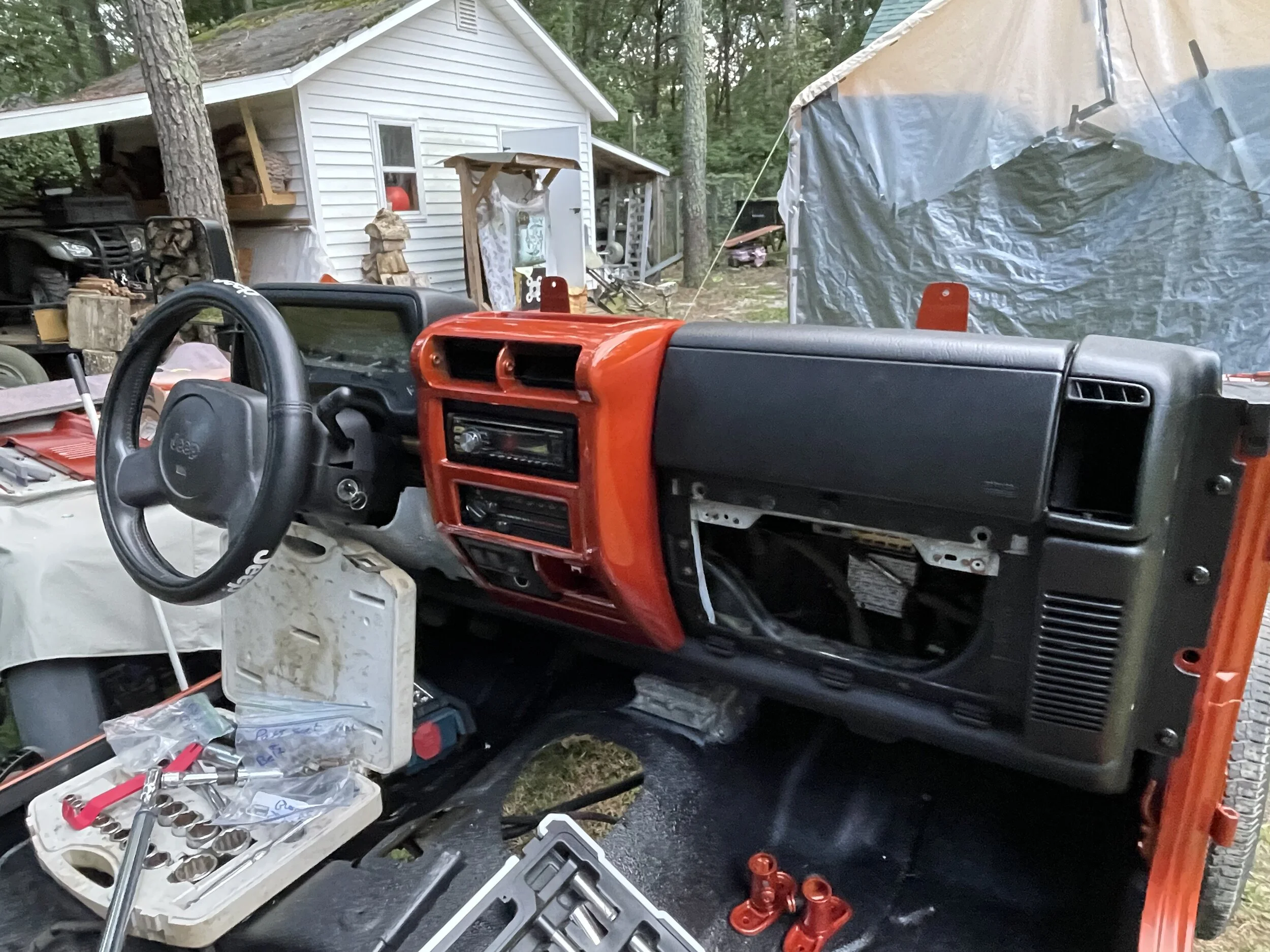

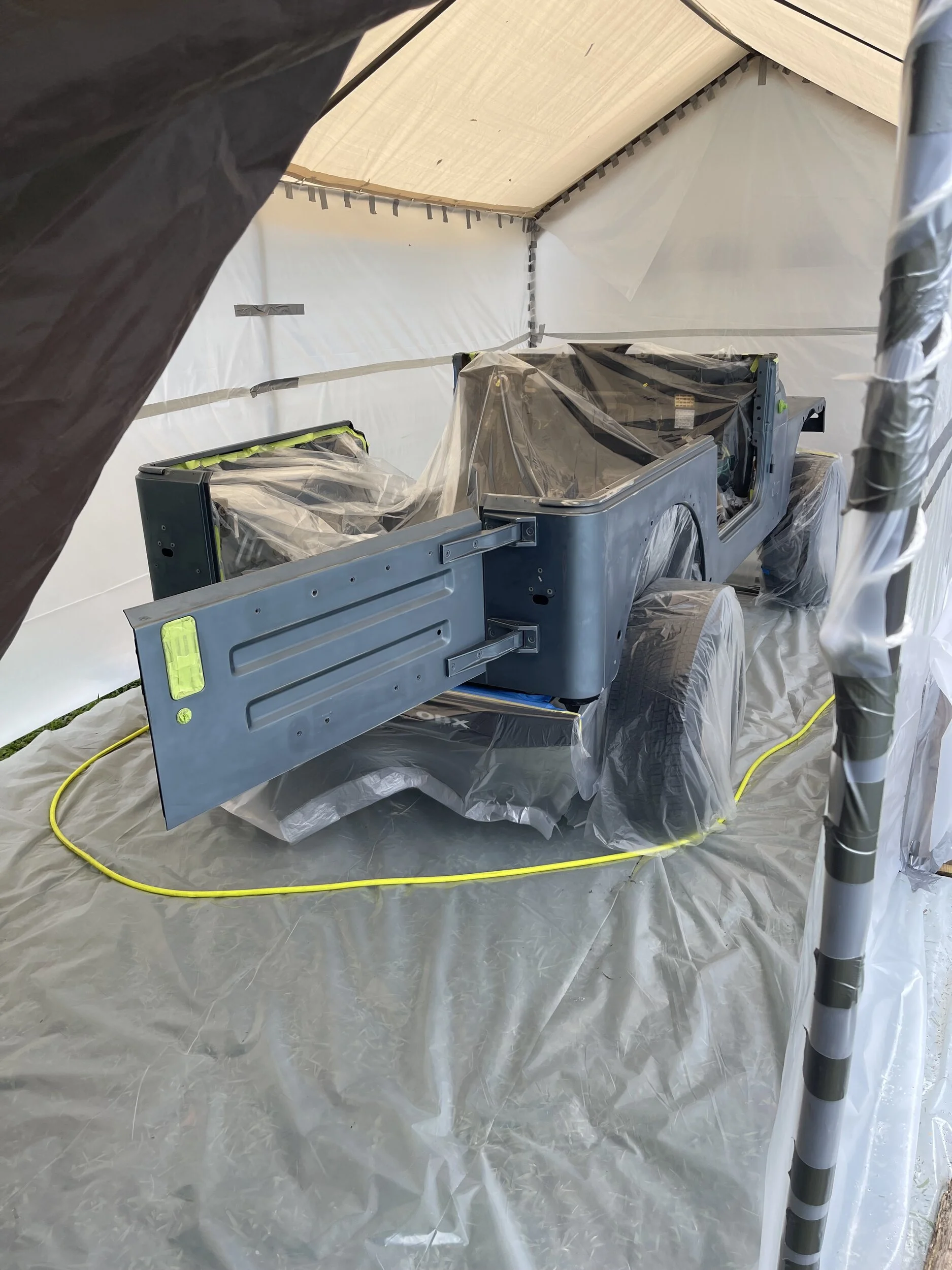

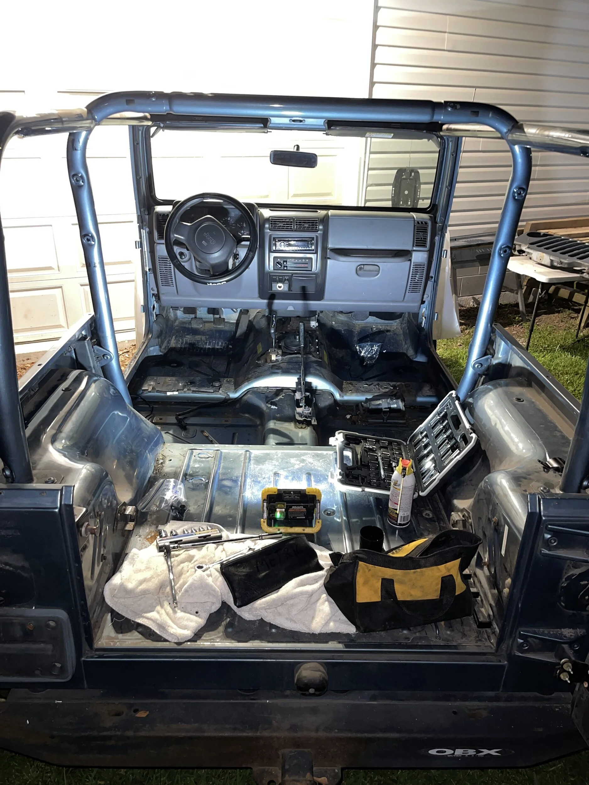

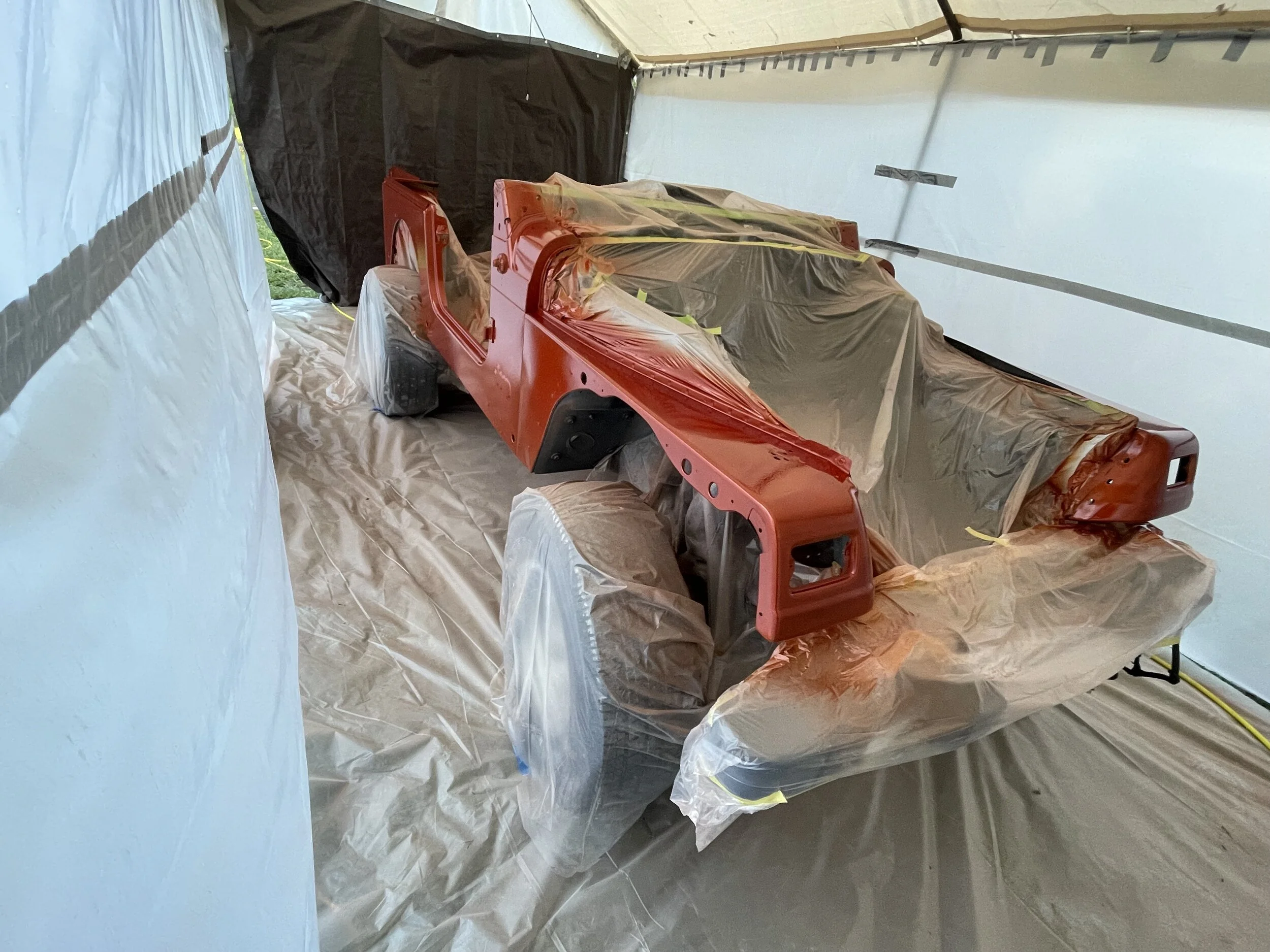

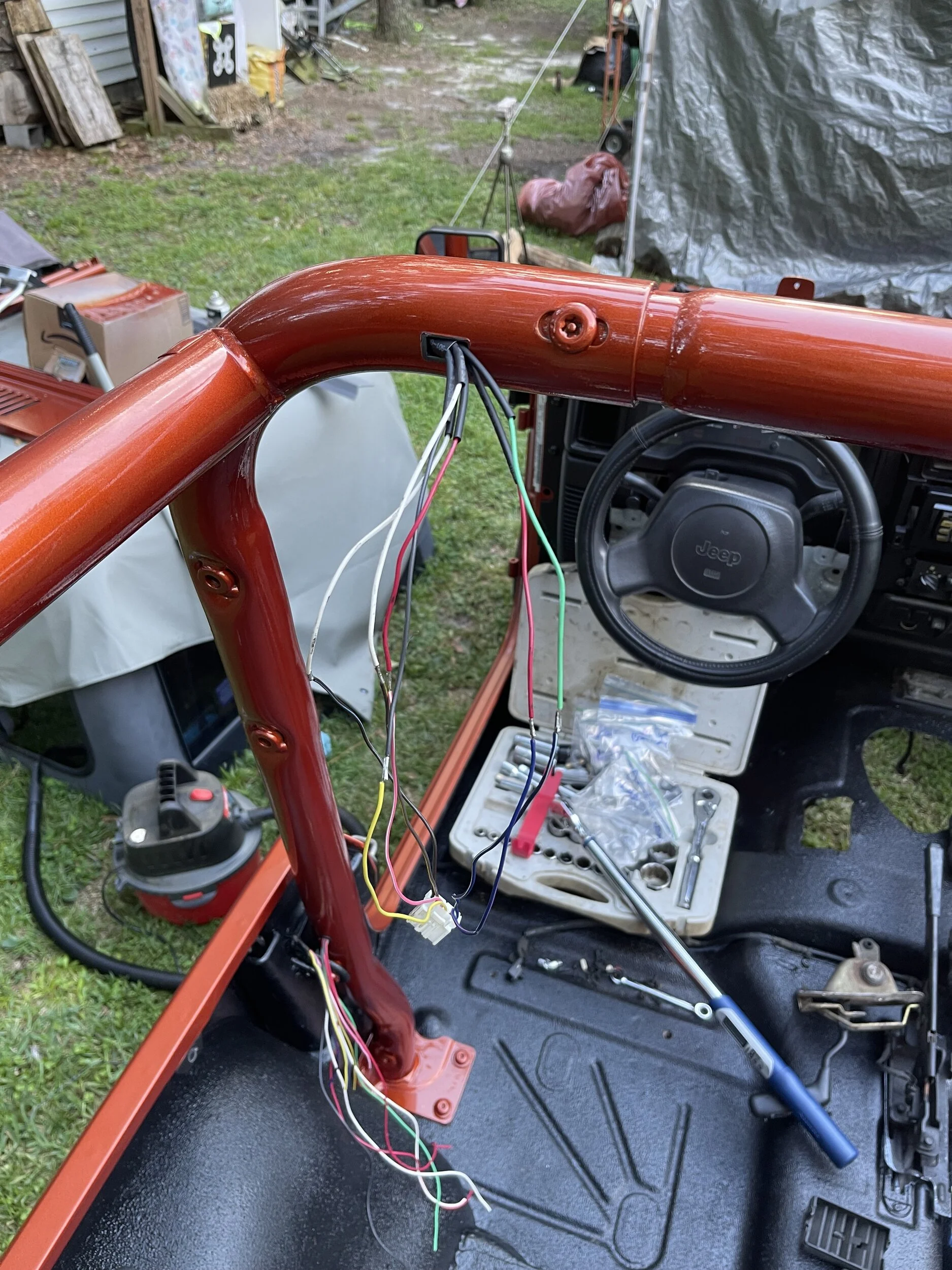

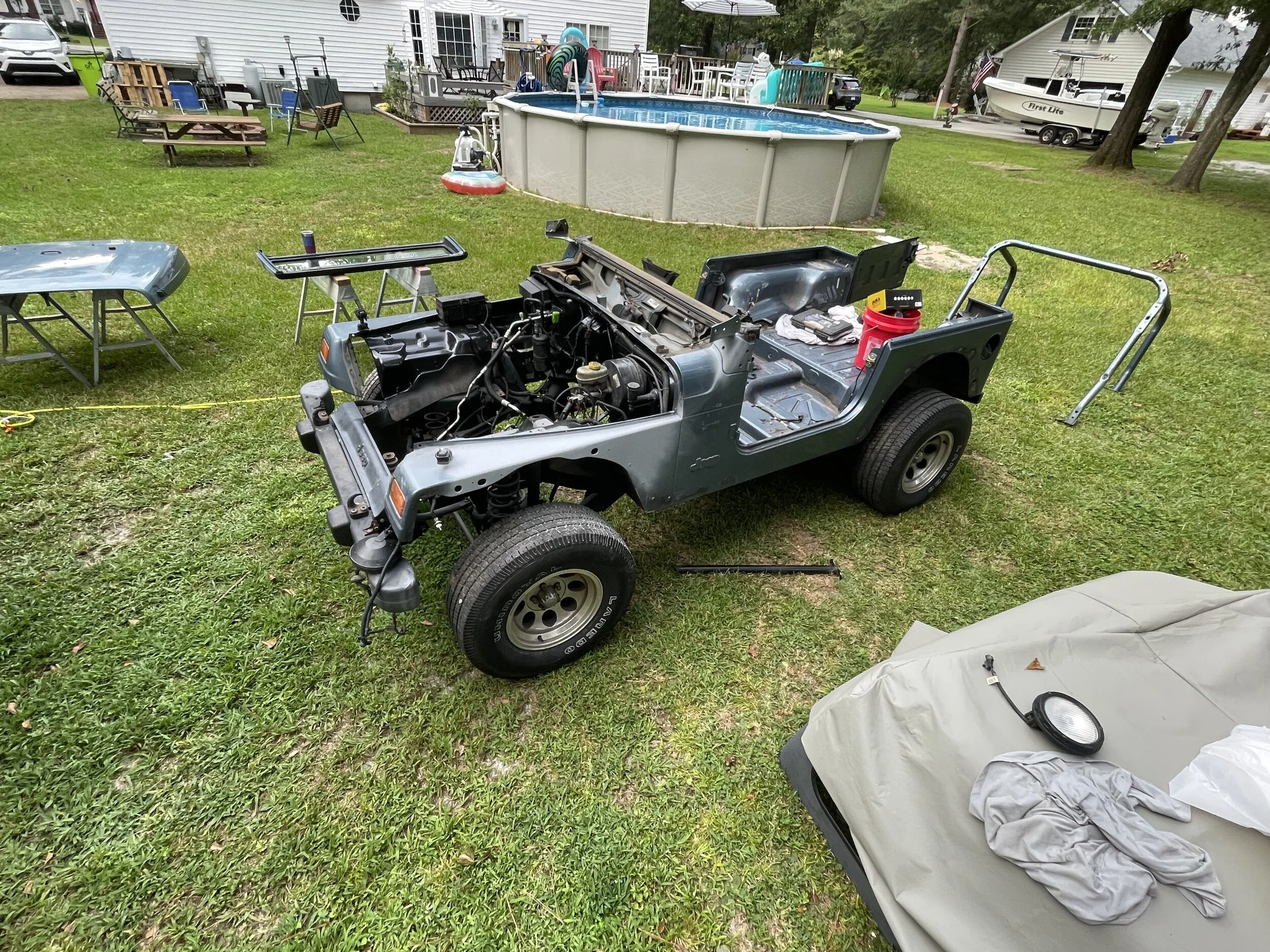

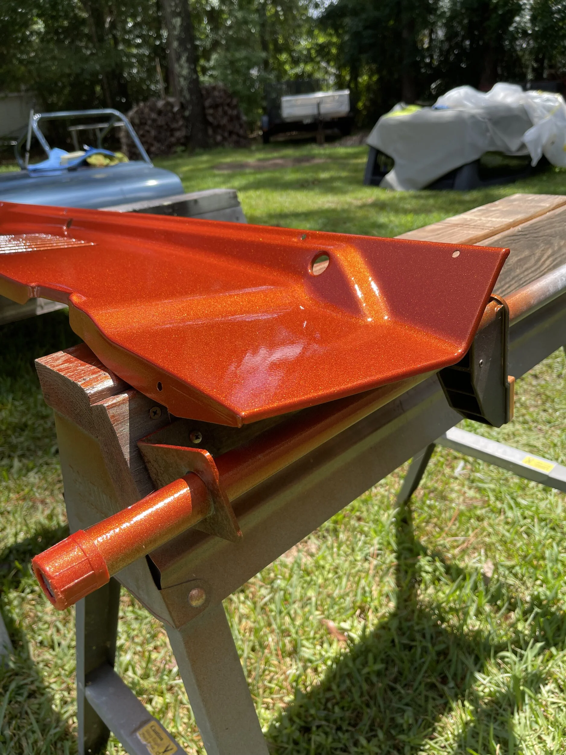

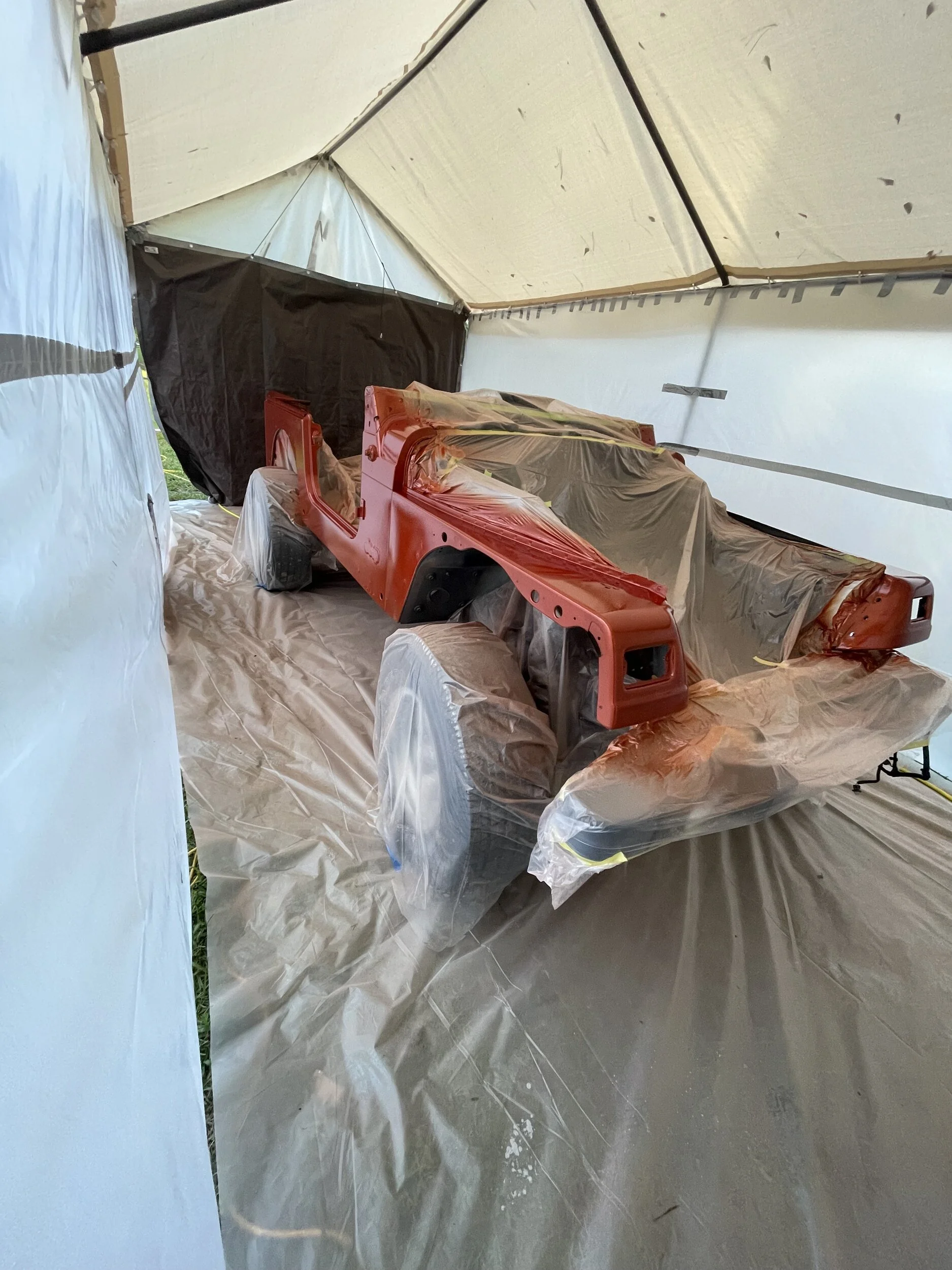

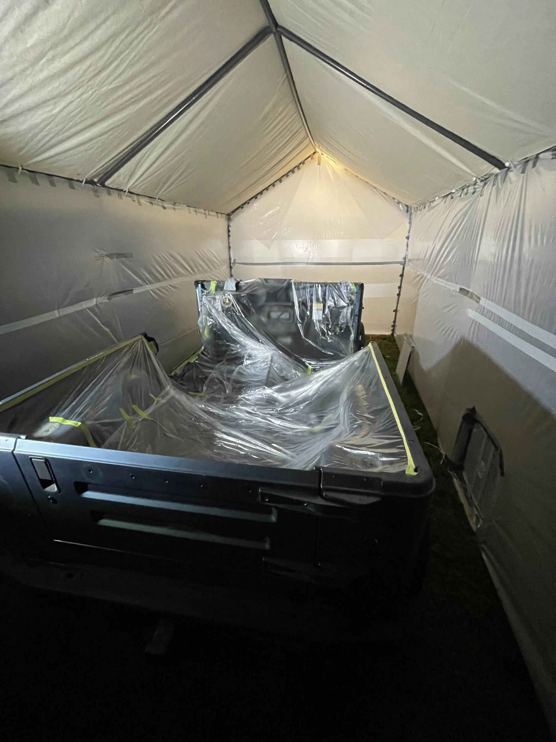

I’m terrible at updating on forums. Wanted to post a few pics of the project. These are a couple months old. I’ll get some completed pics and upload as well. Paints not perfect but I’m happy with it given it was my first solo job like this.
This is terrific! Awesome you just dove in and did it! I’m wanting to do the same but have zero experience or equipment for painting…. Would you be willing to share what specific equipment you used? Spray gun, nozzle size, compressor specs, any hose filters you utilized? I’m a bit overwhelmed at the range of information that’s out there.. I’ll probably only paint 2 vehicles in my lifetime so I don’t need to get crazy expensive stuff. Again, great job!
