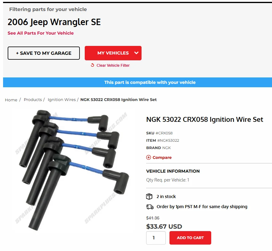

... also, NGK 53022 CRX058 wires — www.ngk.com/ngk-53022-crx058-ignition-wire-set
