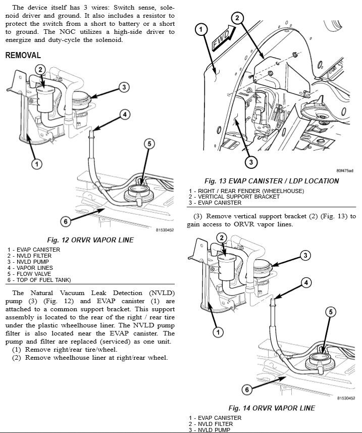

if your evap equip is back there it'll be hard to see behind it and could have the lead wedged or trapped.
Sorry “evap equip”? What’s that?
Evap canister .. emissions related equipment.
