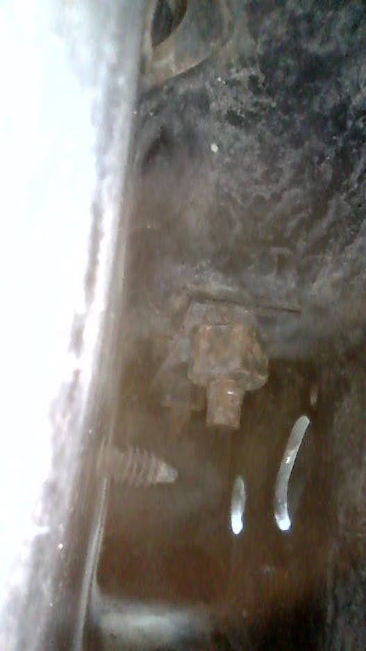

I bought a small wireless/WiFi camera to do some inspections on the house and wanted to see how it worked on the LJ frame. The pictures came out a little fuzzy, I think I need to play with some settings (the photos inside the house crawlspace and similar were excellent!) but you can get the idea of what the frame looks like. Overall, it's immaculate - despite being (literally!) plugged with mud in some spots when I first got it.

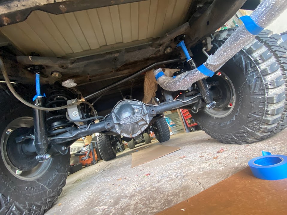

With the weather changing to fall, winter is only weeks away. I took advantage of a 70º day and figured it was the best time to start my annual rust-prevention measures. I picked up two cans of Eastwood's Internal Frame Coating and watched a few YouTube videos. After two additional power-washings and a few days of drying out, it was time to get down to it.

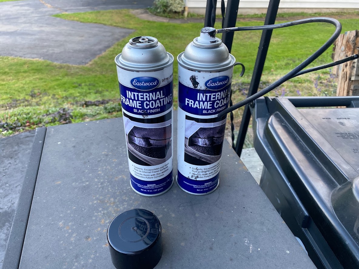

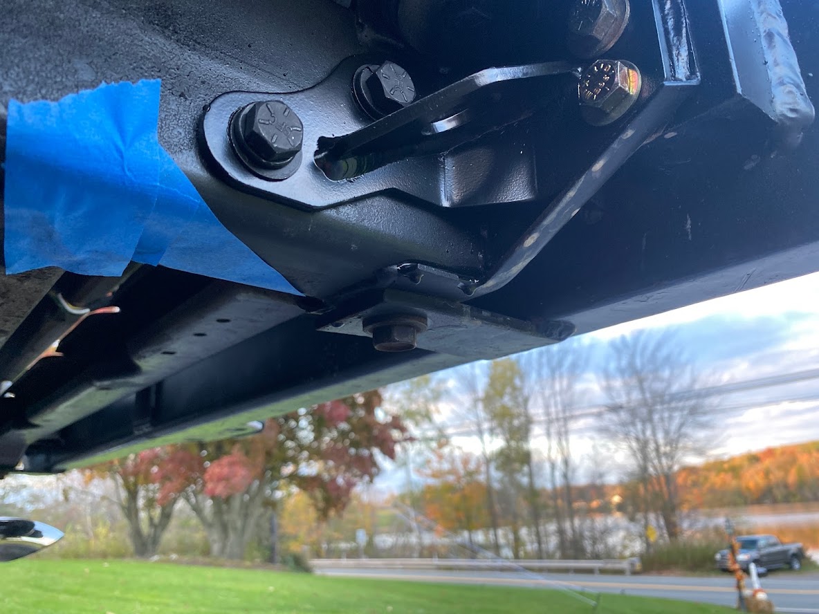

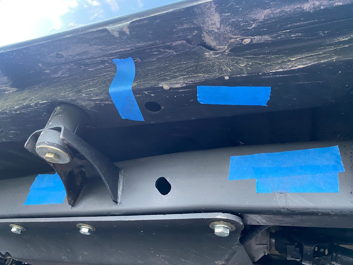

I taped up most of the holes in the frame and torque boxes/tub rails. The hose included with the Eastwood can is ~24" long, and gives you maybe 20" of useful length.
The hose has a conical sprayer on the end that sprays in about a 140º pattern outward. In something like a frame, the pattern works well for coverage. To apply, you simply depress the nozzle and "pull" the hose along while holding the nozzle depressed. I found it easiest and most controlled to spray and pull back about 7-8" at a time. Then I repositioned my hand on the hose and repeated until the end of the hose was almost clear of the hole.
The nozzle and spray pattern is quite vigorous. Combined with the very low viscosity of the coating, it will find any crack or loose piece of tape you have. As a result, you DO NOT want to do this on a concrete driveway without serious drop cloth/tarp protection. My blacktop driveway was easy to wipe clean and it's already black, so not a worry there. On light concrete, this will make a mess.
I used gravity to my advantage and parked the Jeep facing uphill on the part of the driveway with a decent scope. This meant the coating flowed through the frame towards the rear, rather than just pool in spots. When I got to the rear, a bit of material was flowing out the back of the lower bumper bolt, which I figured is where water and salt would accumulate if it were ever to touch this frame anyways, so it made sense to go "heavy to the rear". If you look close below, you can see a few drips on the bottom bumper bracket.

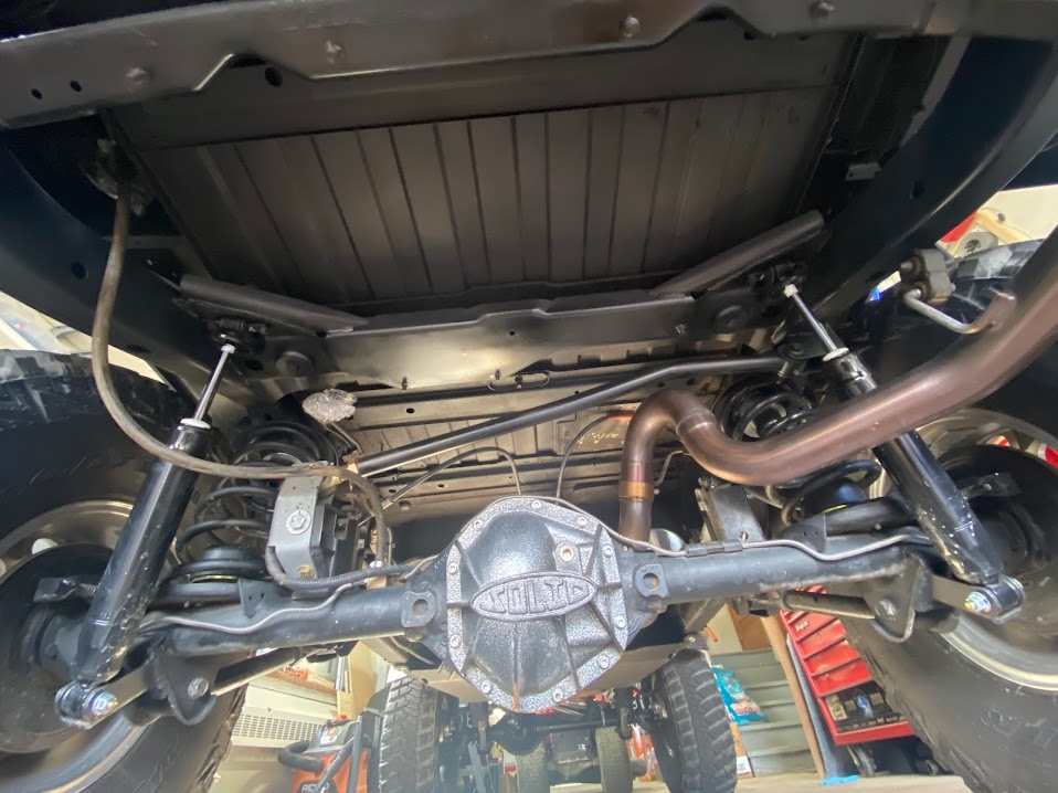

The photo above gives a good shot of the new Poison Spyder Frame Stiffeners - I got these cheap on Amazon and figured it was a good move for towing/snatching.
Overall, I'm curious to see how well the coating actually coated the inside of the frame. I used 1 and 1/2 cans of coating, with a 1/2 can remaining for touch-ups if needed. This included the frame, the tubular crossmember across the front of the frame, and both torque boxes under the tub that run parallel to the frame rails. Since I got two cans, I also have an extra hose handy to reapply if needed. I'll give the paint a few days to cure and then I'll stick my camera down there and see what it looks like!

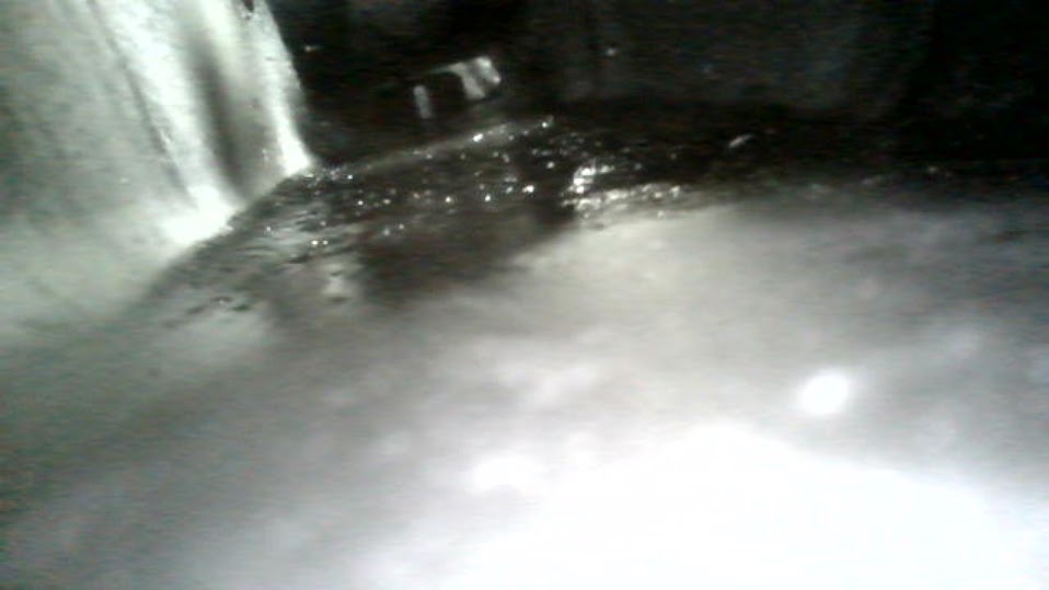

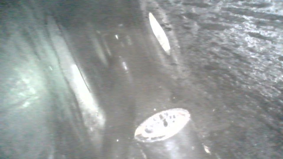

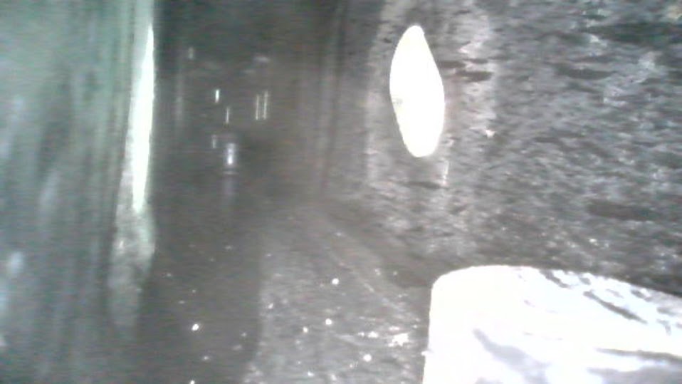

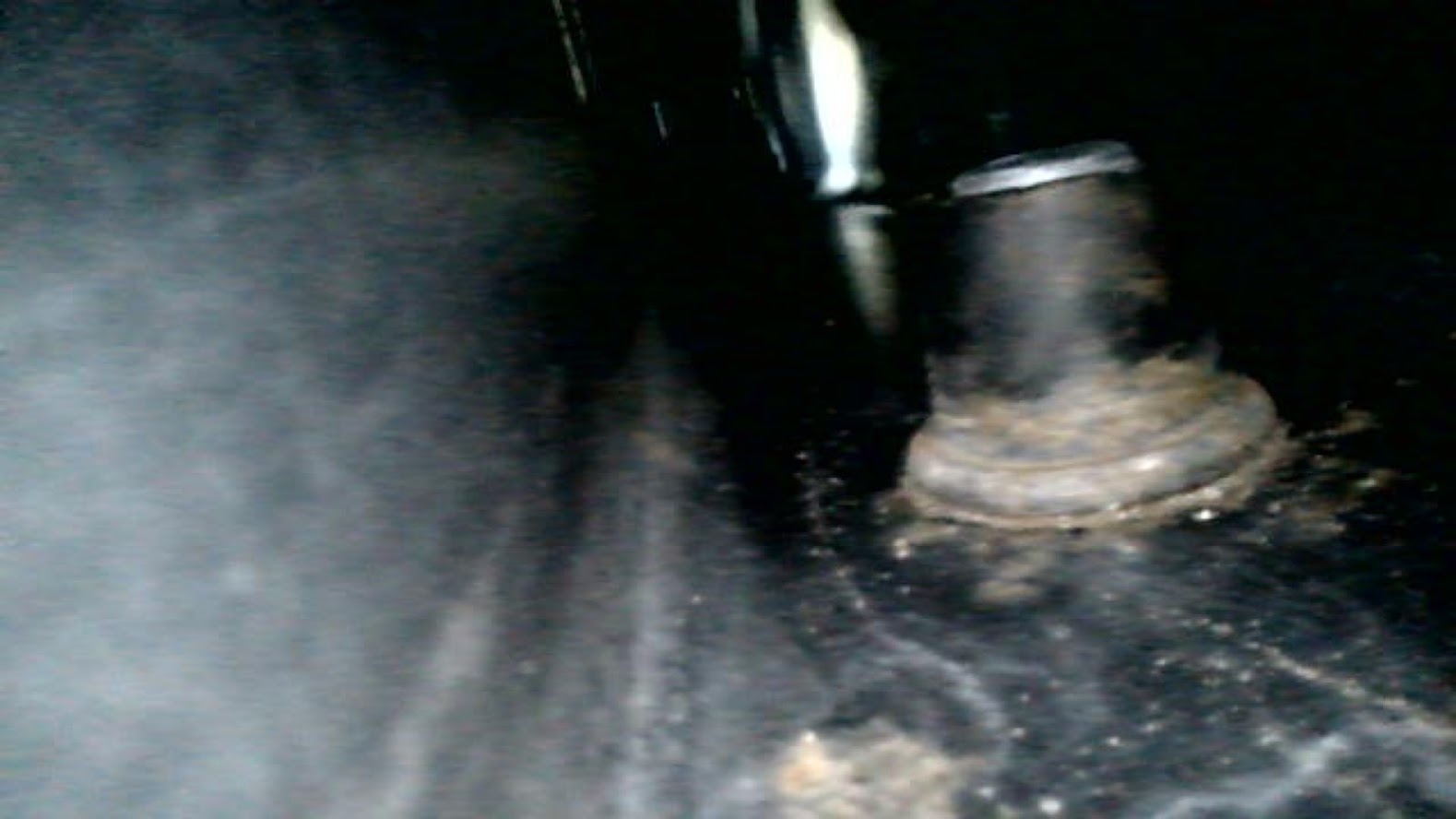

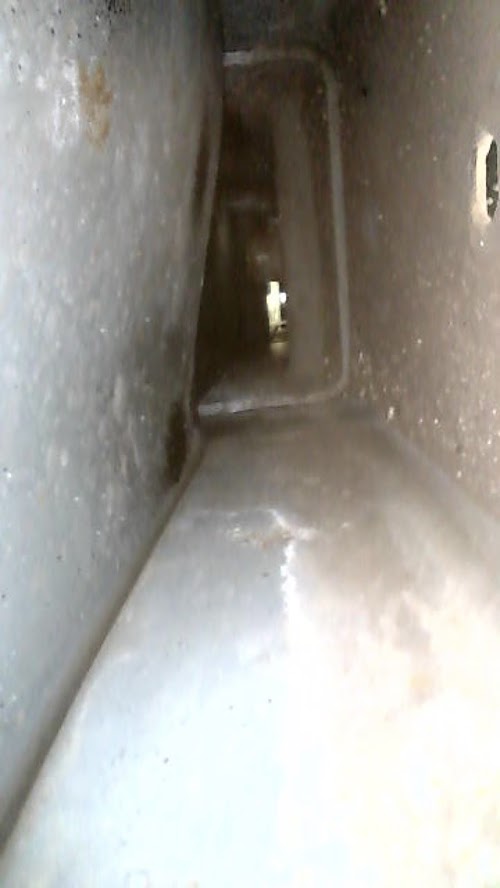

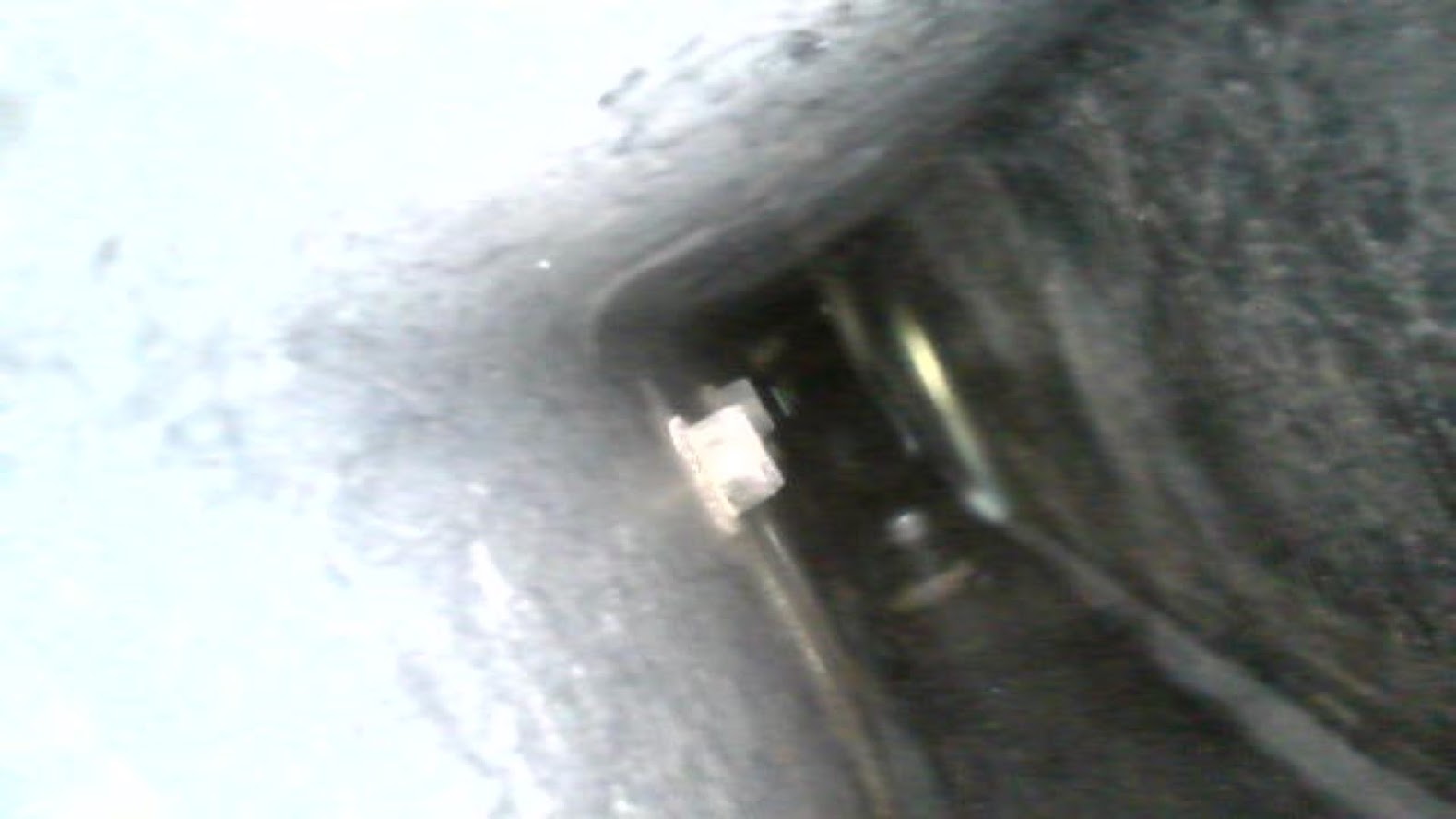

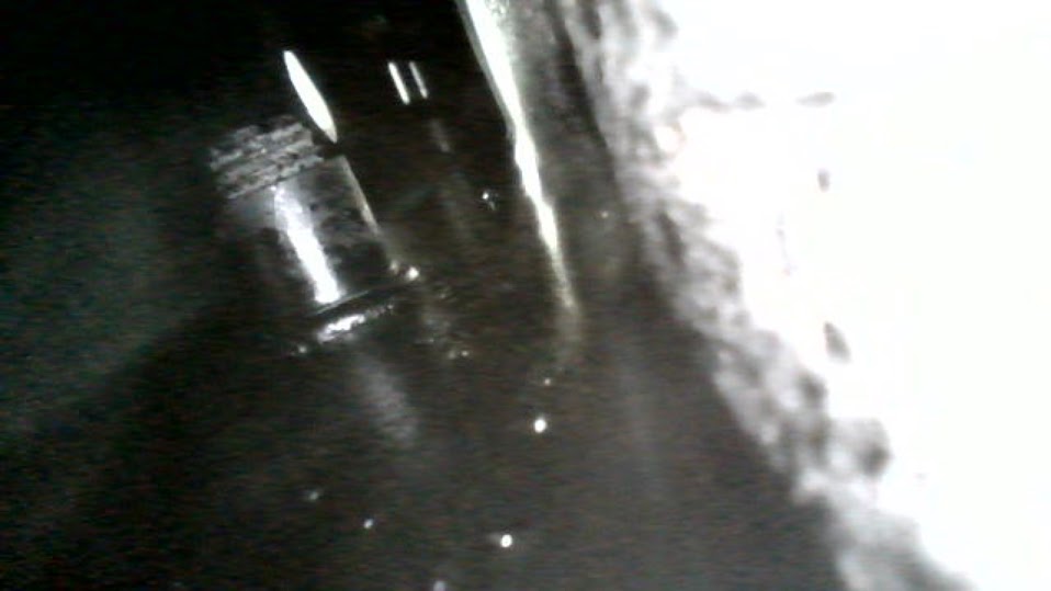

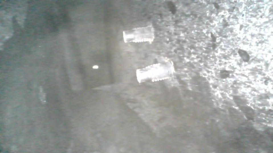

Got some pics from inside the frame rails - the black coating makes everything look like B&W film, to the point where I thought I stepped into a scene from the Blair Witch Project...
It seems to be well coated. There were some "streaks" that appeared on the camera but when I was looked into the frame where I could actually see into rail, the coating seems to have coated the wall and the streaks were simply a separate droplet that came from a different angle.
The bottom of the rail seems to be nicely coated, which is probably what needs to the most coverage anyways...

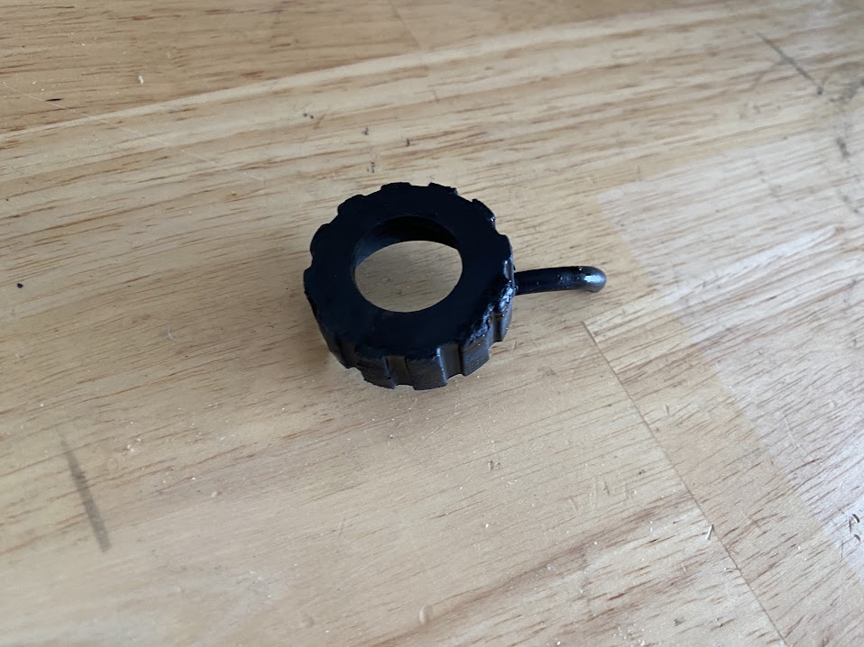

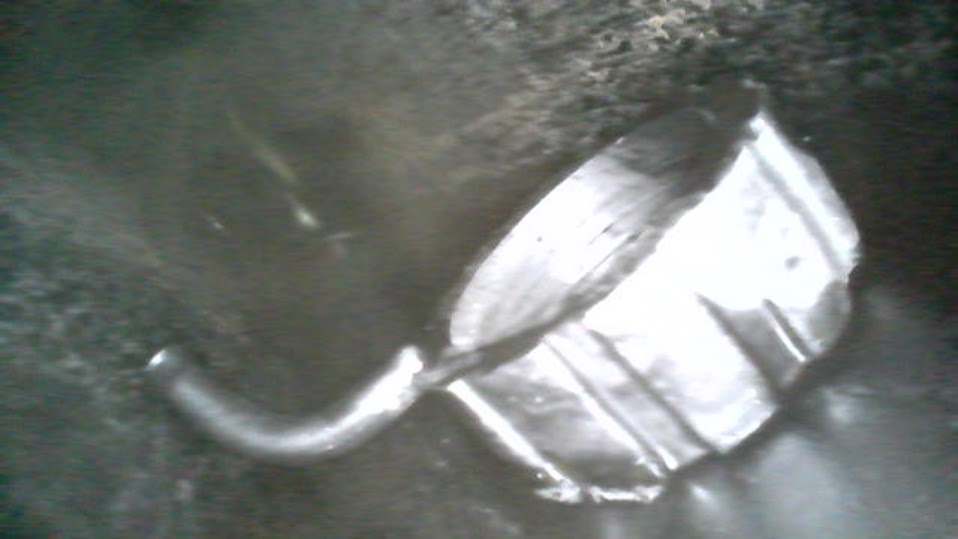

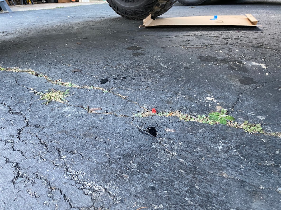

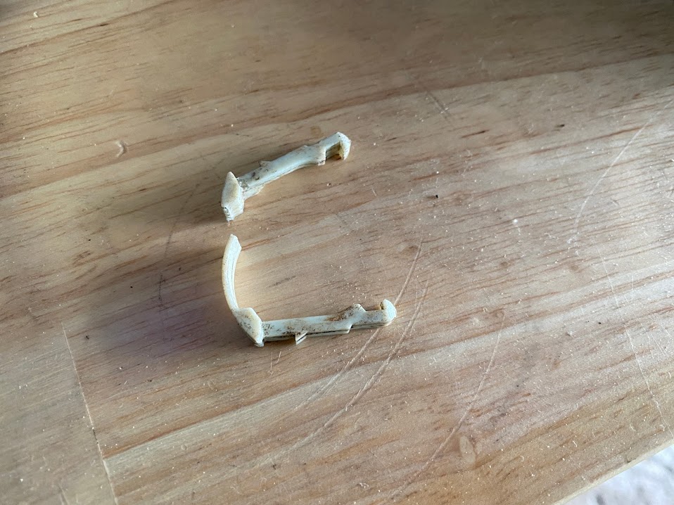

As I was looking around for proper coverage, I saw this thing...
I used the camera itself to hook the unidentified object and pulled it out of the frame. I still have no idea what the hell it is, but it's out of the frame rail now...
A heated garage, thorough cleaning after wheeling/driving on salted road, and doing this every year should keep the frame looking perfect for as long as I own the LJ...
If I can ever get all the dirt out of my frame I've got the frame coating also. Glad you posted the pics to give me a idea of what to do.
I'm with Nashville as I have no idea what that part is. Funny the things you find sometimes.
My guess is some sort of collar for a power washer. Hard to tell the size of it, though.

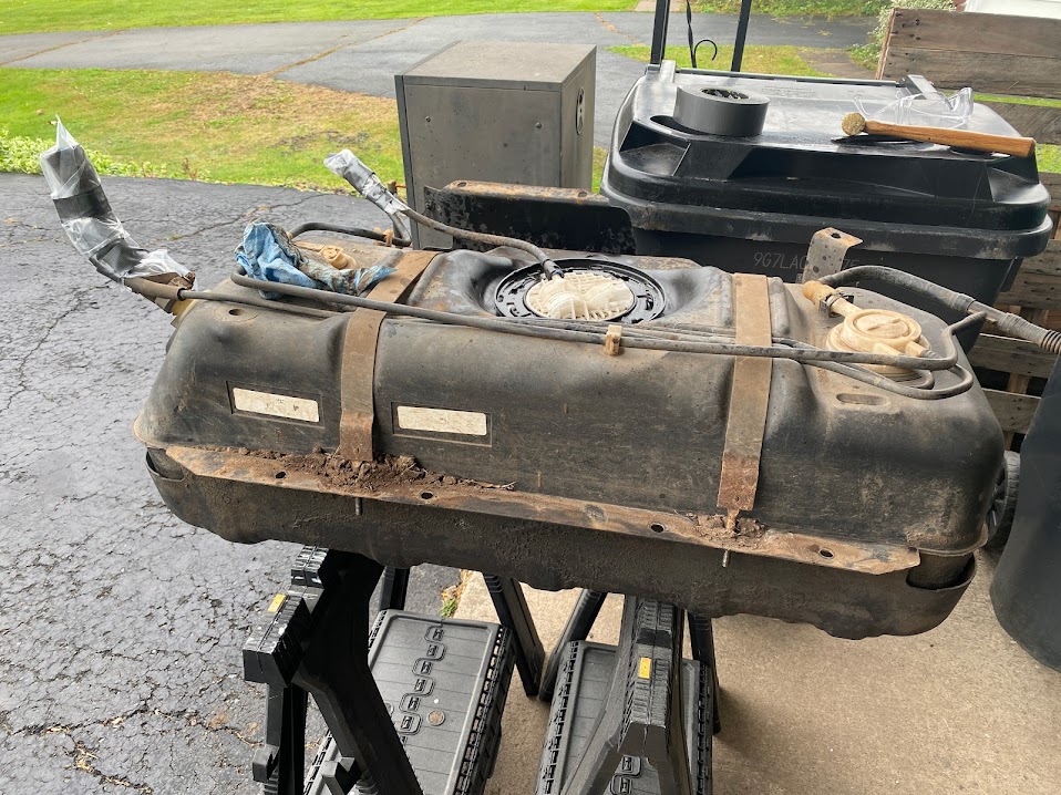

Only place left to clean and undercoat was directly above the fuel tank. I have been keeping the tank low, less than 1/4 tank, knowing that this was coming. I thought I had nailed the timing, with my gas light coming on as I drove the Jeep into the garage to start the work...
Much to my surprise however, the tank was ~1/2 full - so obviously my gauge is not reading correctly. The fuel sender is likely malfunctioning, so I think I'm going to order a replacement this week and get that swapped while it's all apart. I'll probably pull the flapper-valve out of the filler neck as well and do the DIY mod as well, since I have noticed some nozzles in the area do not work well with refueling and it constantly clicks off, requiring me to manually hold the fuel nozzle handle ~20% open the entire time.

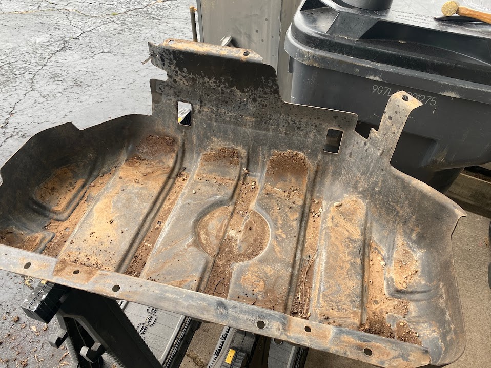

The factory skid was fairly muddy but not rusty, thanks to spending its life in Hawaii and Arizona. There was a sizeable dent in the middle however, which means I'm sure this took quite a few hits in its day...
Of course the vent line clip leading to the charcoal canister broke despite using two 90º picks with surgical precision! Mopar doesn't list them in any parts diagram I could find, but luckily we have Amazon Prime and someone made a comment under the review for Dorman 800-041 Fuel Line Clip that it worked for their Jeep. I ordered a 2-pack and they are indeed a perfect fit!

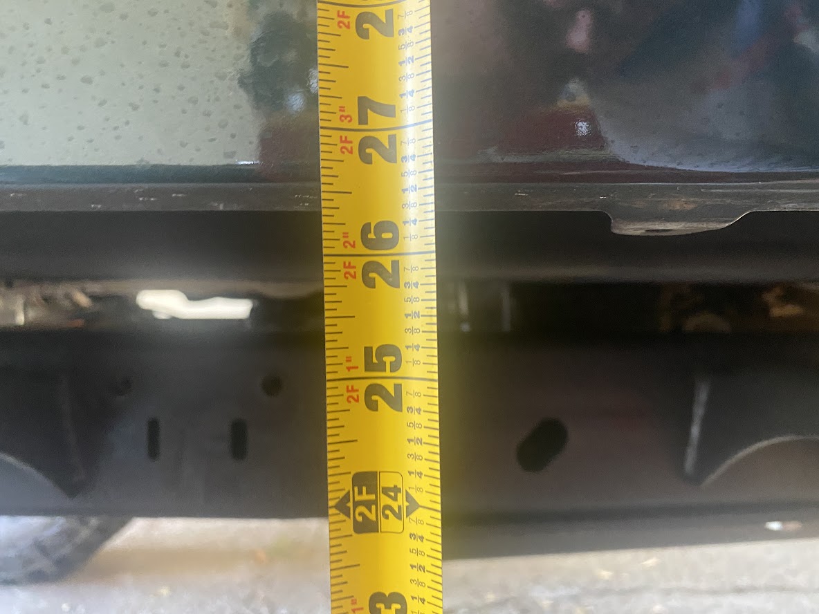

You were pretty close - my rocker panel is a smidge over 26-1/2" at the center of the door:

I washed the undercarriage one more time last week with some degreaser and wheeled the Jeep back into the garage to dry out over the weekend while we were exploring Philly. With everything dry (and before we get a bunch of rain and colder temps!), I did the last remaining winterization/rust-proofing.
All taped up and ready to spray:

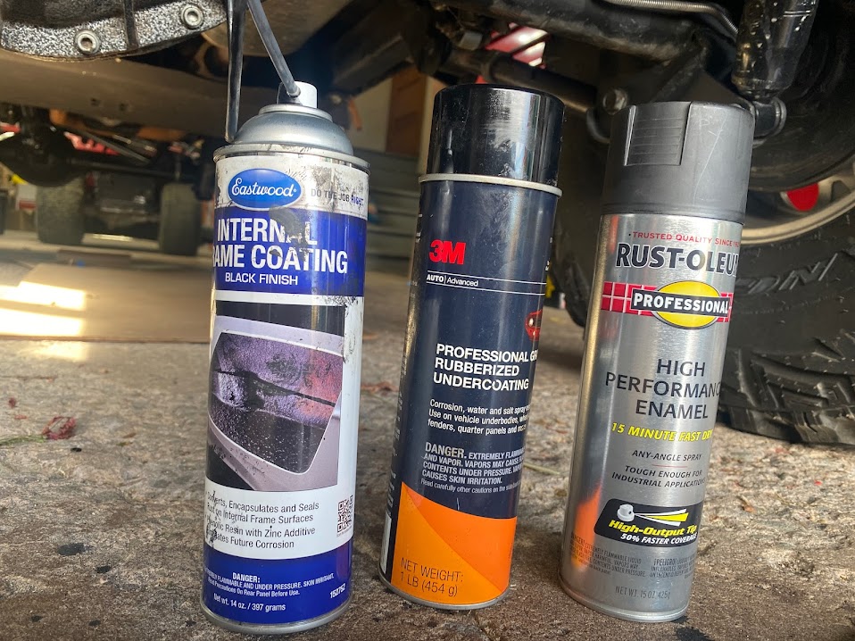

The Three Amigos of Rust Prevention:
Finished Product:
I used the Eastwood Frame Coating to get inside all the support rails (did each rail twice, one "pass" from each direction), then used the Rustoleum Professional for the exterior of the frame rails, the upper shock mount and crossmember, and the track bar bracket, then hit the tub underside, as well as the inner fenders (where I had run out of undercoating last time), and inside the tub by where the taillight wiring is. I also made sure to coat the tub panel by the body mounts from multiple directions to ensure it was a smooth and even coating. One of the advantages of the LJ is that the rearmost crossmember is exposed and easy to clean in winter months!
