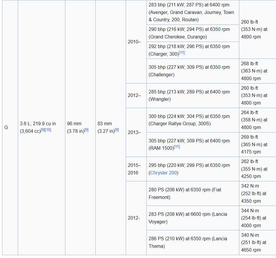

In all seriousness are you talking about the 3.6?
Who rev's their engine to 6,400 RPM's on a normal basis? And the torque peak is way higher than most would rev to also.
