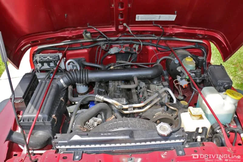

I am looking for a pic of a stock TJ 4.0 taken from the top side.

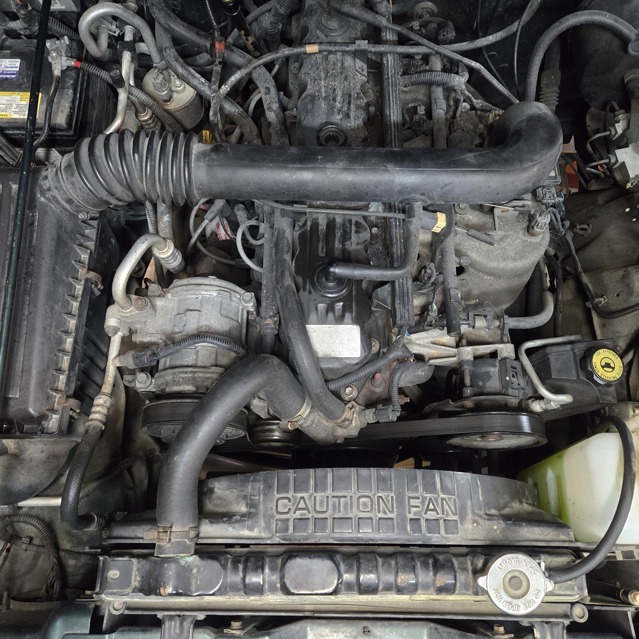

"jeep tj 4.0 engine bay" Second picture.
Not sure, just had the jeep a few weeks.
Oil fill cap, guess that's the odd area in valve cover, just behind the inlet air tube?
I guess replacement caps are available?
Is threaded or just pulls out?

Order another cap. Turn that nasty boy out with a pair of pliers and replace it.

Yes, that's it and it's threaded. I used a pair of channel locks when mine did that.
They all do it eventually. I was working in an oil change shop in high school when these things were new and was already seeing them come apart back then.
Here's a couple of my 06 if any different angles are helpful. I took these deliberately for the heat shield because I had just replaced it after the old one disintegrated while replacing the valve cover gasket.
