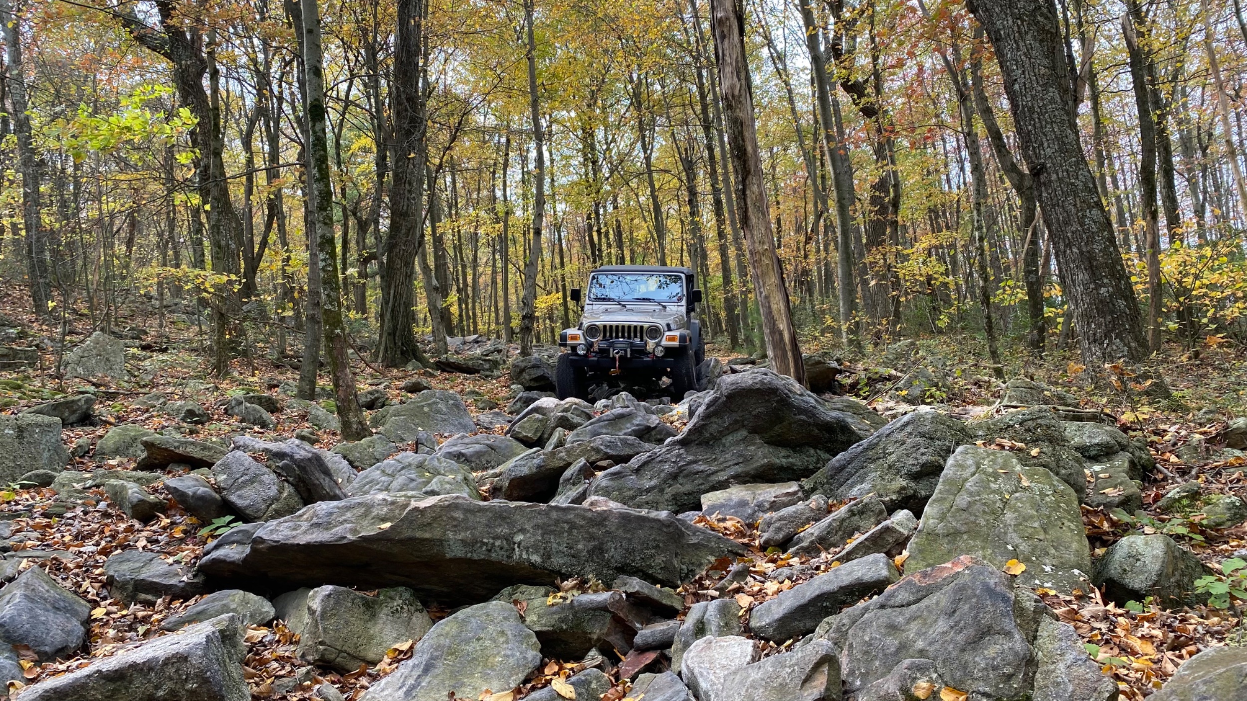

Not to be rude… but why? I just ran a black trail, medium/ slightly hard, with two other guys at AAOA all on 33s.
You know, sometimes when I’m out there on 33’s with my 2” lift I think.....if I can’t go over this stuff with these tires, I might not need to be going over this stuff.

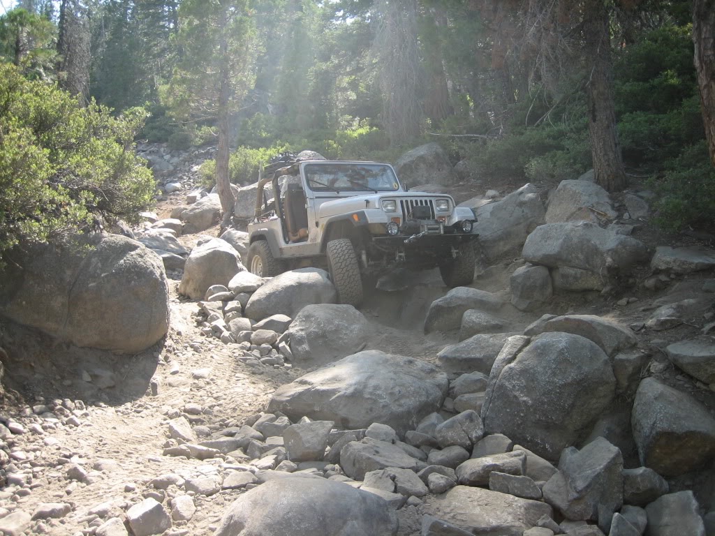

This guy was on 35’s
I never had a snag following him. Same behind a JK on 37’s.
And I understand deep ruts, snow wheeling, etc - I realize 33’s aren’t the be all, but you can have an awful lot of fun on them.
