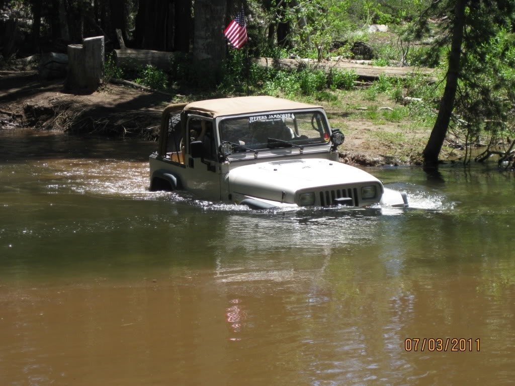

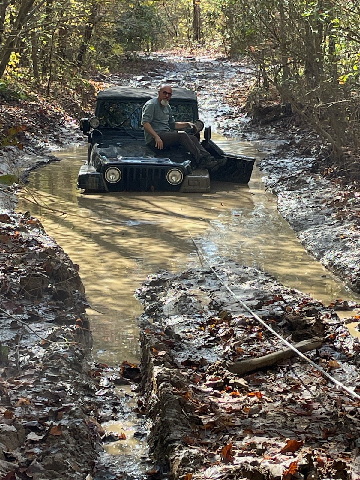

Like I said sometime you just want more than 33's 🤣
And sometimes you either need a brain or 40's..... I needed a brain :ROFLMAO: :oops::ROFLMAO:
