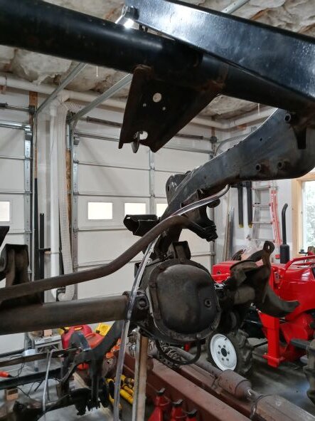

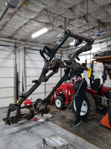

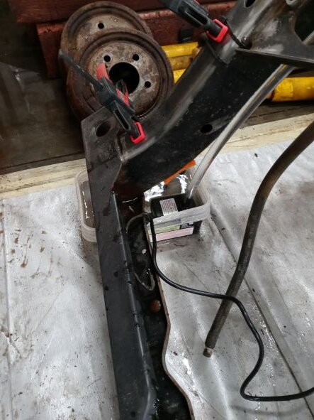

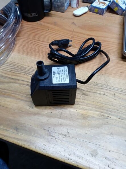

Picked up a cheapo aquarium pump and 15' of vinyl hose to circulate some evapo rust across the inside bottom of the frame. Used a pool noodle and tie-wraps to close up frame openings where necessary. Been testing with water for the last
2 hours without drips so time to swap in the solution.
