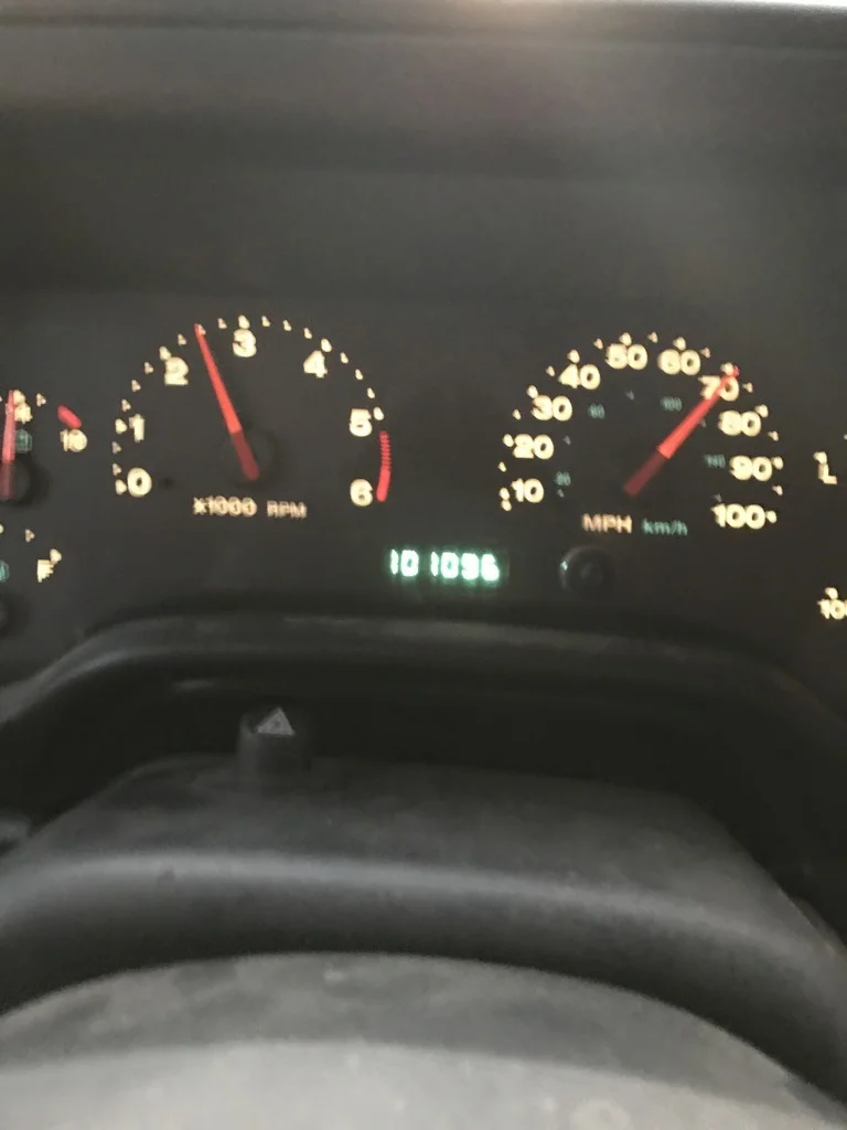

I can't help you with 35's and 5.38. But, I am running 33's and 5.13, with the 42rle.
So if you run 35's and are geared to 5.38, your speedometer and RPM's will be similar to what I am running.
Around town, that low gearing is quite awesome. And on the highway, I can easily pass others, and I don't have to struggle to when driving into the wind and going up hills.
That rpm with 35's is the minimum that is ideal for the highway, which is why I always recommend 5.13 or, better, 5.38. I personally hope to some day regear from my present 4.88 to 5.38 for my 35's and 42RLE transmission. 5.38 would barely give a slightly higher rpm than is in that photo which is really what you want for 35's with the 4.0L, 42RLE transmission, and with the Wrangler which is a fairly heavy vehicle... heavier than many people would guess. Especially given its barn-door aerodynamics on the highway. :)
