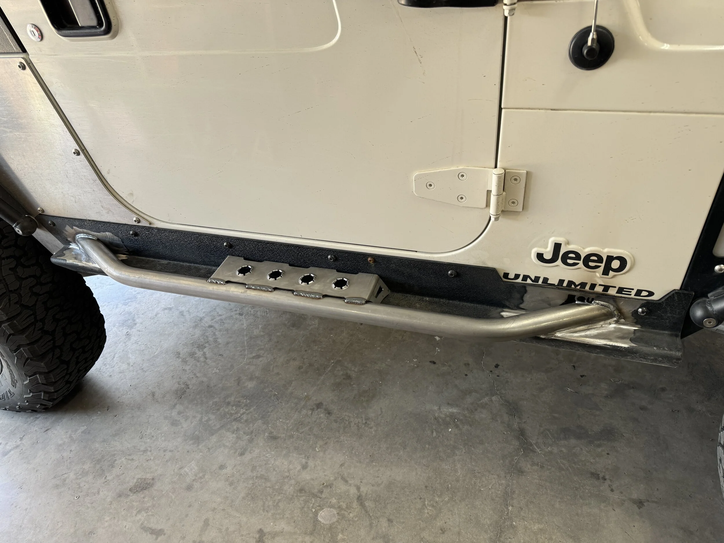

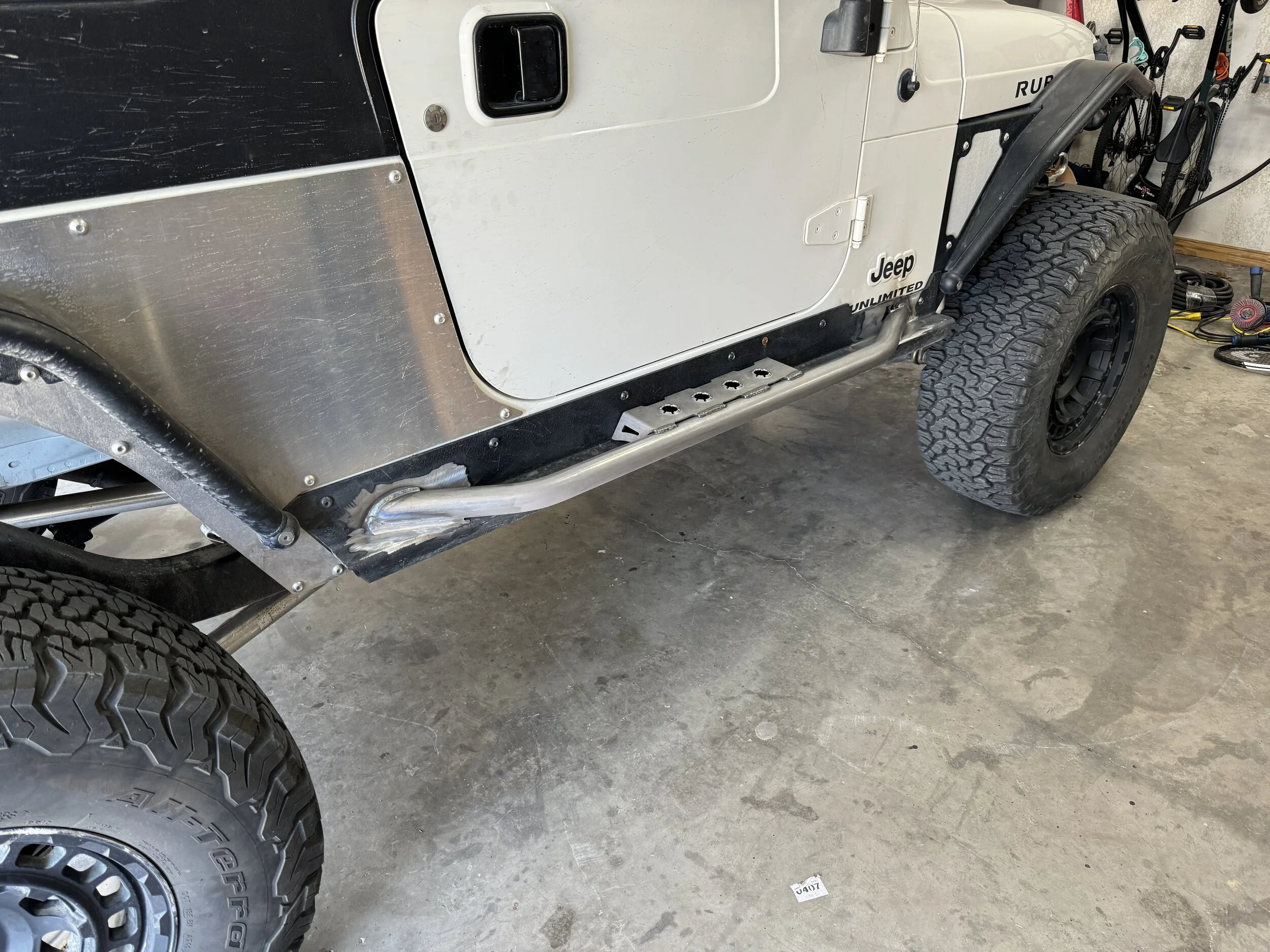

The shop replaced the rear gears and pinion bearing under warranty. I got the Jeep back yesterday and the howling is gone! I celebrated by installing some Motobilt rocker tubes this morning. Thanks for the help, everyone!
