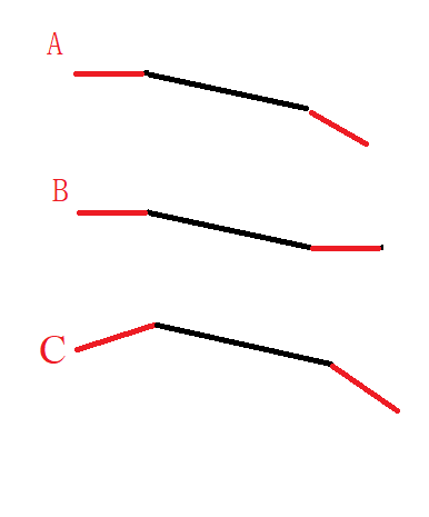

Unless someone fabricobbled a double doubler out of a single block of steel...a left and right end together with two yokes probably set at 180 degrees...so they didn't need coupled together with a welded shaft.
And I suppose said product doesn't exist for a reason.
-Mac
@freedom_in_4low In theory both of your drawings would have the same results. If you have two joints at each end of those pairs of joints (each double cardan) are cancelling each other's oscillations. So joints 1 and 2 cancel each other out and joints 3 and 4 cancel each other. With the double cardan at each end of the shaft, the relationship between each end of the shaft doesn't matter. You could almost view it as two different drive shafts, each with a single joint at each end. Imagine your black line as the transfer case and your red lines the front and rear drive shafts in a vehicle. I've added a 3rd example to your drawing. This example C is more exaggerated and more similar to what we see in those front XJ situations because the transfer case points up away front the drive shaft, the drive shaft slopes down away from it, and the pinion points up towards the transfer case, just not enough for a regular double cardan to work well.

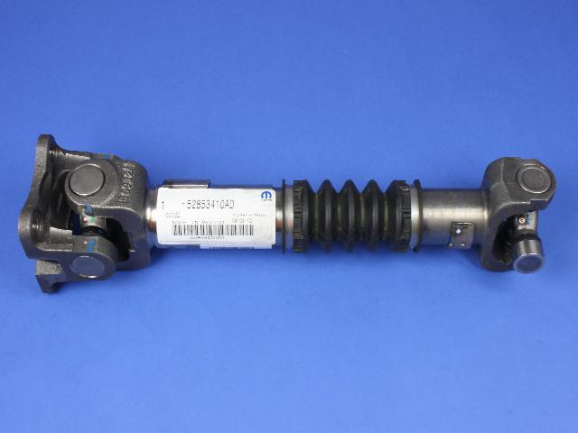

The vibrations seem to be torsional, not radial. It had been proposed that DC shafts are less ideal due to the larger diameter chunk of mass in the H yoke and that maybe having two on the same vehicle and spinning them close to 4000rpm just isn't ideal. Maybe that's why Jeep never did it from the factory even though traditional logic would say the rear needed it as much or more than the front does due to the length.
I would agree with you on spinning them 4000 rpms, but jeep did use two DC driveshafts on the rubicon models.

They did not. it was a bolt on instead of a slip yoke but it still only had 2 total u joints and no h yoke, therefore not a DC.
Ah, i hadn't looked very closely at them i guess i assumed it was a dc shaft stock. maybe that has something to do with it. the first time I read about the issue i wondered if the reason the vibration is cyclical is due to slightly different speeds front and rear (especially with Dana 30/Dana 44 having different size ring gears) combining and cancelling each other. I guess it could also have something to do with the fewer teeth on the pinion when you get down to that ratio.
