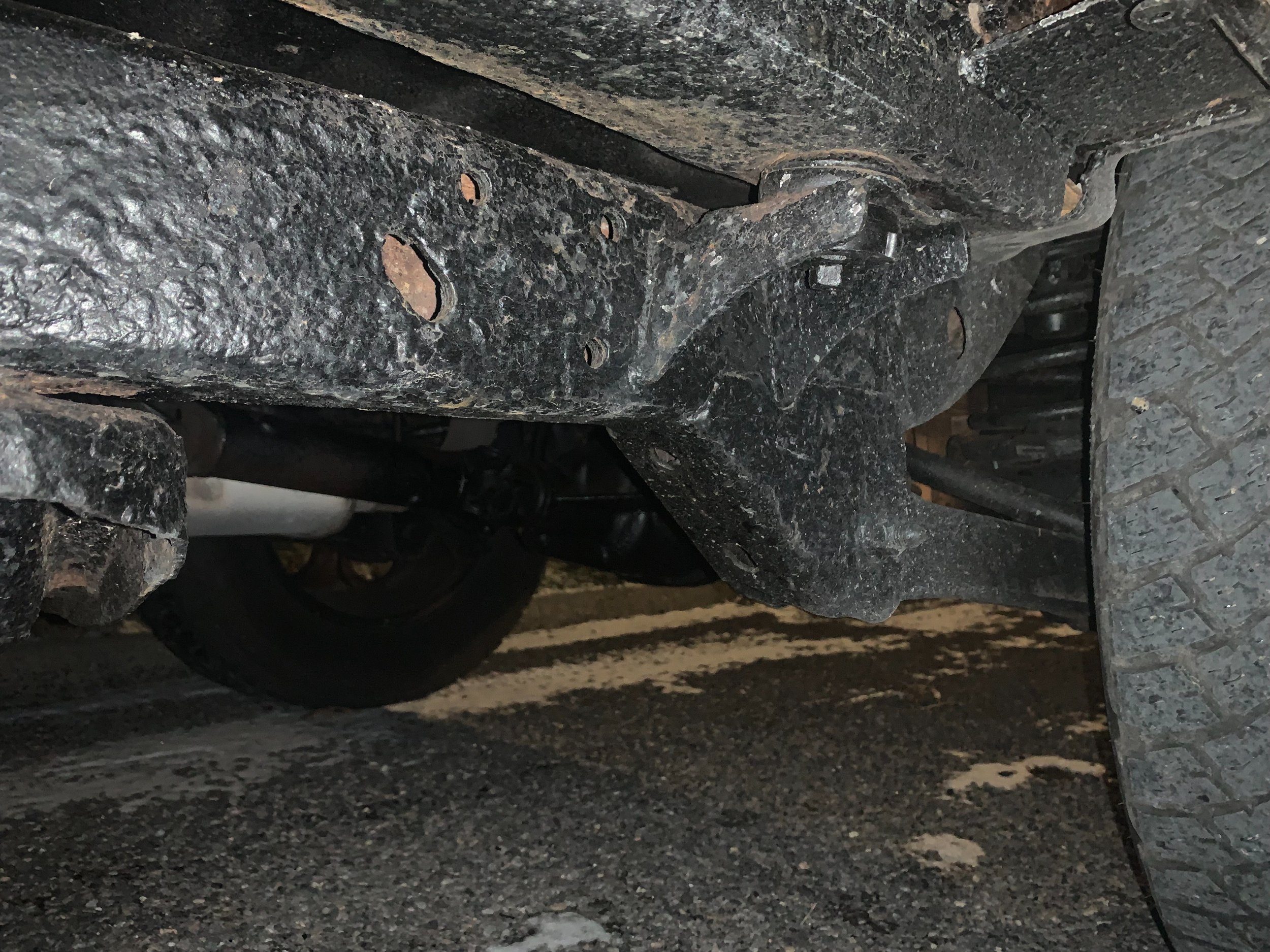

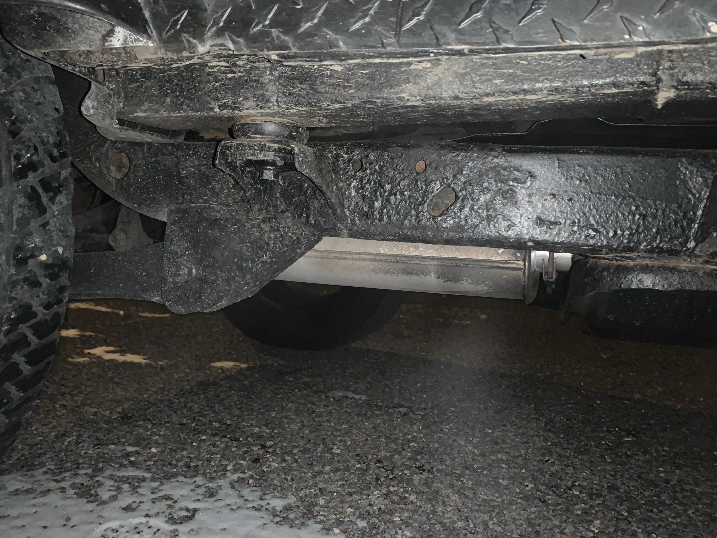

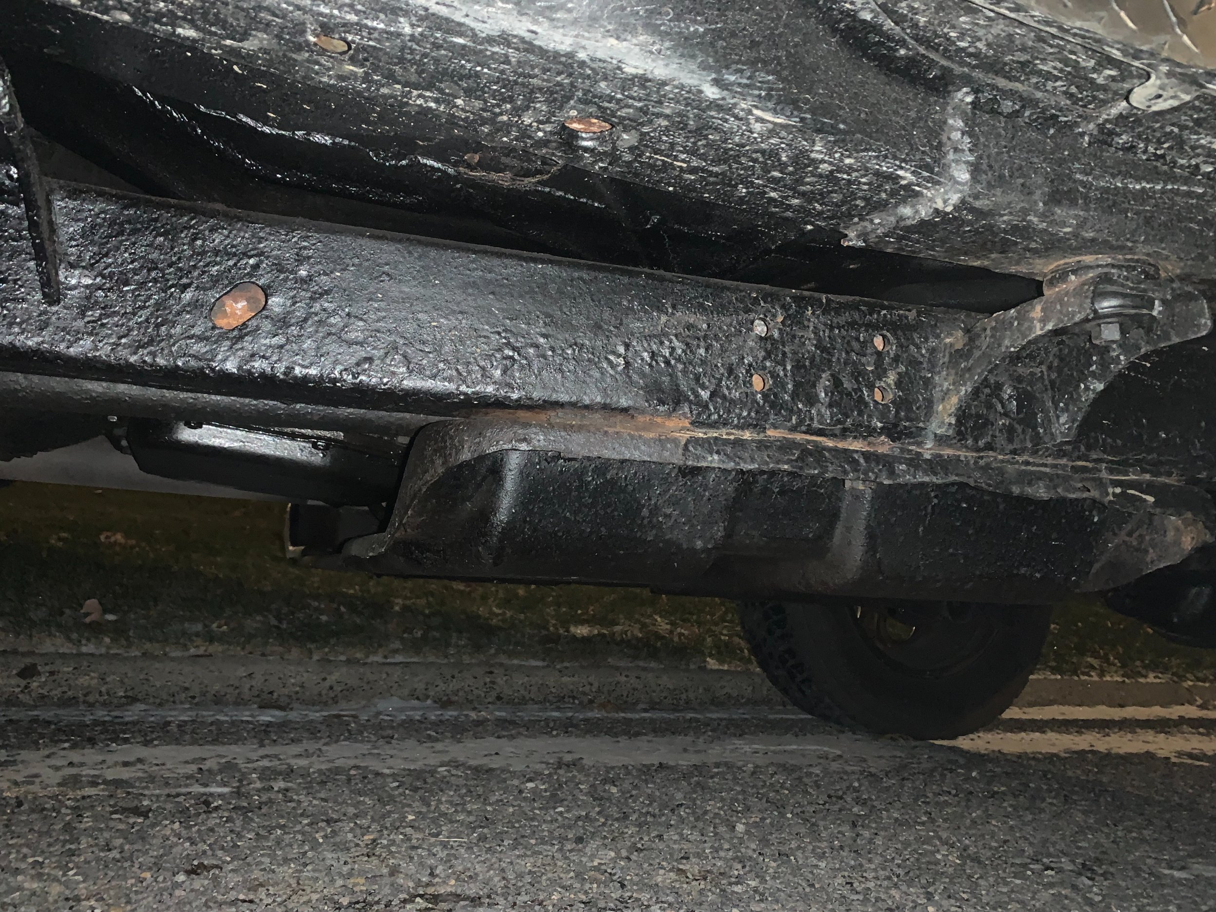

I'm a highschooler and this jeep is my first car, but I'm really looking into doing a 5.3 LS swap, but idk how good my frame actually is. This is a 2000 Jeep 2.5L I4
i did get the bottom coated because i was told it would stop the frame from rusting, they didn't do the inside of the frame (you can see this in the pictures)
I just need a second opinion on if this jeep is worth working on and spending money on
let me know your guys' thoughts and what i can/should do to make this jeep last as long as it can
Not only is that frame trashed it also looks like its already been repaired a time or two. Run away.
I see heavy rust scale under that coating. The inside is likely just as bad or worse. A coating on top of existing rust will not stop it, and will actually hasten the process. I see some previous repair. Until you scrape that coating off and really inspect things, I'd assume that Jeep has major issues.
