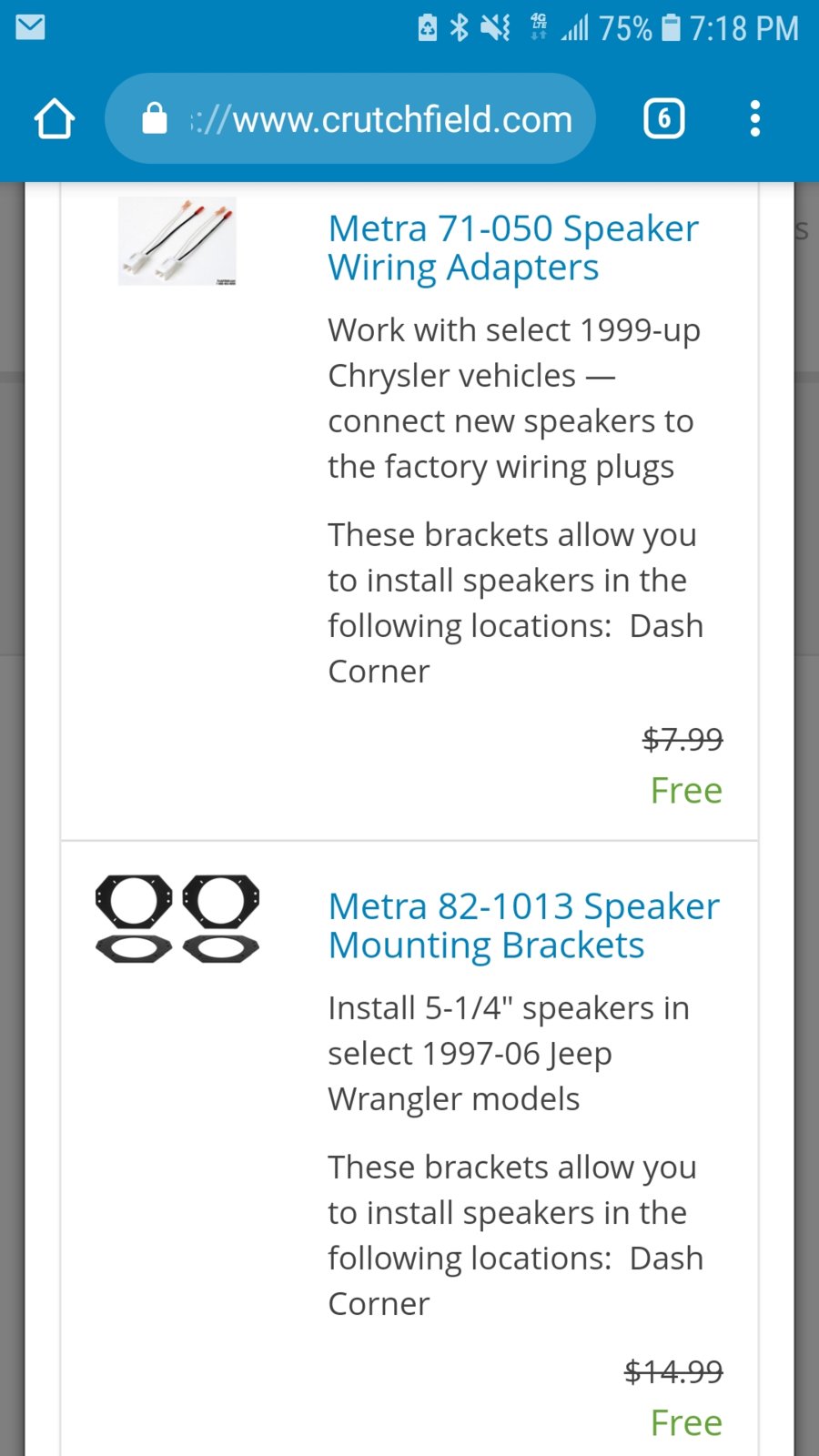

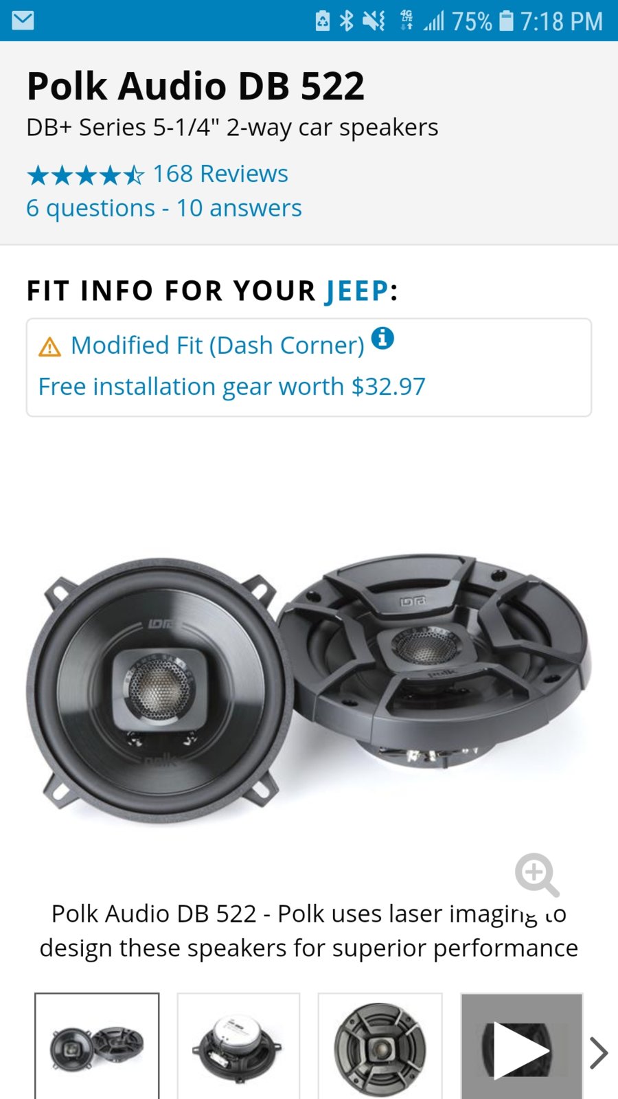

Hit up Crutchfield and get the Polk DB 522 for the front speakers and the Polk DB 622 for the speaker pods. Crutchfield will send you the pigtails (connection harness) and front brackets so it is plug n play. They are going for $59.99 each including the pigtails and brackets, so $120 for a simple and awesome upgrade.
2006TJ1
Dec 4, 2017
383
Atlanta, GA
x2 on the Polk DB522
Also another vote for Crutchfield, as they send adapter plates (front dash location) and factory harness adapters for free

There's a night and day sound quality improvement by upgrading to something like those Polk DB speakers. The component in a stereo system that has the greatest effect on sound quality is the speaker.
