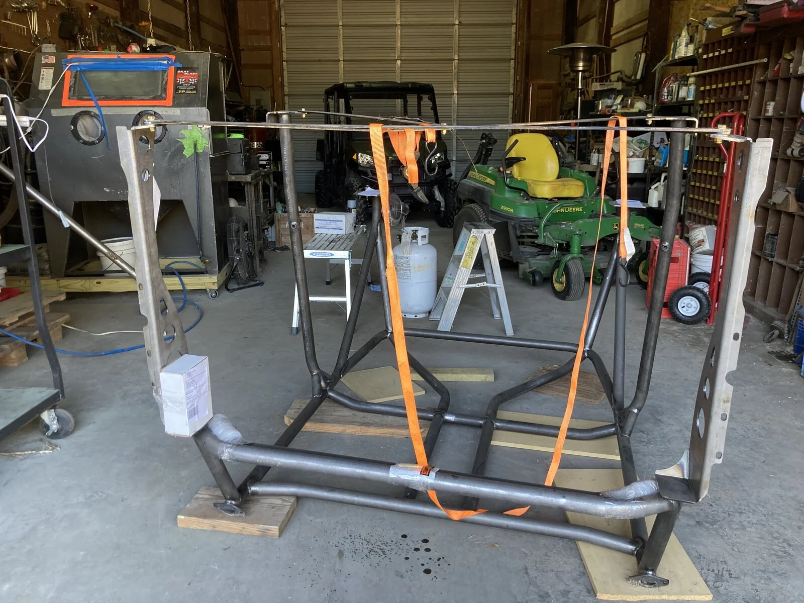

Bought a fully welded Poison Spyder cage and it is on the way.
I guess I'd want everything welded that I want to be there before powder coat or paint. And I have no idea how to make harnesses work with stock seats. Might just have to wait till all the puzzle pieces arrive.

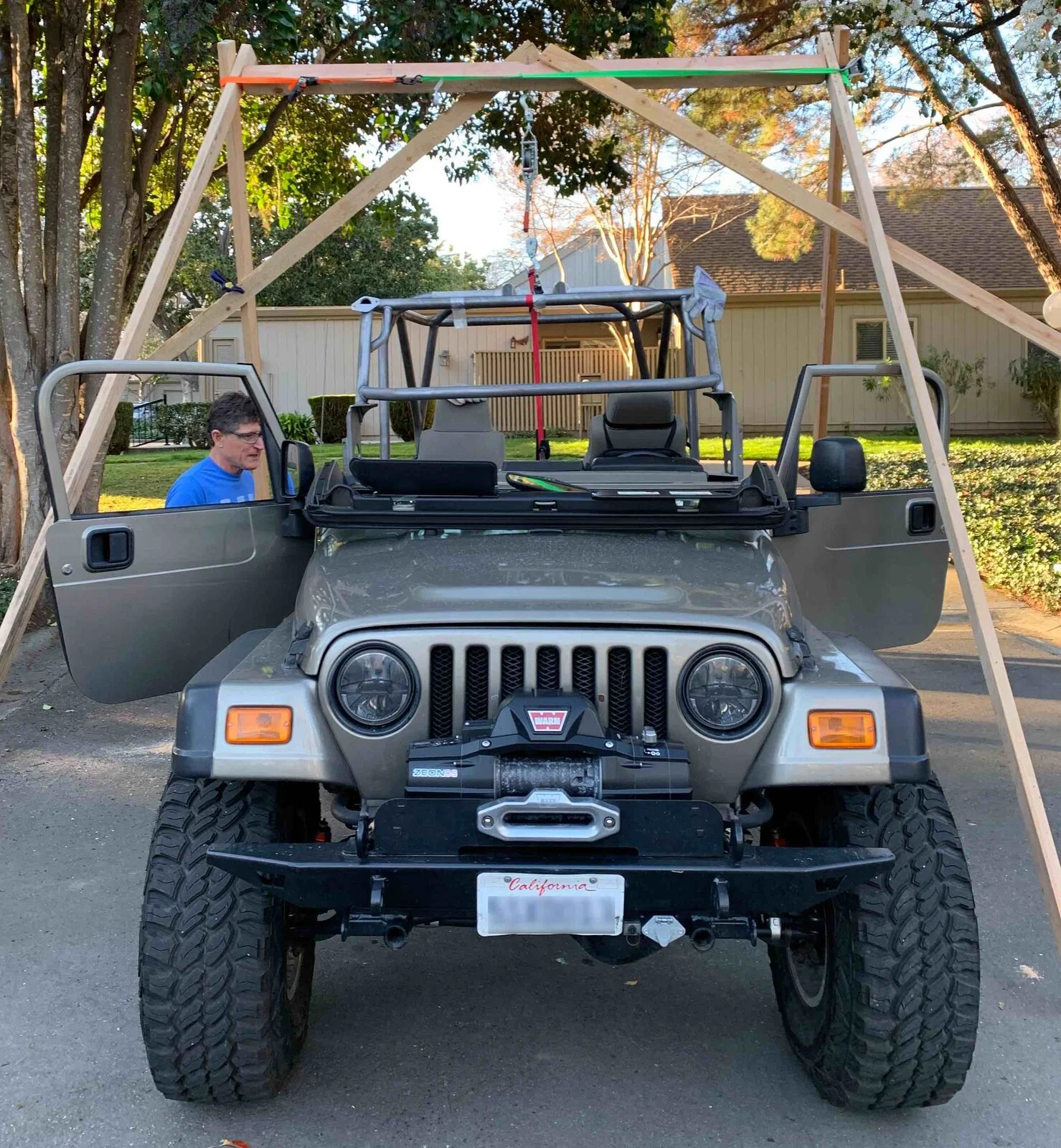

Installing cage with my fancy safety glasses.

When the cage was delivered and where it still sits in the shop.
