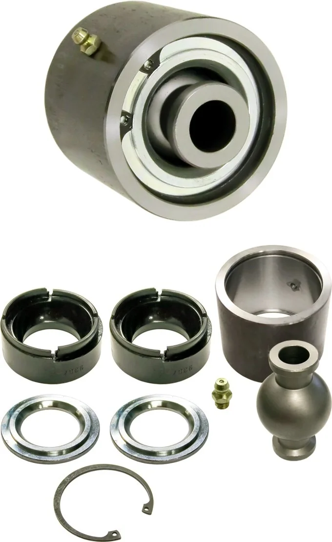

I have the MC bar and on heim #3. The heims loosen up a little bit and cause a clatter/clank when turning. This new joint seems to be holding up fine now.

I agree with everything @JMT said, but I'll add JKS track bar. It's a good product with a proven JJ at one end. I also agree with you on getting a rear adjustable TB instead of the relocation bracket, provided you don't go the SYE route, in which case you'll need a angled relocation bracket anyway in conjunction with an adjustable TB.
