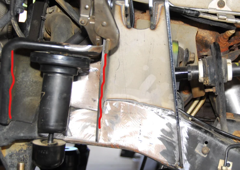

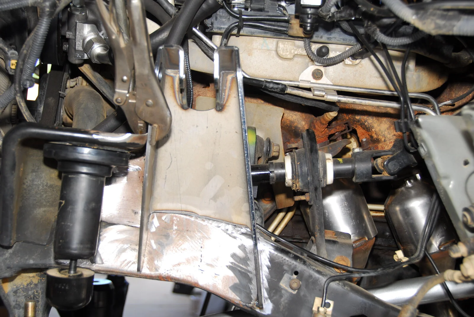

Best I can do is borrow a pic from one of Blaines builds as a reference.
cn0h2a-jpg.27540

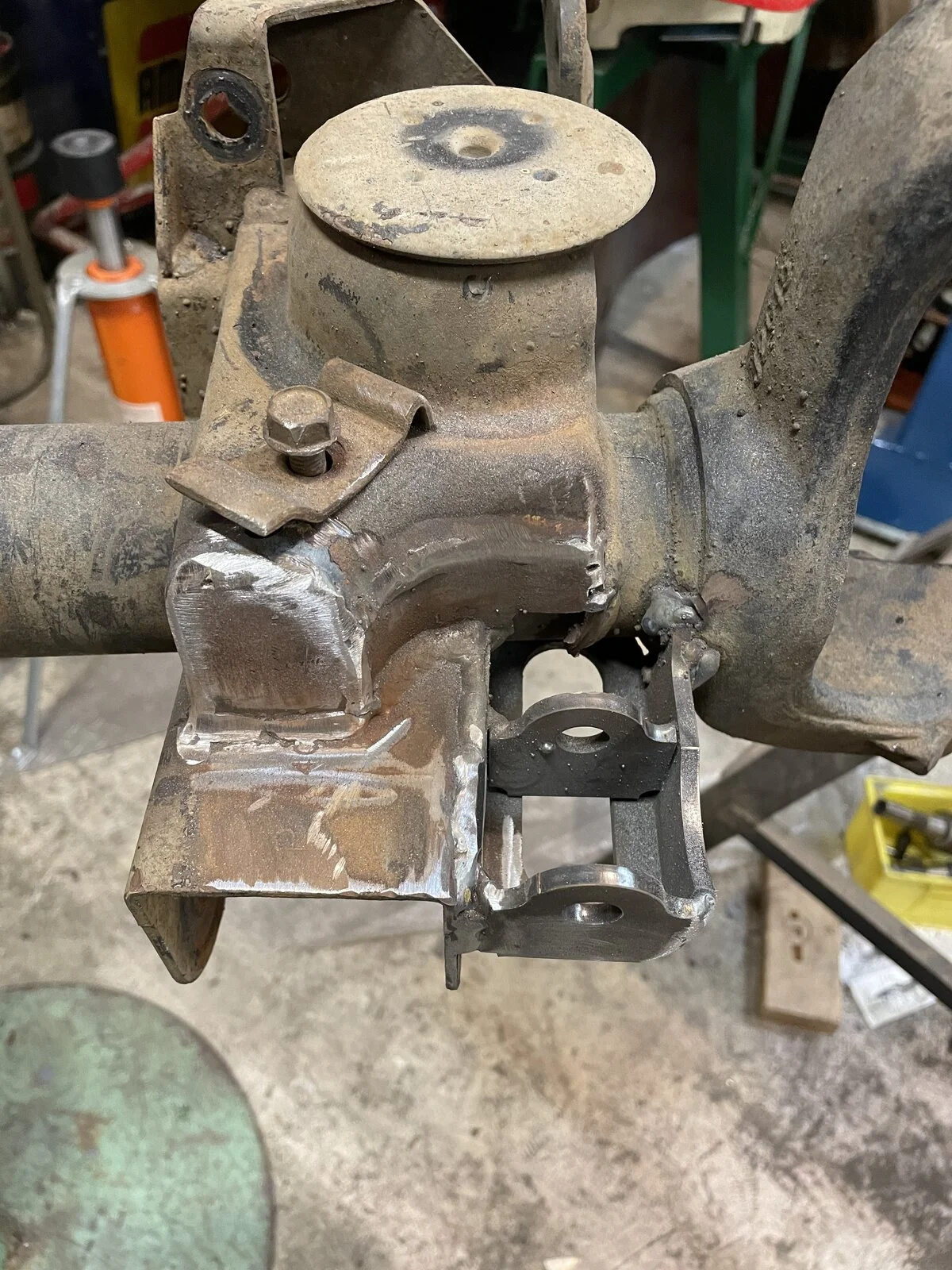

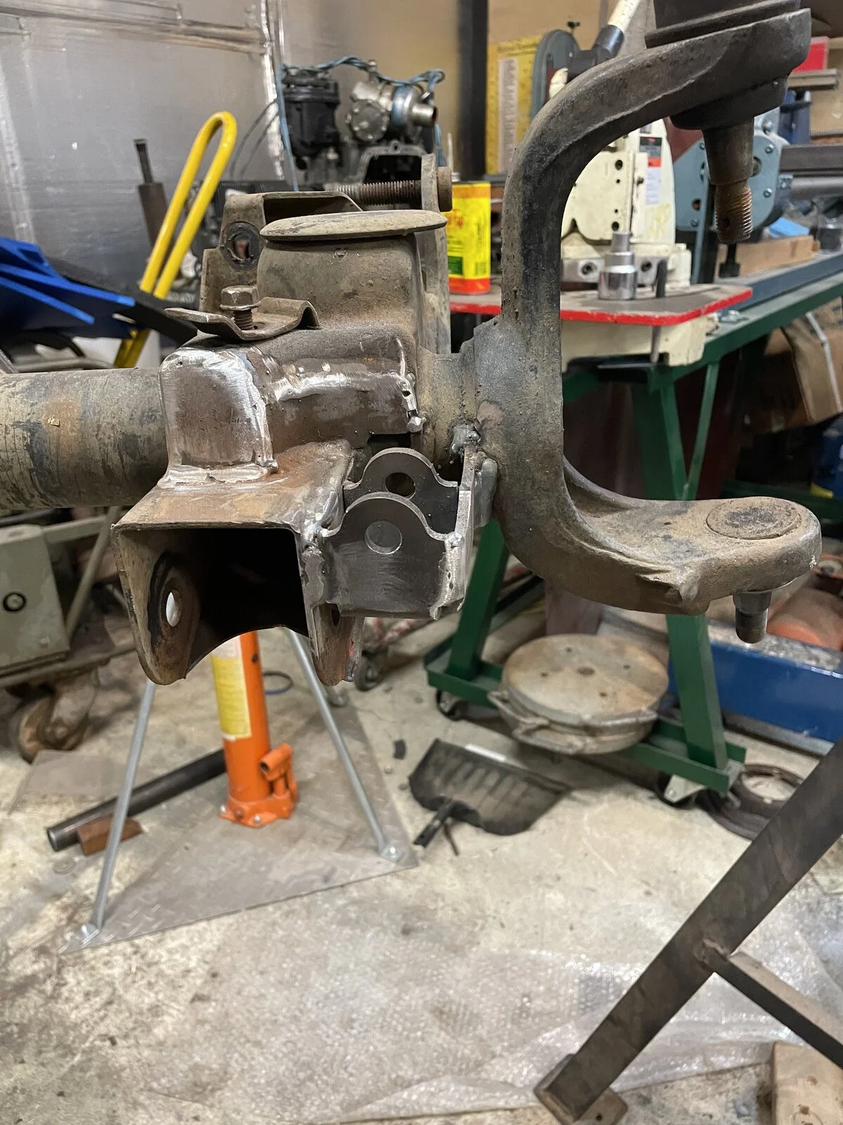

This is how I welded up the front lower on the hp30, I have the 12” fronts from @pcoplin abd probably should have done the 11” ones just because the extra inch is a lot more than an inch on the shock body…

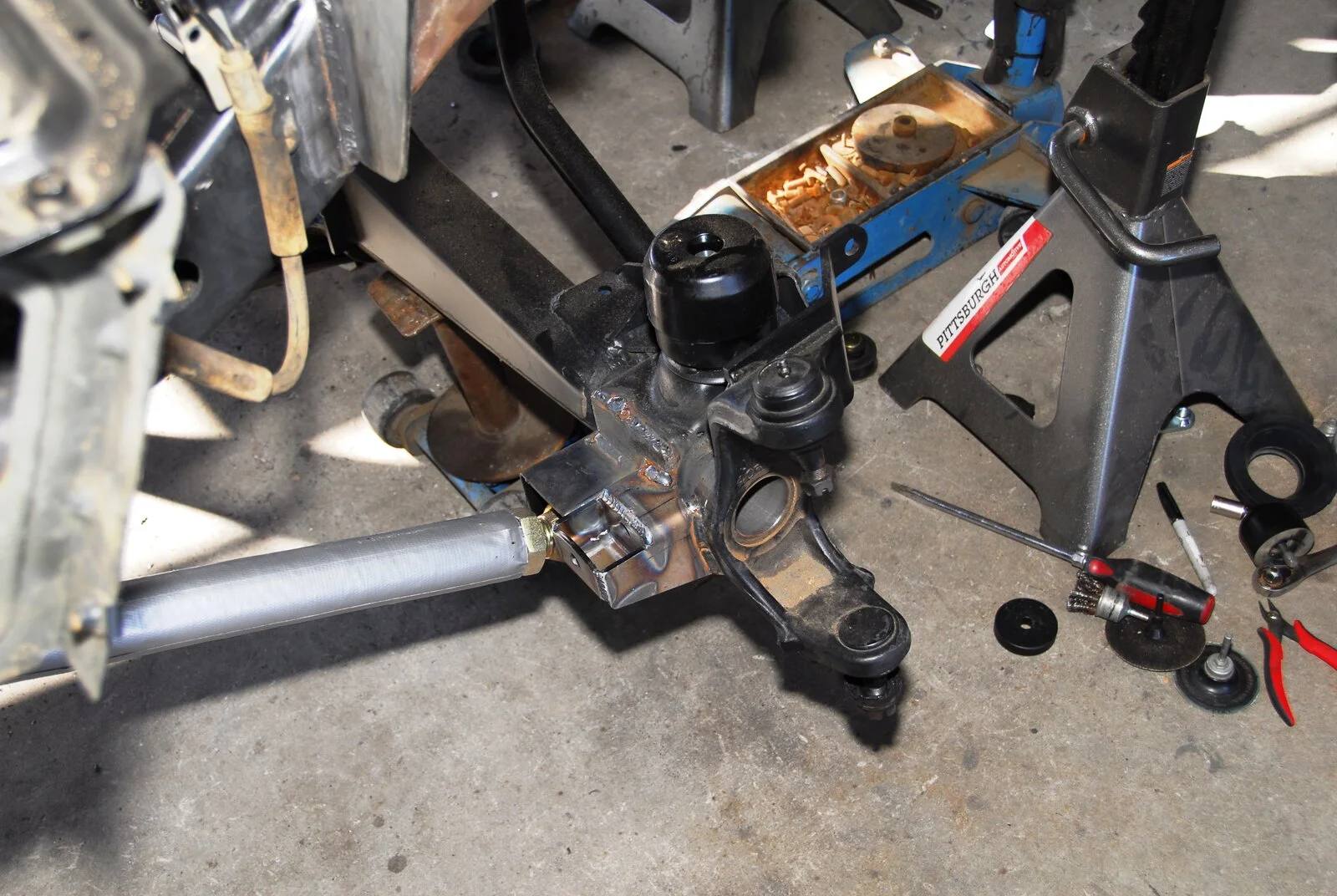

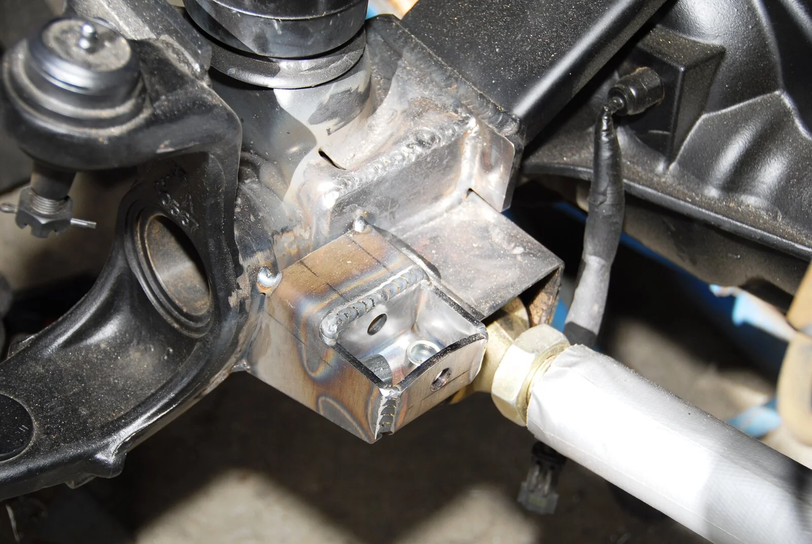

A few things that may help. Your reference point is the hole in the factory fender that lined up over the top of the shock pin. That is what I use to keep the shock tower relatively located to where it should be. That will also let you keep the shock tower roughly centered fore and aft on the shock body.
Your mock up stick will screw you hard if it holds the top and bottom bolts square to each other. The frame curves inward which rotates the mount out of square with the lower mount. My mock up stick is two round tubes that slide inside one another to let that happen and set the distance apart for the two bolts.

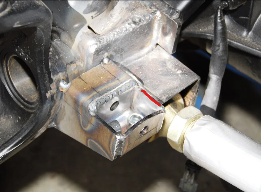

I cope the lower mount into the C after capping off the back of the spring perch to support the cut edge. That cut is parallel and generally even with the back of the axle tube looking straight down on it. Tacked only to hold the mock up stick and set or help set the height, rotation, and tip out angle up the upper mount. If I need a 1/4" up or down, I can cut the tacks to get that.

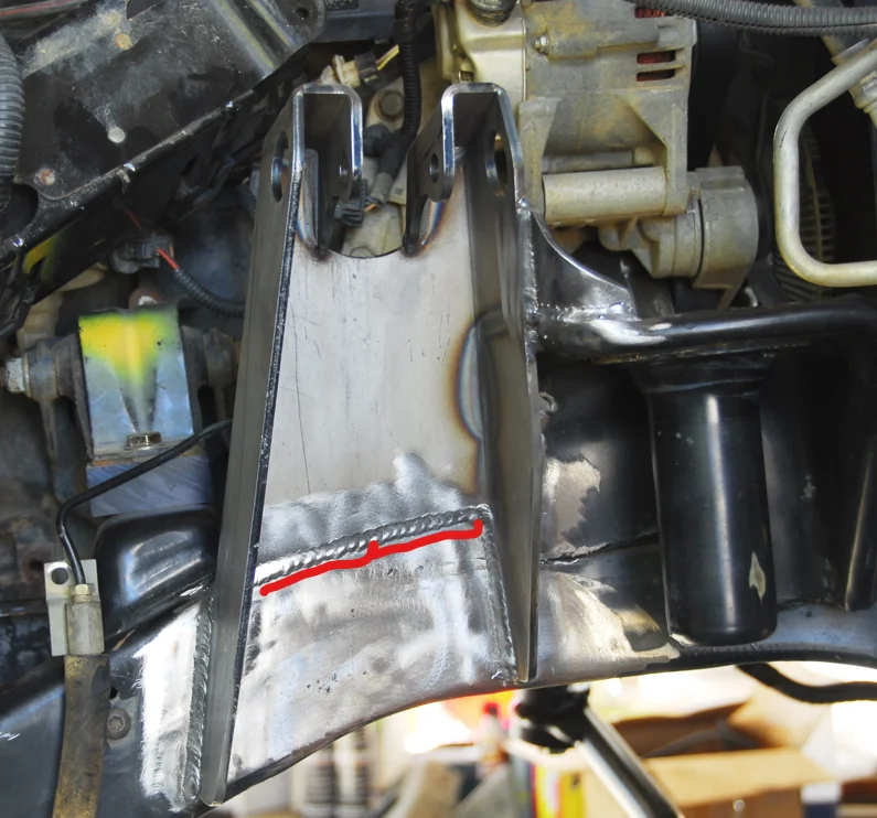

The edge highlighted in red is generally around 3/8" above the top of the lower control arm mount. Emphasis on generally and it is also parallel to the top to keep the two bolts relatively square to each other.
That edge is the edge as it comes from Poly. If you try to notch it into the gap, the shock will be too close to the axle and not as vertical as you would want.
The underside will need some trimming around the LCA bolt. And, the forward inboard side will need to be cut up some to clear the axle tube. We weld down the inside along the lower control arm mount, down the inner C and where it touches any place else.

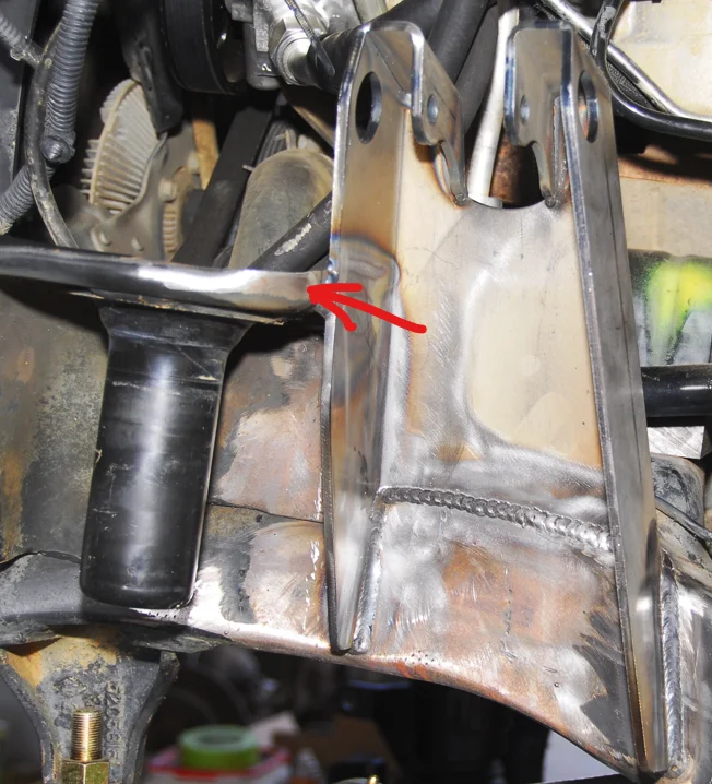

For the upper, I use the vertical brace as my forward limit, I remove it completely and then replace it with the forward leg of the tower. I don't worry about trimming it much until final, then I cut it down to about the same size as what I removed and hold the lower end up from the bottom of the frame a small amount.
If you try to get the two faces roughly parallel, it seems to work out fairly well.

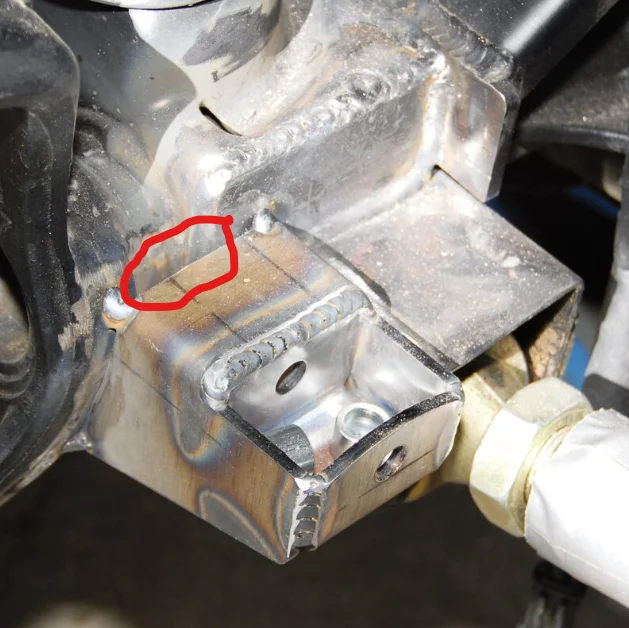

Once you start trying to fit up the mount and cope it in to close up the gaps, looking at where the mount side touches the spring perch, you will note a big gap as the front edge touches first. I smack that edge forward to help with that and kinda beat that whole side into submission to get it close enough to weld. I also gusset the edge of the perch back up to the mount to put back the support I removed when I cut off the rolled edge.
As in both mounts at the horizontal frame cut, those are trigger welds, some days I can do a good bead there, others I have to trigger weld them. It is the option of last resort though. But with so much surface area welded up on both sides of the closely fit down legs, they are just basically filler to make it look sorta like it was done well.
