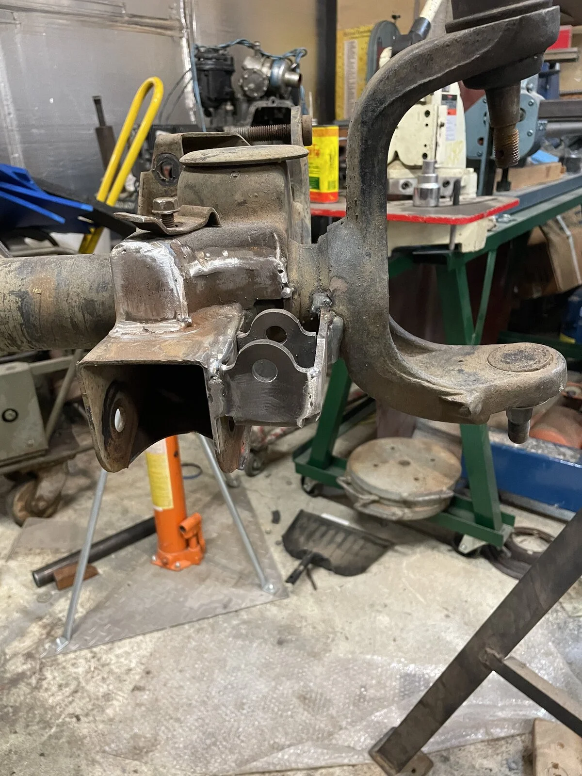

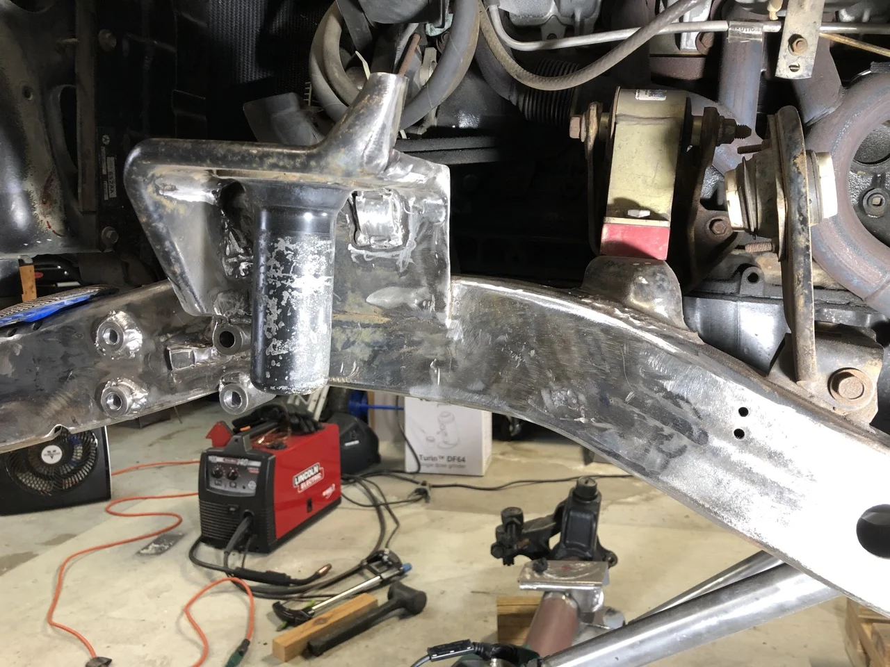

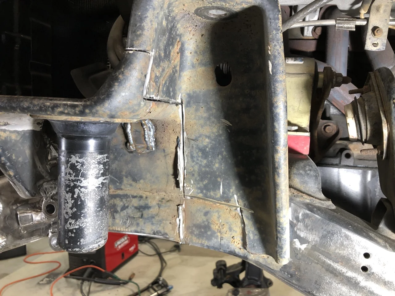

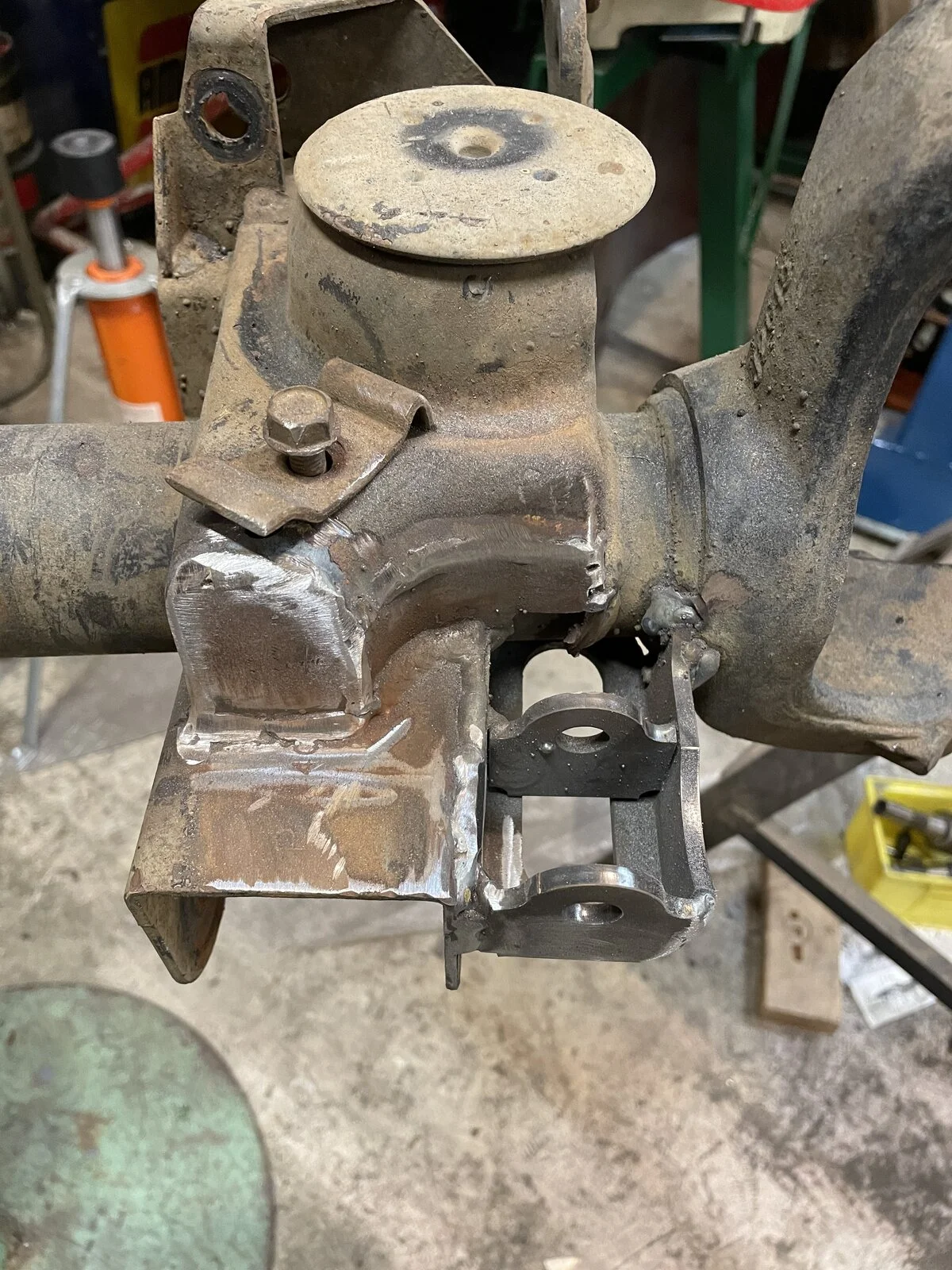

Cut one of my towers today:
What are the criteria for shock placement, other than just making it fit without hitting anything? You want them completely vertical at ride height, both in therms of camber and caster (for lack of better words)?
Reactions: L J
NskLJ
Oct 19, 2021
1,527
Long Beach
Shock vertical at ride height. As Blane stated the upper shock tower in line with the hole in the fender. I measured forward to the core support and in to the alt bracket on the right side and the exhaust tube on the left. I’m reall happy with the way the right side turned out. ( I just have to finish welding )
