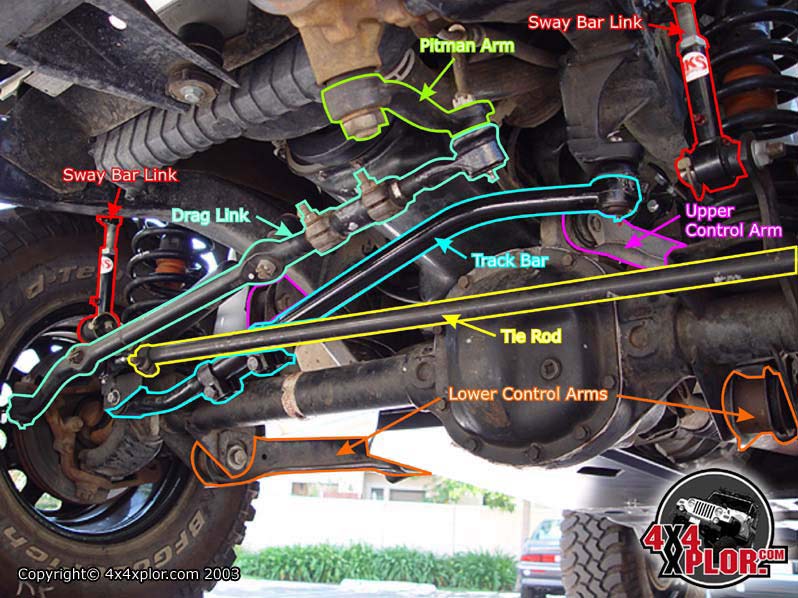

With the engine running, have a helper turn the steering wheel side to side between 10-2. You reach in and feel each and every steering and suspension connection you can think of. Listen and feel for these clunks and pops.
Reactions: NashvilleTJ
Try the "dry steering test" which will probably help you to isolate where the noise is coming from. Do this with the tires on the ground with all the Jeep's weight on them and without the engine running so you can hear the results as well as see them.
Have a helper do repetitive quick short turns with the steering wheel while you closely watch and listen to the steering system from the front. Look for sideways slop/movement at all the rod-end joints including the track bar, drag link, and tie rod. Sideways slop is bad at joints and where they are bolted together but it's normal for there to be rotational play as you rotate the drag link or tie rod with your hands. That's because they're mounted on ball joints so they can rotate as the suspension moves up and down while driving.

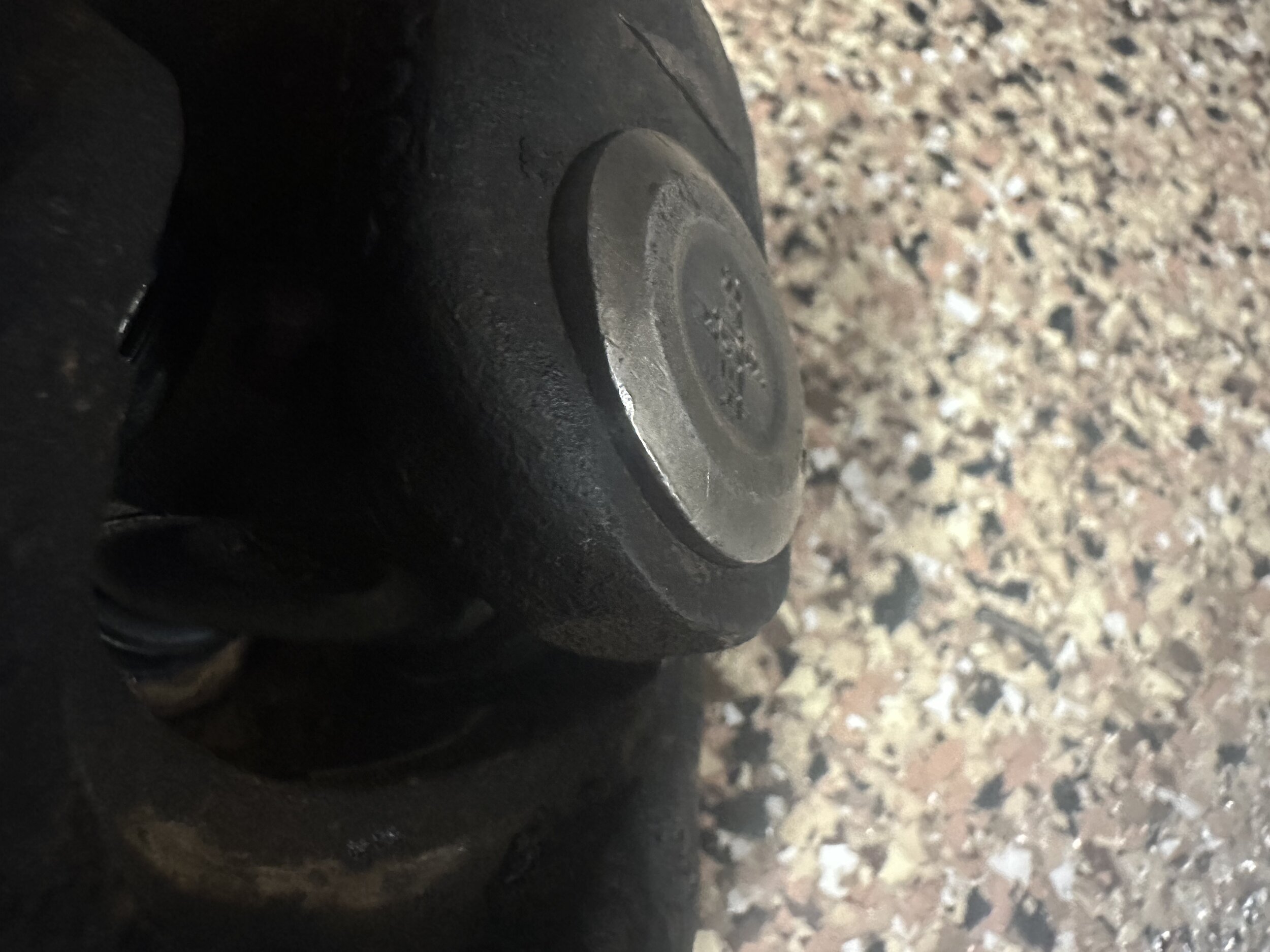

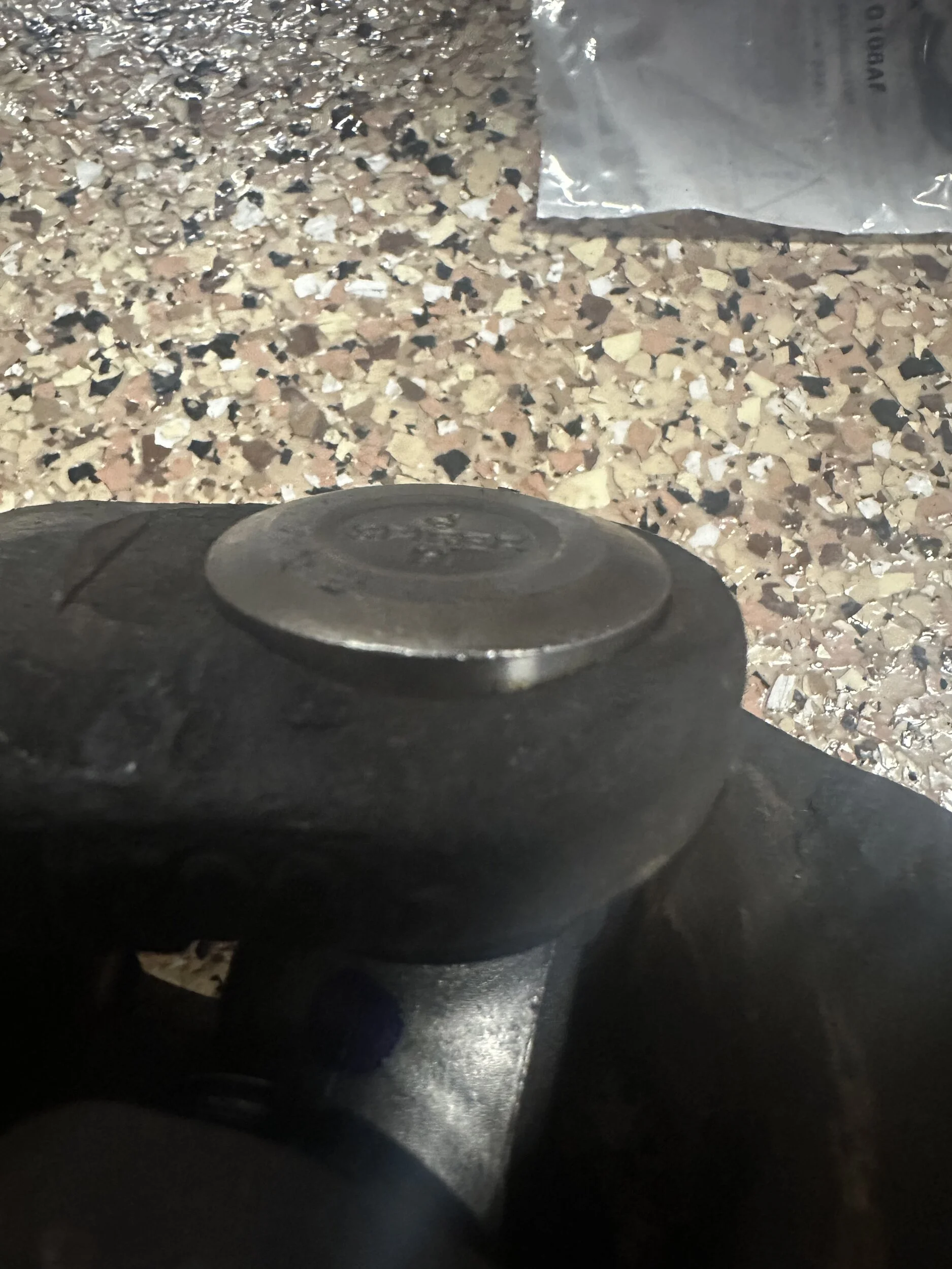

Installed the new u joints. For some reason the one side isn’t fully flush. I’ve tried getting it flush from both sides but it just keeps coming out the other end. Is this too much too be concerned with?
