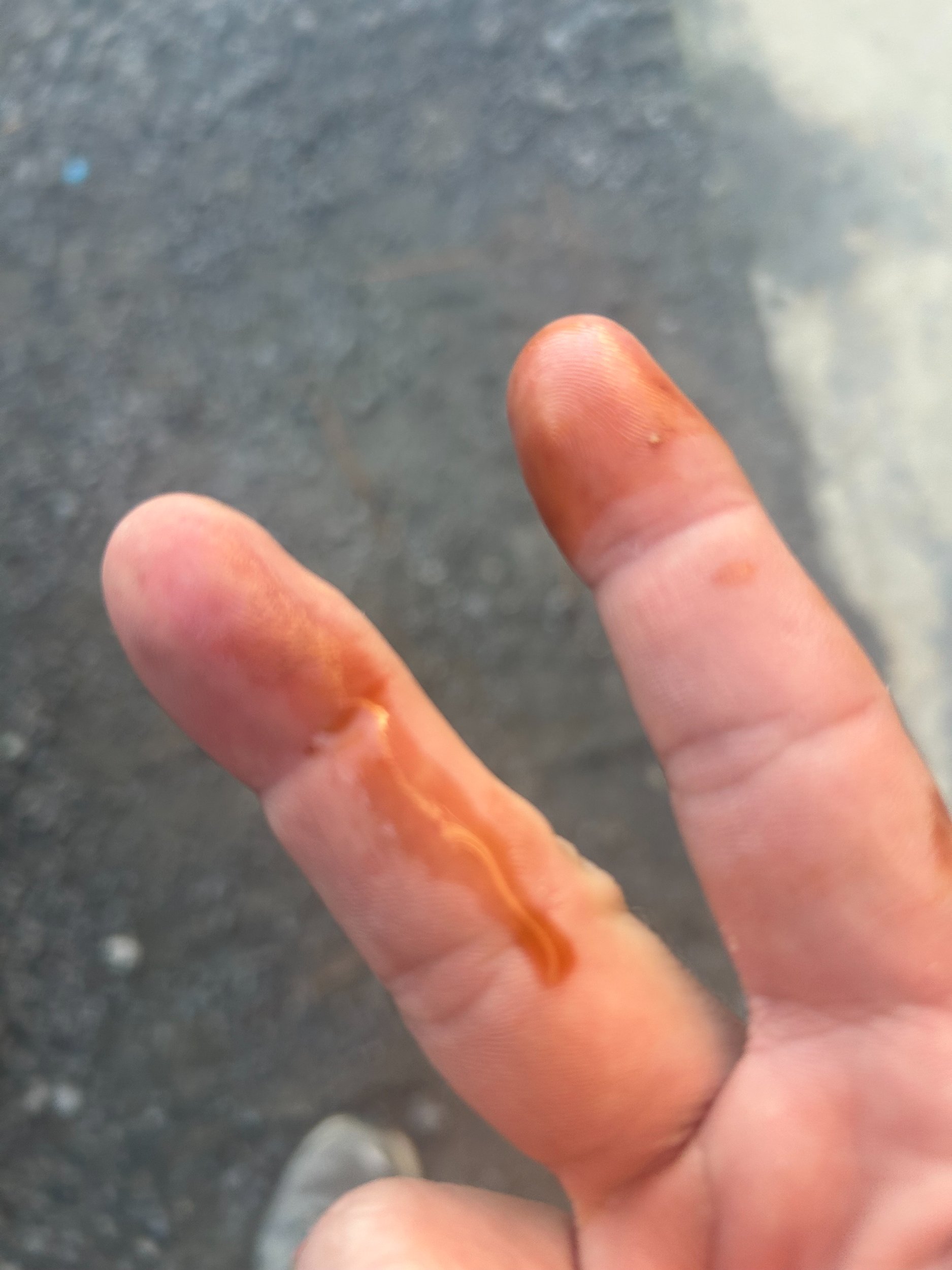

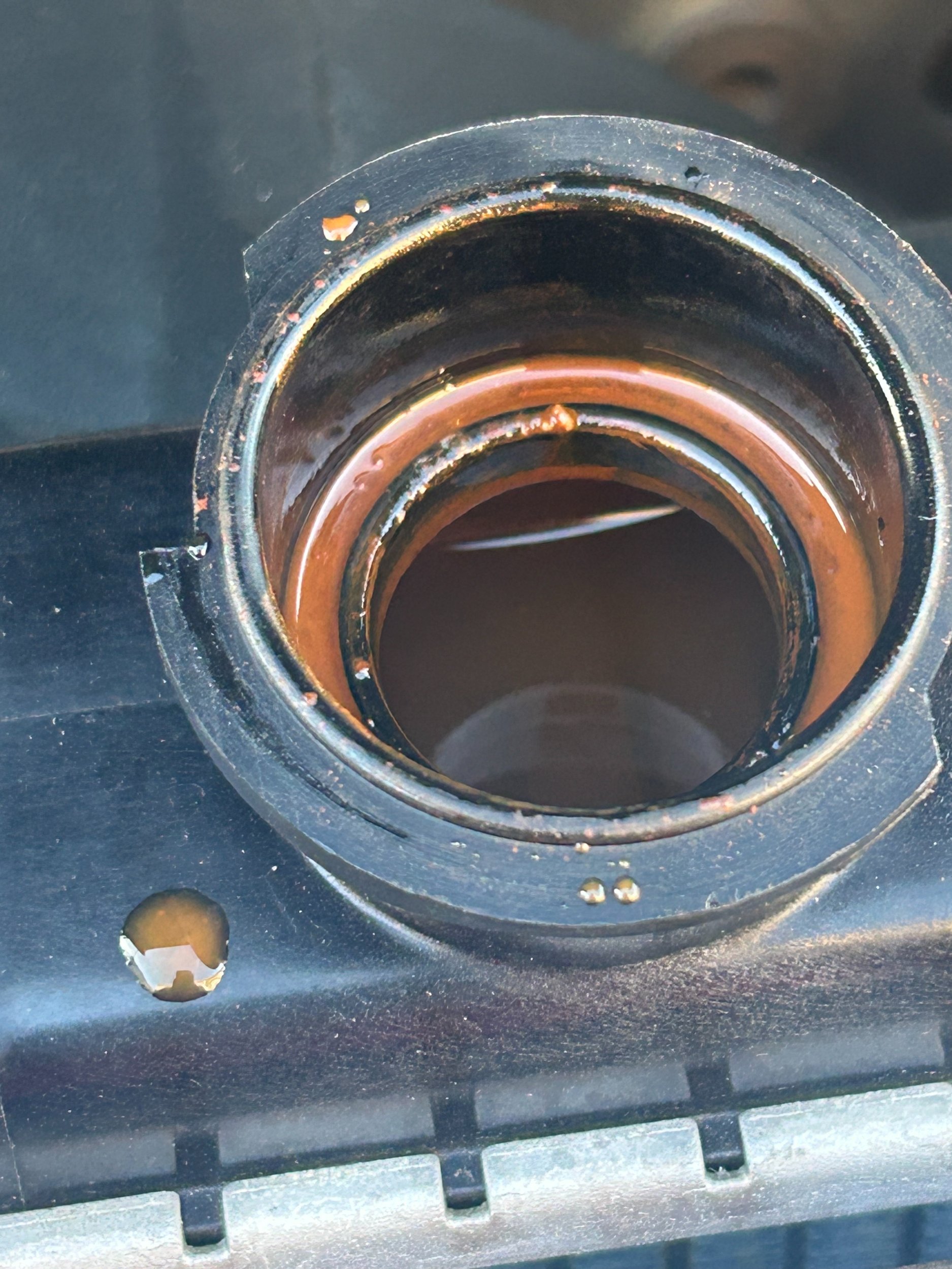

Im guessing this isnt too good? its neither green or pink or whatever the other one is unless they mixed?
new radiator was just put in.
  • Face Palm
Reactions: macleanflood
No idea. That's why I'm posting this. I guess it's bad. The valve cover gasket was recently replaced as well as thermostat, radiator, and heater core was flushed. I'm guessing I jus need to take it down to the mechanic to get a full system flush.
You definitely don't need to take it some place to do a full flush, there are plenty of writeups here. Get some themocure and run it through as per the instructions. lather, rinse, repeat. Nobody talks about it here, but the prestone flush kit works pretty well too.
Prestone flush kit is available and Walmart for cheap. Flushing the cooling system is simple and definitely not a task requiring a mechanic.
