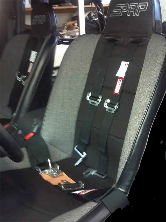

For seats I'm very happy with my PRP Daily Driver seats, not to mentioned they're made in the US. They don't look this pretty now but they're still in relatively good condition. Mine don't have an adjustable seat back angle but I'm totally happy with it as is and never feel the need to adjust it. PRP does have other models with an adjustable seat back angle.

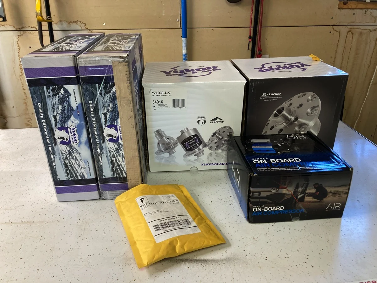

Well, after some debating with friends on the subject, I decided against the posi trac. Watched some video's and was not impressed. I respect your opinion Jerry, and I've heard about the 35's snapping axles, but I'm not pushing limits or even going up in tire size..
So..... Decided I want the Eaton E lockers.... Well, even Eaton has no clue as to when they'd ship. Disappointed :confused:. In the end, went with the Yukon Gear Zip Lockers. Really didn't want the air system (I'm believer in K.I.S.S.) but it was in stock wasn't $2000 each end + labor which I was quoted with no date to install. Hopefully I'm happy with the system.
