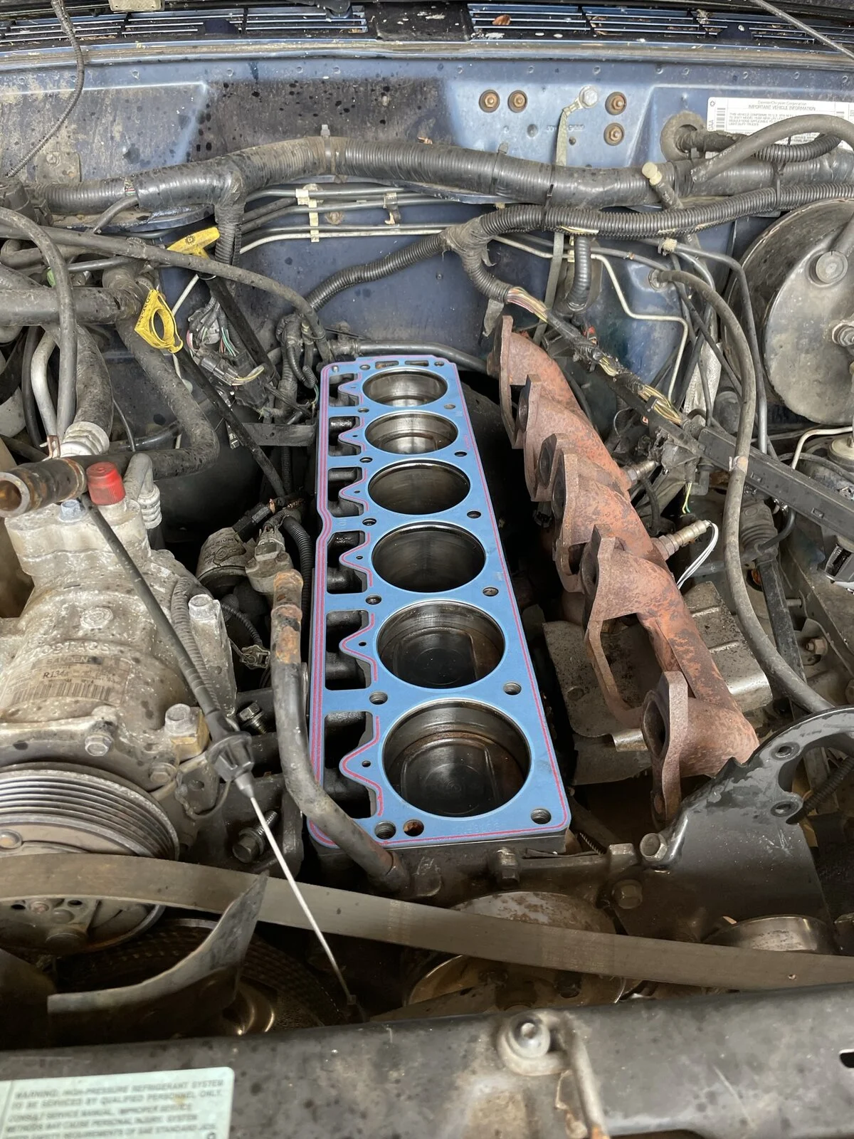

pits not really that bad, I know it’s an xj…. But same engine. Did that two weeks ago
